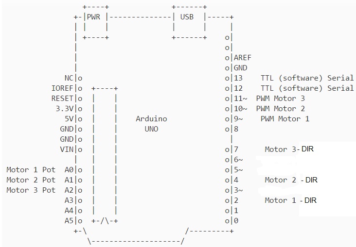

    Question
    Do you need Firmware To upload the Arduino board
    Or just download the file (SMC3.ino v0.63) to Arduino
    and The opening program ( SMC3Utils v0.63 ) and tests and test the motor
    Another question
    To connect the wire there is 1 pin for pwm and 1 pin for direction of h-Bridge
    Is this true form of linking ?
    just Only CODE MODE1
    Do you need any Other modification ?
    the SMC3 Utils Is It similar AMC1.5 and xSimCTRL
    Is if used SMC3 I do not need a program xSimCTRL ؟
    Forgive me On stretching
  10. Pit
    3,007
    30,502Coins
    +3,098 / 31 / -0
    No firmware needed, only the ino file has to be uploaded via the Arduino software. SMC3 utility is needed to set the parameters individually and test the motors. The proceeder is described at the beginning of this thread.
    The wiring is very well described and very easy to do. Only follow the pictures.
    No, the rest has to be done within the SMC3 utility.
    Please READ the complete todo at the beginning of this thread, there is all described and easy to understand. If there are any issues you will run into while configuring the set we are here to help you :) But first read please ;)

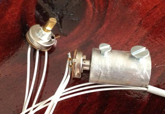

    When the testing process are linking the Pots with the motor as the picture
    In order to get the desired result
    Or leave Pots Also in the picture
    and work test:nerd

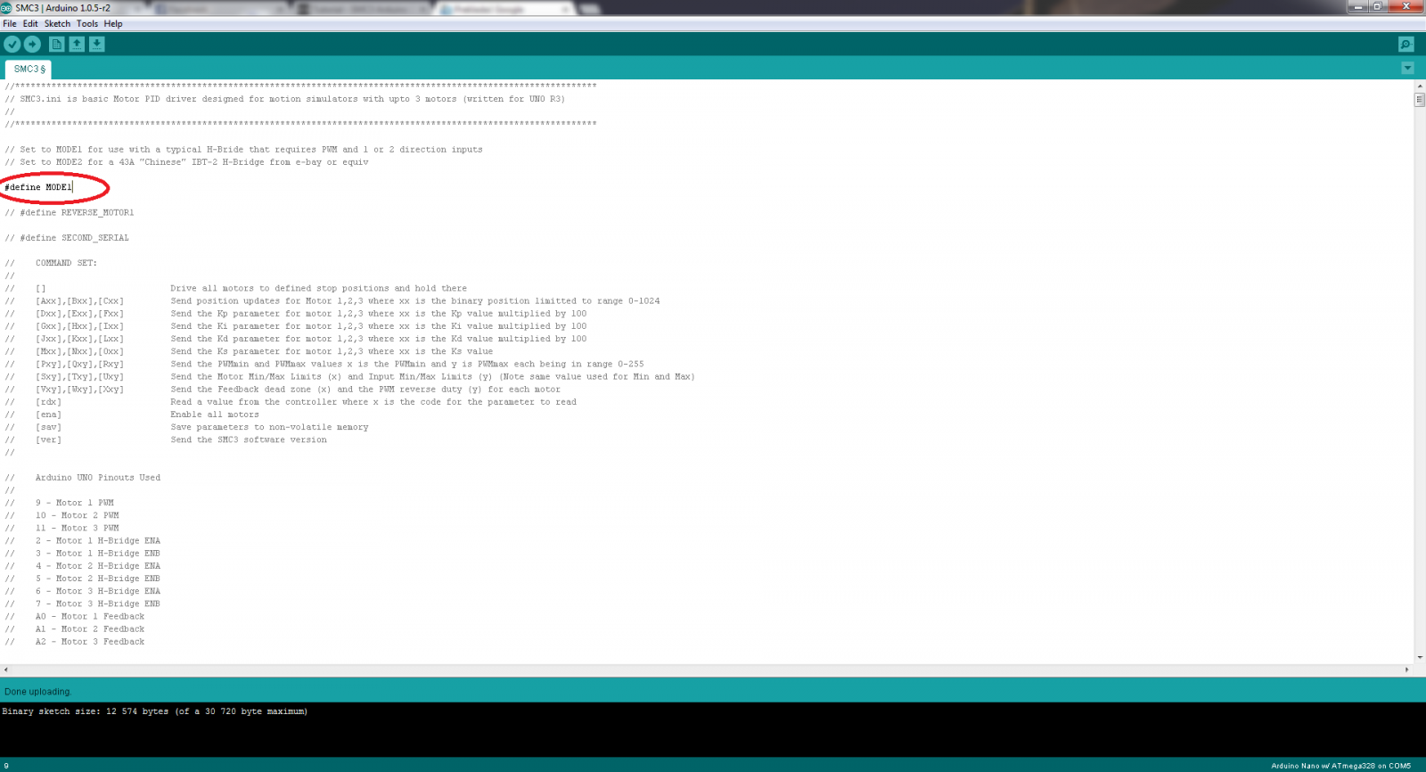

    Hi everyone, How do I modify the code to MODE2 what to delete or add? Because I can not do it. Thank you for your response.
  17. hooshang
    hooshang Active Member
    Jul 6, 2011
    273
    275Coins
    +157 / 3 / -0
    simply write MODE2 instead of MODE1 at the beginning of the code SMC3 v0.63
    hope it help
    regards
    Hooshang
  18. berty
    berty Member
    Sep 10, 2014
    72
    164Coins
    +12 / 0 / -0
    So that only this just overwrite the MODE2. Nothing more?
  19. Pit
    3,007
    30,502Coins
    +3,098 / 31 / -0
    Nothing more. Uploading and done.
