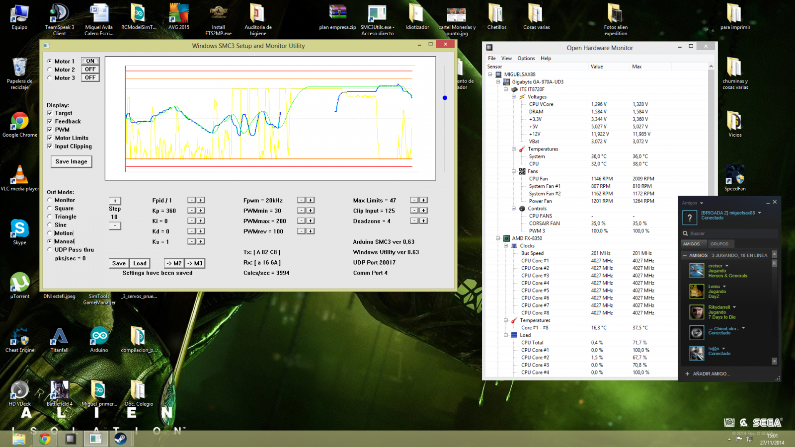

  14. CalSim
    CalSim building things
    Jul 24, 2014
    89
    bacteriology analist
    Spain
    1,310Coins
    +41 / 0 / -0
    DC motor, Arduino, JRK
    Well this is my fail right now.
    The code, or the arduino, something is missing.
    It works as it should, but sometimes the motor "misses" the target line.
    Pot works, as you can see in the photo. I was using the manual output mode.
    When I just move fastly the blue dot, the direction is missed. Same happens on real fire on a game. To get it back, I have to put the target line OVER the green pot line, then it takes the signal back and follows as spected.
    See the graphic and judge yourself.
    Whats wrong???
    thanks

  16. SilentChill
    2,645
    20,598Coins
    +3,570 / 34 / -0
    Check check and recheck your wiring, it solved most of the problems I had . Only reason I can think of that an Ard would blow
  17. SilentChill
    2,645
    20,598Coins
    +3,570 / 34 / -0
    It sounds like the same problem I had, it was the motors drawing too many AMPs making my motomonsters shutdown for a second making the motor stop and it restarted once I aligned it again. I just ended up using 1 dual motomonster for 1 motor it solved the problem for me. May be the same issue but I dont know what your setup is ?
    ps Have you tried a lower PWMMax say around 150-160 ?
  18. CalSim
    Jul 24, 2014
    89
    Spain
    1,310Coins
    +41 / 0 / -0
    @SilentChill I made again all connections, changed main wires, now AWG14, sanded all pins.
    My motor is big, but people drive the same and even bigger ones with mm. It is the motioncontrolproducts ZYT-90, its 23A constant 48 Apeak, with 60:1 gearbox
    I really dont think ( i hope it wont) the motor is crashing the mm, beause i'm using 1 mm in dual mode, to drive 1 motor. My PSU is 70A and it shuts down if PWMmax > 180 ( With Kp500 )
    I did not know motomonsters have overdraw protection. just thermal protection. When signal is lost, the mm is still on since i can see the red led. If i have reached the max power of the mm, this is definitely not proper to drive the motor.
    What kind of test shall i make, to ensure this is my issue?
    Maybe @Pit, that works with mm knows this issue, or @RufusDufus can have an idea of whats happening.
    Really, Thanks
