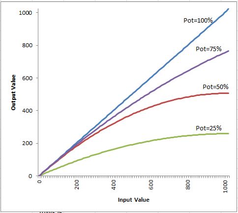

    A new version of the arduino SMC3.ino has been released (v0.7)
    This new version adds an additional analog input that can be connected to a POT which is used to scale the motion output (like a volume control :grin) I have been using it for months now and had no problems so finally got around to uploading it.
    It also adds a minor feature to reduce the power to the motors if there has been no comms from the computer for about 30 seconds.
    • I would suggest if you use it save your motor settings first with SMC3Utils - shouldn't be necessary but just in case.​
    • Check the MODE is the one you are using in the top of the .ino file.​
    • Enable either non-linear or linear scaling by uncommenting the appropriate line at the top of the .ino file - just go by comments at top of code. (My preference in the non-linear scaling)​
    • The POT input used in AN5.​
    • The scaling currently only applies to Motor 1 & 2​
    • I wouldn't use the software with scaling enabled if the POT is not connected as it will probably pick up noise and give strange results.​
    • With the pot at 0% you effectively stop all motion and center the Sim - good for getting in/out of the rig.​
    The non linear scaling is designed to try and reduce the overall motion but maintain the "smaller" movements as best possible - ie road noise and stuff, but scale back on the huge side to side motion you get in higher power cars.​
    NOTE: If you don't need the POT scaling there is no need to change from the previous v0.63

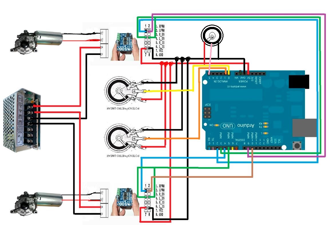

  14. Blame73
    Blame73 Well-Known Member
    Nov 6, 2014
    1,215
    8,306Coins
    +1,134 / 5 / -0
    This is my diagram, hope it can help, the new pot is the one on the leftside, with the cyan wire
  15. RufusDufus
    RufusDufus Well-Known Member
    Jul 21, 2013
    681
    Adelaide Australia
    16,357Coins
    +1,016 / 10 / -1
    If it works without a GND wire between the H-Bridges and the Arduino then I would say you definitely have a wiring/earthing issue somewhere. You need GND connection between the two (the digital GND - not the motor power GND).

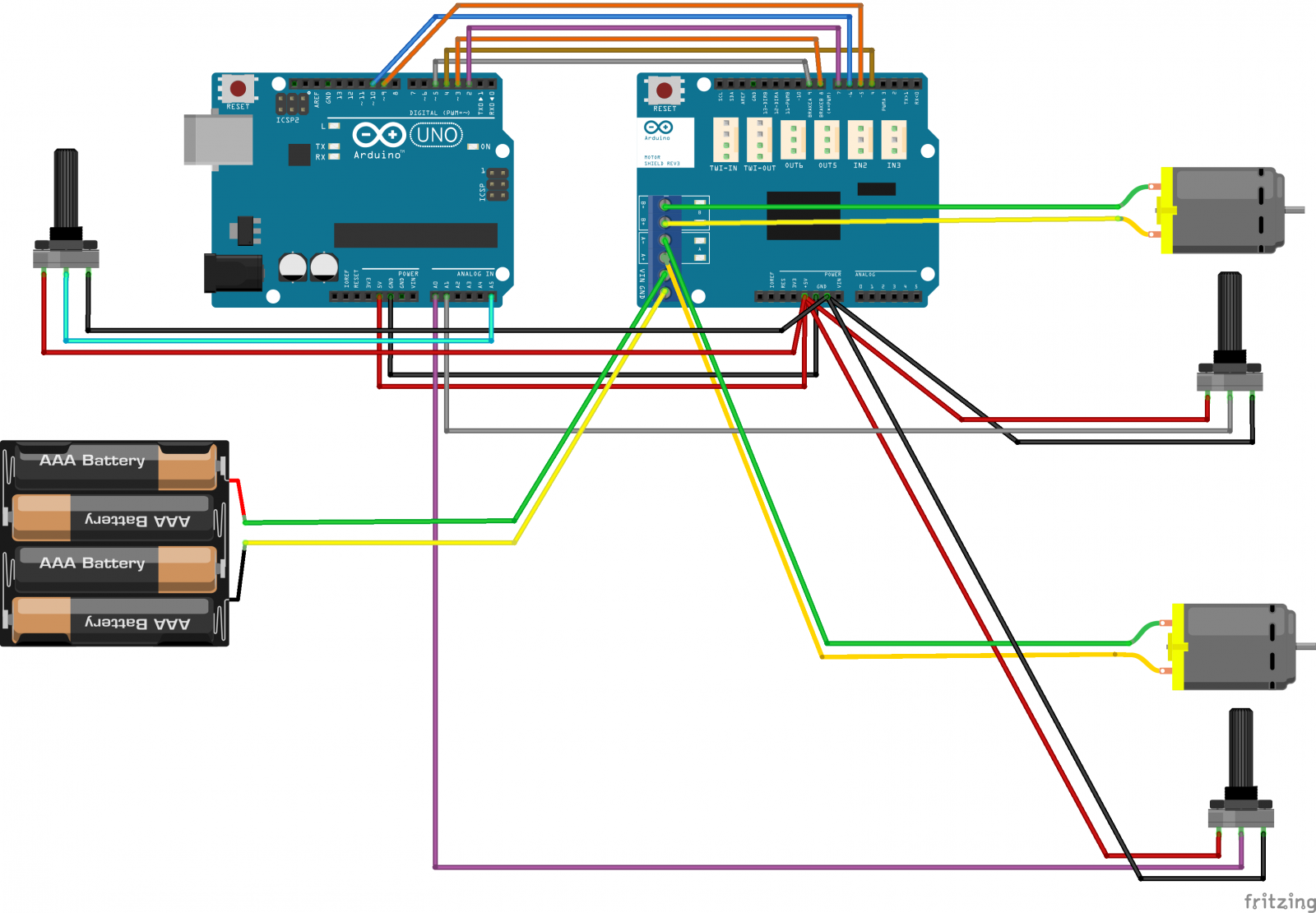

  16. terry wells
    terry wells Active Member
    Jan 19, 2014
    255
    retired military
    minnesota USA
    717Coins
    +59 / 1 / -0
    3DOF, Arduino
    If using update SMC3 V0.7 and the IBT -2s, is this the way the pot should be connected?
