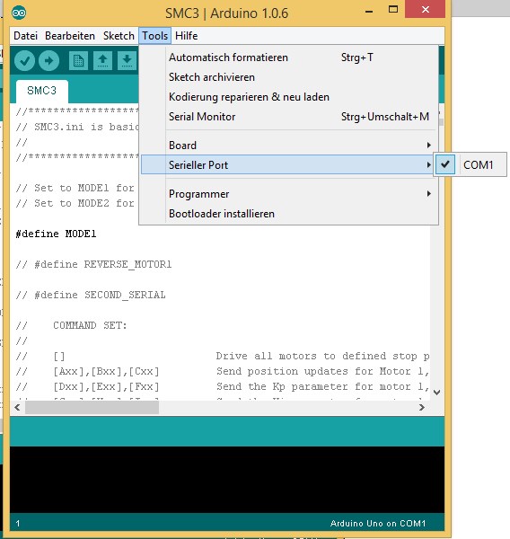

    Which error? Please can you attach the screenshots of you steps before uploading the code? Do you have selected the active COM port where the Ard is connected before uploading?

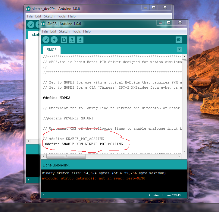

    you need to define either ENABLE POT SCALING or liner or non liner pot scaling in your arduino IDE try that and see if it helps

    Hi, I am currently on holidays and can't see the images too well.
    If you are still getting compiler errors then I would suspect there is something wrong with your installation of the Arduino IDE. Make sure you are using the latest version.
    Try installing the basic Arduino Flash LED code on the arduino site, make sure you don't have any problems with that first.
    If the error is that it can't connect with the arduino to download code then make sure no other code is running and connected to the arduino. Ie shutdown Simtools and windows smc3 utils before trying to program the arduino.
    It looks like you have the wrong interface settings in Simtools, but if you can't program the arduino you don't have to worry about that yet. The details you need are in the first post.

    RacingMats code is good code that has been used by many. If you have that working stick with it until you have everything else working (best only to change one thing at a time). The SMC3 code gives you a bit more control over the motor drive using a PID control loop. It may give you some finer detail in your motion, but not everyone notices a difference.
    While you can enable the POT Scaling as Terry indicated, don't do this unless you actually have a POT connected!

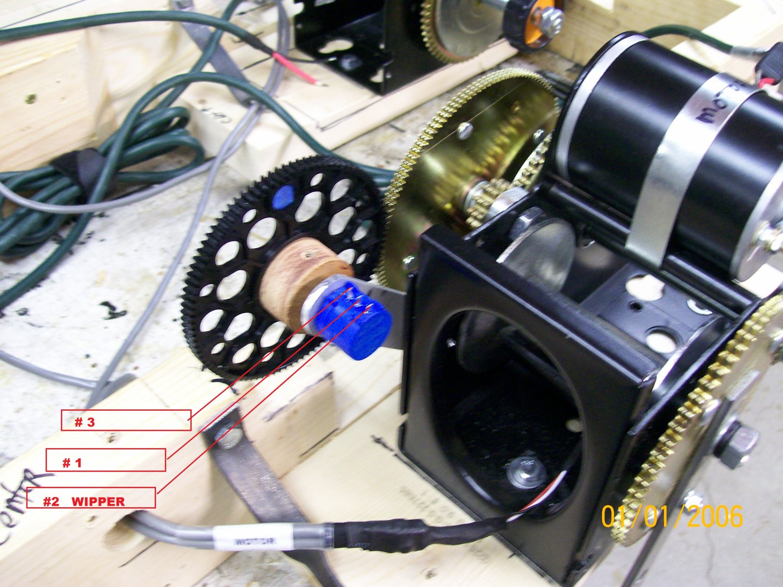

    Hey rufusdufus:, How can I make my 10 turn/10K pot work with SMC3? no matter what I do I cannot get any signal to my motor to make it run. I am using the tail rotor gear (like histoker) on my gear cluster winch motor set-up. The pot is (BOURNS 3590S) I have it connected according to the manufacture specs. ( A three turn pot works ok?)

    make sure your potentiometer is in middle position(2.5V). this is one feature of this code if it goes out of limits it disables the motor until you get it back into limit zone, otherwise smc3 will keep it disabled
