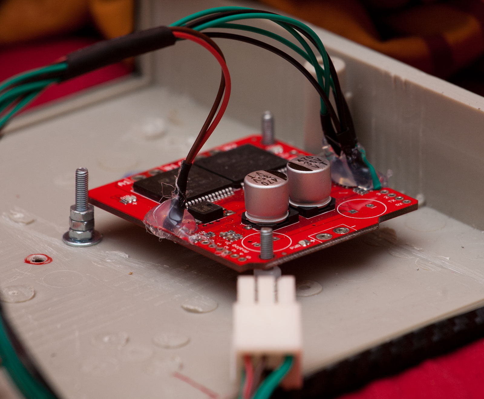

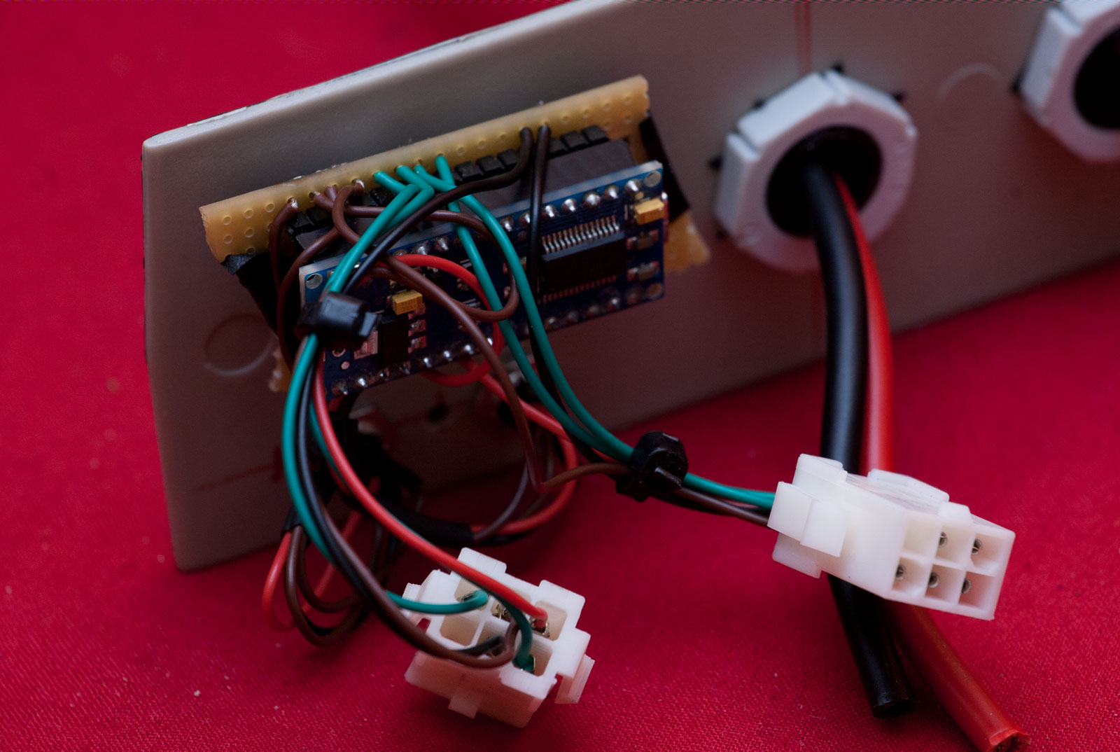

    all my parts for electronics are arrived, and i put it all together today.
    I use an Arduino Nano with smc § Firmware to controll two Motormonsters like descriped by Pit.
    I used this for my wireing
    Arduino -------- Monster Moto
    2 (Motor 1 H-Bridge ENA) ---------------7 and 8 (INA1 and INB1)
    3 (Motor 1 H-Bridge ENB)----------------4 and 9 (INA2 and INB2)
    9 (Motor 1 PWM) --------------------------5 and 6 (PWM1 and PWM2)
    Arduino -------- Monster Moto 2
    4 (Motor 2 H-Bridge ENA) ---------------7 and 8 (INA1 and INB1)
    5 (Motor 2 H-Bridge ENB)----------------4 and 9 (INA2 and INB2)
    10 (Motor 2 PWM) --------------------------5 and 6 (PWM1 and PWM2)
    Also 5V and Gnd from Arduino are connected.Connection between Smc utilities and Arduino is fine. Also pot connetion is fine.
    I don't have connected my motors yet. Only 12v power supply and tried these steps
    1. Set the Kp, Ki, Kd, PWMmin, PWMmax, PWMrev to 0 for ALL motors (This will make sure the motors don’t move)
    2. Set Clip to 255 (you need to do this first) and Limit to 255 (This will give you plenty of margin if something goes wrong while setting up)
    3. Turn on the power to your motors – nothing should move at this stage!
    4. Set Kp to about 400
    5. Now slowly, increase PWMmax… at some point the motor should start to move. When it does check the “Green” feedback line is moving toward the “Blue” target position.
    as descriped on the first post. If i turn my powersupply on the red led for input lights up at the MM. But there is no led for direction lighting up. I checked EnA and B with voltmeter and meassured nothing when turning the pot. Also MM output is dead.
    5v to MM is ok, it reads about 4,47 on my cheap Multimeter.
    Did i miss something? In code i selected Mode 1. I read somewhere on this thread that a nano works, but did i have to change anything for Nano to work? It's th exact same on both MM and measurements are the same on both.
    Thanks for all your work on Hard and Software, and hopefully i can fix this.

    Please post high resolution pictures to be sure all wiring is done correctly.
    As designed. No issue here.
    To be sure: A1 and B1 have the same polarity, A2 and B2 have the same polarity.
    That is OK.
    Correct.
    The Arduino Nano is a board based on the ATmega328 (Arduino Nano 3.x) and has more or less the same functionality of the Arduino Duemilanove. As far I have read in comparison with an Uno R3 (from a programming point of view) there is no real difference between the Duemilanove and the Uno 3.
    Perhaps you should try out as a very first strep one h-bridge in "normal" parallel mode to be sure that all works fine.

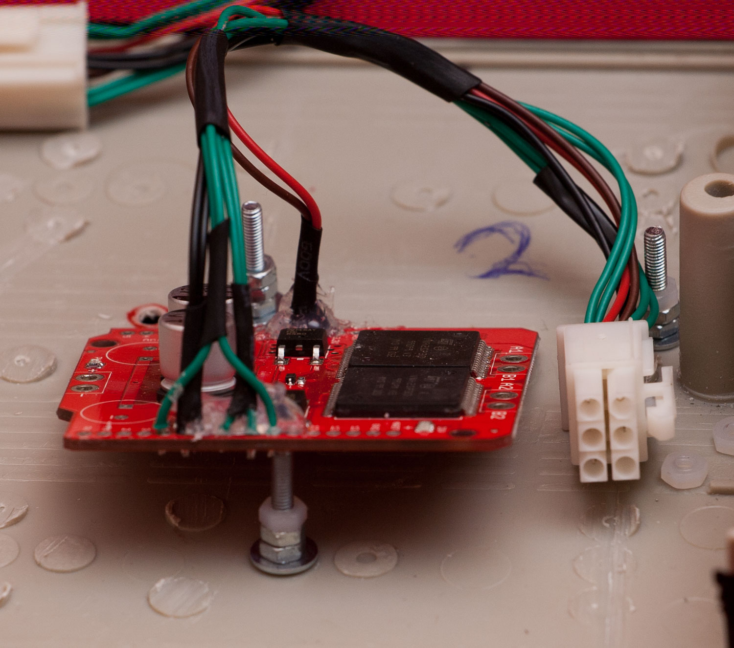

    Maybe a little error in understanding. I mean the direction Pins from Arduino to MM.
    The outputs A1+A2 and B1+B2 didn't meassure any voltage at all.
    I tired to make as good pictures as possible, because everything is conneted.
    I've testet all connections again with multimeter and they are on the corret pins.
  8. Pit
    3,007
    30,498Coins
    +3,097 / 31 / -0
    ooops, I did not read your phrase correctly - sorry. ->
    Impossible to confirm if all is correct, IMO you should never use same colors.
    Are you sure? On the MM photo is it hard to determine if 4 and 9 (INA2 and INB2) are both connected, it seems that 9 and 8 are wired together? And why you use silicone? If somethings goes wrong how you want to clear of that stuff?

    I only used the same colors for Direction lines. I'm 100% shure wires are correct.
    It is no silicone. It is hotglue to prevent cables from bending at the connection. I heat this up 2-3 seconds with hotairgun and can remove it. I removed a little bit to show better the wireing.
    When i turn the power supply off the led for powerinput is light up very dimm. Maybe there is the error?

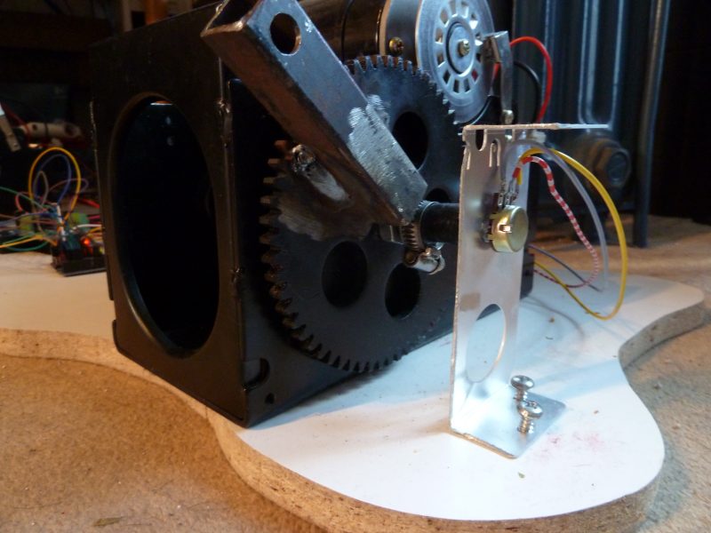

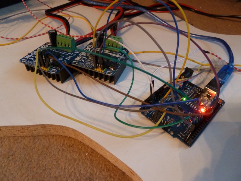

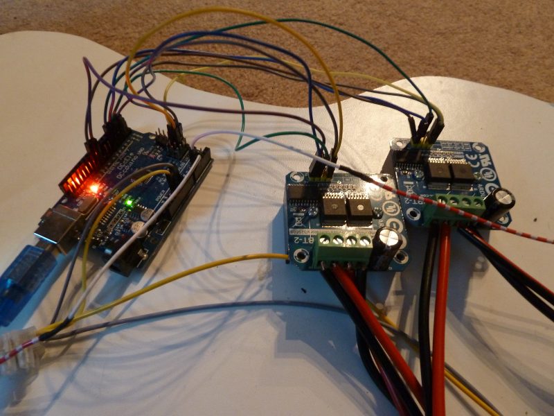

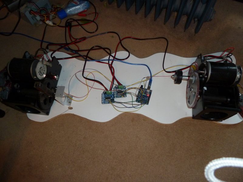

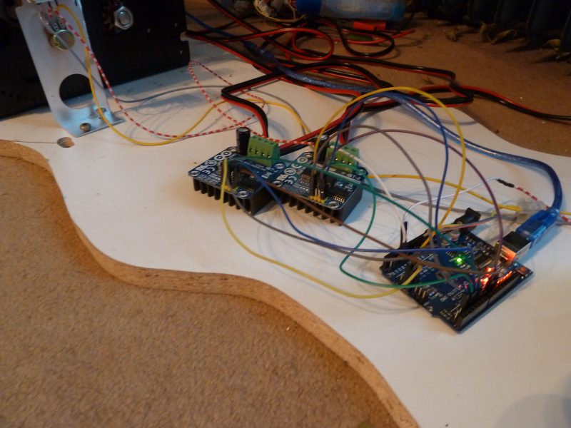

    Hello RufusDufus,
    thank you for your great software, motion sim code and wiring diagrams.
    That was very helpful.
    I can build things along a given "path" but I am not good at problem diagnostic and Arduino code.
    I have read all 26 pages of this thread to find a solution for my problem but I didn't find any.
    My setup, some pictures attached:
    ATX powersupply 13A (only for testing, will be changed to a higher AMPs later)
    2x China IBT-2 H-bridges
    2x pots 10k
    2x 12v car winch motors
    Arduino Uno clone running SMC3 firmware
    SimTools v1.3 runs on 1 PC (Windows 7)
    All connections made like in this picture from page 1
    http://www.xsimulator.net/community/attachments/wiring-2-motors-jpg.10925/

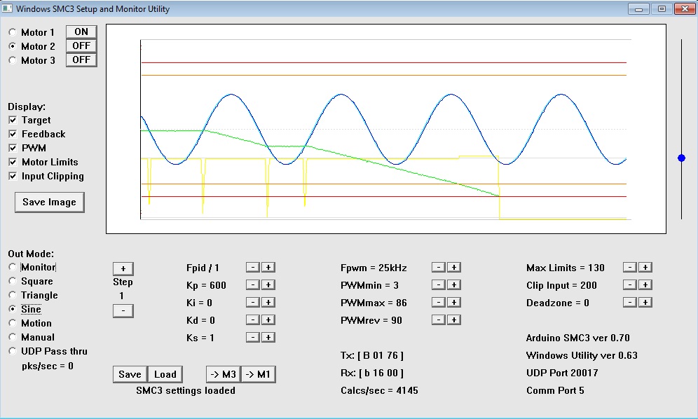

    I have been able to make the attached DC motor move with the SMC3 software.
    But both motors only move in one direction and the lines in SMC3 do not follow the feedback line.
    See both screenshots Motor 1 and 2.
    I have tried two days testing all kinds of settings and your code 0.63 and 0.7 in MODE2 and MODE1 but the same results.
    Can you give me a hint please ?
    Thank you very much.
    Jens

    I am on holidays so only a short suggestion before an other would probably help you : Some winches turn only in one direction.
  19. Outatime
    Outatime New Member
    Apr 21, 2014
    29
    205Coins
    +6 / 1 / -0
    I had tried the winches with a car battery and they turn both ways.
    They are normal DC motors with two wires.
    But maybe my 13A power supply is to weak. It can't start a single winch motor connected directly (Power supply shuts down).
    Only the PWM with SMC3 makes it possible to drive them.
  20. Pit
    3,007
    30,498Coins
    +3,097 / 31 / -0
    My winches don't start using a standard PC 1000W PSU (30A). So in this case your PSU is too weak
