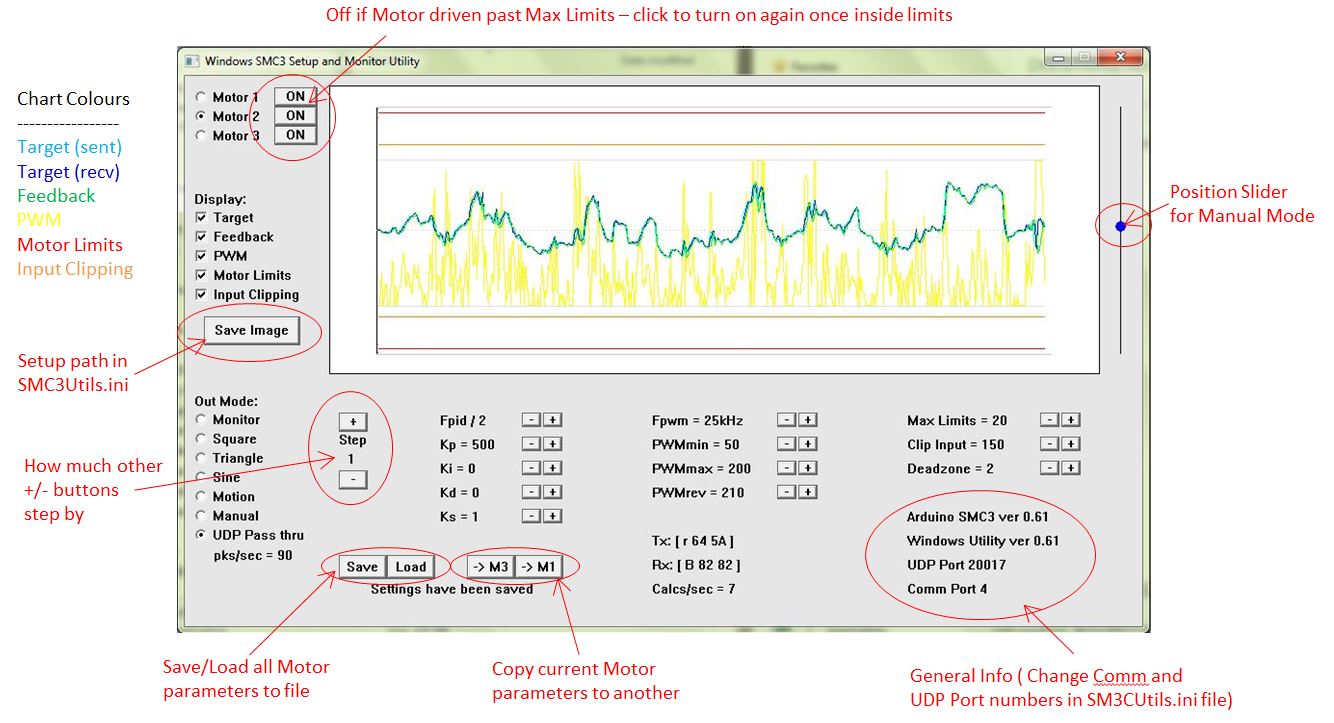

    SMC3 drives only one motor, either motor 1 or motor 2 etc. You have to click with the mouse on the "Motor 2" upper left corner to drive Motor 2..

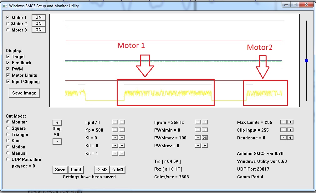

    Thanks! And is it normal that once it moved the right motor, then I had to re wire the left one but after finishing this none of them move. Checked my cabling and all is well.
    Or setting up the utility needs simtools and a game to be running also?:confused:

    Nope, the tool doesn't need any games or simtools to run. Should simtools be running SMC3 wouldn't be able to communicate cause the port would be already used.
    Why are you rewiring the motors? have you tried just re-launching the application?

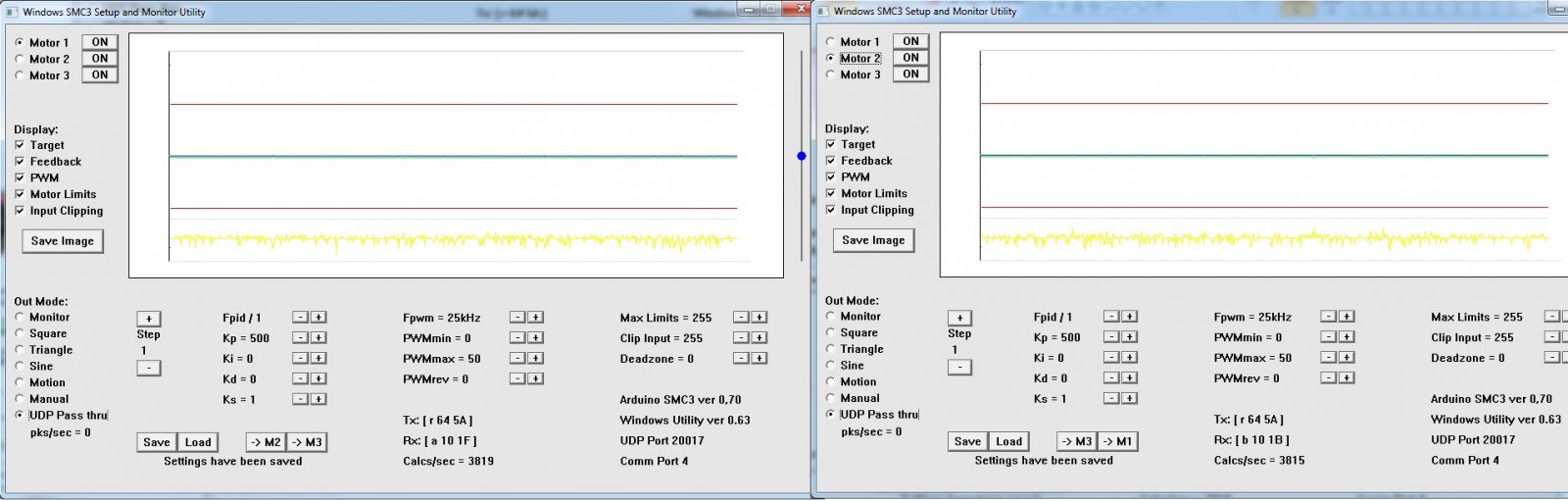

    Basically this was the reason, but I only had to change the power leads on Motor 2:
    • If it is moving away turn off motor power immediately (or quickly reduce PWMmax again). In this case you need to either reverse the wires to the motor being tested –OR– reverse the +5V and GND wires to your feedback pot for the motor being tested (do not do both). Restart the test from the beginning."
    My diagramm might have been bad, the two yellow bars where represented like so, I have just changed the motor 1/2 blip and hence got the same info on one screen:
  5. Pit
    3,007
    30,498Coins
    +3,097 / 31 / -0
    As I mentioned before in other threads (and already not only one time) do not write down your issues only, please post all photos and screenshots about your hardware/software. And I mean all...The screenshot which you have posted shows motor 1 ONLY.

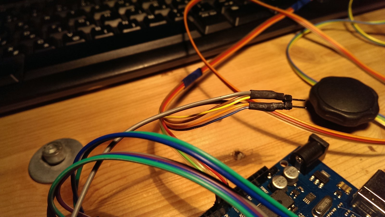

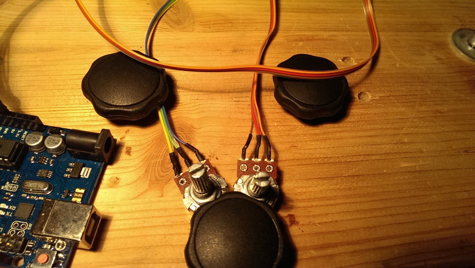

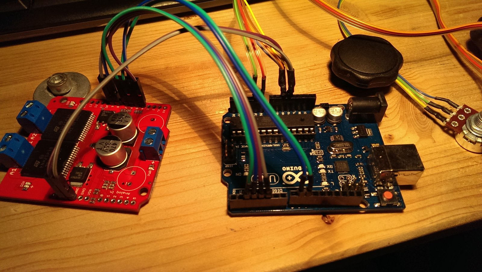

    Sorry about this.
    So the motor1/2 picture:

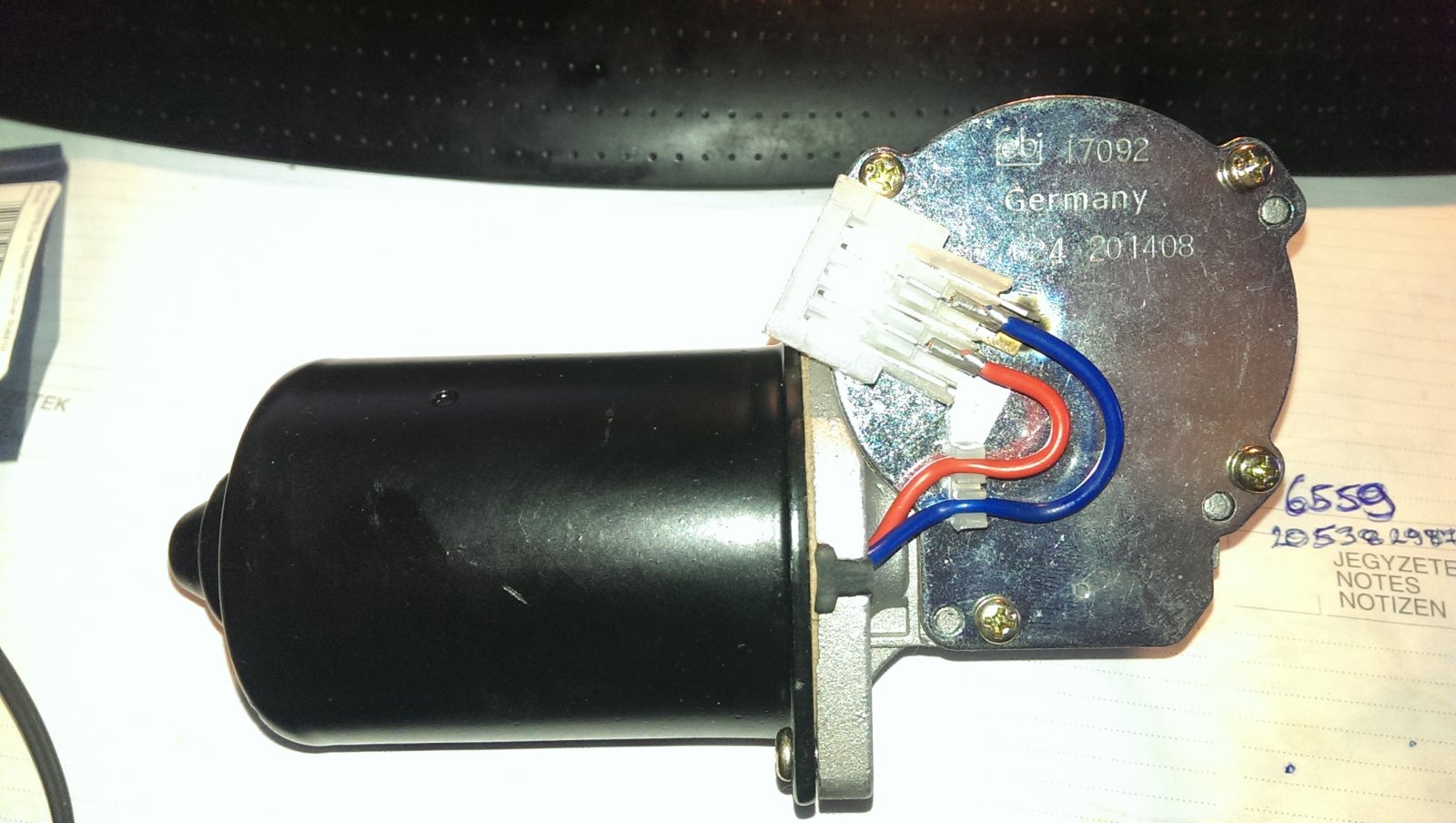

    My motors are wiper motors from VW:
    My wiring is done like so:
    I run the tools from the same pc as the games.
    What else would you need?
    Thanks!!

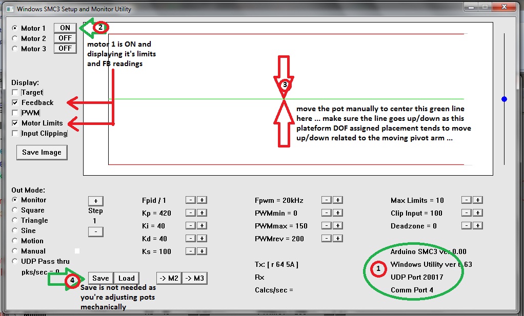

    Sub thread :
    Using the SMC3 Util. as Hall effect Feedback pot adjustments tool .
    Now open the SMC3 Util. connected to Ard. board ... then select to display the feedback signal and motor limits Only ... you will see a Green and 2 Red lines ... the green one is moving up and down when you rotate the pot manually ... align the pot Real midpoint " some pots have a midpoint click " to midpoint displayed on the screen ... OR ... 0-180 degree to the upper/lower Red motor limits .
    - Repeat that for each motor ...
    - Tight every thing down ready :thumbs .

    @Greg83 the wiring seems to be fine, of course I cannot see if all is welded correctly. BTW your wiring is really messy, please beware of mixing any colours, use blue or black for GND, red or orange for + and NEVER use same colours for different outputs. The day will come and you have to solve any issues. You will be lost mate if you will use two or 4 MMs once upon a time :) (30A; 60A).
    PS: already only using one MM you will be lost.
