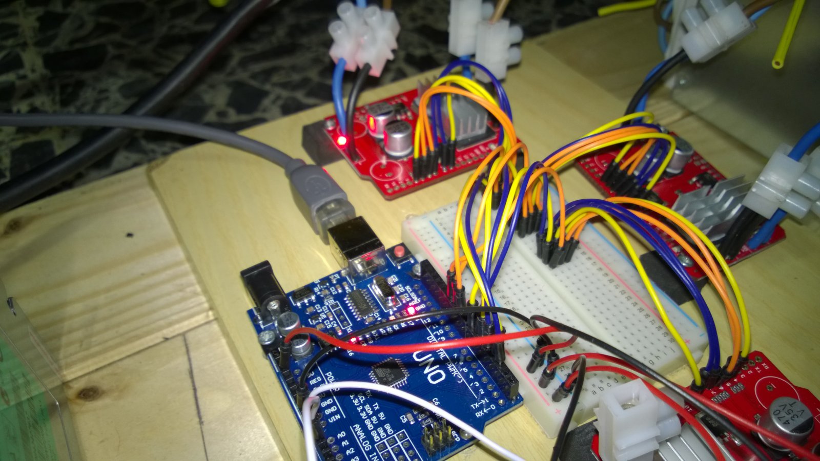

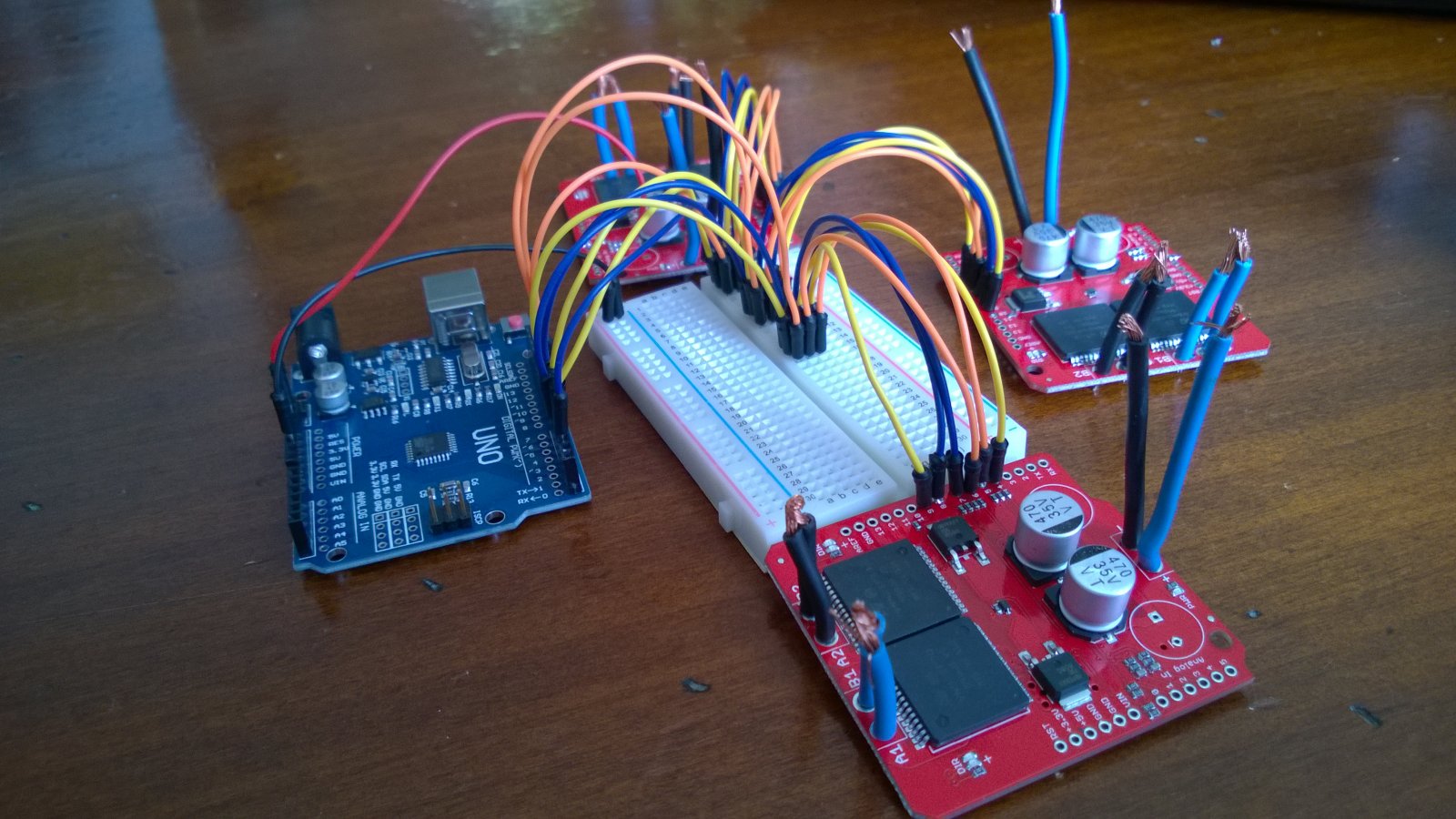

    Hi everyone guys! Is this the right place to ask a question about an issue with SMC3?
    Sorry for not being so present, unfortunately too many hobbies and not so much time..I will update my simulator thread asap.
    However, let's arrive to my question: after successfully using the RacingMat 2DOF code I decided to try SMC3 code to move my 3DOF rig (thanks RufusDufus for your precious work).
    Here's my actual configuration: WP_20150503_13_20_22_Pro[1].jpg WP_20150510_20_33_36_Pro[1].jpg
    an Arduino Uno with three MM (one for each motor). I'm using the breadboard to prevent cables disorder (could this cause issues?).
    Well, which issue you may ask..actually nothing moves.
    I strictly followed the guide in first page, I've been checking wirings, soldering, pots, power supplies, motors etc all the day but, when increasing the PWMmax, nothing happens.
    Although SMC3util seems to work quite well, could this malfunctioning depend on the driver I'm using to drive my chinese Arduino (http://wiki.tuttoameno.it/index.php/CH340USB)? It is like if the Arduino and the MM cannot communicate.
    Or is there something wrong in the wiring (is it mandatory to connect the 5V for pots also in the MMs for example?).
    Here is a video () in which I try to explain the malfunctioning (sorry for my bad english :blush).
    Thanks in advance guys for your help. Really!:cheers
    Marco

    MMs have to be connected to the Ard on the 5V and GND line.
    PS: The wiring ot the MMs seems to be correct (only the issue I have mentioned) though I cannot see the wires on th Ard. BTW the 5V red wire is really on the 5V output on the Ard? Hard to see from that perspective...

    @Overclockersmania.it : indeed, your motomonsters should share GND and 5V but it seems not to be the case...

  7. Overclockersmania.it
    Overclockersmania.it Member
    Oct 24, 2014
    99
    Cagliari, Sardinia
    20Coins
    +25 / 0 / -0
    You're welcome RacingMat! thanks to you for your code, it was really helpful at the beginning and worked without issues (and even without the +5v on the MM..:grin).
    Thanks a lot also to you Pit: pots are wired correctly as I've checked with the tester and got right values.
    I think I've also tried to link the +5v on MM to the pot (for one motor) but nothing happened.
    I will try again tomorrow, this time soldering the wire. Hopefully it will work..
    Thanks again guys! Stay tuned! :cheers
  8. Pit
    3,007
    30,501Coins
    +3,098 / 31 / -0
    Mate this IS impossible. W/o 5v the MMs can't be driven by any code. EDIT: @RufusDufus clarified that even without sharing 5v the MMs can work.
    This doesn't work, there is no 5V source on the MM but on the Ard.
  9. Overclockersmania.it
    Oct 24, 2014
    99
    Cagliari, Sardinia
    20Coins
    +25 / 0 / -0
    Sorry I meant that I didn't share the 5V and the GND pins between the Arduino and the MM.
    MM was supplied with 12V.
    I thought (but I've to say I missed this point in the datasheet) that the 5V and GND pins were intended to be outputs, that's why I didn't wire those pins on MM.
    Anyway in my rig (I may have a video somewhere) MM could drive the motors properly with RacingMat's code, finding the middle position and going ccw and cw till the desired position..maybe this was possible cause I just drove my motors through Arduino serial monitor, I haven't tried Simtools yet. Any idea of this strange behaviour?
    Thanks for the help Pit!
    Marco
  10. RufusDufus
    RufusDufus Well-Known Member
    Jul 21, 2013
    681
    Adelaide Australia
    16,357Coins
    +1,016 / 10 / -1
    Hi Marco,
    Below is the schematic for the MM. In the case of the MM the +5V is an input to the module however is only used for pull-ups on the EN signals. The board will work without it providing the source signal is driven high or has pull-ups at the source. So this is why it worked without the +5V. Even though it is not mandatory I would suggest you connect the +5V to minimise the risk of any noise generated in the cabling from the high motor currents.
    GND is typically required to be connected between any electronic circuits to provide "a point of reference" for the interconnected signals.
  11. RufusDufus
    Jul 21, 2013
    681
    Adelaide Australia
    16,357Coins
    +1,016 / 10 / -1
    Based on what I can see in the video it looks like the Windows SMC3Utils is communicating with the Arduino SMC3 fine. You can see at the bottom of the window it is processing close to 4000 PID calculations per second and the Rx Packets are changing both of which come from the Arduino SMC3 communications.
    One other thing to check is to manually move your seat (or just the POT) and see if the green line moves on the chart. This will confirm if the POT is wired up correctly to the Arduino.

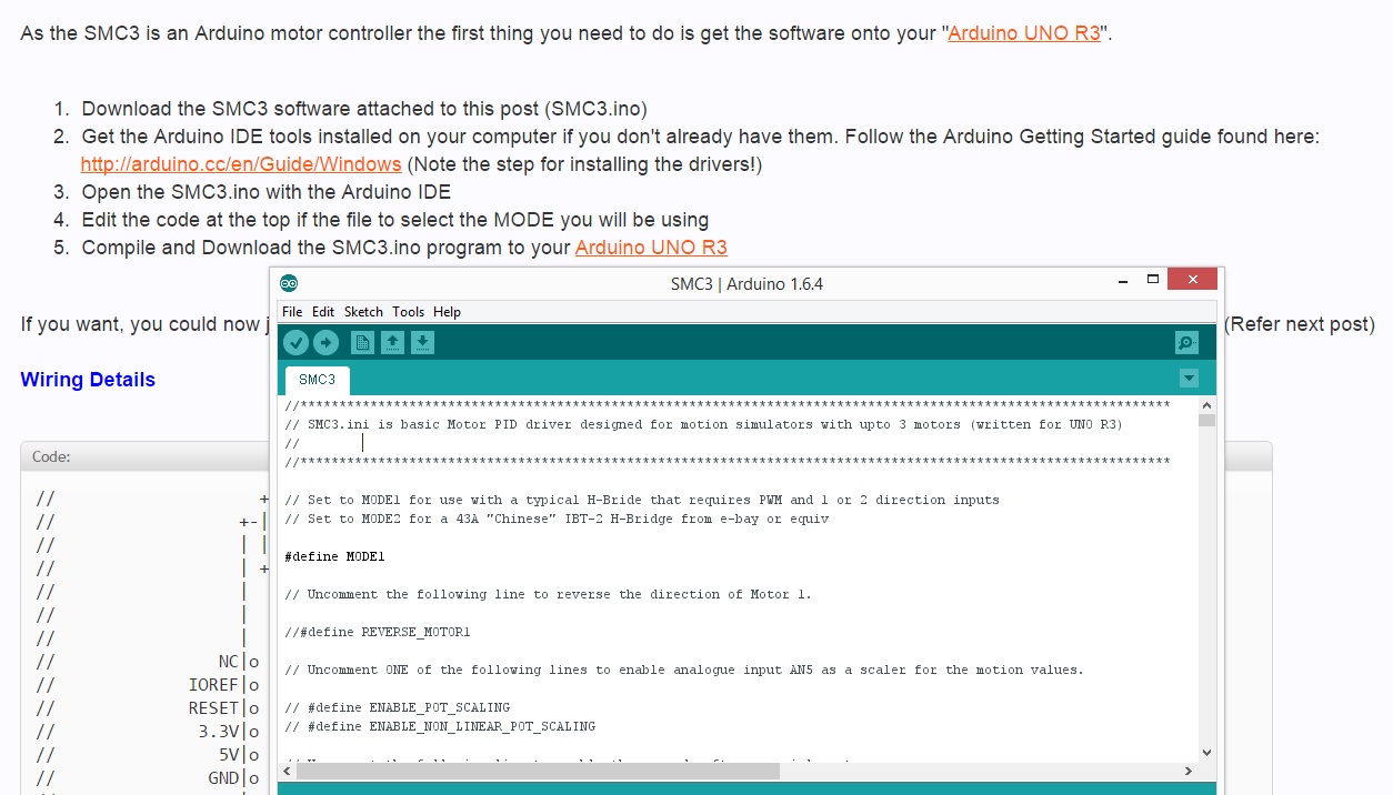

  13. mariano68
    mariano68 Active Member
    Nov 15, 2014
    574
    builder contractor
    Argentina
    3,339Coins
    +394 / 2 / -0
    2DOF, Arduino, 4DOF
    Excuse my total noobness, I have zero electronic background so this will take me a lot of time to get it right without burning anything, I promise I wont ask again :oops:
    I don't understand what you mean with this :
    "4-Edit the code at the top if the file to select the MODE you will be using"
    is that a typo? Anyway, could you tell me what I have to do to set mode1, or is it already set by default?
    Thanks anyway!
    I think I can answer myself
    Edit: Means "Of" the file, and also the mode 1 is on by default as it is uncommented.
    Sorry, too afraid to do something wrong :p
  14. RufusDufus
    Jul 21, 2013
    681
    Adelaide Australia
    16,357Coins
    +1,016 / 10 / -1
    That is correct. :cheers
  15. Overclockersmania.it
    Oct 24, 2014
    99
    Cagliari, Sardinia
    20Coins
    +25 / 0 / -0
    Thanks RufusDufus and Pit for your help.
    I haven't had time till today to work on the sim so sorry for this late answer.
    However, today is a beutiful day! Pluggin' in the 5V and GND to the MM caused the sim to finally move!
    Thus I can say this was the reason why the rig didn't move.
    It still seems a bit strange to me but..who cares? IT MOVES!!!
    Pit your talking wasn't so rubbish in the end..:cheers

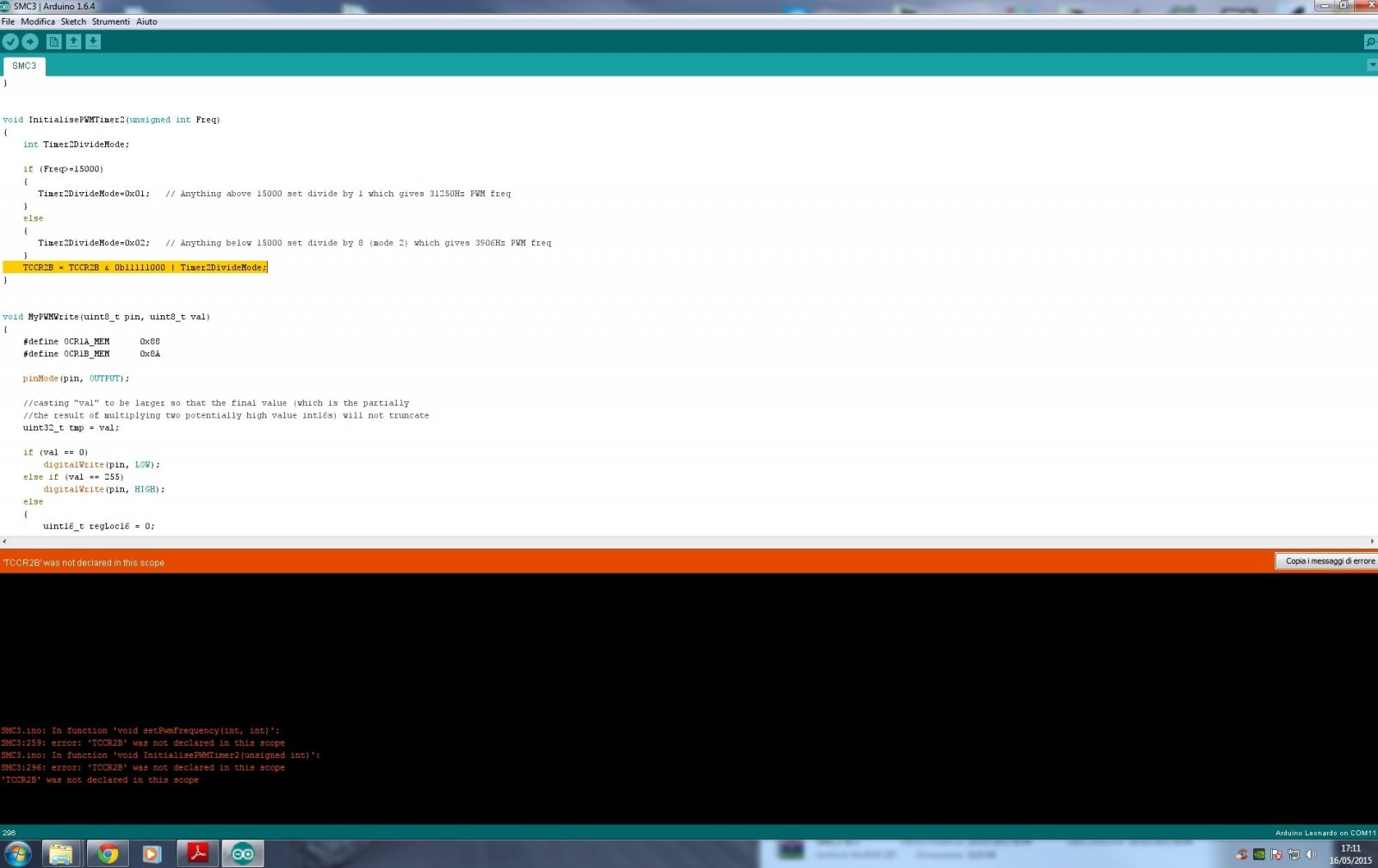

  16. dualclick76
    dualclick76 Active Member
    Mar 23, 2015
    163
    italia
    11Coins
    +40 / 0 / -2
    first wanted to thank, I ask you my problem, I tried to follow step by step instructions and code event To use SMC3 SMC3 utility. when loading the code Arduino I get this error what should I do?

  18. RufusDufus
    Jul 21, 2013
    681
    Adelaide Australia
    16,357Coins
    +1,016 / 10 / -1
    Hi, Those are default registers that should be defined in the built in Arduino IDE libraries.
    Have you selected the Arduino UNO board in the tools menu before compiling/uploading?
    The only other thing I can think of is to reinstall the Arduino IDE?

  20. dualclick76
    Mar 23, 2015
    163
    italia
    11Coins
    +40 / 0 / -2
    thanks for answering my RufusDufus Arduino is "Arduino Leonardo" card very similar to arduino one
