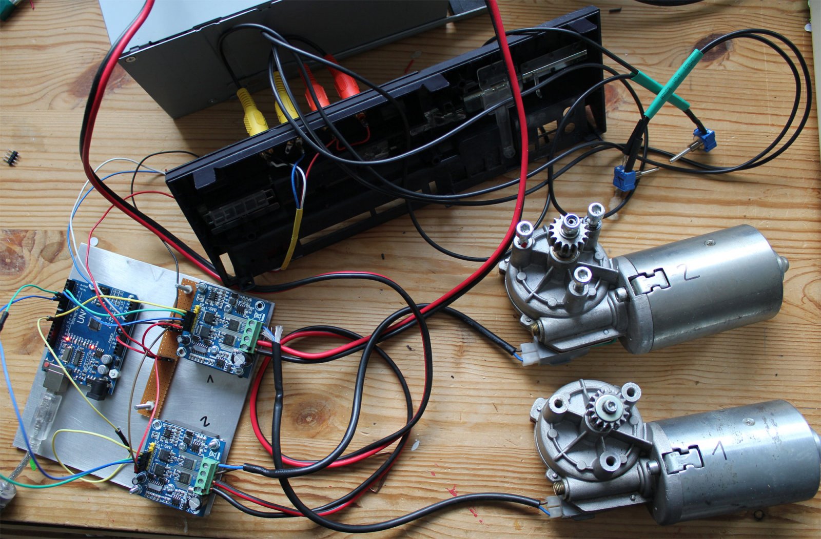

    Here we go, proof of concept , mode2 as described. (The black thing is the front panel of the PC where it all goes later ;-) )

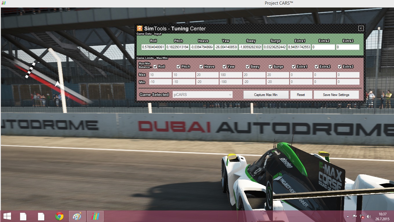

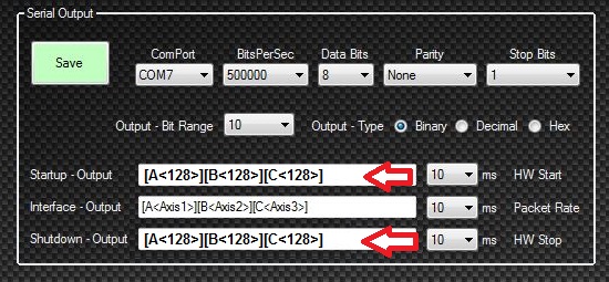

  6. lcturkey
    lcturkey Member
    Jan 5, 2015
    46
    163Coins
    speedy my problem is that simtools doesnt send any data to arduino. when I try it on winutilty it works fine and send data to arduino

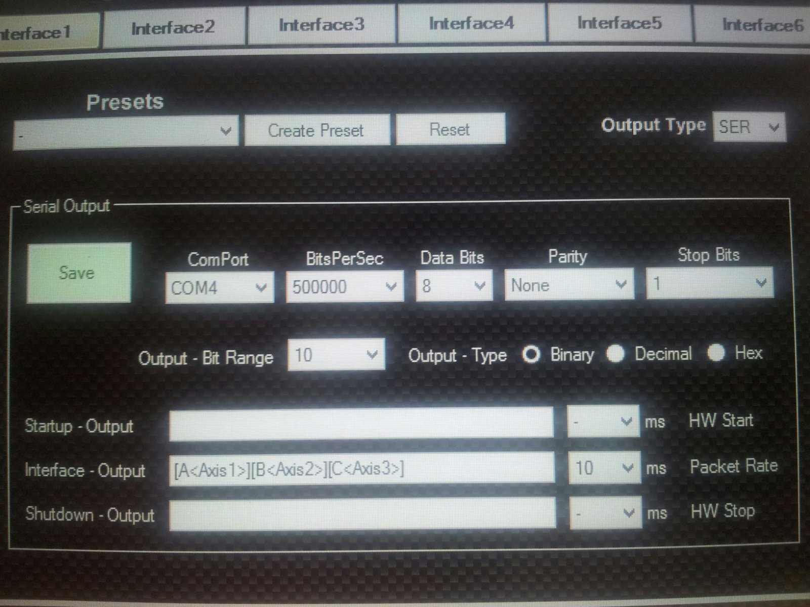

    @lcturkey post screenshots from game manager's settings so we can help.
    you have to run game engine with SMC3 utils closed.
    is com port the right one in game manager interface settings?
    have you made a profile for testing(the default)?
    whats your regional settings in widows?
  8. lcturkey
    lcturkey Member
    Jan 5, 2015
    46
    163Coins
    yes Smc3 is closed and com port is right. when I try output testing on game engine , I click to eturn on tx led is on but rx led doesnt work. what do I have to check in regional settings in windows ? My language on computer is turkish.

    @lcturkey ... mmmm correct settings :think...
    And I guess both Rx and Tx leds will normally work with SMC Util.
    as it is acquiring data to be displayed on the computer screen .
    But not like the SimTools as it only sends data ...
    I don't know if they are correctly named on the cloned Arduino but logically with SimTools one of them will stay OFF ...
    correct me guys if I'm wrong !!!
    Sorry to ask a silly question ...
    What is the "eturn " ?
    Did you press SMC3.JPG in the SimTools ?
    It seems like you didn't make a profile for testing yet ... please confirm !

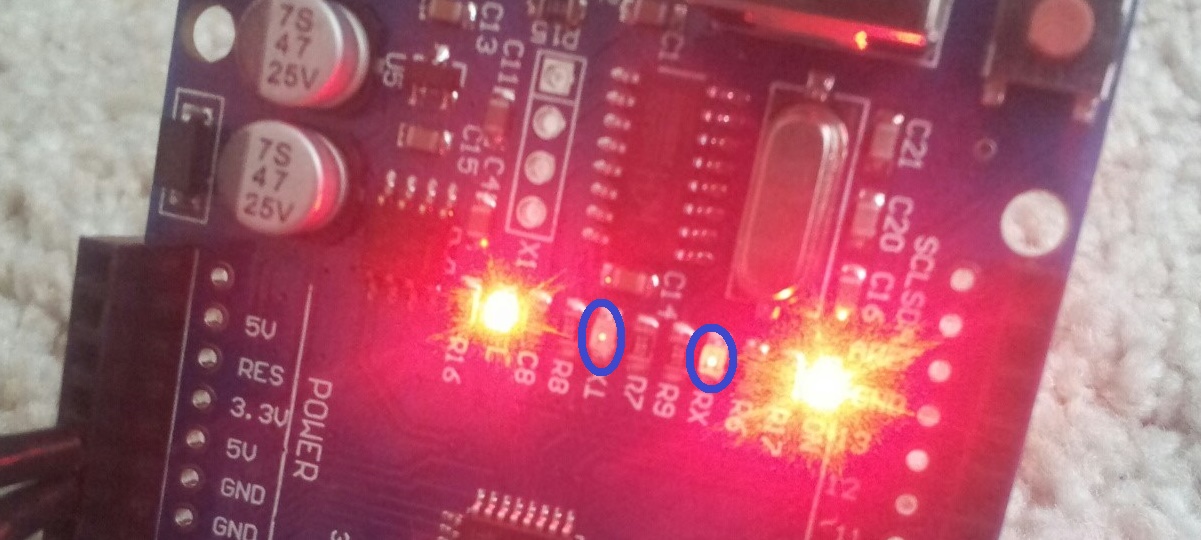

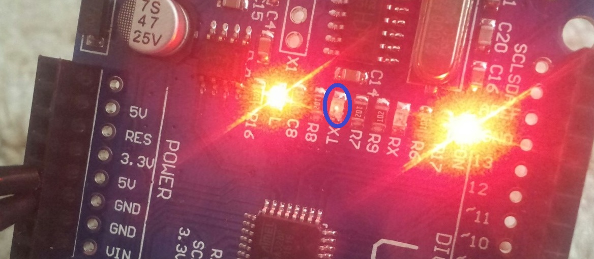

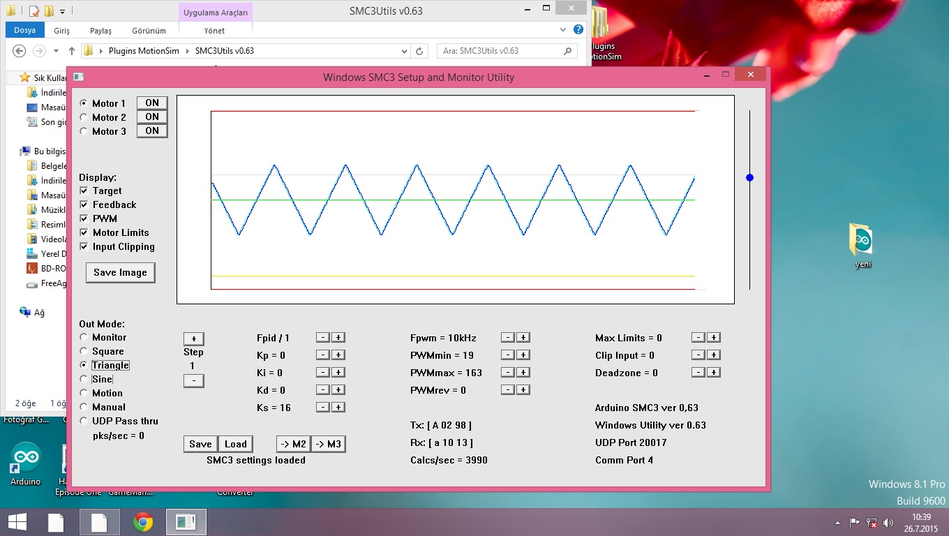

  11. lcturkey
    lcturkey Member
    Jan 5, 2015
    46
    163Coins
    Speedy sorry it was turn on button in output testing. Yes I pressed Save button and make a profile I can seee Game Engine reads the data from Game but it doesnt send the data to Arduino just TX led is on and the others is off. I think my arduino is clone and it is Arduino Uno, not R3 do you think the problem is about my arduino ?
    here is my screenshots and photo of arduino
    this photo taken while game engine and game working. ( Just TX led is on ) SimTools working.jpg
    here is the photo while SMC3 Utilitys working ( TX and RX led is on and getting data )
    Game Manager is running.

  14. lcturkey
    lcturkey Member
    Jan 5, 2015
    46
    163Coins
    @insanegr my simtool version is 1.3 I tried regional settings it didnt work. Can you send me your arduino photo while communicating with simtools. I am thinking about to change Arduino uno to Arduino Uno R3

    please confirm with us here about the Rx and Tx leds are working while using SimTools ... are they ?

    @lcturkey i'll take some pics when i get home tomorrow, meanwhile can you confirm some things
    1. do you have motion in SMC3 utils ?
    2. have patched and repatched the game ?
    3. have you configured game profiles in game engine under axis assignments - game list ?
    4. what game are you trying ? i see you have pCars did you look here http://www.xsimulator.net/community/threads/project-cars-plugin.4780/page-3#post-77445
    5. have you tried an other game?
    send a screenshot with your axis assignments settings with the game's game profile you are testing
  18. lcturkey
    lcturkey Member
    Jan 5, 2015
    46
    163Coins
    Thank you @insanegr
    1. My motor driver blow up so I wait for the new one so I cant try motor moves on SMC3 utils but everything looks normal when I try to send data.
    2. Yes I patched the game
    3. I configured the game profile
    4. I tried pcars, euro truck simulator, No limits roller coaster but no was was sending data to ardiuno :(

  20. lcturkey
    lcturkey Member
    Jan 5, 2015
    46
    163Coins
    hi,
    today I bought a original uno r3 and tried it it is same not comminicating with simtools. please someone can corfirm that when it is communicating both rx and tx led is on ?
