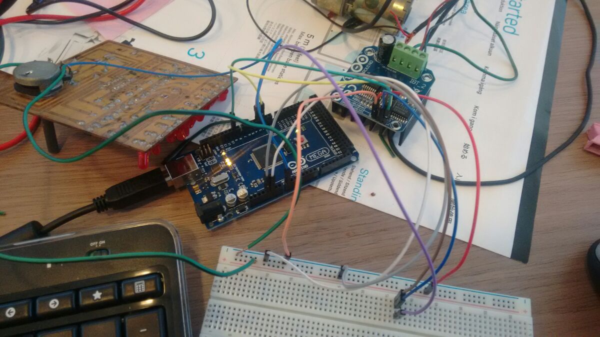

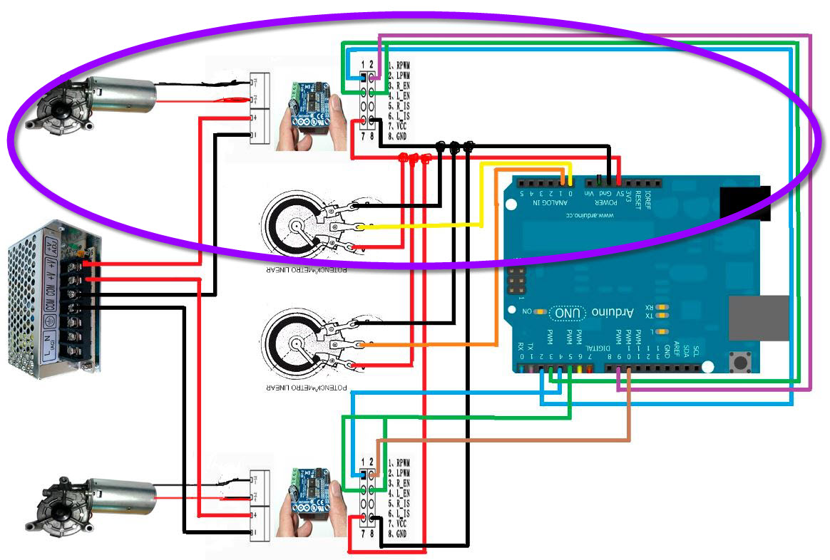

    Hello!
    I followed the tutorial and set up SMC3 in arduino for the H-Bridge (setting MODE2 inside the code) but i am not able to start the motor! I just connect one motor to test via SMC3 windows tool.
    I have the setup attached. The circuit image is also attached and is the upside of the example. What is going wrong?

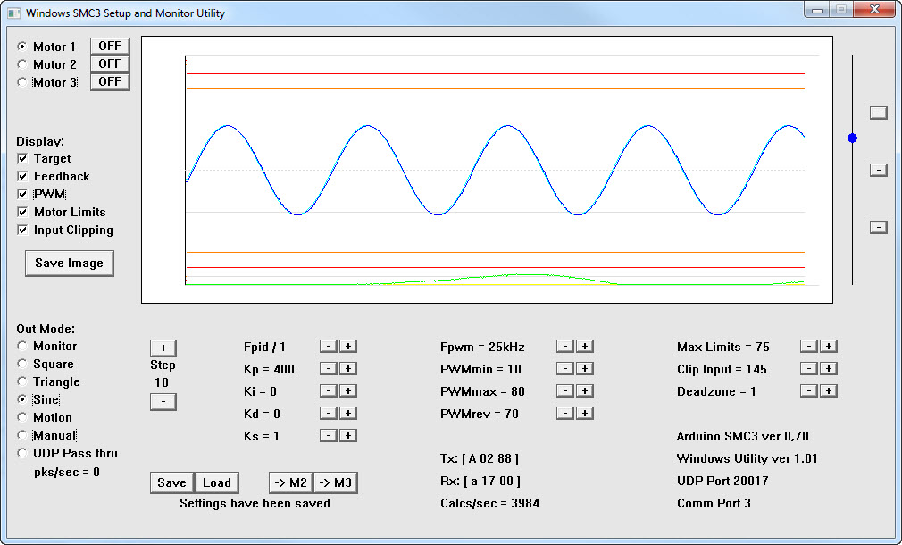

    I turned on the motor and repeated the set up procedure.
    But getting same result : no motor running (
    I attached the new Utility setup. Remarke: the "Max Limits" must no be upper than 65 if not the Motor 1 "ON" buttpn in the left corner on the top, go OFF.

    There is something wrong with the potentiometer or the wiring to the potentiometer

    If i twitch the potentiometer, the Feedback variates as the attachment shows.
    Im using arduino mega 2560 tho, it should be not problems with the code right? The data of the potentiometer is conected to the arduino in A0 analog input. Then i have a protoboard to the put the circuit togheter. I attach a very good photo (lol), can sketch up the circuit if still not working

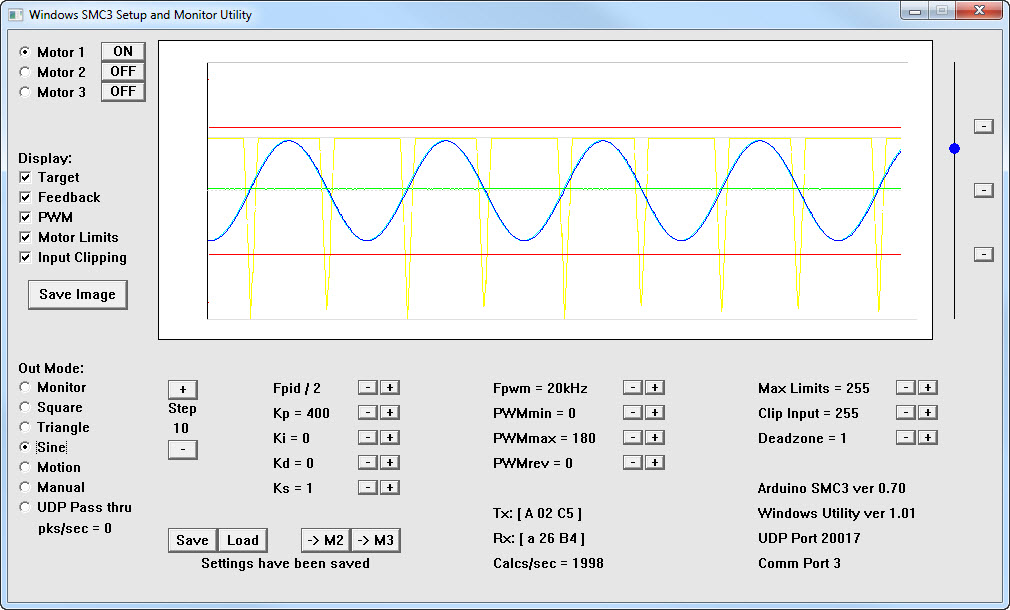

    Hello!
    I'm facing a strange issue with SMC3 running in Mode2 with just one motor attached as motor 2 through 43A IBT-2 driver and Arduino Uno: after opening the windows application and running any motion command, sine wave for example, everything works fine for 5-10 seconds and then motor halts.
    Yellow PWM graph keeps being generated, but nothing moves until I either reset Arduino or close/reopen the Windows application. Resetting logic power to the motor driver or power to the motor itself does not have any effect.
    What could it be? Can it be related to the fact that Arduino and motor driver logic are powered through USB from laptop?

    Yes that looks like it is running correctly. I note that you are using a Mega, I've never tested on this and never got round to checking the specs to make sure all is the same - although I can't think why that would be a problem.
    It is most likely a wiring issue or a problem with the IBT. Recheck all wiring and make sure it is secure. You can make a simple test probe using an LED in series with a 1k resistor and some wires. Connect one end to ground (make sure LED is correct way round) and probe the signals with the other end. LED will light when signal is high. Just be careful not to short anything.
    Note the motors switch OFF when the green line moves outside the red lines. They will switch off if there is noise on the pot wires and even one sample is read outside the range. The pot needs to be inside the valid range when you power up. @Grigory have you checked this also?

    Thanks, I checked that. The corresponding motor button says "ON". It works fine for several seconds, sine wave target is followed quite closely. And then all of a sudden the motor just stops.
    Upon restart of the Windows application the motor moves to the middle of pot range and holds still until I run any of the movement commands. Then it again works just fine but very soon stops.

    Try first Kp=200 and PWMmax=100. Then raise PWMmax up to 180. If no issues then raise KP until the motor stops (eventually).
