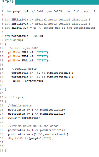

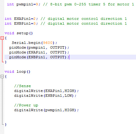

    I tried the first attached code (name 6), just for testing, and the motor starts running with the same circuit as the first page tutorial says.
    Now, analyzing the SMC3 code, i tried the second attached code (name 7) but it does not work. The "portstatus &= ~(1 << PIN_NB);" and "PORTD = portstatus" will disable the specified pin, and also there is a sentence that enable the pin, as if u write the sentence "writeDigital(PIN_NB, LOW)" and viceversa. Any idea why this sentences are not working? kinda lost

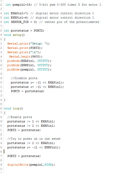

    First, the attached file (first sketch) attached above (file name: 6.jpg). The motor runs, meaning the circuit is fine (i think). The circuit is the same as the first page of this thread says.
    The second attached file above (file name: 7.jpg, re-upload in this answer). The motor dont run, and the code i wrote there is based on the SMC3.ino code, following the lines that activates the motor.
    Conclusion: I believe the sentences "portstatus &= ~(1 << EN_PIN_NB);" and "PORTD = portstatus" dont work as they should in my Arduino Mega 2650. (EN_PIN_NB is the pin ENAPin1 or ENAPin2 in the SMC3 code).
    The documentation (https://www.arduino.cc/en/Reference/PortManipulation) says that the PORTD can be used exactly like the sentence "digitalWrite(EN_PIN_nb, LOW or HIGH)" with less clocks cycles (i.e time)
    Im getting crazy

    I guess you could search the code and everywhere there is a:
    PORTD=portstatus;
    replace it with:
    digitalWrite(PD0, portstatus & 0x01);
    digitalWrite(PD1, portstatus>>1 & 0x01);
    digitalWrite(PD1, portstatus>>2 & 0x01);
    digitalWrite(PD1, portstatus>>3 & 0x01);
    digitalWrite(PD1, portstatus>>4 & 0x01);
    digitalWrite(PD1, portstatus>>5 & 0x01);
    digitalWrite(PD1, portstatus>>6 & 0x01);
    digitalWrite(PD1, portstatus>>7 & 0x01);

    EDIT: IGNORE THIS POST - I see you have two versions of 7.jpg
    You haven't defined or initialised pwmdirection1l and pwmdirection1r in the 7.jpg.
    You should also be initialising portstatus by reading the register first at startup.
    As you have your test code in loop the pwmdirection1l should be toggling very fast and you may have trouble seeing changes without a CRO?

    BTW: i got it working. "PORTD=portstatus;" does not work in mega 2560, replace it with digitalWrite(PIN_NB, LOW/HIGH); (aint tested "digitalWrite(PD1, portstatus>>7 & 0x01);" but the issue of PORTD is the new mega mapping for sure and not update of the PORTD return values).

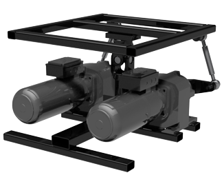

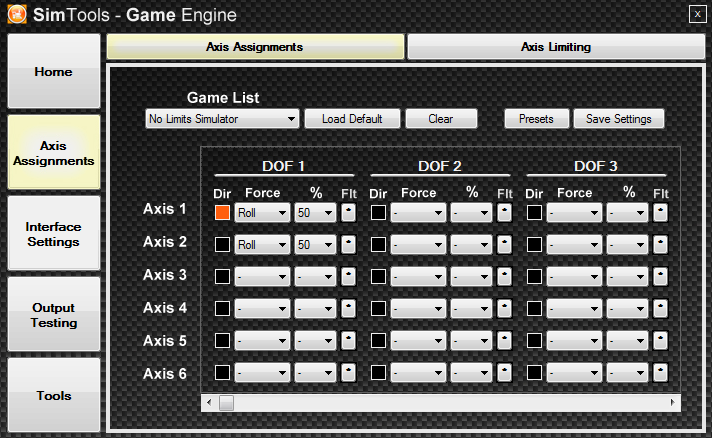

    Hey guys!
    I have a doubt, and I didn't find the answer anywhere here!
    I'm using the SMC3 with SimTools to move my 2DOF simulator (Roll and Pitch).
    I was testing the Roll and Pitch movements separately, so I put only Roll, using 50% on axis 1 and 50% on axis 2 like in the image (is this correct?)
    To test I used "Axis Testing". When I choose 100% on axis 1 and 100% on axis 2, it tilts all the way left, when I choose -100% on axis 1 and -100% on axis 2, it tilts all the way right (as expected).
    But when I test the Pitch movement (the same way), it moves just like the Roll instead of going forward and backward. I tried checking the red box (Dir) but it still moves the same way as before.
    Is there something wrong with my configuration?
    My simulator looks like this one in the picture
    And these are my Axis Assignments (one for Roll, and both I tried to use for pitch).
    Thank you for your attention guys!

    @LuisBranco - output testing uses the "Default" setup I think (or check there may even be an output testing setup? (been a while since I've done that). Ie I'm talking about the dropdown box that has "No Limits Simulator" in your screenshots.

    I don't think it's the case. I'll only be able to test that on the simulator tomorrow, but I tested the Default following the graphics in SMC and in both situations the blue line goes the same way (even selecting "Dir" to pitch)
    About the Output test setup, if that exists, I haven't found.

    @RufusDufus is correct, you use the Default profile for Output Testing. The Output Testing button is second from the bottom on the left side of the SimTools Game Engine window.
    It is helpful to fully explain the hardware you are using, how it is configured, and post a picture of your SimTools Interface settings.
    Do make yourself familiar with the SimTools documentation: https://www.xsimulator.net/simtools-complete-documentation/
    The Dir box controls direction, so roll will have one checked and the other not, pitch will have none or both checked.
    This is how your simulator should be configured to move in Output Testing: https://www.xsimulator.net/community/faq/which-way-to-set-simtool-axis-movements.230/
