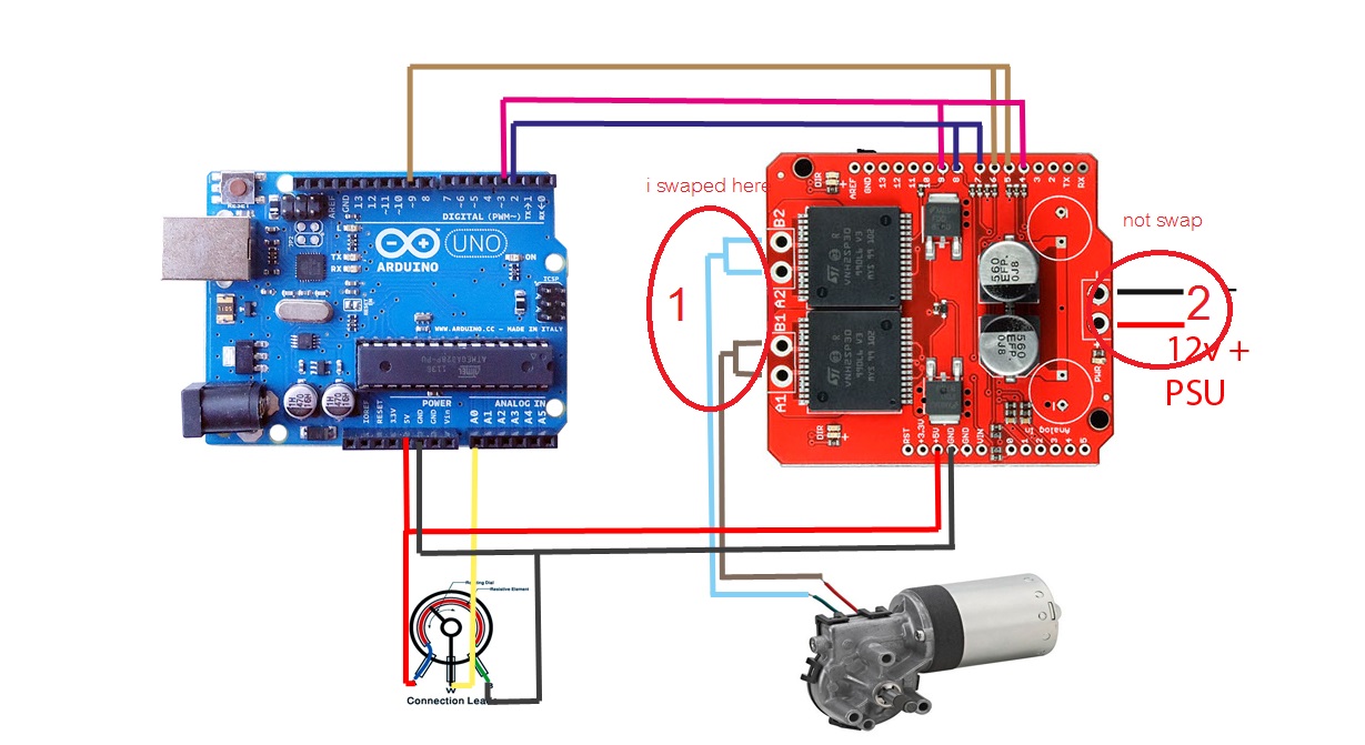

    i has replace my potentiometers with new hall effect pot. and i have some problem to make it reverse. i have change the motor wire (from monster shield to motor) but it still move incorrectly, did it can change some code for make it reverse ? @RufusDufus

    @Meawto Swap pos and neg at the motor.

    which wire i should swap ? i've swaped + ,- from monster shield to motor but not the wire from PSU but it's not working, this is corect ?

    What you have done is so far correct and it should have changed the direction of the motor. Don't! swap the PSU connections to the Monster shield. Do you have 5V and ground going to the right pins on the hall effect pot, it won't work if they are incorrect?

    i have change my new UNO and its work now.thanks for imformation :)

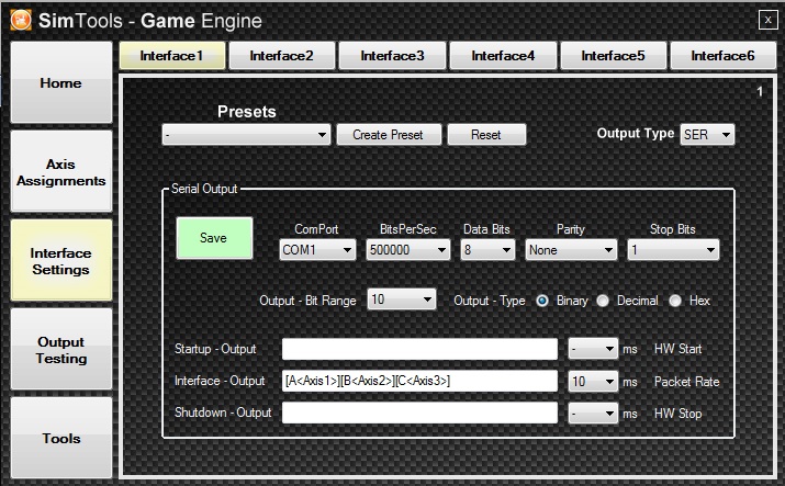

    Can anybody send me the correct Simtools interface setup for the current version of smc3?
    Or any link where I can download the presets for simtools?
    Thanx,
    George

    Simtools Setup
    Setup for Simtools is very straight forward:
    [A<Axis1>][B<Axis2>][C<Axis3>]
    Set for 10bit binary output
    Baud rate 500000 , N , 8 , 1 (10ms delay)

    Thanx for the answer. Like this?:
    Do I need Startup/Shutdown Output?
    Thanx for answer,
    George

    That looks correct to me. As long as you have the proper com port it should be good.:thumbs
