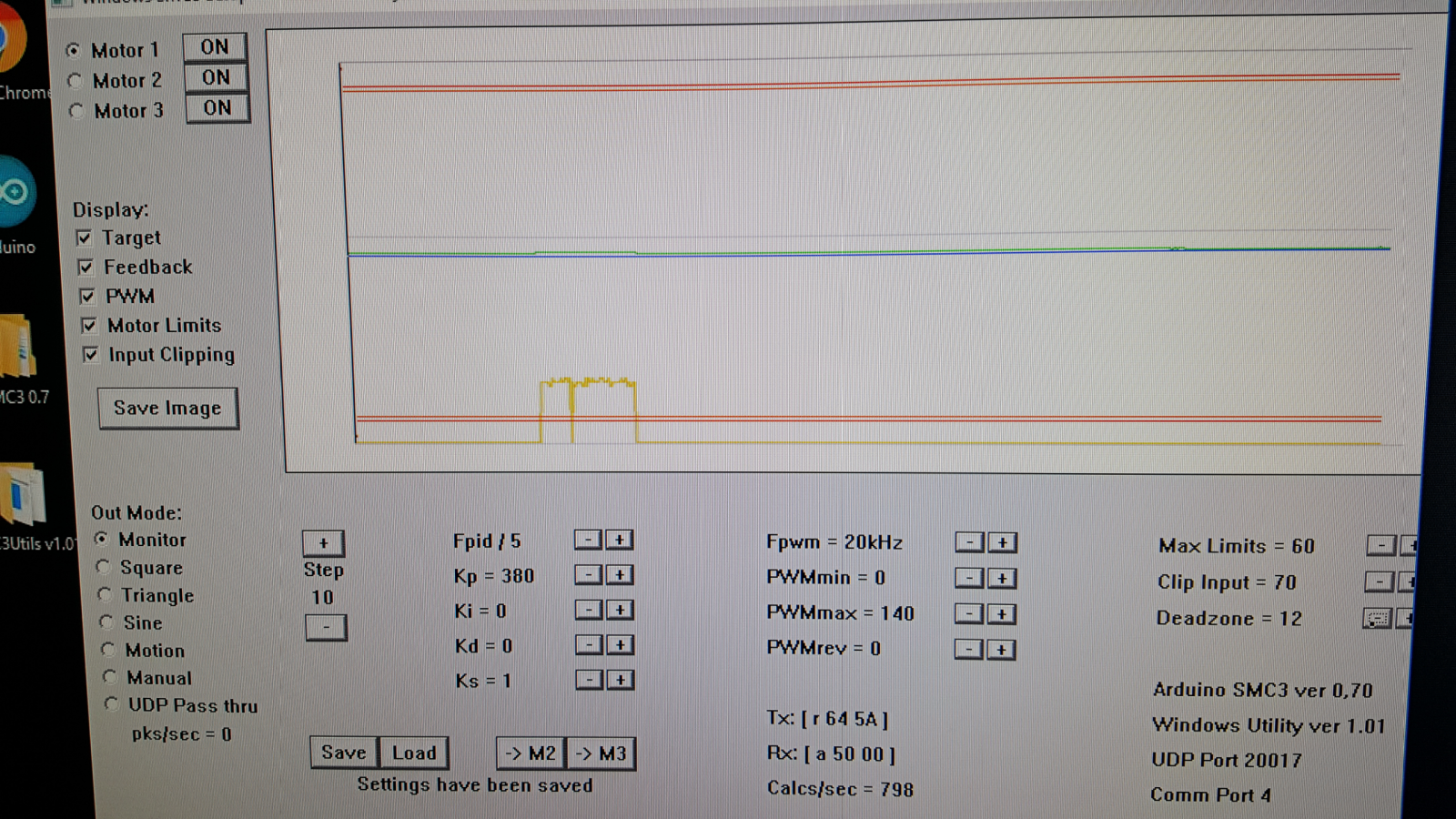

    Hello guys, i have a problem: since I switched from Noname code MM to SCM3 code I can not feel the movement changed Delka able to help me?
  11. Pit
    3,007
    30,510Coins
    +3,098 / 31 / -0
    without any screenshots and zero information about your settings nobody can help you really...
  12. Pit
    3,007
    30,510Coins
    +3,098 / 31 / -0
    Hard to see (bad video quality and I was only over looking it), the Ki and Kd settings should be 0 (zero), from there you start your tests. Ks should be "1". Otherwise check your wiring to to the potentiometers, eventually you have creeping current from the motors on the potentiometers

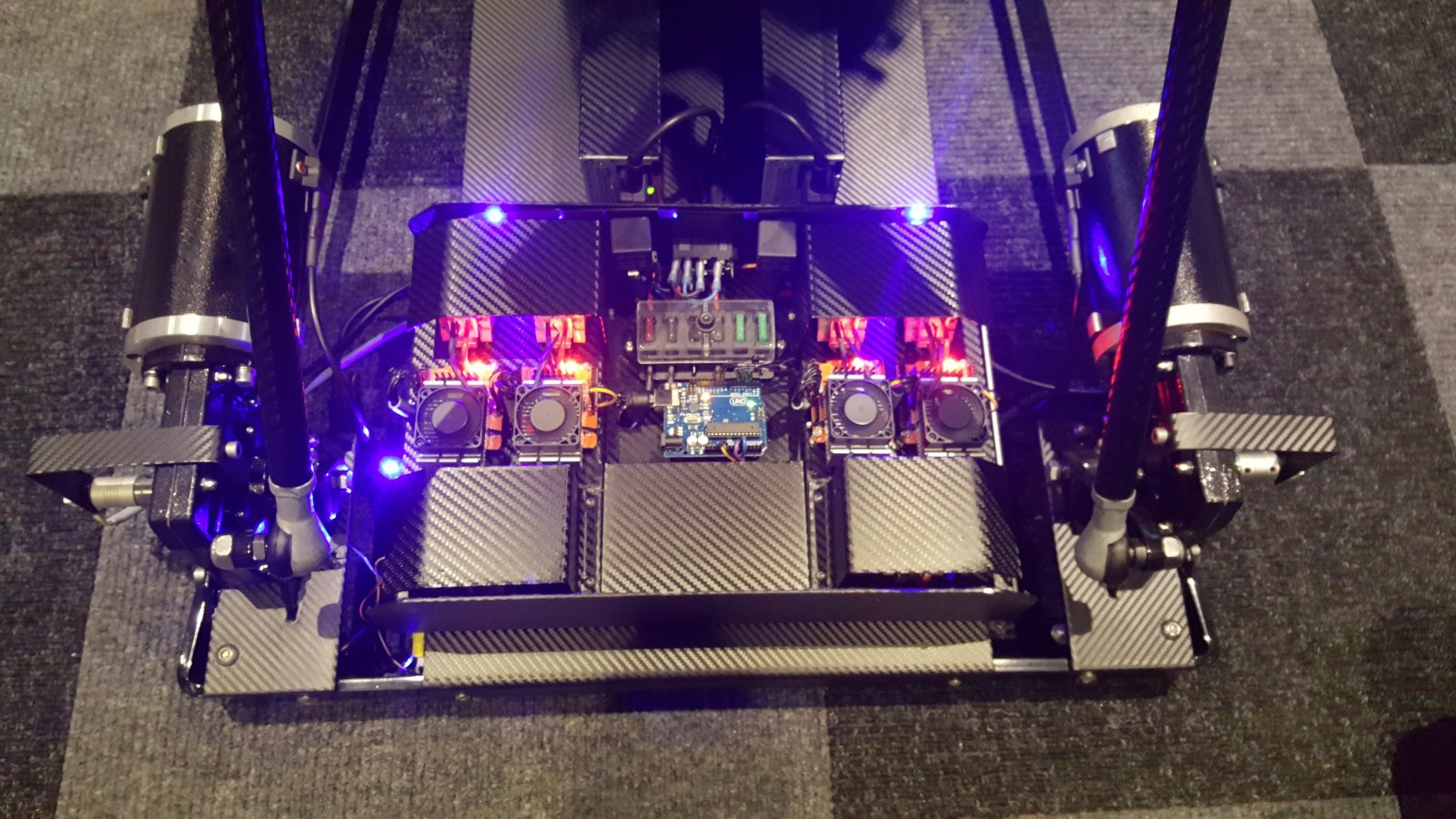

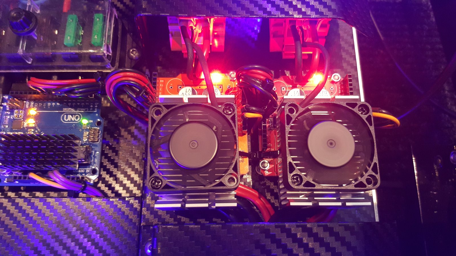

    Hi guys. ;)
    So. Been very pleased with the SMC3 code with 2x moto monster clones per motor in my 2 dof seatmover :)
    Love the way you can finetune etc.
    Perfect.
    But.. Im having a problem which is driving me crazy.
    Since I went from racingmats code to this I have had this issue. Never before the SMC3 code..
    Here goes:
    My Motor 1 is is acting weird.
    Everything works as it should.
    But motor 2 is set to a deadzone at 2 and works perfect.
    Motor 1 I need a deadzone at minimum 10.
    Else it gets hotter and hotter just standing in ready position?
    WHY?
    -My seat is wellbalanced
    Have tried switching pot meters.
    Tried switching the mcp4 200w 1:50 wormdrives from one to another. Still motor 1 which causes the problem.
    Have tried to mount other moto monster clones at motor 1. Still the same.
    Have mounted temp sensors at the heatsinks at the mm clones.
    And in ready position at a low deadzone the temp rises until the MM dies at last.
    If you start racing it actually helps a bit as the problem is while the rig is standby.
    The higher fpid the better the outcome is. can go by fpid at 1 though. Bjt the temp lowers the higher fpid.
    Must be acording to the MM's don't get as many positions with a higher fpid so that in a way dont stress them as much..
    When the temp rises it is mainly the resistors which starts to get hot, not the chip.
