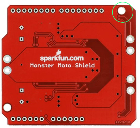

    First of all I would like to know if you have used metal nuts on the MMs?

    If there is no possibility of a short circuit try to switch the MMS. You said that you tried an other MM but not the MM which is obviously doing the job.

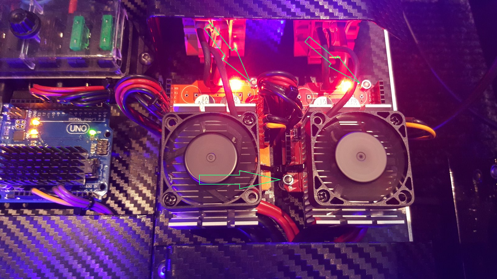

    I have used m3 nuts at the back and on the front?
    Already I know where you are going..
    Feeling a bit stupid right now :blush:grin
    BUT there are nuts at all 4 MM's
    And by inspecting a MM at the back the ground terminal id pretty close. but looks like it is isolated by a coat on the PCB?

    mate I have KILLED two MMs because of a creeping short circuit of pretty smaller metal screws - in comparison with your nuts notabene ......

    If you touch one of these two small metal lines you can be sure that is not the best thing you can do for your MMs :)
    One more hint: You have to measure both channel outputs separately if the power output is equal or similar to the other channel. If this is confirmed you can "double your MM burger", if not you will get on one channel higher voltage and this is resulting in creeping current from the MMs.
    Even if you said you checked all, I am sure there is more space for checking out more things. IMHO I say this from my own experience :)

    Exactly the marked spot you did is the one the nut have touched.
    Will give it a try later and tell how it went..

    Well.. First of all I tried moving the MMs away from the m3 nuts.
    - Still the same..
    Tried to use only one of the MM's.
    -Still the same
    Tried the other and still the same..
    My best guess is some noise causing those problems.
    When looking in the smc3 utility the yellow line in the chart is going more up and down than the "good one which is motor 2".
    Have tried with a new cermet pot.
    Still the same.
    I have ferrit corres mounted on the pots near the arduino. Plus I have ferrit corres mounted at the motors.
    Next up I will try wiring outside the controller box so the wires isn't placed near each other to 100% eliminate that noise could be a factor.
    The motor runs as good as the other and works when I switch them around.
    So that aint that either..
