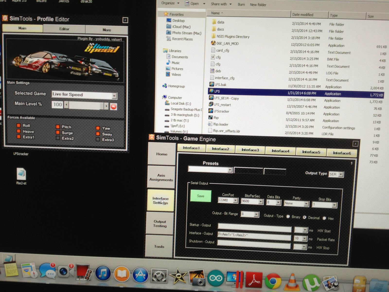

    Hi , I'm trying to connect this to simtools but I can I'm only using one computer is that ok or I need two before I use racingmat arduino code and everything worked ok only wanted to try this one because I feel that the code from racing mat was missing some feeling I didnt feel the acceleration/braking or the gears changing.
    with this code I can connect to the smc3 util but even there the pots are very sensitive in center .

    Yes this can be used with one computer. The best way is to use it just like any other Arduino code and just connect direct to Simtools. In this case you only need the windows SMCUtils to setup the Arduino parameters then you shut it down and run Simtools. Best getting this to work before trying other modes.
    To setup Simtools to connect direct to Arduino SMC3 use the following settings.
    SER output, with connected comm port
    500000 baud, no parity, 8 data bits, 1 stop bit
    10 bit binary output.
    Output string: [A<Axis1>][B<Axis2>][C<Axis3>]
    (Note you need to include both square and triangle brackets above)
    **** warning the pinouts may not be the same as other Arduino code - check first ****

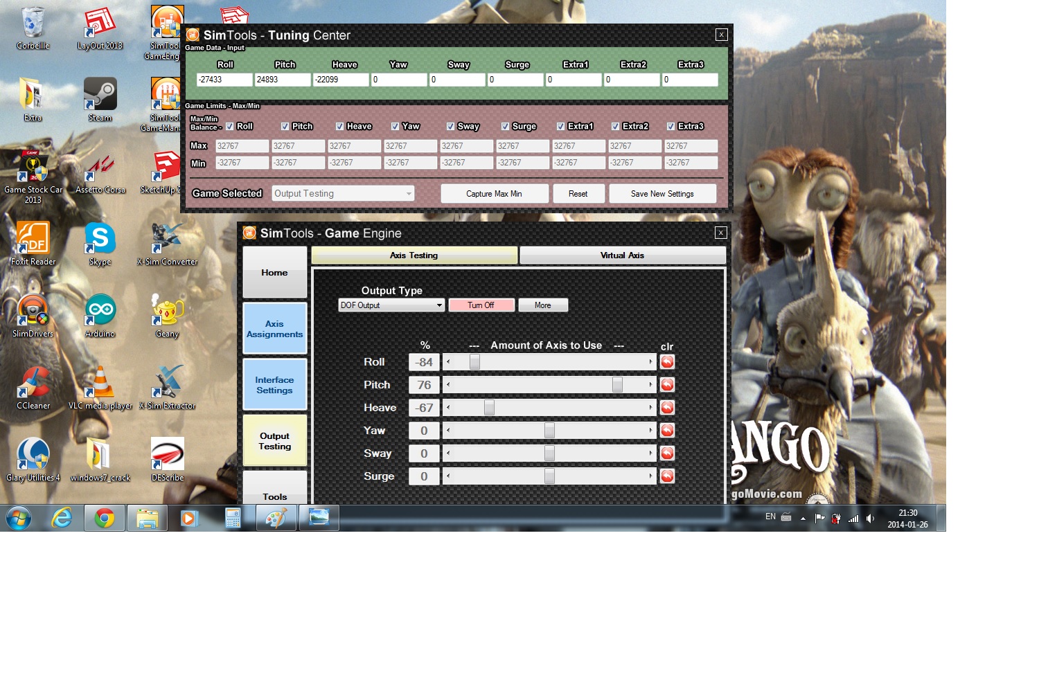

    You can setup various parameters in the Arduino SMC3 code including a deadzone and axis limits. Use the windows SMC3 utils to do this setup. Once happy everything is automatically saved in the Arduino. Shutdown windows SMC3 utils and run Simtools.
    If movement is too sensitive you can fine tune motion using Simtools tuning center.

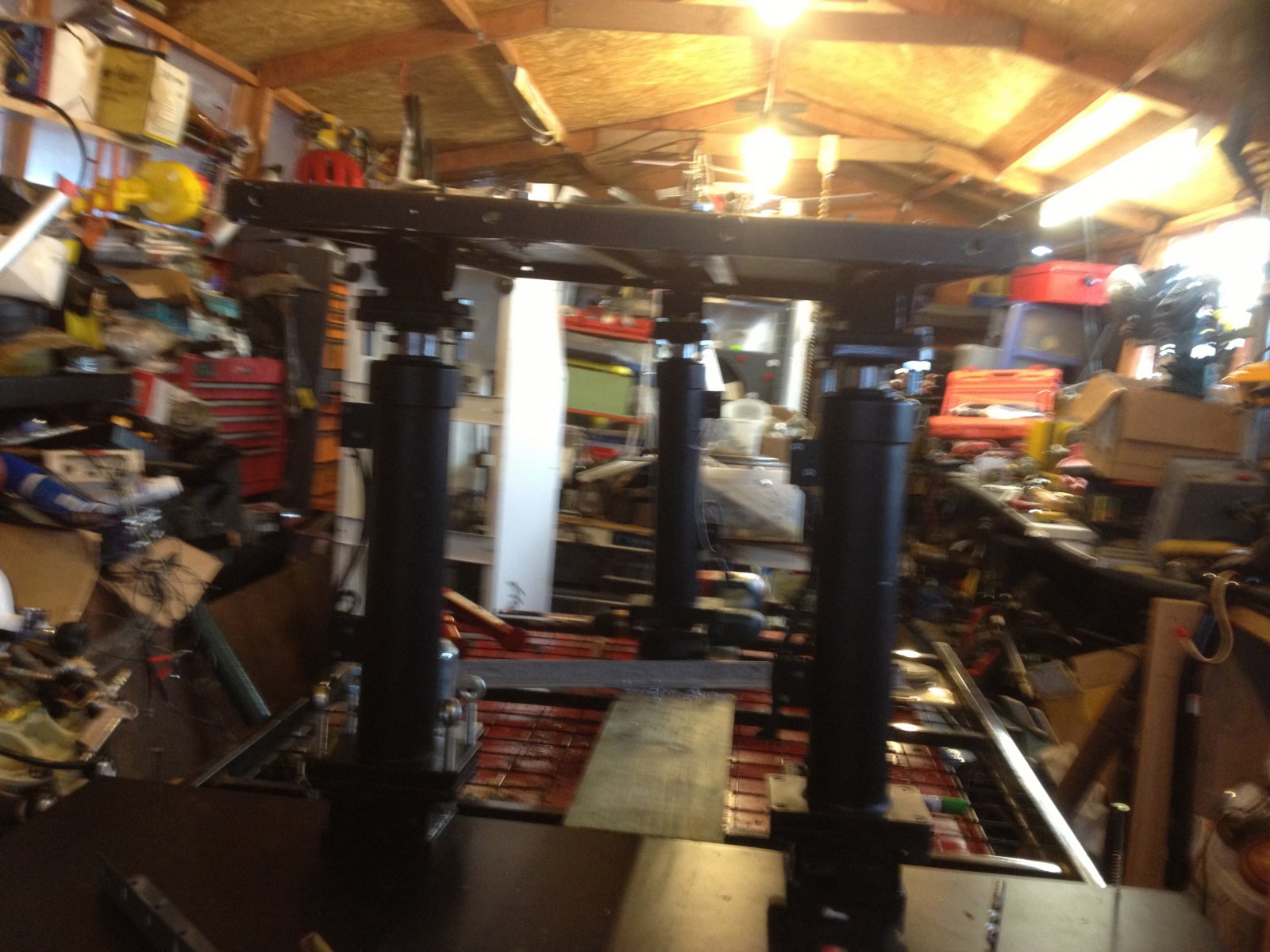

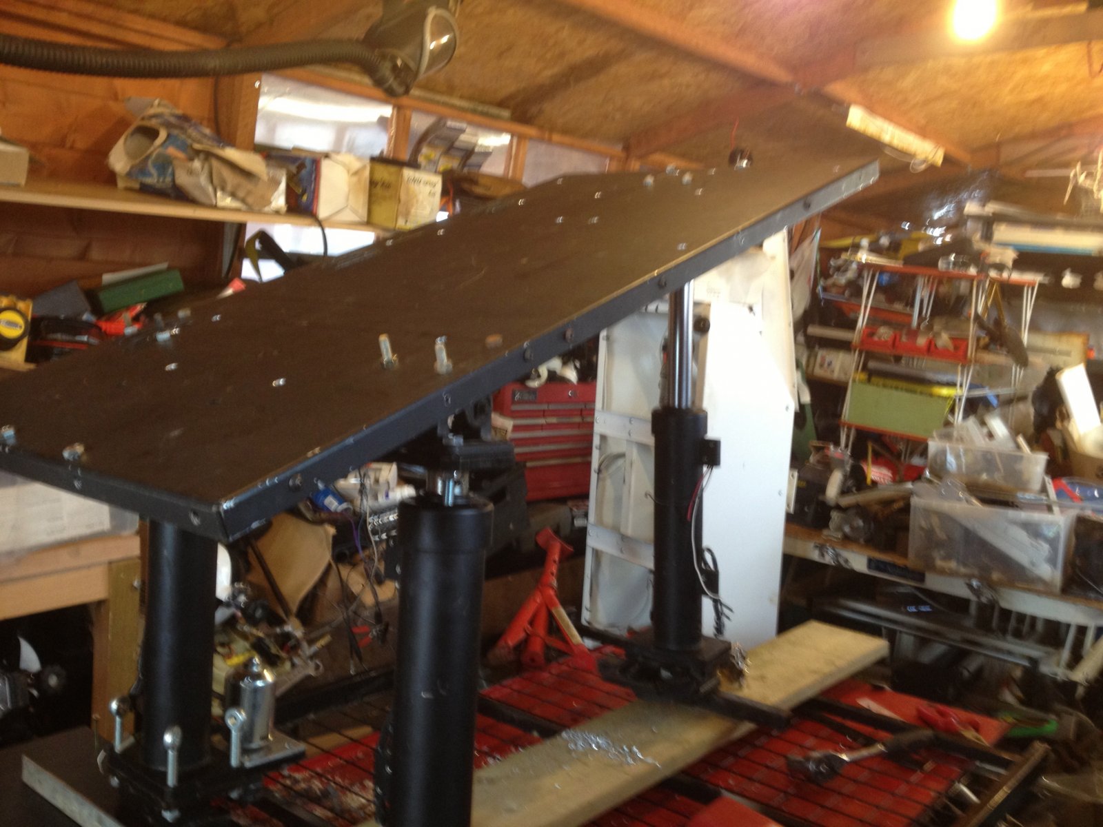

    hi thanks for servo sketch robbie i need to change to set up as the i think its the 301 simulator this i have looked at the sketch what should i put for the rear centre servo
    to add it to the the left and right
    const char kActuatorName[kActuatorCount] = { 'R', 'L' };
    const int kPins[kActuatorCount] = {4, 5}; // pins to which the Actuators are attached
    const int kActuatorScale[kActuatorCount][2] = { { 0, 179 } , // Right Actuator scaling
    { 179, 0 } // Left side Actuator scaling

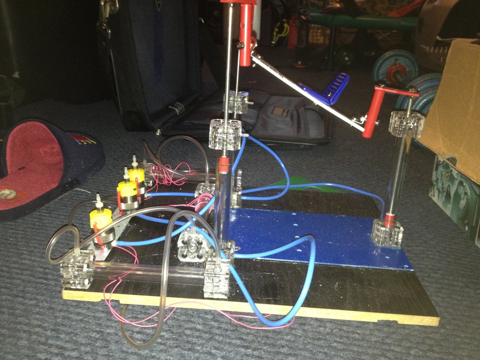

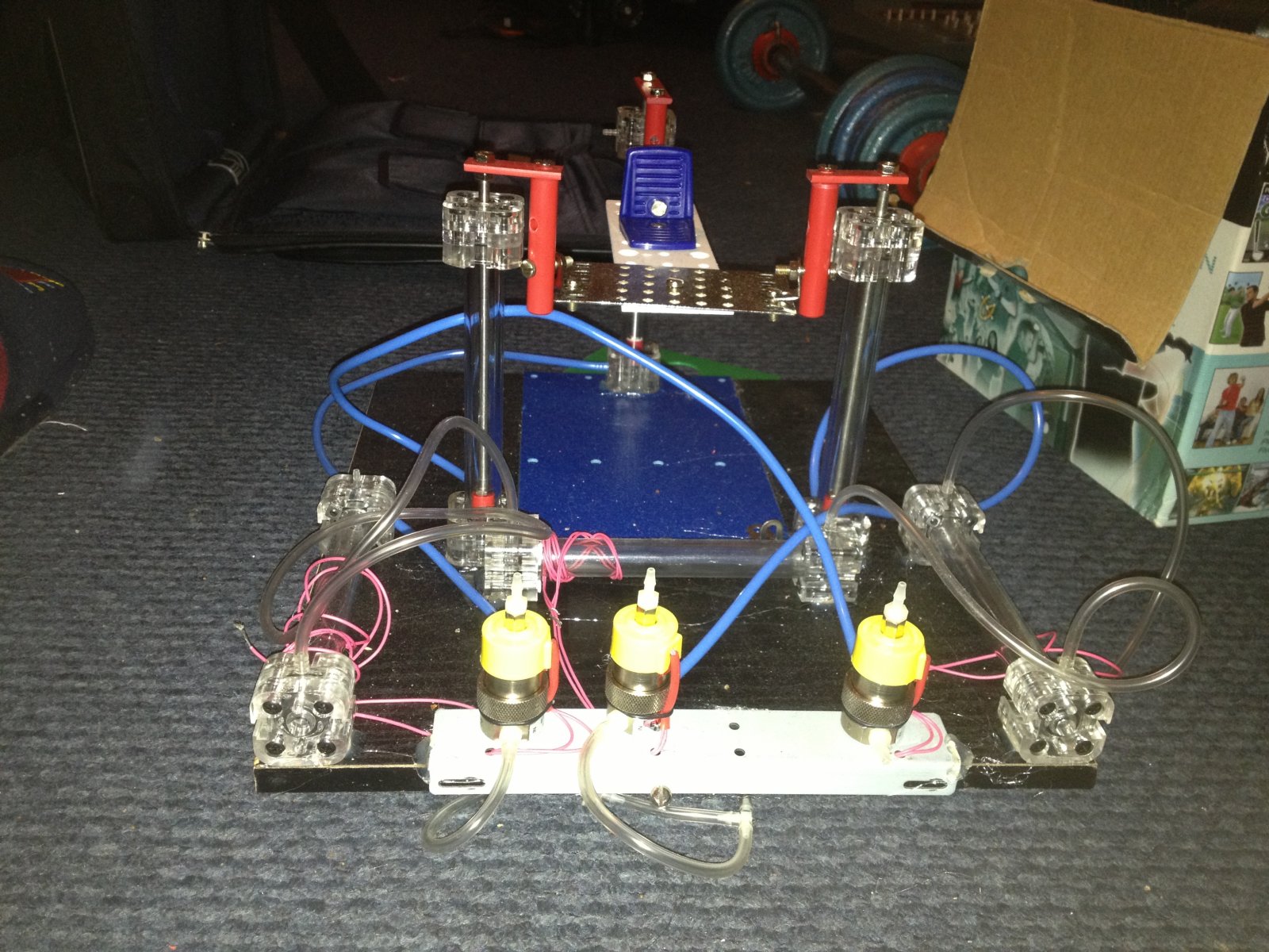

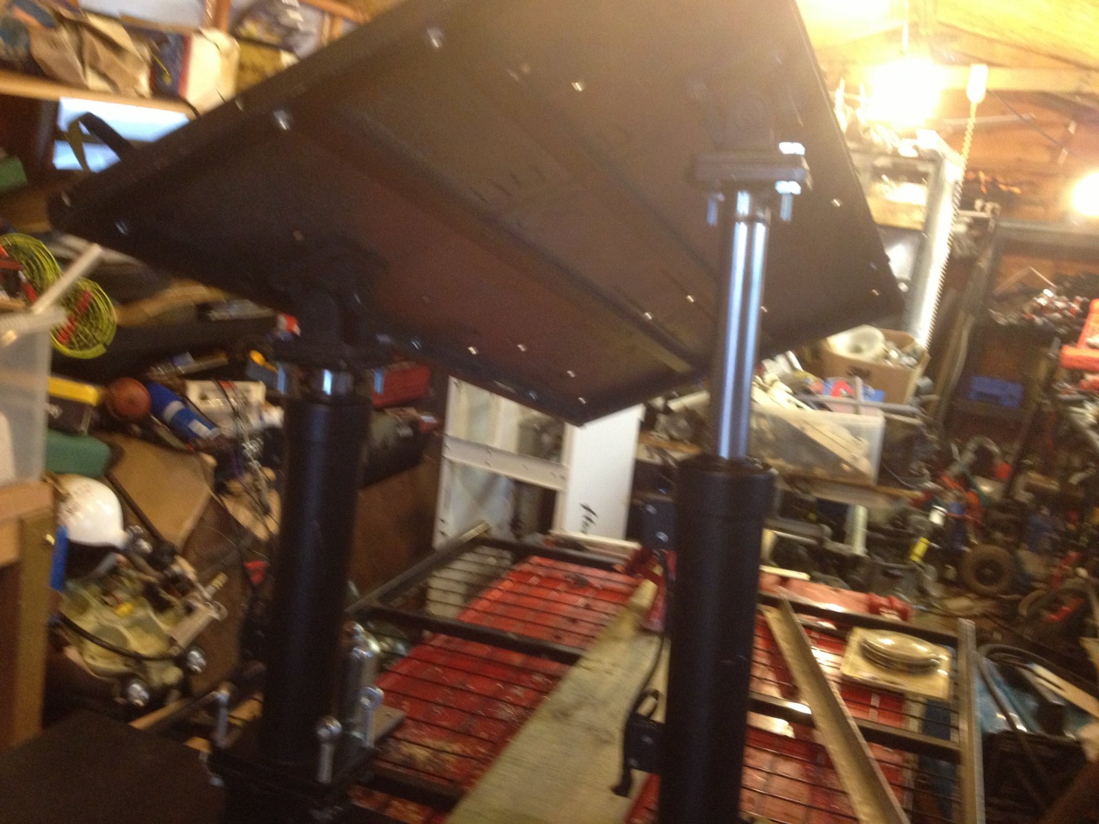

    }; i have set up all 3 motors today finally got them finished as you can see in the pictures i am using a hospital bed control just for testing what control 4 motors 24 v
    i only need to use the 3 of them two at front and one at the back as i will not be using tv using the oculus rift to keep down the weight i have put on a pic for the settings for robbie i need some help so close for testing

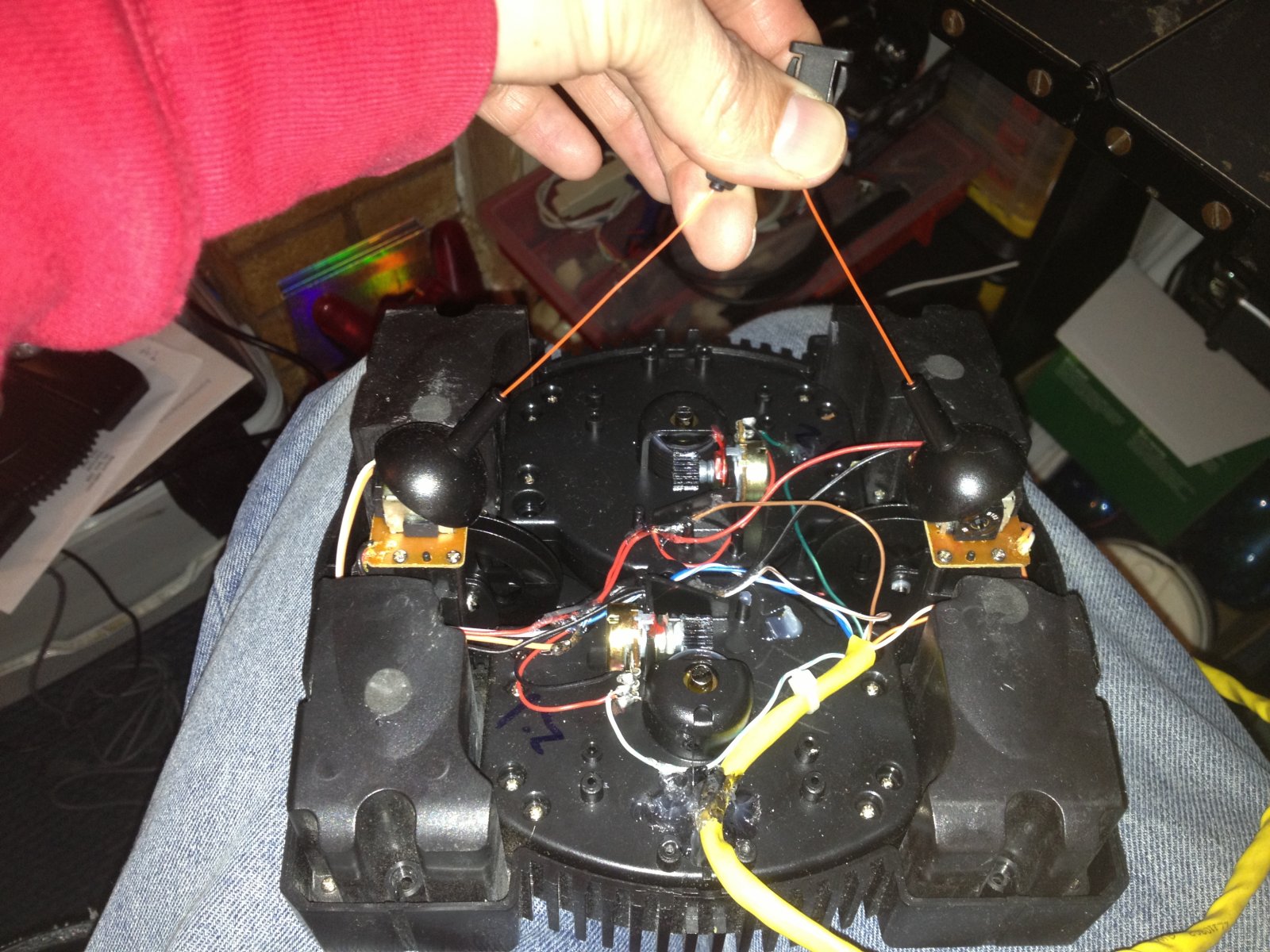

    just wanted to add got measuring pot value i have been playing with gametrack its a fight golf controller easily works with arduino its spring loaded save breaking pots and it good for liner measurement they are cheep to buy i hope this helps some one

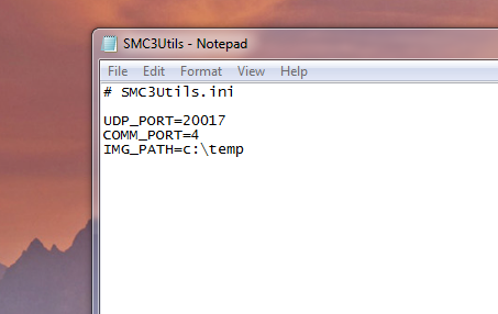

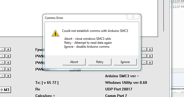

    I downloaded the SMC3 zip files but I am having problems with the SMC3utils v06 file. When I open the file and click "RUN" I get a message that says it was unable to connect to the com port. (pic#2) I am using Com #4 I went into the ini file and changed the com port from #7 to #4. (pic #4) That did not work, same message Is there something else I need to change to make this work?
  20. Historiker
    2,162
    9,214Coins
    +2,170 / 19 / -1
    Did you install SMC3 via the Arduino IDE? I know this might be a simple question but you never know....
