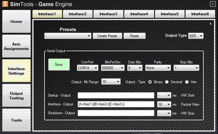

    Hi All,
    I just installed simtools V2, but the old settings not working with the system anymore.
    I tried to set the same interface settings as with 1.3.
    Did anyone installed V2.0 yet with smc3?
    This was my V1.3 interface settings:
  3. Pit
    3,007
    30,501Coins
    +3,098 / 31 / -0
    Interface Output MUST be now: [A<Axis1a>] etc.

    Yeah, that one got me as well when I first installed the Beta, lol. Pulled some hair out of my already balding pate.

    Thanx.
    Now its working. But.. the smoothing option is not working neither in the
    game manager output testing, neither with the games....some games unplayable in this way....

    If I recall you must use a "b" though instead an "a" for dof 7-12; thus its inclusion.
