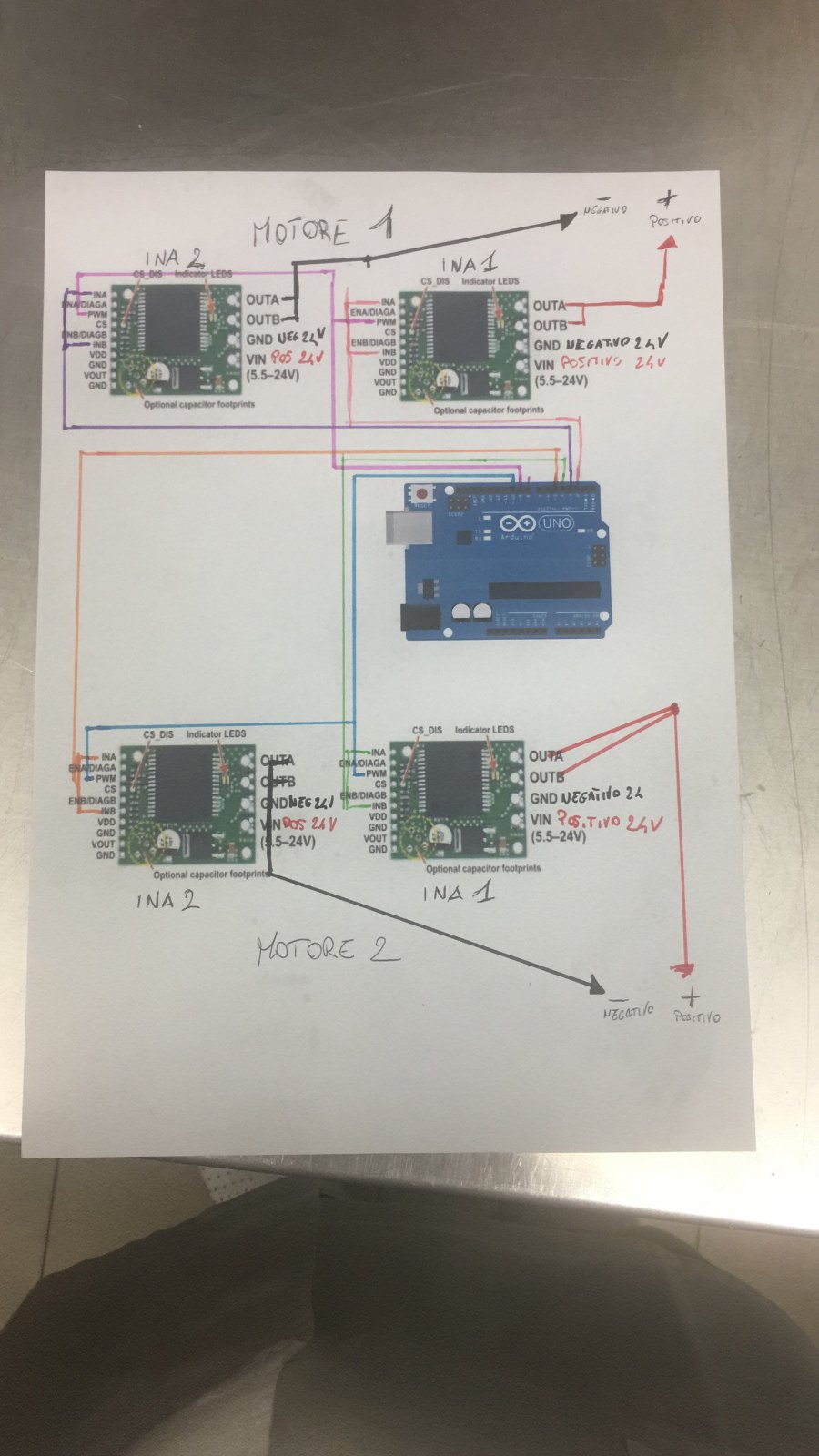

    Hi guys, I was thinking of putting bigger engines, the engine cards I use are the single VNH5019 "https://www.pololu.com/product/1451" on the forum I found the schema for the same cards but the most model Great "https://www.pololu.com/product/2502" I have reproduced a scheme but my problem now and on the feed I'm not sure it's okay as I did, I attach a blank picture that someone can help me!!
    Thank you guys!!
