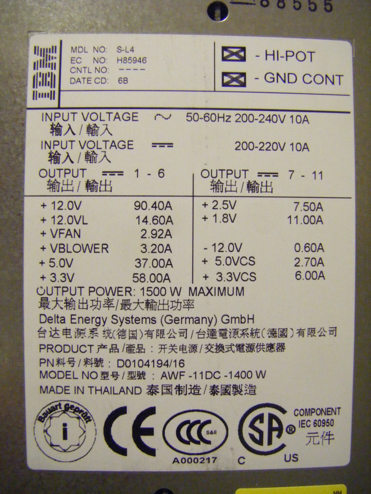

    I attached the datasheet of psu. As you can see there are output 12.0V 90.4A and 12.0VL 14.06A
    Wich is the difference beetween 12.0V - 90.4A and 12.0VL - 14.6A??

    just test with amperometric caliper. the psu shutting off in peak protection when motor need moore than 20A more or less. this happen over 85 PWMmax , triangle outmode and only one motor connect. So I tried to instal 2 resistor 10A each but the situation not change a lot. the PSU shutting off over 28A and 103 PWMmax and the same mode.
    The videos show the limit. over thes value PSU shutting off
    sighsigh

    I finally managed to solve the problem of my psu Using a switching psu server with a parallel battery The psu does not go in protection. Now I have another problem. I have configured simtools exactly as indicated in the instructions I set all the parameters but the motor not move. In tuning center all valle are 32767 and I can not reste or modify. i think that motor can not move sa these value are too high but Simtools don't let me change them
