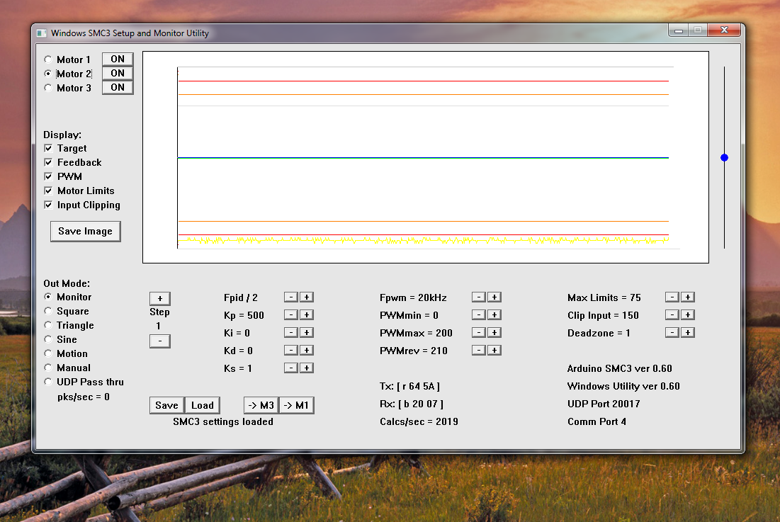

  5. terry wells
    terry wells Active Member
    Jan 19, 2014
    255
    retired military
    minnesota USA
    717Coins
    +59 / 1 / -0
    3DOF, Arduino
    Thank you foe helping me with my problem. I went through your check list and all checked out what I think is OK. However when I set the SMC Utils to Triangle or Sine wave, the motors run wild. (unable to stop with the pots). When I shut down SMC Utils,open SIM TOOLS, setup default I still have no movement using the mouse control. My default is setup in DOF4 #1 axis,pitch and #2 axis, Roll. is there anything else needed for the default? Do I need to use COM3 or COM4?. COM4 is the path that my Arduino board is hooked into. Also, I am somewhat confused by the last paragraph . Is what you are saying is to shut down SMC Utils before I open SIM TOOLS? I think that is what you mean. Thank You again for helping me, I want to make sure that my proto type will work before I jump into the "BIG PICTURE"
    Terry

    @terry wells do yo have the pots mechanically connected to the motors or are you manually turning them at the moment? If you are manually turning them then it will act more like a speed control than a positional feedback - ie when the pot is positioned such that it matches the target value the motor will stop the further away you turn the pot from this position the faster the motor will go. If you are doing this manually and running a triangle wave target for example it will be almost impossible to manually match the required target position so the motor will just appear to "run wild". So if you are doing it manually it sounds like you are all good! :grin
    Yes correct shut down Windows SMC Utils before opening Simtools. Windows SMC Utils is just a setup utility for the Arduino PID code (it does have some other advanced functionality but don't worry about that until you have things working)

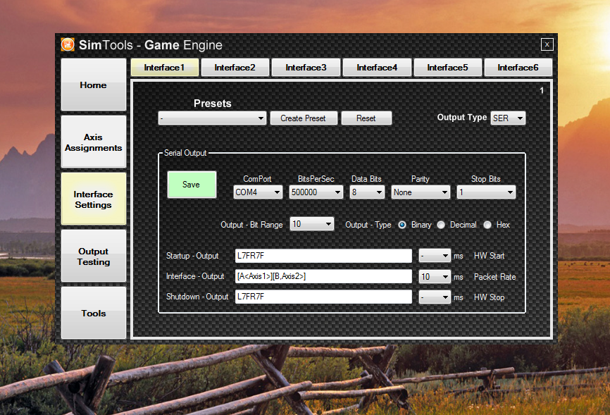

    COM4 is correct if that is what the Arduino is connected to. Have you setup the "Interface Settings" tab in Simtools? The following settings should get you going:
    [A<Axis1>][B<Axis2>] Note: you need to include both the square and angled brackets
    Set for 10bit binary output
    Baud rate 500000 , N , 8 , 1 (10ms delay)

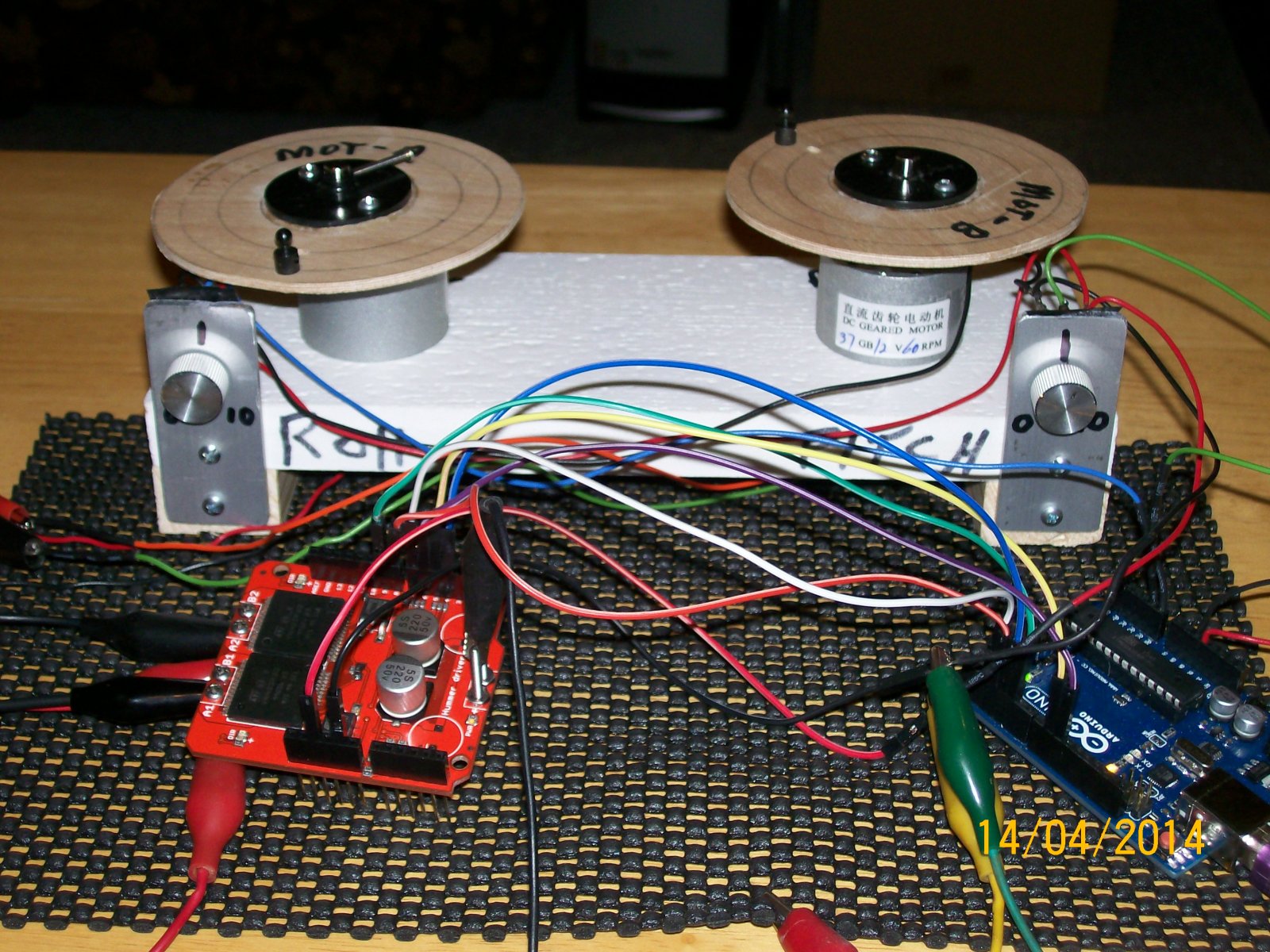

  7. terry wells
    Jan 19, 2014
    255
    retired military
    minnesota USA
    717Coins
    +59 / 1 / -0
    3DOF, Arduino
    Yes, they are mechanically connected (see pic) When I turn them from center they speed up or slow down cw or ccw. I set them to the stop mode. I typed in the info you gave me and motor A (Axis 1) works the right way. However I cannot get motor B (Axis 2) to work at all. ???? I know motor B is good because I can turn the pot and make the motor do what you say. these are my settings. Thanks again
    Terry W.
  8. RufusDufus
    RufusDufus Well-Known Member
    Jul 21, 2013
    681
    Adelaide Australia
    16,374Coins
    +1,016 / 10 / -1
    @terry wells perhaps it is not clear in the photo but looking at the picture I can't see how the motors are mechanically connected to the POTs? I take it the POTs have knobs because you manually turn them? Do the POTs turn themselves as the motors turn?
    Your comment "When I turn them from center they speed up or slow down cw or ccw." - this is correct if the POTs aren't turned/driven by the motors.
    Don't worry about simtools until you have everything working in the Windows SMC Setup Utility - if it doesn't work here it definately won't work in Simtools. From what you are describing though it sounds like you are very close :thumbs
    When running Windows SMC Utils you will see in the chart the "Green" line should move as you turn the POT - this is the feedback. The "Blue" line is the target position. The Arduino will attempt to drive the motor so the green line is positioned over the blue line. So if the POT isn't turned by the Motor then you have to manually turn the pot so the green line matches the blue at which point the motor should stop. The further the green line is away from the blue line the harder/faster the motor will be driven to try and get it to where it should be. So it appears as a speed control unless the pot is 'mechanically' connected to the motor.
    Also note there is a safety feature built in to the Arduino code - if the green line moves into the "Limit Zones" the motor will be shutdown and nothing will appear to work until you move the pots back into the working zone and reset the Arduino. (This could be why you had no response from motor B)
  9. RufusDufus
    Jul 21, 2013
    681
    Adelaide Australia
    16,374Coins
    +1,016 / 10 / -1
    @terry wells Ahh, I think I notice your problem in simtools... You have a , instead of a < after the B in the interface output string - simple typo :grin
    Also you don't want anything in the startup output or shutdown output - leave blank
  10. terry wells
    Jan 19, 2014
    255
    retired military
    minnesota USA
    717Coins
    +59 / 1 / -0
    3DOF, Arduino
    Thank You for seeing that, it is working now like it should. My pots are hooked like the wiring diagram at the start of this thread. however I did need to flip/flop the blue and green wires. A0 & A1 to make the pot on the right operate the motor on the right. Is there a way I can check the motor operation by using my Joy Stick instead of the mouse? I really need to see that my stick can move the motors. You can see that the red and green are on track.
