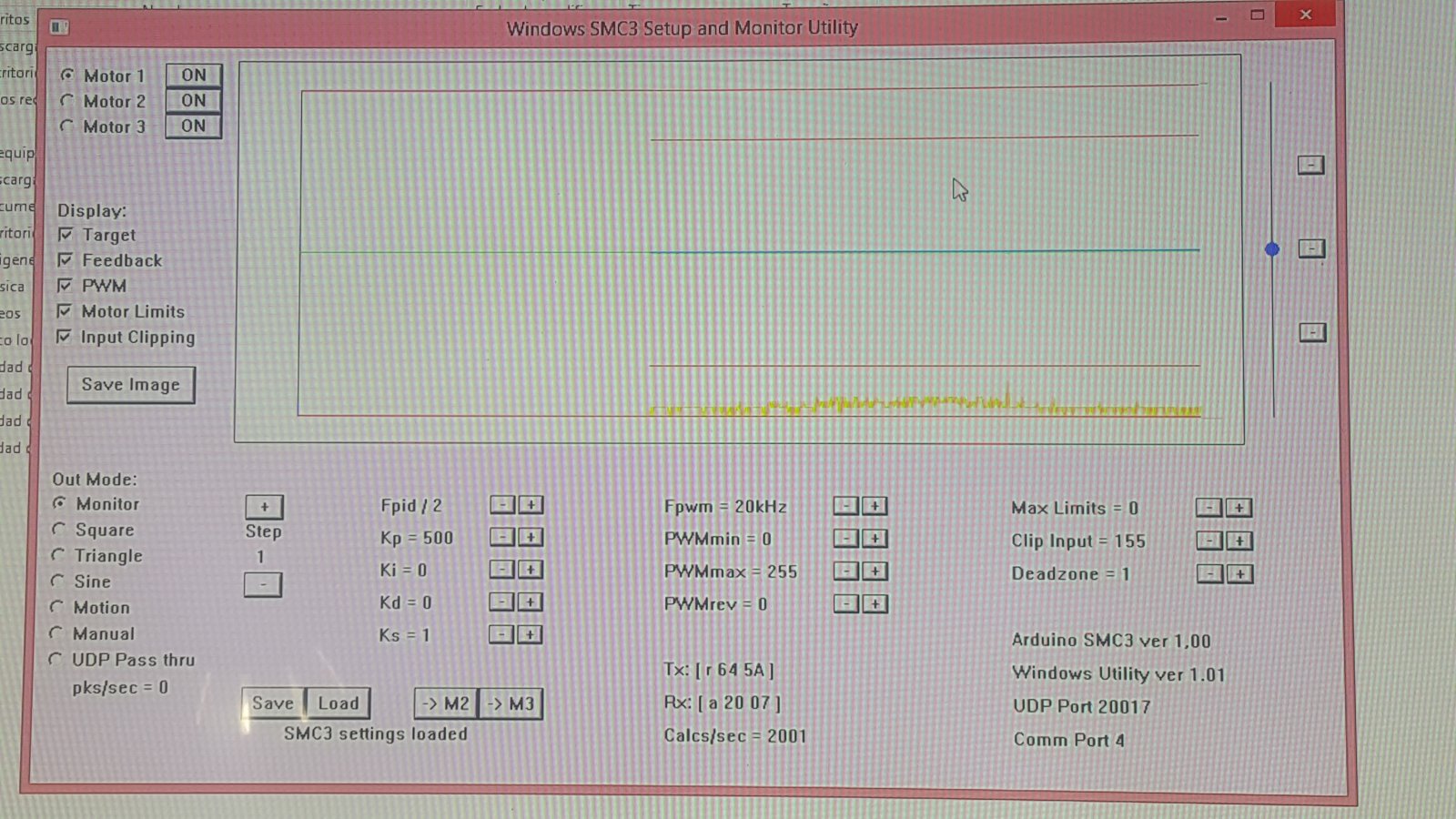

    Ok I have read this entire post 2 times.. I'm at a loss and need some help. I'm running a 3DOF setup. My pich and roll are fine. My traction loss how ever has died. I thought it was a bad pot sensor, i replaced that... nope. Then i thought it was the IBT2 bridge, replaced that... nope. Then i figured its got to be the arduno, replaced that.. nope.. Pretty much the motor only runs on one direction. when i move the pot sensor it will speed it up and slow it down. But it will not reverse the direction. Any help here would be great before i toss this thing out the second floor window !!!! I have triple checked thge wiring, re soldered everything ....

    What do you see with SMC3Utils?

    Its odd, see attached. As move the pot manually, the motor will turn on slowly. Then it jumps right tothe max and turns the motor off. If I loosen the coupler, i can keep the motor spinning if I keep the green line under the blue line. But once it crosses the line it jumps right up and turns off the motor.
    Here are the screen shots from SMC3:
    https://ibb.co/gygzh6
    https://ibb.co/b00s26
    https://ibb.co/b8U8aR
    You can see in the pic, this is when i keep the motor running. Only spins in one direction.
    https://ibb.co/cNewUm
    https://ibb.co/itf39m

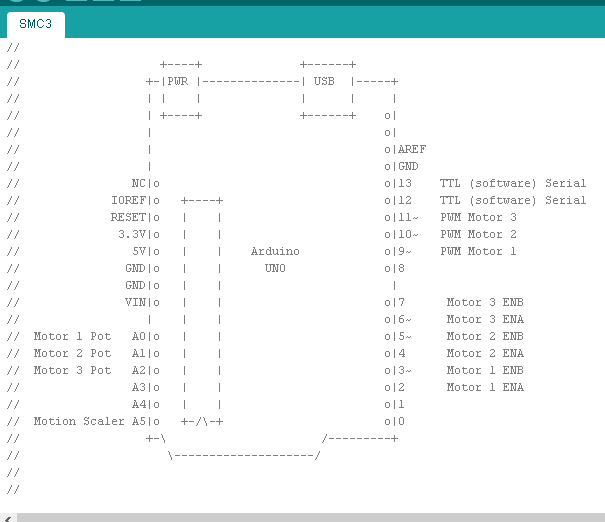

    The Wiring Details are not the same sa the schematic @eaorobbie posted just under the wiring details?
    What is the correct wiring for this .ino file and a aurduino with 2 motors & 2 10k pots?

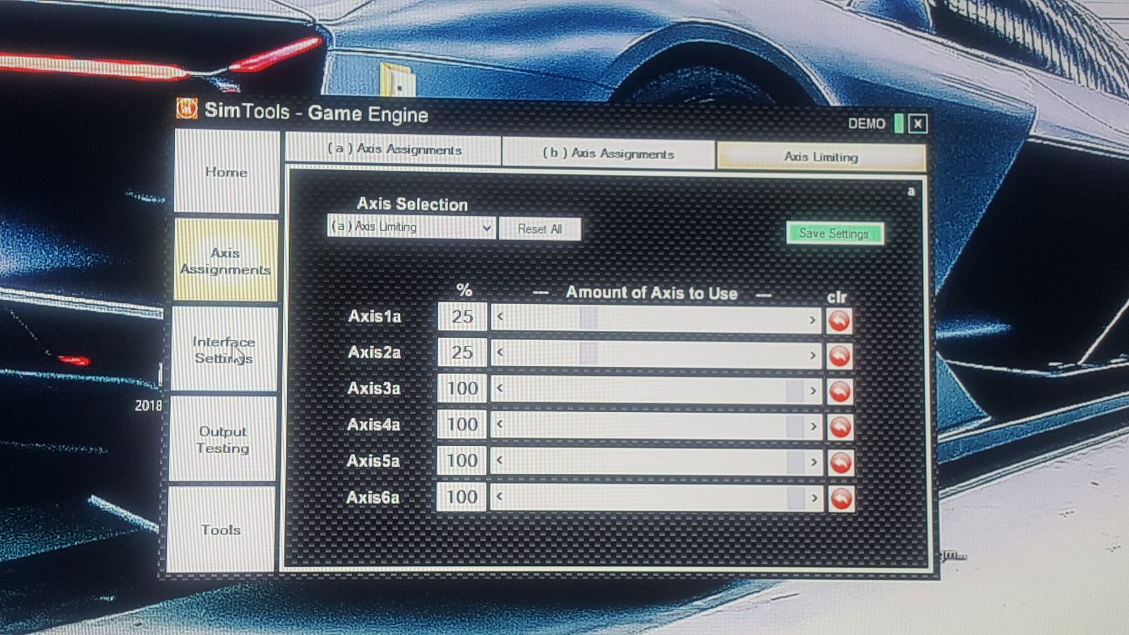

    I have problems with the excess of rotation of the motors, according to the tutorial this would be the solution? But should I connect an5 arduino to the center pin of the potentiometer? And this is the parameter that should be reduced to reduce excess of rotation?
  15. Gadget999
    1,960
    11,989Coins
    +484 / 10 / -0
    can you reduce the movement using simtools ? reduce the motion to say 15% and observe the results
  16. MuñozChile2dof
    MuñozChile2dof 2 DOF SIMULATOR ARDUINO AND IBT-2
    Mar 18, 2016
    36
    Hydraulic technician
    CHILE
    54Coins
    +13 / 0 / -0
    thanks @Gadget999, i reduce axis amount to use and increased the KP parameter in SMC3 utilities and everything works perfect, again thank you so much.
