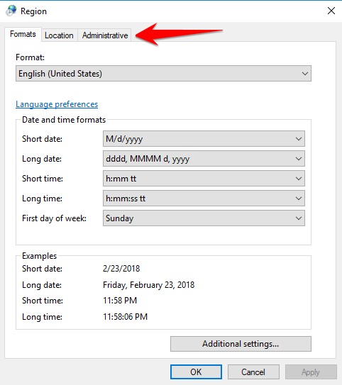

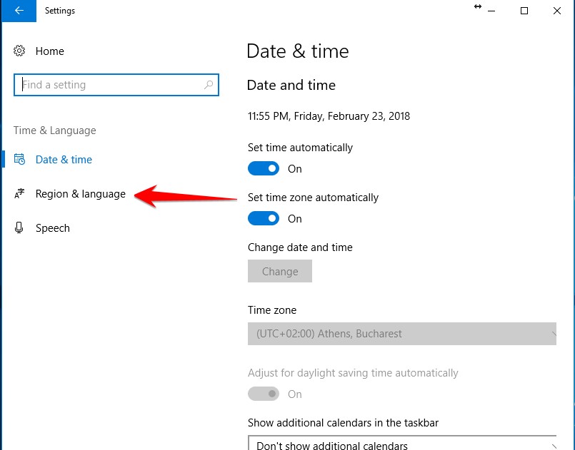

    Hi guys,
    I need your help!
    I have build 2DOF motion rig and using this tutorial my creation is alive, BUT i have a little problem.
    When I use SMC3Utils to test the rig everything is working OK, but when I try to test it with "Output testing" from Simtools as soon as I hit "Turn ON" button the center position of the motors shifts in one direction. After that it is working ok but the rig is tilted. When I turn off output testing and start SMC3Utils again the rig goes to level position.
    Please give me any advice why this is happening and how to correct?
    Thank you very much!

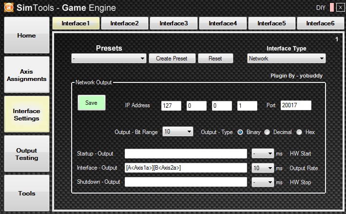

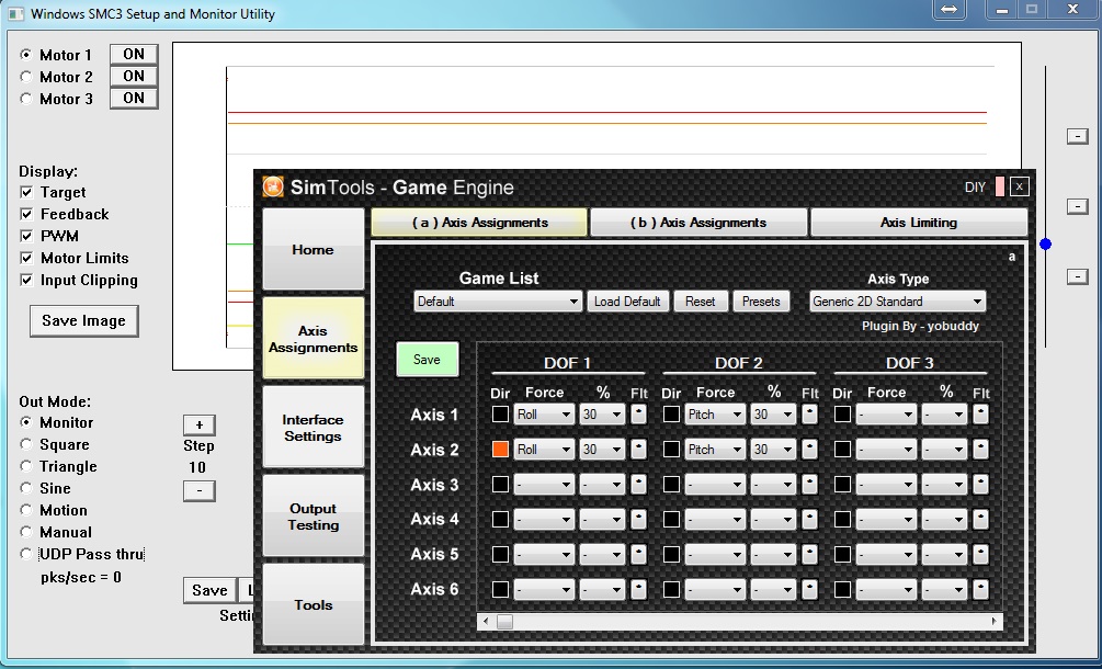

    Can you please post pictures of all of your SMC3 and SimTools settings.

    My settings are uploaded!

    and after 1 full day of different tries i found that the problem exist only on my laptop. I have put a brand new copy of OS changing from win7 to win10 pro and guess what - the problem still exists.
    On my desktop everything works OK.
    Please give me some advice because i want to use my laptop.
    I have already change the OS. Install a fresh copy of arduino. fresh copy of SimTools2.2
    I have no idea what to do next!

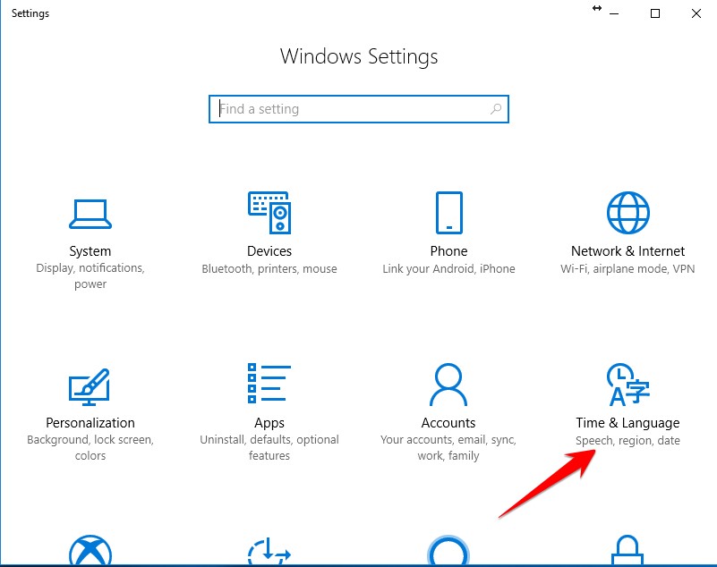

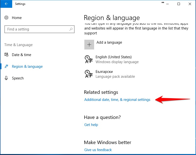

  12. myxt75
    myxt75 New Member
    Mar 6, 2017
    6
    Bulgaria
    94Coins

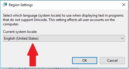

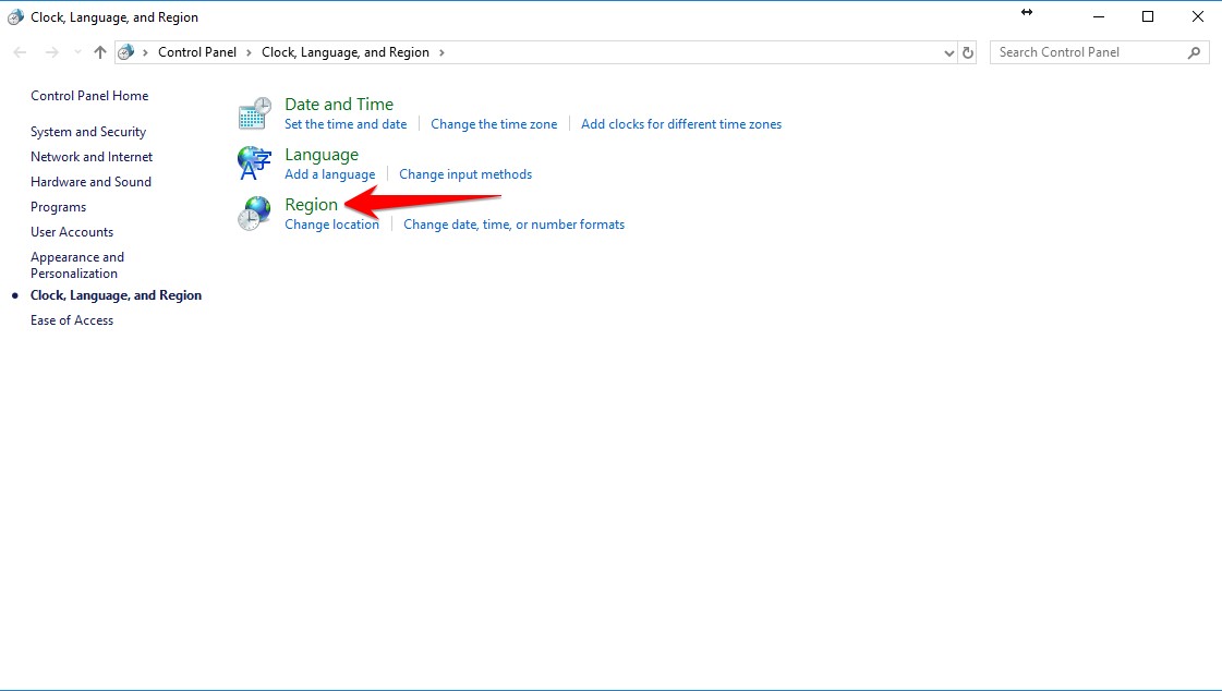

    So,
    After a few more hours of reading and testing, finally I found the answer...
    To work properly SimTools is very important to set "System Locale" to United States.
    Changing only date format to US (mm/dd/yyyy) is not enough!
    Uploading some pictures how to do that for Win10

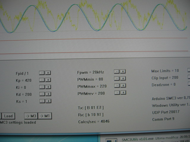

    Hallo i have a big problem with smc3 and sim tools, when i try the moviment in smc3 is all ok but when i use sim tolls after one big escursion the motors stars to 360' and never stop.

    I try different config but the problem is present

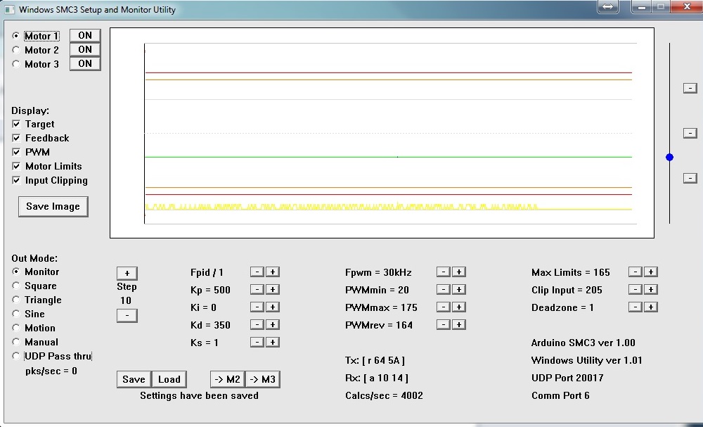

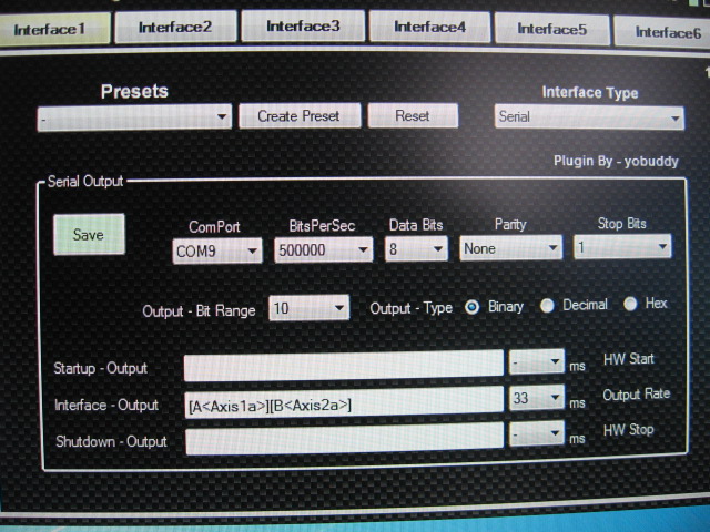

    What are you SimTools Interface and Axis Settings, please post pictures of them.

    I have arduino uno R3 with spy01 the same the motor monster (HB), i use directly potentiometers. My config is standard, when i use Smc3 utils the sim is ok but when i use Sim Tools the sim do what you wont...i don't know why.

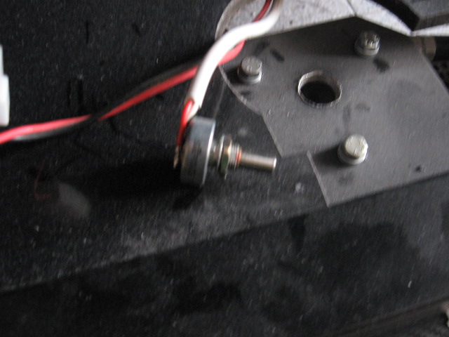

    Just to be clear are you using pots or hall sensors?
    And are they actually connected to the motor, as they are not in the pictures.

    io using pots monted directly on motor, what you see are the same that i have in my sim.
    io have a second spy01 to do a drift effects, is 3° motor and pot in photo not legancy to sim e spy01.
