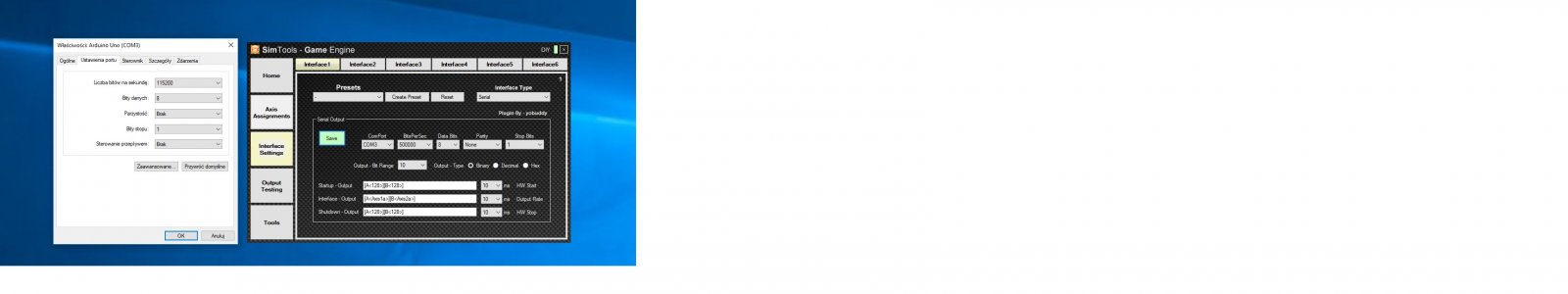

    Hello
    I have a problem after changing sys to win 10 (clean, change due to change to z370)
    SMC3 Windows Utilities works correctly (I had to change the region) while simtools 2.2 turns off the left engine for just 1-2 seconds. I would like to say again that SMC3 Windows Utilities works all the time correctly, so it's not the fault of either the arduino engine or the MonsterMoto shield.

    He already changed the region. The settings in the interface are wrong the bitrate doesnt match and the startup/shutdown is not needed with smc3.

    bits per sec on pc is 115200. In the interface you have it set to 500000.
    Also remove the commands in the startup output and the shutdown output. These should be left empty. did you alter the smc3 sketch, even just for modes?

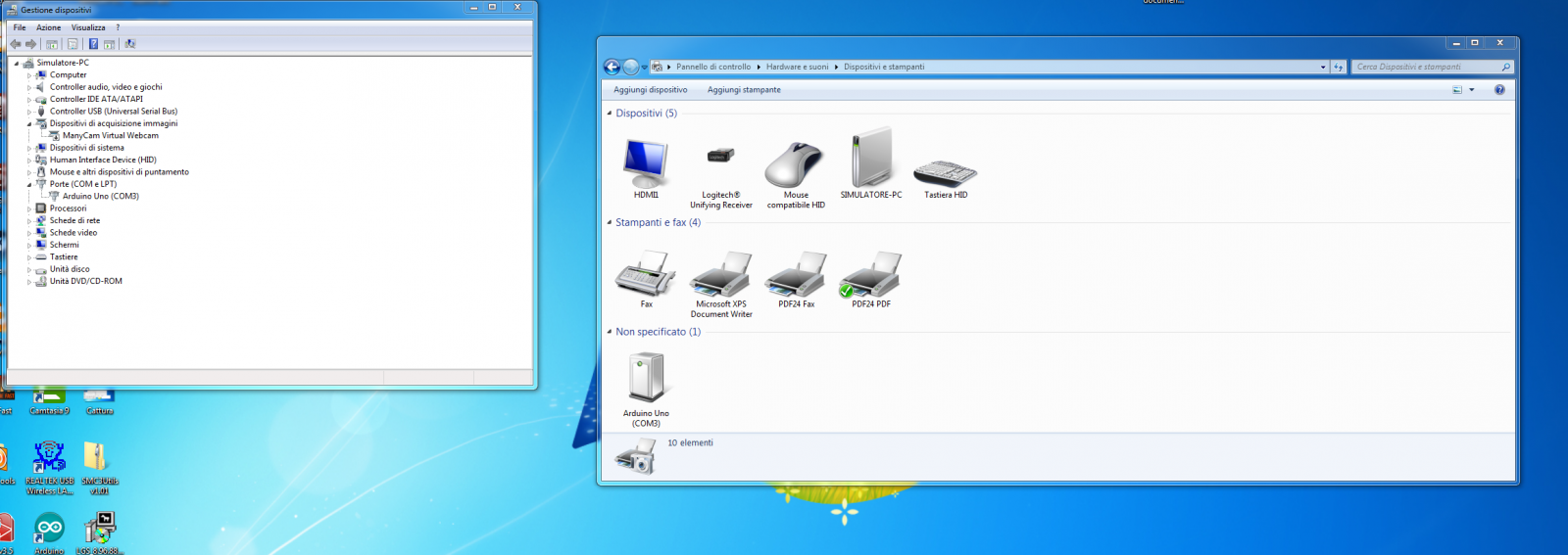

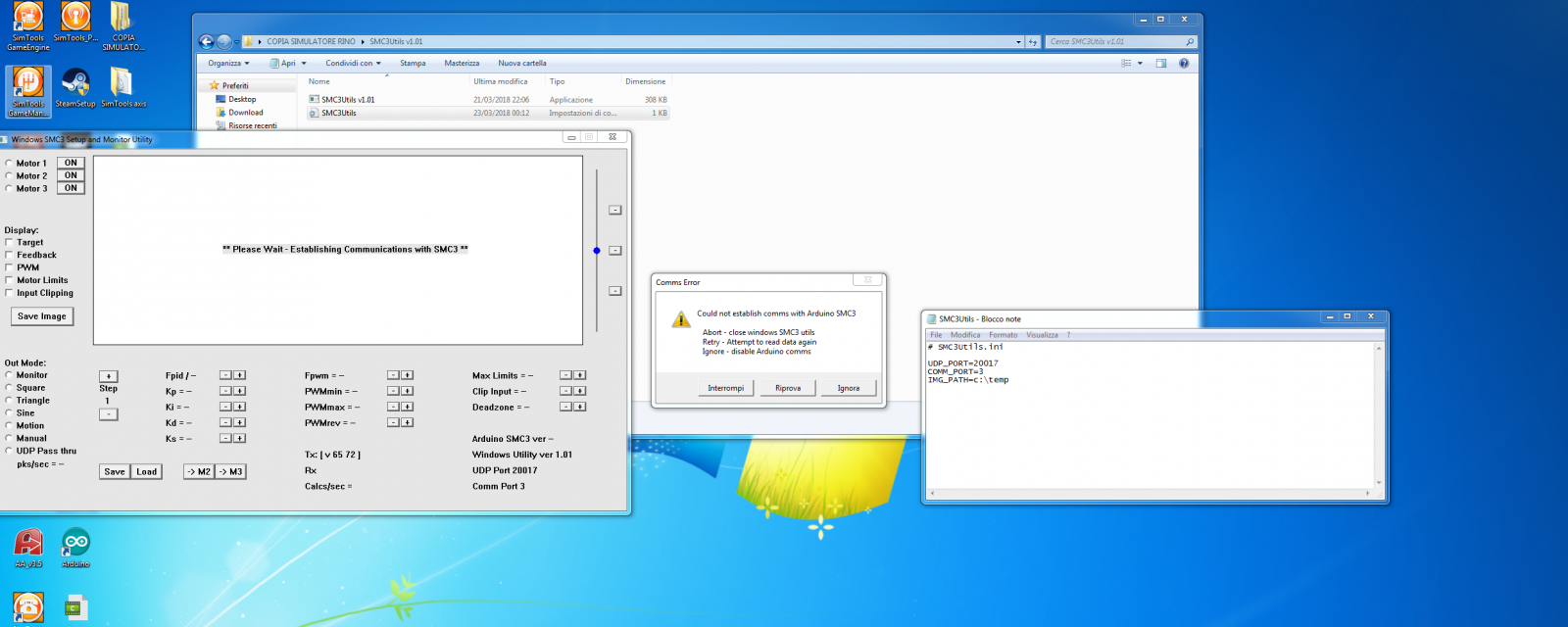

    4DOF
    Hello community I'm new on simulators I'm trying to connect 2 spy01 boards to 2 motors for each board. I'm struggling with SMC3 as i always get this error. I tried to change several times the COM port, but nothing. I tried the trick of the language, but nothing. Please help because I'm stuck. Thamk you very much.

    did you program the arduino ? what port is it in device manager ?

    The board has a built in sketch written by the creator of the boards which has been tested and proven, so it works (of course I can't show it to because I'm not the owner of the sketch).
    In device manager I get this

    built in sketch? that app is made for SMC3 sketch. if your using a different sketch it probably wont work. try using arduino to uplaod the proper sketch. or contact the manufacturer of the hardware your using. the smc3 works for ibt-2, monstermoto and sabertooth.

    I contacted the producer of the boards he said that the sketch is the smc3 sketch with small modifies that don't conflict with the comunication. I've got an other simulator with his boards that are smaller and there it works. I think it' sa problem of PC.
