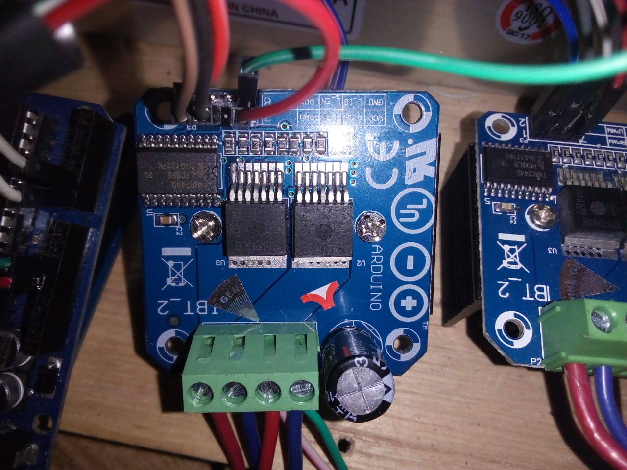

  8. Pedro Andres Pineda
    Pedro Andres Pineda Member
    Dec 12, 2018
    47
    System engineer
    Colombia
    46Coins
    +10 / 0 / -0
    hi, I changed from motomonster to ibt-2 BTS7960B, I've changed the file in arduino to set mode2, but my motors don't move, in smc3 tool I can see the pwm with high values. Is correct wiring as example in mode 2 and set arduino in mode2? What can be my problem?

  10. dedas
    dedas Active Member
    Feb 5, 2012
    115
    IT Manager
    Netherlands
    - 26Coins
    +81 / 0 / -0
    Hi Pedro, If you wired it just like the picture it's 100% correct.
    Your motors are enabled in the SMC software?
    You can set your limits with the potentiometers and the SMC software, if your settings are out of bounce your motors wil not move!!!!

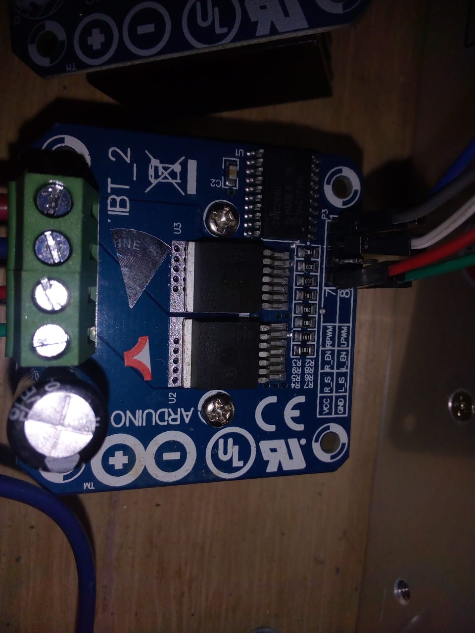

  11. Pedro Andres Pineda
    Dec 12, 2018
    47
    System engineer
    Colombia
    46Coins
    +10 / 0 / -0
    Hi. Thank you for your answer.
    I wired all with the picture for mode 2. And I set and compile the Arduino in modo2.

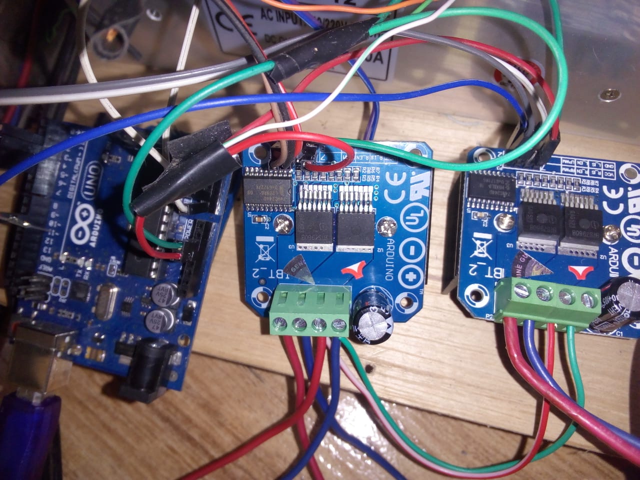

  12. Pedro Andres Pineda
    Dec 12, 2018
    47
    System engineer
    Colombia
    46Coins
    +10 / 0 / -0
    And this is how Smc3 tools shows the info.
  13. dedas
    dedas Active Member
    Feb 5, 2012
    115
    IT Manager
    Netherlands
    - 26Coins
    +81 / 0 / -0
    Ok, when you rotate the potentiometers can you see a change in te SMC3 console?
    I can't follow/see the wiring, that's a bit too hard to see :) (in the pictures)
    did you measured the +5V on the H-bridges?
    is enabled high? (~ +5v)
  14. Pedro Andres Pineda
    Dec 12, 2018
    47
    System engineer
    Colombia
    46Coins
    +10 / 0 / -0
    Yes, when I move the potenciometer smc3 shows the new position, in the h bridge I can measure correctly +5v.

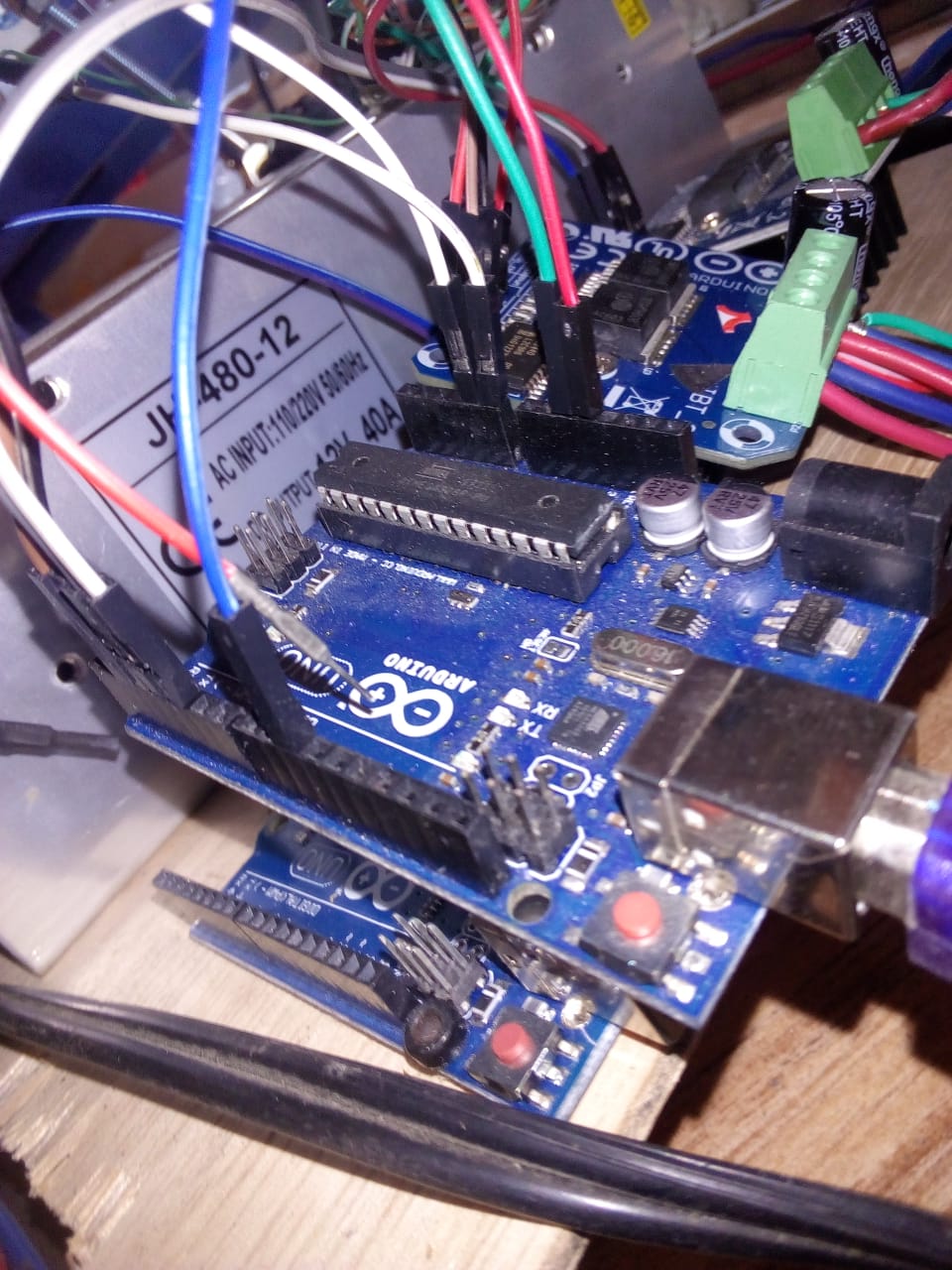

  16. Pedro Andres Pineda
    Dec 12, 2018
    47
    System engineer
    Colombia
    46Coins
    +10 / 0 / -0
    Thank you everyone for the help. After all, with my father, we decided disconnect the Arduino and h bridge from the motion platform and we connected it on the table with a small motor and another power supply. All worked fine on the table. We tried the old arduino with our old motomonster and it works too. Finally we need validate what happens with our motors in the motion platform and the 40 amp power supply.
  17. Pedro Andres Pineda
    Dec 12, 2018
    47
    System engineer
    Colombia
    46Coins
    +10 / 0 / -0
    We don’t know if is valid put the power supply, h bridges and arduino together under the motors. Does this generate interference between the components? I tested each motor and the power supply and these works correctly, but when I connect these with the h bridge and arduino doesn’t work.
  18. noorbeast
    22,048
    153,884Coins
    +11,154 / 57 / -2
    Are you using wiper motors and if so are they ground isolated: https://www.xsimulator.net/community/faq/wiper-motor-mandatory-ground-isolation.25/
  19. Pedro Andres Pineda
    Dec 12, 2018
    47
    System engineer
    Colombia
    46Coins
    +10 / 0 / -0
  20. noorbeast
    22,048
    153,884Coins
    +11,154 / 57 / -2
    No, the pgsaw motors are fine to use as they are, they do not need ground isolation like the wiper motors.
