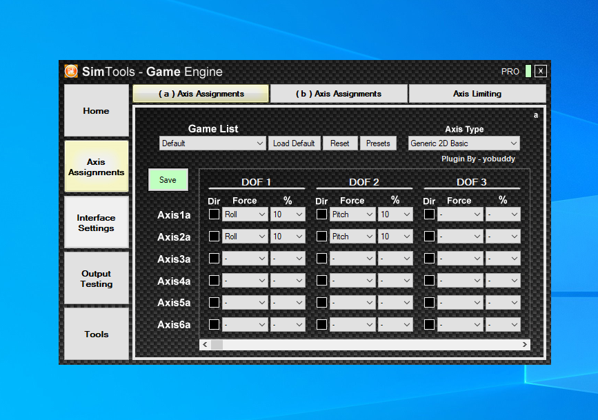

    And for the other issue, its posible to invert the movement? The wiring its identical to the guide in MODE1 , the way i build the mechanics its just need to go invert the direction movement.
    And i cant flip the motor cable because will not work the pot.
    But all work great!!

    The Dir checkbox in Axis Assignments being checked orange or not determines which way an axis moves, so you can use that to invert which way the motor moves for a given axis.

    Perfect! @noorbeast .
    I thought it was to turn on the axis channel jeje.
    (( read the manual Xavi ))

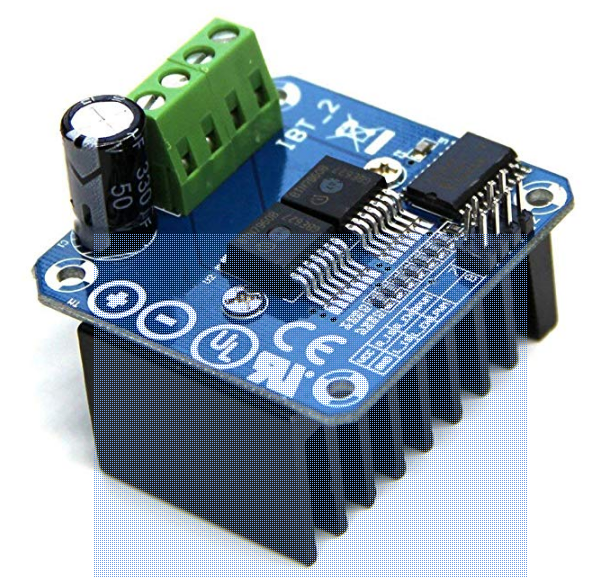

    Ciao noorbeast,
    my intention is to modify my sim with Hiletgo BTS7960 43A cards and use SMC3 to set up the electric motors.
    I'm sorry but your answer is not clear to me, confirm that the cards I ask for information are okay?
    Grazie for your help.

    Ciao,
    I'm looking in the forum and I see that others have tried IBT-2. I thought that they are an alternative as it seems that they mount the same electronic components.
    HiLetgo BTS7960 43A the link below:
    amazon.com/HiLetgo-BTS7960-Driver-Arduino-Current/dp/B00WSN98DC
    I want to try something different from the MMS with VNH2SP30-And because I burned several. I need to drive 2 12V 235W 26A DC motors.
    Do you think I should buy exactly the one described on page 1 of the post?
    This card Double BTS7960 43A is tested with SMC3?
    by Fevas
    amazon.com/Fevas-BTS7960-H-Bridge-High-Power-Diagnostic/dp/B07M6LDQPS
    21,890
    152,971Coins
    +11,115 / 56 / -2
    See previous response:
  12. BlazinH
    BlazinH Well-Known Member
    Oct 19, 2013
    2,145
    Oklahoma City, USA
    16,676Coins
    +1,839 / 32 / -1
    Yes they are one in the same. Set SMC3 to Mode 2.

    Before proceeding with the purchase of two more questions, the price of the cards is very different from each other, do you think it is a commercial or quality aspect of the product? The fact that noorbeast says that HiLetgo BTS7960 43A is not tested with SMC3 should make me give up buying HiLetgo.
    BlazinH, confirm that they are equal. Are you sure that HiLetgo works correctly with SMC3 MODE2 as described in the tutorial on page 1 of this post?
    To be sure I should buy exactly the one described in the tutorial, but unfortunately there is no writing what it is.
    I take advantage of your patience and ask:
    if I wanted to change my SIM (which gives me big problems) following the instructions on page 1 using the SMC3 firmware for arduino and "physically" connecting only 2 motors and setting only two axes in simtools (making a 2 DOF with the firmware for 3 DOF) would be a problem or the system would "get angry".
    Thanks again for the help.
  14. BlazinH
    Oct 19, 2013
    2,145
    Oklahoma City, USA
    16,676Coins
    +1,839 / 32 / -1
    The components are the same on each card but I can't speak of differing build quality depending on whom you buy from.
    No.
    Yes. I've used them myself and if you look at the cards they are all stamped IBT_2.
    Yes.
    However I can say that out of 5 HiLetgo branded units I bought one was DOA but the replacement they sent worked. So in my case 83% were functional.

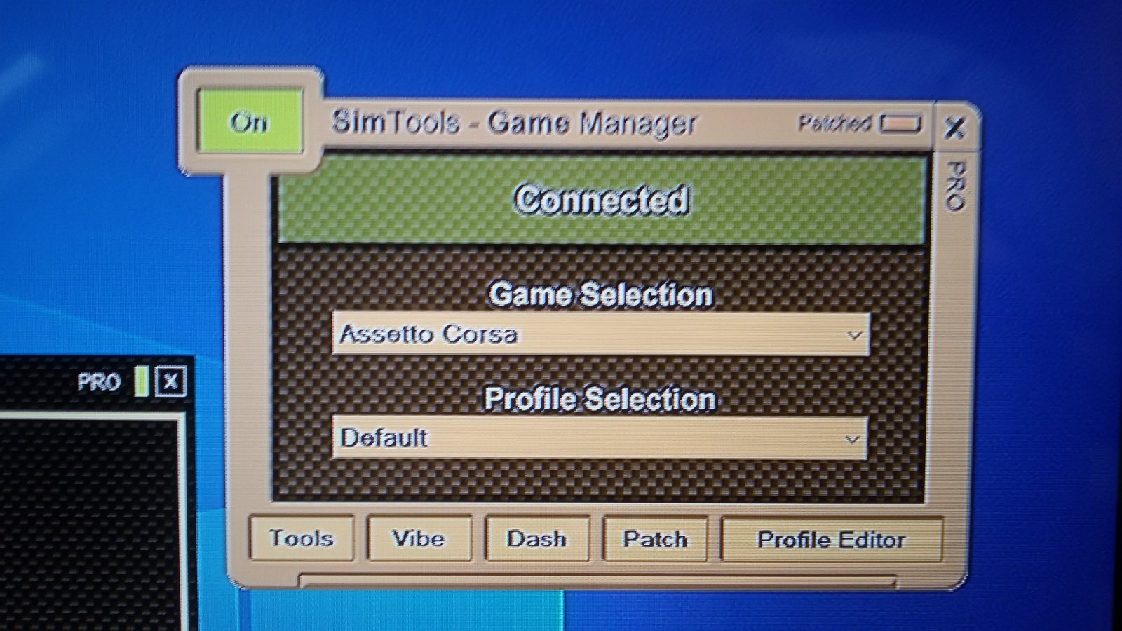

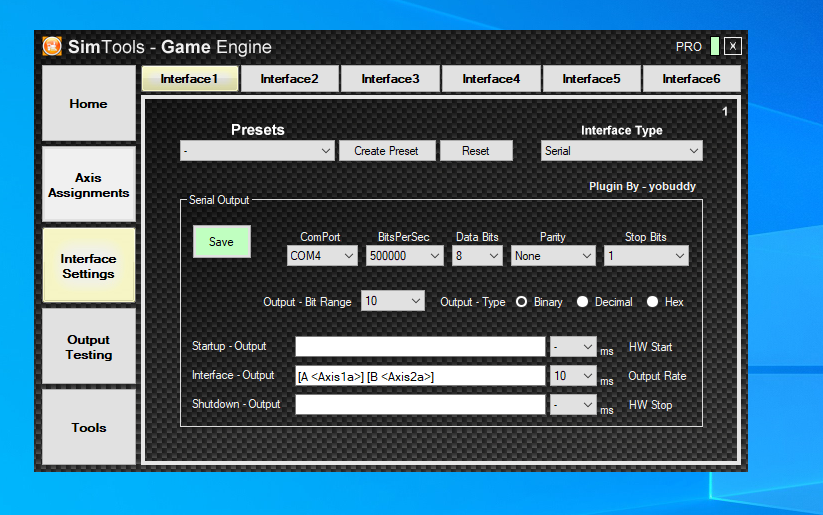

    I started the RIG with SMC3 (as from the beginning of this post firmware MODE 2).
    I think I did everything correctly, I say I believe because with simtools it doesn't work!
    The setting of the motors with SMC3 utility has been successful the motors are running correctly.
    I close SMC3 utility and launch simtools, I try to move it to manual (output test with default profile) but the motors don't move.
    I have the impression that simtools does not communicate with Arduino!
    Do you have suggestions, by clicking SAVE in SMC3 utility the configuration of the motors is saved, the saving on HD must have a precise path?
    Thanks for your help.
  20. alexdraco
    alexdraco Member
    Aug 8, 2018
    85
    278Coins
    +34 / 0 / -0
    Ciao,
    I installed the vs 2.4 and everything seems to work.
