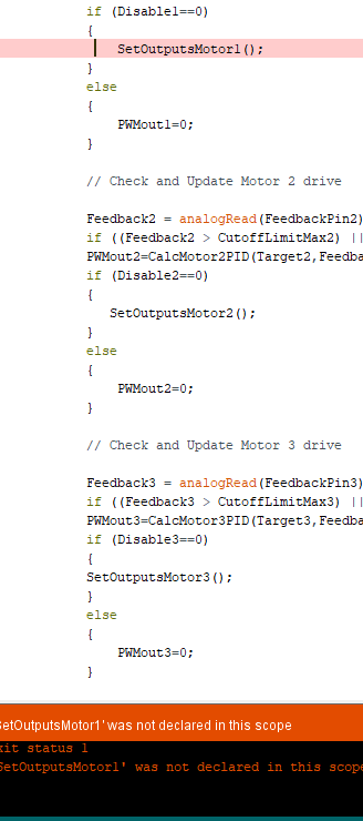

    Hi Guys,
    back again. I´ve a stupid problem. After a systemcrash i´ve lost my Arduino Code for SNC3. Does anyone have the code for download?
    My setup:
    Arduino Uno3
    Motormonster
    Thanks to all
    Martin
  11. Martin.Berger
    Martin.Berger Member
    May 6, 2014
    71
    204Coins
    My detailed problem ist the following Respons when i check the code or upload it:
    Any ideas?
  12. BlazinH
    BlazinH Well-Known Member
    Oct 19, 2013
    2,145
    Oklahoma City, USA
    16,630Coins
    +1,835 / 32 / -1
    Assuming you downloaded the latest sketch from the first post of this thread and didn't modify it the only thing I can think of right now is to check that you have Uno selected as your board in the programmer. If that doesn't work try using a different Uno.
