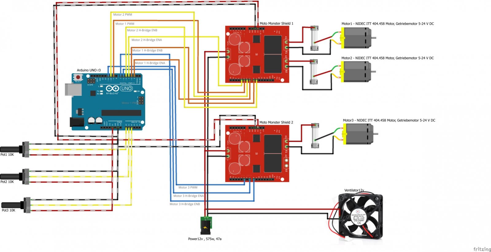

    3DOF, DC motor, Arduino, 6DOF
    is that right for 3DOF ?
    regards Andreas ?

  18. terry wells
    terry wells Active Member
    Jan 19, 2014
    255
    retired military
    minnesota USA
    717Coins
    +59 / 1 / -0
    3DOF, Arduino
    hey Andreas, Thanks for your wiring diagram. This is what I want to do.
    Terry W.
  19. dahfl
    dahfl New Member
    Feb 21, 2014
    29
    Administrator
    Mülheim Ruhr
    485Coins
    +37 / 0 / -0
    fine, then i can test it now.
  20. RufusDufus
    RufusDufus Well-Known Member
    Jul 21, 2013
    681
    Adelaide Australia
    16,374Coins
    +1,016 / 10 / -1
    Hi dahfl, Unless you have some non-standard POTs your wiring to those is incorrect.
    The center pin is typically the adjustable wiper output and should have your coloured wire connected to it. The two outside pins have the +5V and GND connected.
