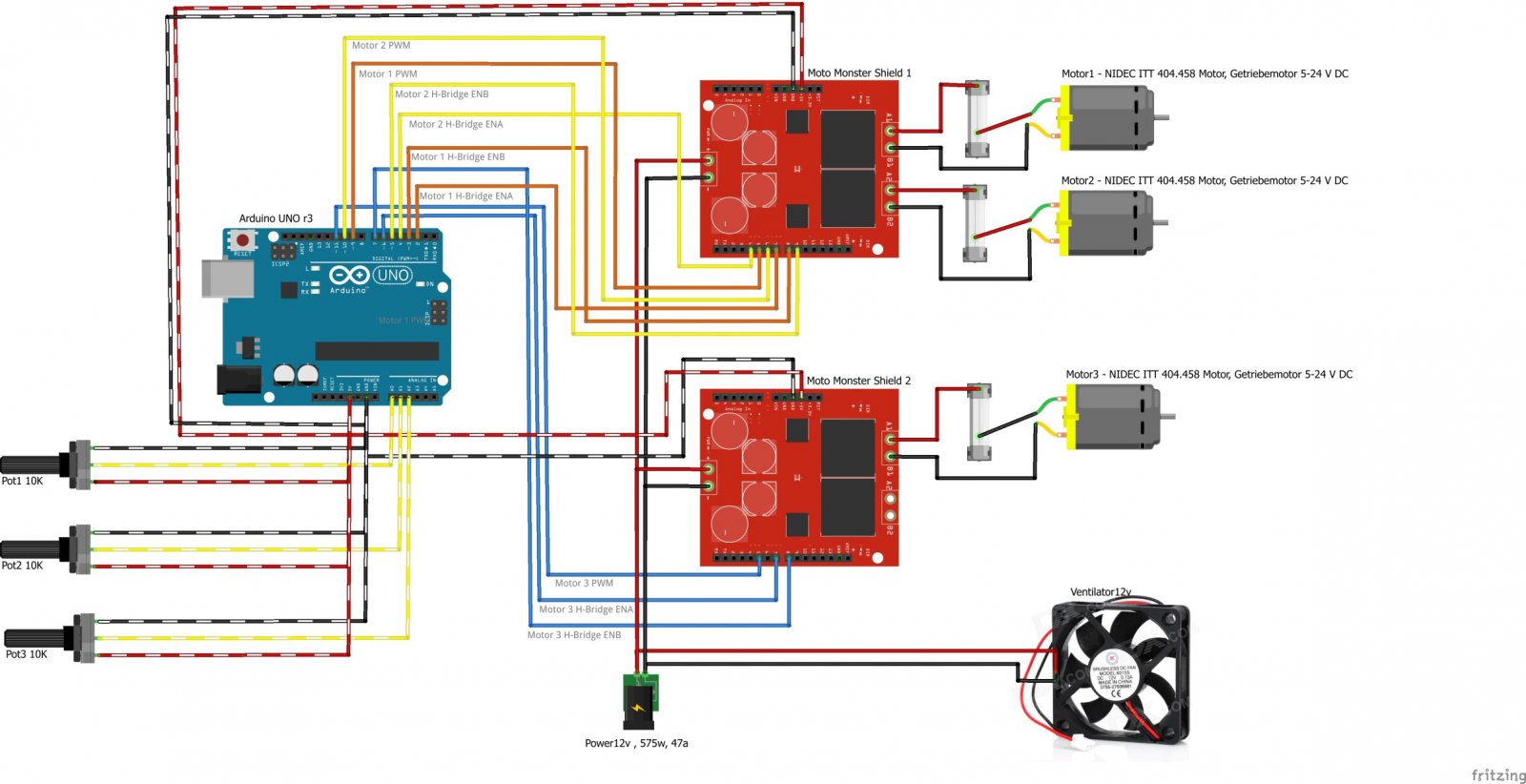

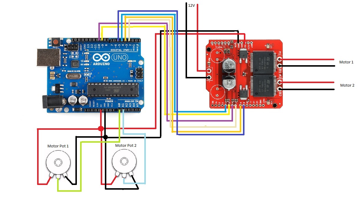

    Attached the wiring diagram and the .ino code used.
    Is it normal, with this config, that the motor start to move when I power on the system?

    At the end I solved it by increasing the DEADZONE value. Now it's setted to 10 and when I turn on the motor are stopped.

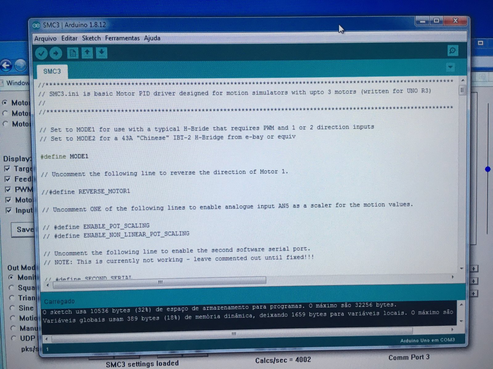

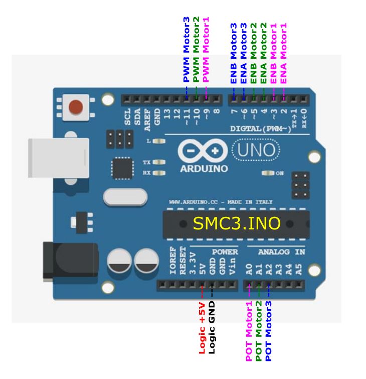

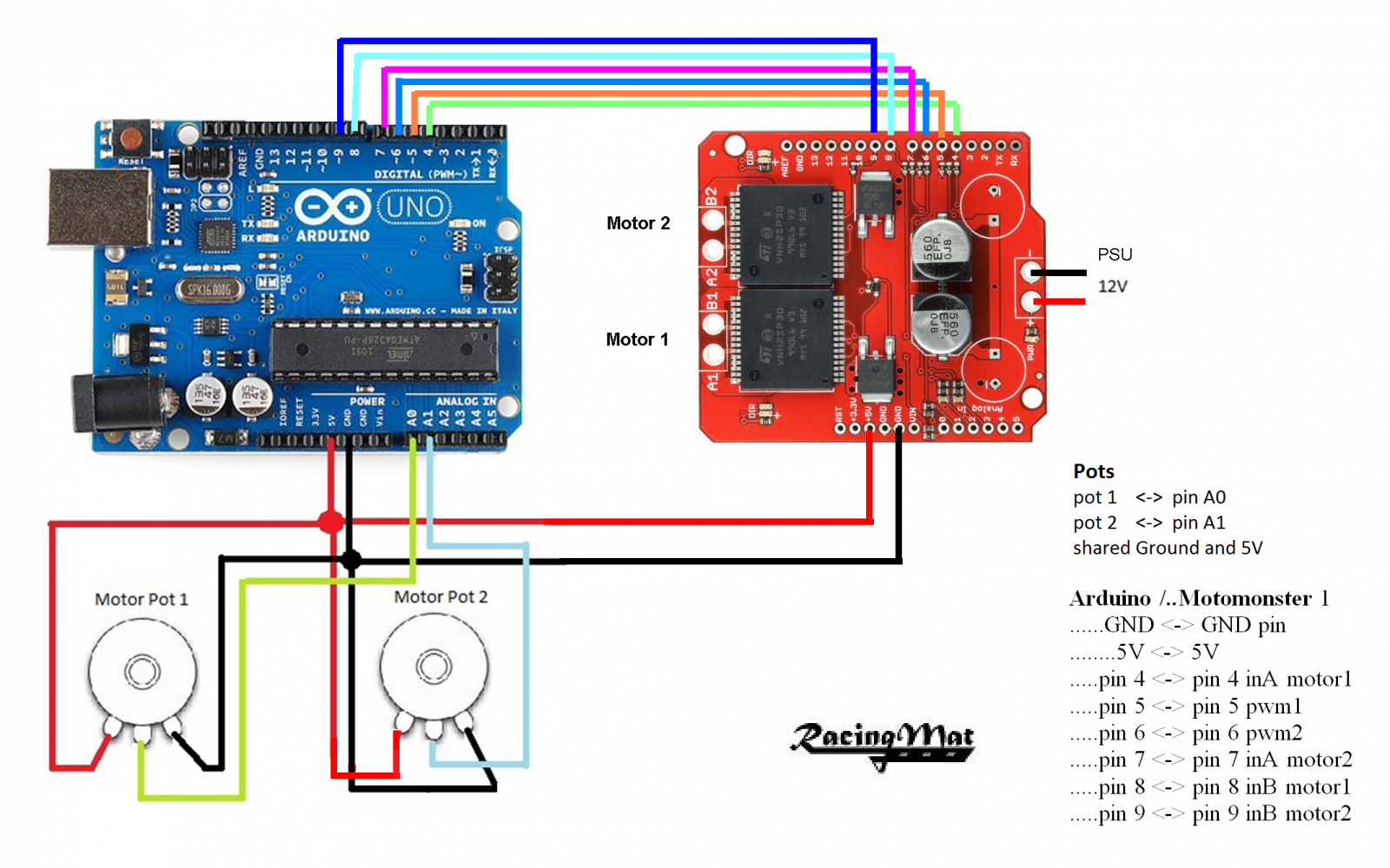

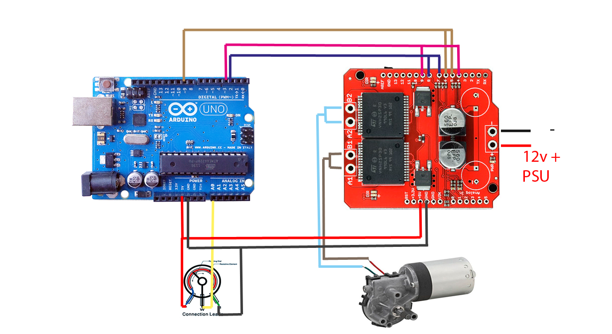

    Hello.
    I am unable to run the engines with the SCM3.
    The potentiometers appear on the graph but the motors are not started.
    What is the correct pinout to configure the motors?
    It is?
    Or is?
    I'm using this Arduino code.
    Please help, thanks.

  5. tomkil192
    tomkil192 Member
    Jun 25, 2015
    81
    Uk. London
    - 25Coins
    +26 / 0 / -0
    Set the green line right in the middle. And then play with the program but read the link above from Noorbeast first

  7. tomkil192
    tomkil192 Member
    Jun 25, 2015
    81
    Uk. London
    - 25Coins
    +26 / 0 / -0
    It takes time. you have to read a lot. Set the green line righ in the middle with the potentiometer. Then set all parameters low as per the instructions. Max limit and clip input set to 250. then click sine
    (Do not touch the potentiometer)
    If the switch next to the motor you have selected is ( OFF) then you have reached the limits.
    I hope this will help.
  8. Marcos73
    Marcos73 Member
    Feb 14, 2020
    77
    100Coins
    +55 / 0 / -0
    Thanks Tom, I was successful, in fact I had used an Arduino pinout that was not correct. And after testing all the pinouts I found here, I found the correct one. Hugs and good luck! :)

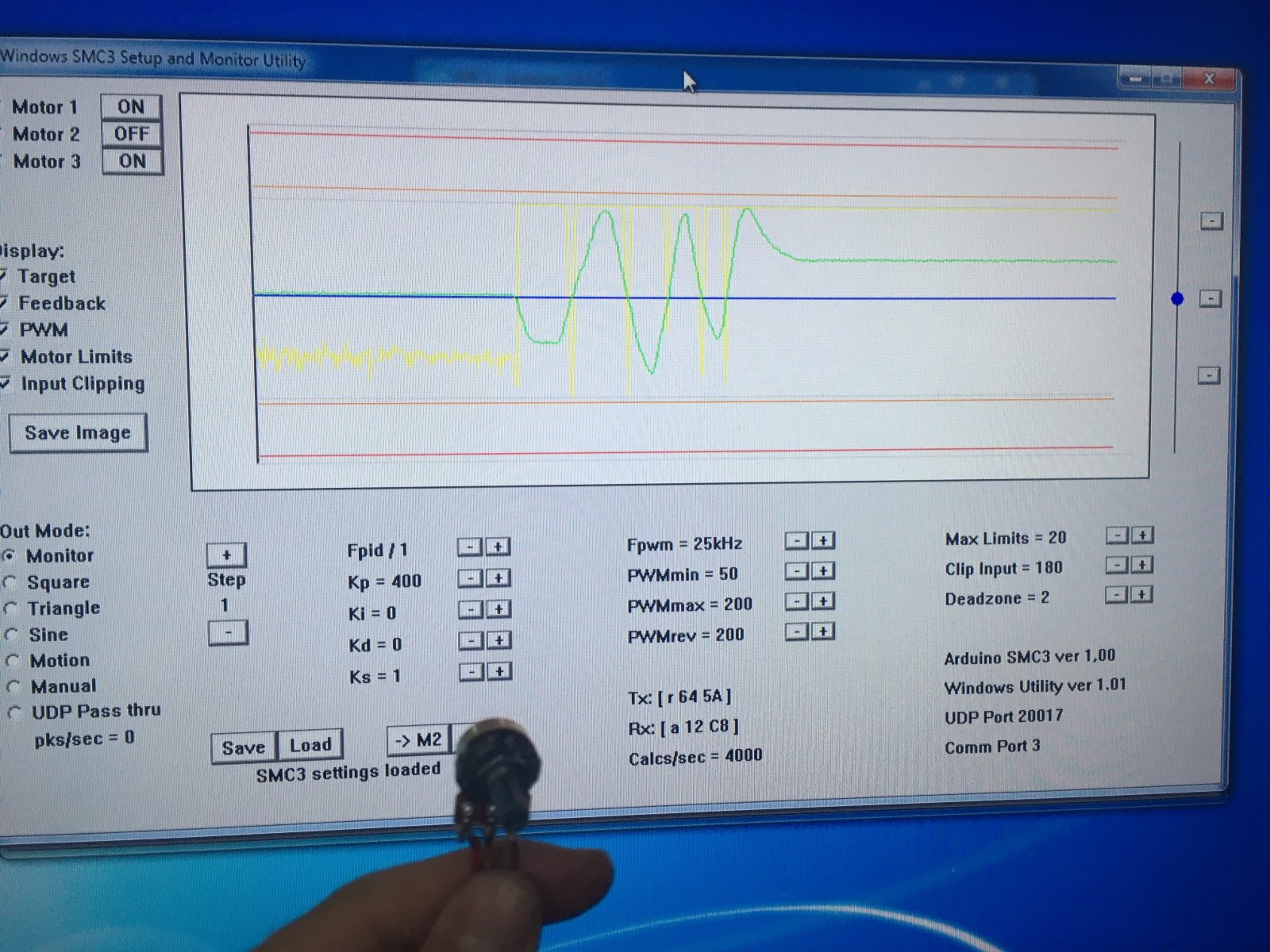

  10. Marcos73
    Marcos73 Member
    Feb 14, 2020
    77
    100Coins
    +55 / 0 / -0

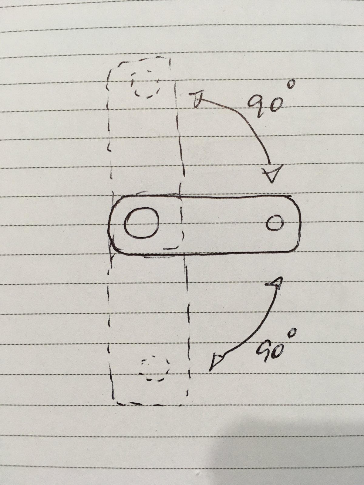

    Hello. Following your guidelines and RufusDufus ttps://www.xsimulator.net/community/threads/smc3-arduino-3dof-motor-driver-and-windows-utilities , but I believe that there is still no success. The engines did not stop. I still don't understand how SMC3 works!
    Does the SMC3 define the working angles of the engines?
    If so, what happens is that you are not able to stop at 90 °, setting the maximum engine limit.
    When using the potentiometers, they stop, but still pass the 90 ° I need.
    And I changed all the parameters.
    Please help.
    Follow video.
    Thank you.

    The SMC3 configuration is explained here: https://www.xsimulator.net/communit...driver-and-windows-utilities.4957/#post-48121
    You need to have a pot connected to the motor, which gives position.
  12. noorbeast
    21,595
    151,233Coins
    Sorry but there is not enough detail and context to understand what you need help with, can you please be more specific.
  13. noorbeast
    21,595
    151,233Coins
    What motor drivers are you using?
    Please post pictures of all of your settings and hardware.

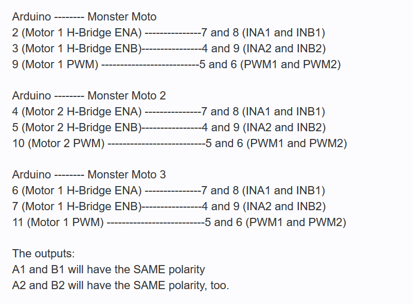

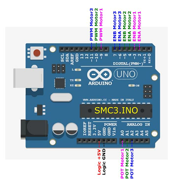

  17. josemanuelrm26
    josemanuelrm26 my 2dof
    Sep 22, 2015
    100
    valencia
    - 8Coins
    +36 / 0 / -0
    hello following this firmware for arduino for 3 motors do you know how to connect the pins to 2 motomonster?
    is that I'm a little lost ..
  18. Llewelyn
    Llewelyn Member
    Nov 10, 2017
    69
    IT consultant
    south africa
    108Coins
    +18 / 0 / -0

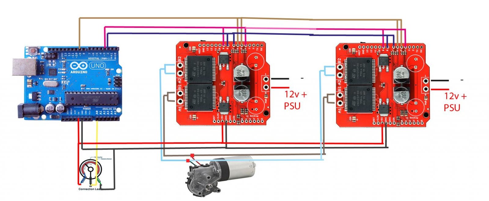

    Hi had these pics which I always use,you can figure it out from there,simple.
    This one below is to double the current capcity. Double moto monster connection.jpg
    This is to connect two motors to one motomonster below:
    This one below is todouble the current capacity of the two channels on the one board:
    And lastly this is the pin outs to use when you connect your motomonstor boards:
  19. josemanuelrm26
    Sep 22, 2015
    100
    valencia
    - 8Coins
    +36 / 0 / -0
    I need this but I don't know if the wiring is correct 3 motors 1 arduino and 2 moto monster
    and thanks for answering me
  20. Llewelyn
    Llewelyn Member
    Nov 10, 2017
    69
    IT consultant
    south africa
    108Coins
    +18 / 0 / -0
    Yes that wiring is correct.
