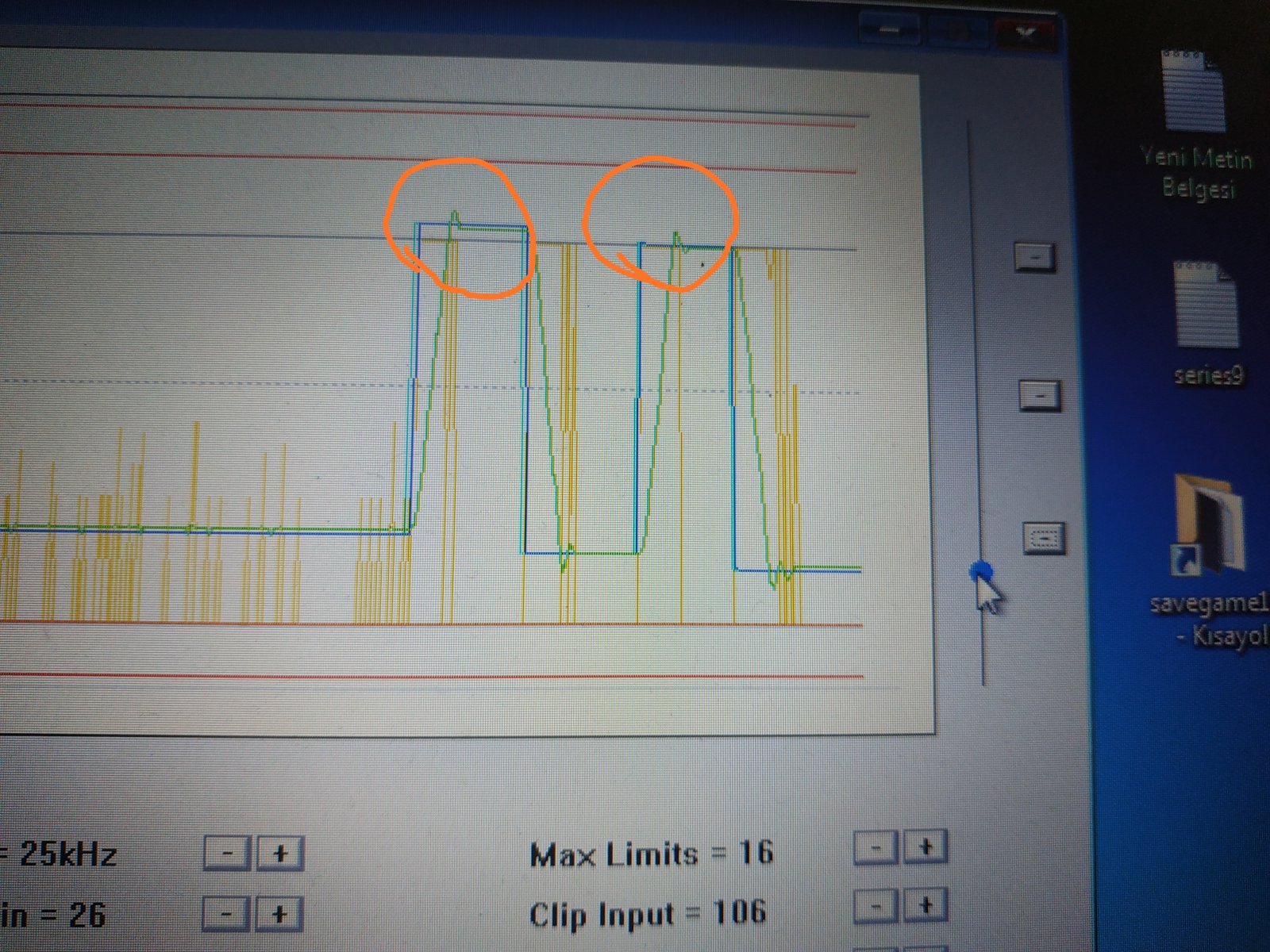

  10. kadirbekil
    kadirbekil New Member
    Apr 26, 2020
    87Coins
    2DOF, 3DOF, 4DOF, 6DOF
    Yeah. Do you think the problem might be on the engine. The engine does not stop where it should stop.

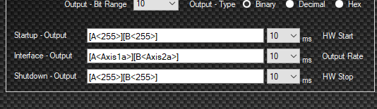

    Why didn't this work for me? Is there currently some kind of different configuration?
    I wish my engines were at maximum height when turning off the game.
  17. noorbeast
    22,048
    153,884Coins
    +11,154 / 57 / -2
    In Startup and Shutdown basically what you are doing is sending an ASCII char for the value of <x> (where x = 0 through 255), page 45 of the SimTools manual: https://www.xsimulator.net/community/faq/rtfm-start-with-the-official-simtools-documentation.117/
    So with JRKs, which I use, 221 is the on command for Position, 63 tells it where to go and 225 turns it off.
  18. Djalma Ribeiro
    Djalma Ribeiro Member
    Mar 24, 2020
    65
    Drone Pilot
    Cuiabá, Brazil
    168Coins
    +12 / 0 / -0
    Excuse me. I appreciate the help but I still don't understand anything.
    Give me a practical example please. What is the amount I need to fill so that my engines are in the highest position?
