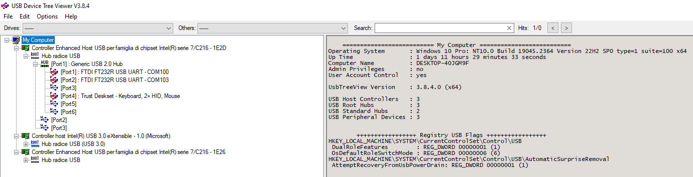

    Hi everyone, I have a problem.
    I am using SMC3 "Softstart V1.7a" and to test my 3DOF simulator (4 cylinders), I am using rFactor which has AI (auto driving (so I can see and test everything without driving).
    A strange thing happens: after about 3 minutes one of the motors stops working, as if it no longer receives commands from the BLDC driver.
    So I run this test: close rFactor, open "Game Engine", Output testing, Turn ON, (a) Axis Output, move slider "Axis4a" but the engine doesn't work. I open SMC3Utils, Sine, and the engine runs.
    What's the problem?
    How can I solve the problem?
  18. noorbeast
    22,185
    154,750Coins
    +11,196 / 57 / -2
    It could be a number of things, but my first guess would be possible USB disconnects: https://www.xsimulator.net/community/faq/usb-disconnects-and-port-mapping.396/

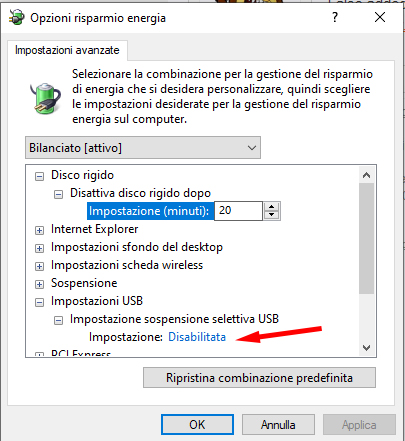

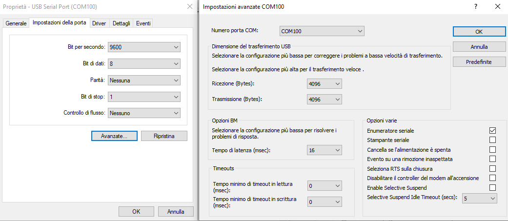

    Hi noorbeast,
    The two USB cables are both connected to the V2.0 ports
    I just downloaded "USB Tree Viewer", I attached the result.
    I disabled selective suspend
    These are the COM port settings.
    Question: Is 500000 BitsPerSec correct?
    In "Manage Devices", COM ports, which speed should be set?
    I set 9600, is that correct?

  20. noorbeast
    22,185
    154,750Coins
    +11,196 / 57 / -2
    I would leave the com port default for now.
    Just change one thing at a time, as you first have to find the cause before you can fix it and changing too many things at once will make that hard.
