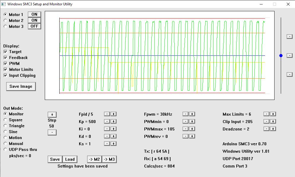

    I uploaded the soft start to my Arduino.
    Startup the Arduino and only motor 1 and 2 are moving forward, this is what I have in SMC3
    Motor 3 is not turning at all..
    What could be the problem?

  4. Design89
    Design89 Member
    Oct 25, 2022
    32
    Netherlands
    214Coins
    What exactly do you mean?
    Reversing the + and - of the motor only makes the motor turn the other way. This is what the IBT2 does, isn't it?
    Could it be that the wires need to be connected differently than described?
    The Arduino code states:
    o|7 Motor 3 ENB
    o|6~ Motor 3 ENA
    o|5~ Motor 2 ENB
    o|4 Motor 2 ENA
    o|3~ Motor 1 ENB
    o|2 Motor 1 ENA
    3, 5 and 6 are PWM.
    But the connection says:
    ENA ----> IN1/RPWM
    ENB --+-> EN1/R_EN
    +-> EN2/L_EN (ie connect ENB to both R_EN and L_EN)
    PWM ----> IN2/L_PWM
    ENA should be PWM? Or not?

  7. Arta Yasa

    Hi bro i try your code and set ssloop to 100 until 500 but first start still same very fast.
    And also when i set pwmmax exsample 150, and save the value after that i close the smc3 and open again the pwmmax become 11 sir, its bug or i wrong setup sir?

    2DOF, 3DOF, DC motor, AC motor, SimAxe, Arduino, Motion platform, 6DOF
    The same thing happens to me too: I set SSloop to 1000, soft, linear movement. When I open SMC3Utils, in PWMmax the value of 150 becomes 12.
    It's a bug in the code, it would be good for the creator to fix it..
    However the PWMmax value, even if I read "12" is 150.

    Any news on the fix for the values not saved bug? Does it save values for everyone and the bug was a glitch or does it really not save anything for everyone? I'm trying to figure out which SMC3 mod I should use for my new 6DOF build, and I'd like a soft start...

    Hello, I have not yet found a corrected version for the entries which do not register correctly in the SMC3 utility, I returned to the original SMC3...
    When I look at the code, there is not much to modify, it adds a loop which increments the pwmax data, and I think that the utility does not like that, we read and modify one of these values, it therefore gives a distorted result... well I think that's it....
    Has anyone found the solution?

    Hi. I have tried to identify the change and implent it into the 1.7a version so it should now read the values saved inside arduino from SMC utility for all three motors. Please not that I have not tested it yet, so if you are willing to give it a try.... Please report back if the fix is working otherwise I will remove it.

    Yes it's perfect ! thank's !!!
