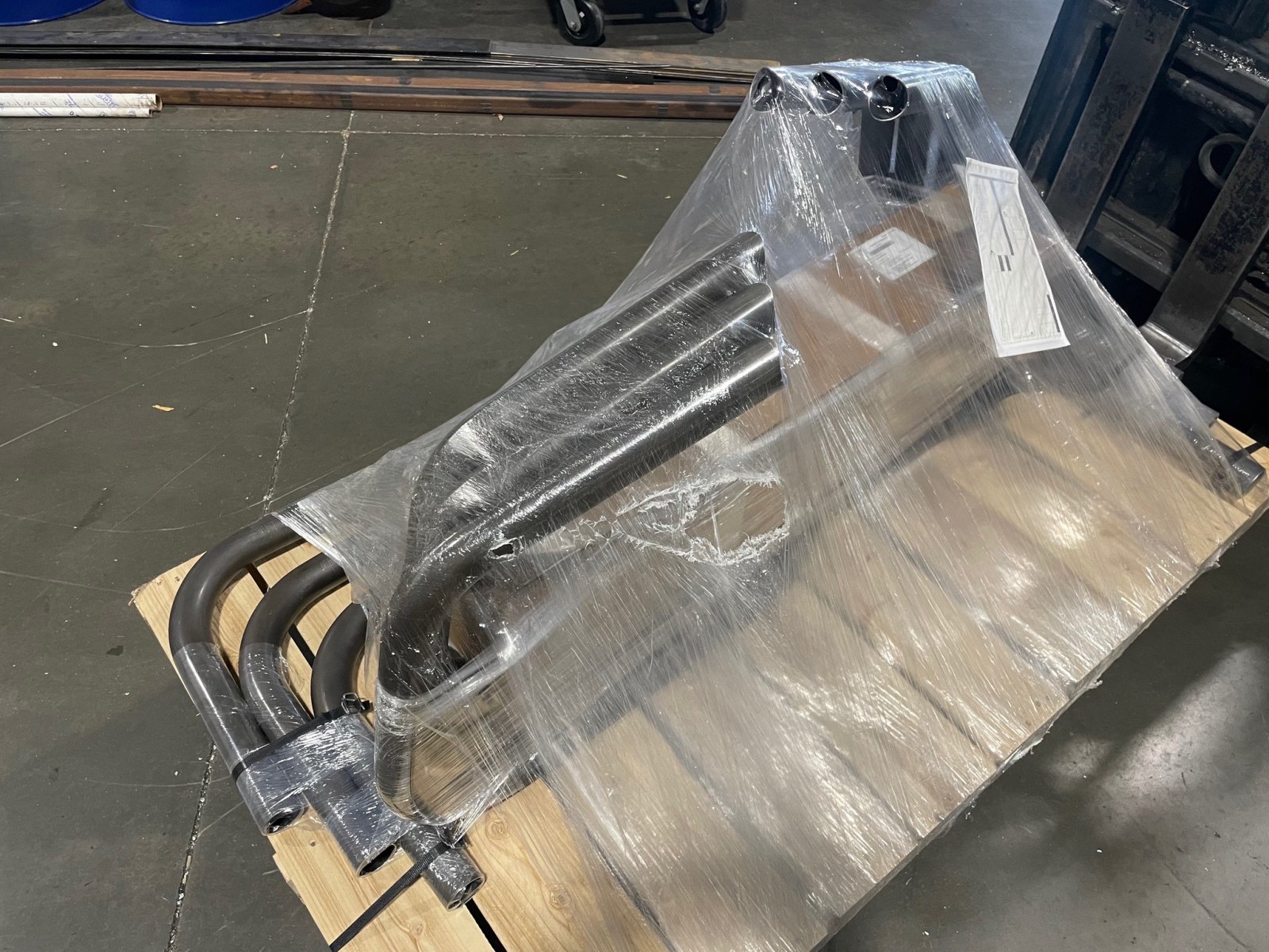

    Where do you source the tube bending?

    Can you share the job shop for the tube works please?

    https://vr3.ca/
    i sent them the solidworks model of the tubing and 3 days later it was on a pallet on a truck!

    4130 steel, mostly 2.00 x .065 and some 1.00 x .120

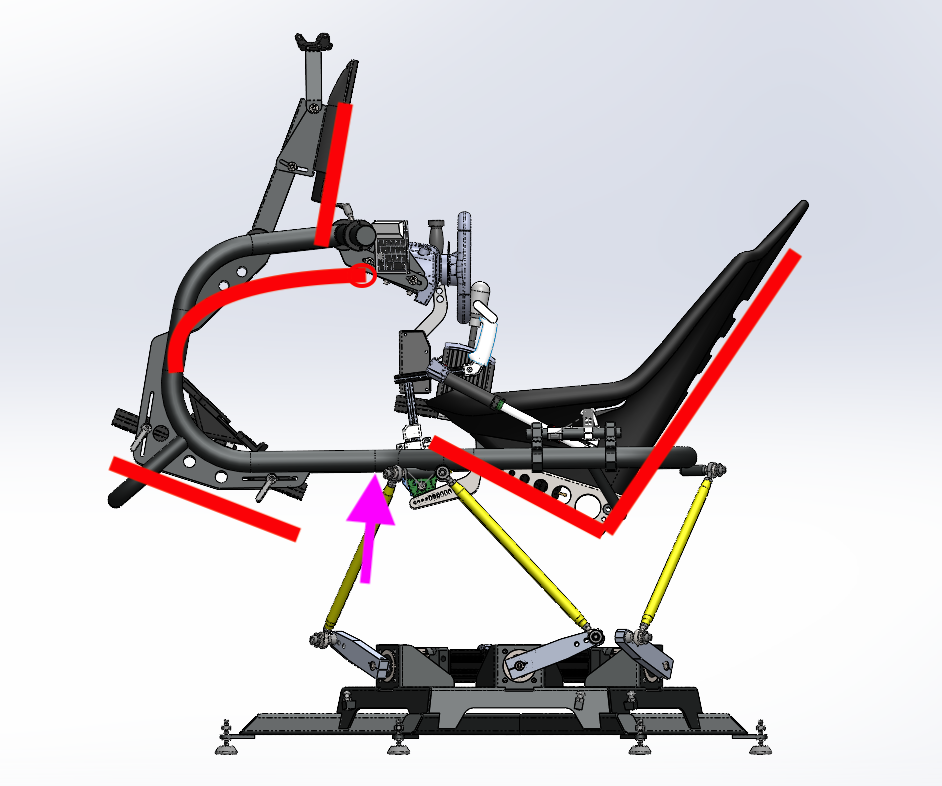

    I have a question, if you were to make another one, what would you change?
    I mean it looks perfect from an outsiders perspective (well mine anyway) but as the user, you will have indepth knowledge, about little things, that you would do differently if there were that "next" time.
  12. smitty
    smitty Active Member
    Aug 24, 2021
    154
    962Coins
    +211 / 2 / -0
    Not a whole lot!
    • One thing i was thinking about, would be to drop the seat/pedals about 100mm, (red lines) while keeping the bottom tube in the same spot. this would also lower the upper part of the bent tube and monitor. It's not hard to get in/out but this would make it easier. Lowering CG is never bad.
    • The tube at the purple arrow is a weak spot. the whole forward pedal/monitor part of the tubes comes to this point, and there isnt much there to prevent bending. on frames #2 and #3 we did add some thin gusseting under the tube to help. My frame doesnt have the gusset and it hasnt been a problem, but i get some resonant vibration from that frame section bouncing up and down.
    • A softer chair maybe? i covered this hard plastic chair with 1" foam but it can still be a bit rough. i've looked at other sim seats but many are just too wide to clear my heli collective. other seats that were the right width didnt have the shoulder harness cutouts that i need. i keep looking but i havent found a good replacement yet.
    Other than that, it's been pretty much maintenance-free for almost 2 years now, and im in it nearly every night

    Wow... so even 4130 steel 2.00 x .065 tube alone is not rigid enough? Is it flexing during motion (vibrate) or more flexing during braking (pressure from the feet)?

    Its plenty rigid, theres just a wee bit of vibration. if i wanted to fully "overbuild" it, there should be some triangulation tube going from the "dashboard" tube to alongside the seat on the right side (i enter on left side)

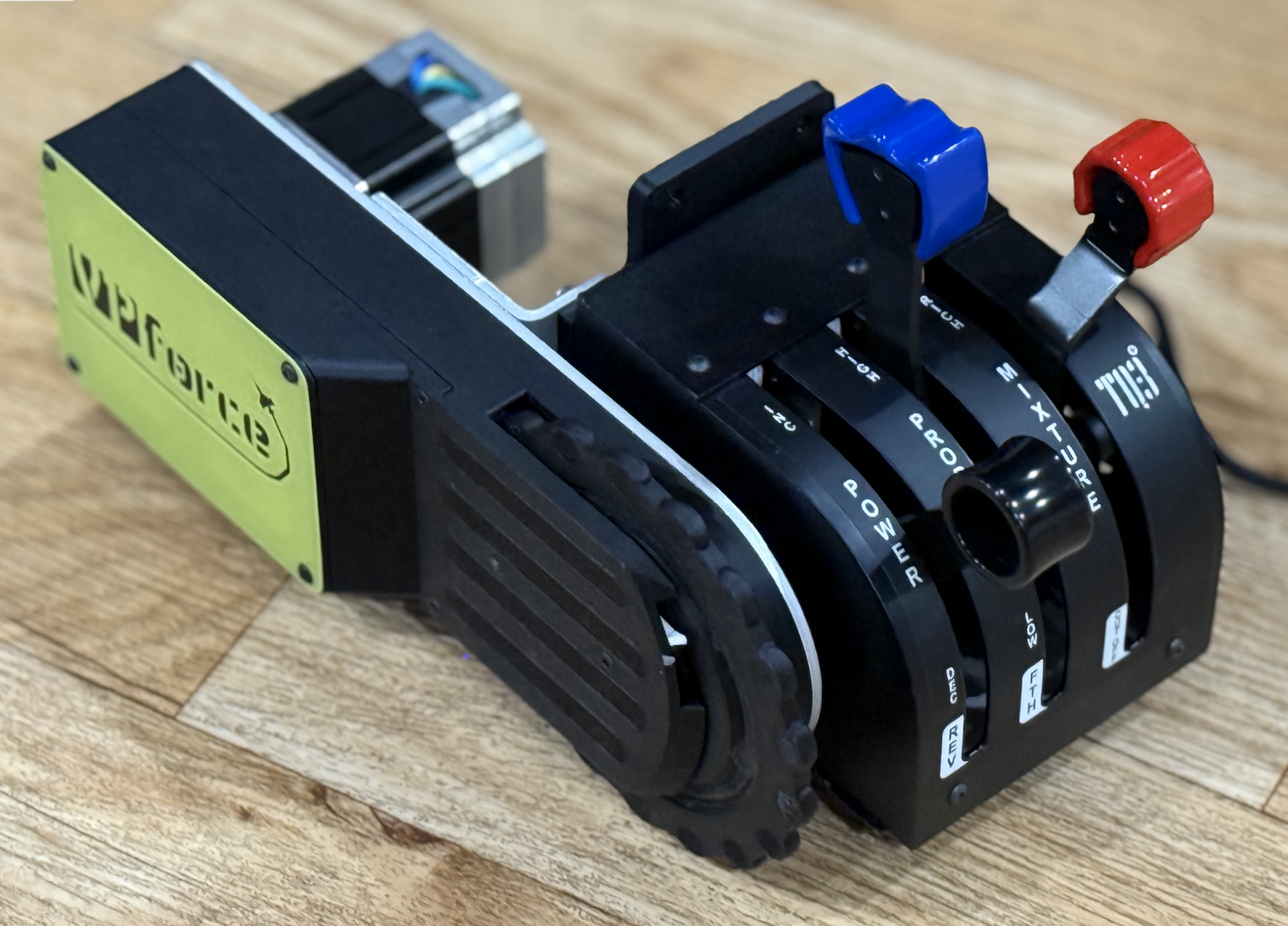

    The 11th motor!
    Using yet another VPForce motor, i made a motorized trimwheel. I always kind of hated the simple potentiometer trim wheel, it worked, but everytime the msfs autopilot moved the trim in game, touching the trim wheel sometimes meant a violent change as the peripheral sent a new number to the game.
    Now, i can use the autopilot or stick trim buttons and it moves the wheel. or, i can move the physical wheel and it updates in game.
    also got a used VirtualFly TQ3+ from ebay, its such a nice unit
