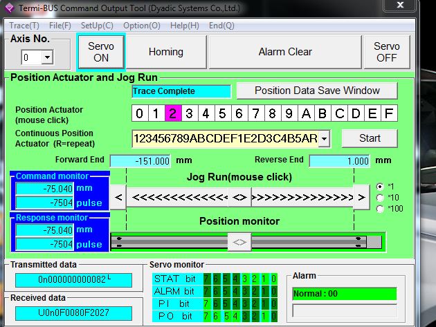

    Problem occurs after every windows restart (or logout).
    Usually i have axis limiter at 90, but now i tried to set it to 50% (before test on "working ok" mode), tested, restarted and back to "not working":( - no change there,
    I also checked for alarms at TBVST - no alarms triggered..
    Right now i bet for power cables, that´s really the last thing all acurators have in common and which i did not replaced yet...

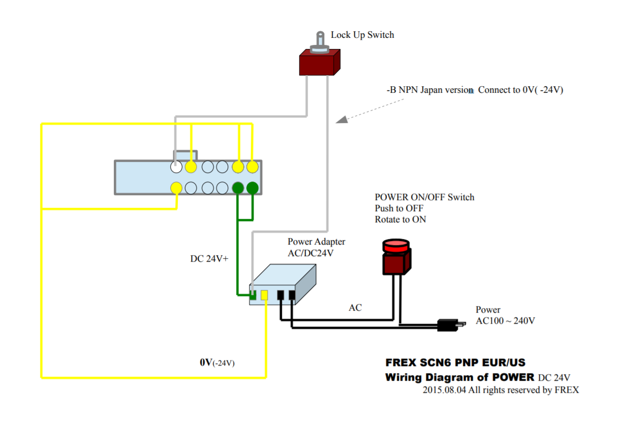

    I have this power connection from Frex. I have checked the cables, but can not find there any Z diode or resistors. Could it be a problem? That might explain it...?
    Can somebody please help me and show me on diagram where to put Z diode and resistors? Also, diode should be 27 volts, but how many Watts - they are different. And i have all three acturators supplied by one power source and via one cables - shall i put diodes and resistors on all cables? (three diodes and resistors or just one is fine..?)
    Many many many thanks!!!

    Wires seems ok (bought the wire kit ready from frex, but i double checked it and add the Z diode and resistors which were not present - but that does not change anything..).

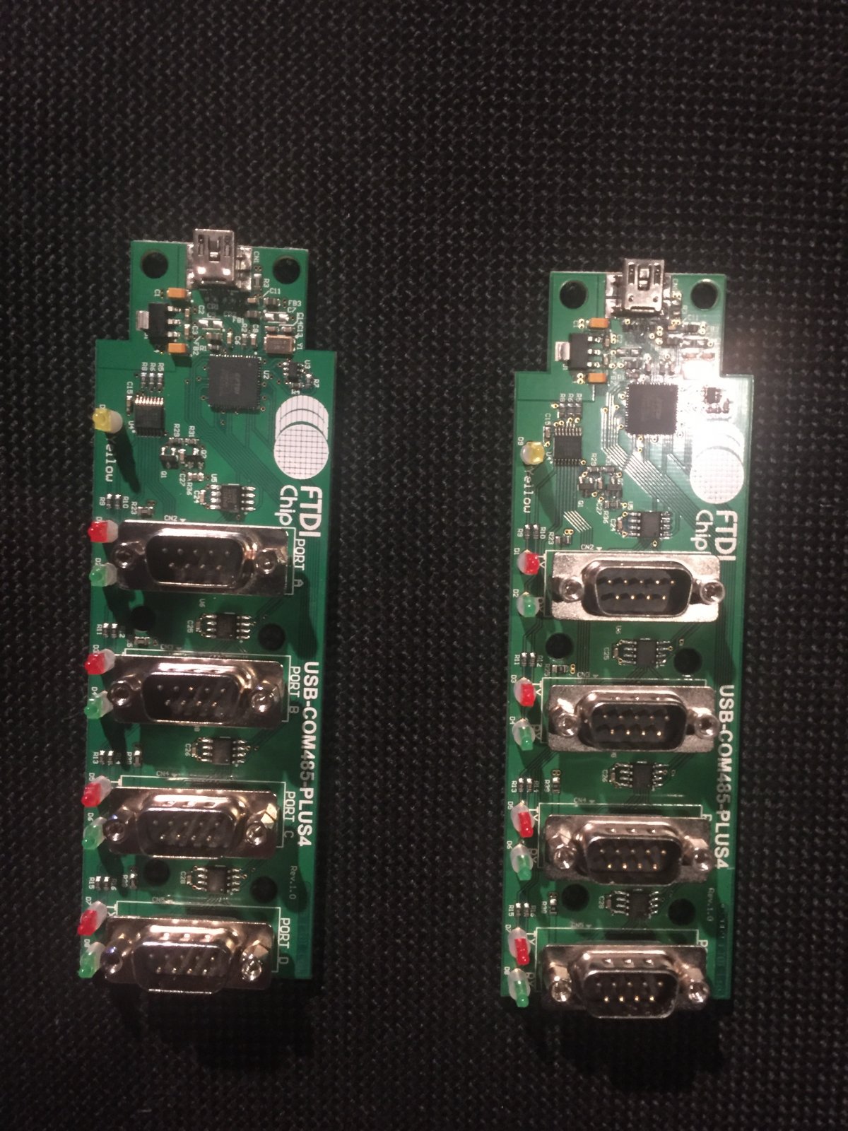

    Ok today did some more tests. As i arrived at first - it was working ok (computer and psu was disconnected from power all night, otherwise everything connected together) - no problems, could play with smoothing and no change in output filter. Then i jumped to assetto, then back and again the same issue - smoothing very very slow and jerky in output testing:( other filters does not seem to make any change, only smoothing..
    Ok so i tried all three motor one by one - no change. Every single motor behave the same - slow and jerky.
    Well then i spent some little time looking for some decent motion - it looks like it will work ok but i had to put down main filter in game manager - seems like something like 75% will do the job. All other filters in axis assigment at 0, 15k speed / 200 accel.
    But any other strange thing happened:D i order about week ago another FTDI RS485 (exactly same 4 port like i use) - so i gave him a try, but i cannot connect that one at all:D i deleted the old one completely (because when i connected new on the com ports assigned were bigger then 10), connected the new one and nothing... Even the TBVST or simtools can not connect to any SCN. It looks like it is "touching" at it (red and green diodes are flashing), but simtools does nothing and tbvst reports error in comunication finally. Strange, because it is exact same device like i use normally with exact same settings / drivers on same computer..
    There are no jumpers to choose connection type there..

    That looks exactly like the "premium cord" i got for testing..
