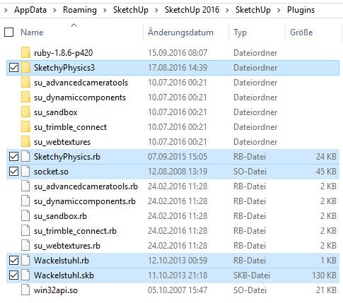

    Ihave 32Bit version of SketchUp 2016, pasted all the files, @noorbeast posted, in my plugin directory:
    SkechyPhysics3
    SkechyPhysics.rb
    socket.so
    Wackelstuhl.rb
    Wackelstuhl.skb

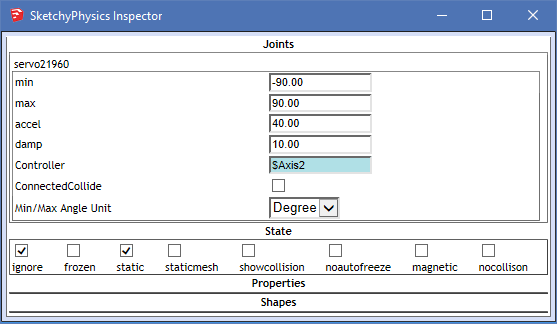

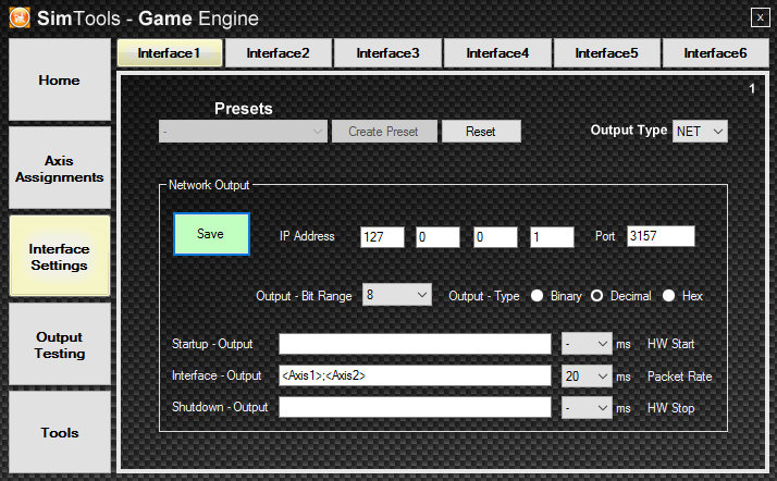

    I have renamed the axis in sketchup to $axis1 and $axis2 and changed all the values in game engine according to the DIY tutorial but the model does not move at all. Does someone have an idea why it does not work?

    You need to duplicate the instructions accurately @sww, it is <Axis1>;<Axis2>;<Axis3>;
    Note the capital A in Axis
    Also make sure you hit the SketchyPhysics play button to activate it in SketchUp.

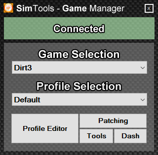

    Thank you, but it still does not work. I have renamed the axis in simtools and SkechUp to axis and have activated Play in SkechyPhysics. May there be a problem with GameManager? it is saying "connected" but not something like game running.
    22,032
    153,788Coins
    +11,150 / 57 / -2
    The most likely problem is misconfiguration, not GameManager.
    What are you language settings: https://www.xsimulator.net/community/faq/language-setting-bug-change-to-english-local.233/
    And please post screenshots of all your settings.

    This are the files in my SkechUp plugin directory.

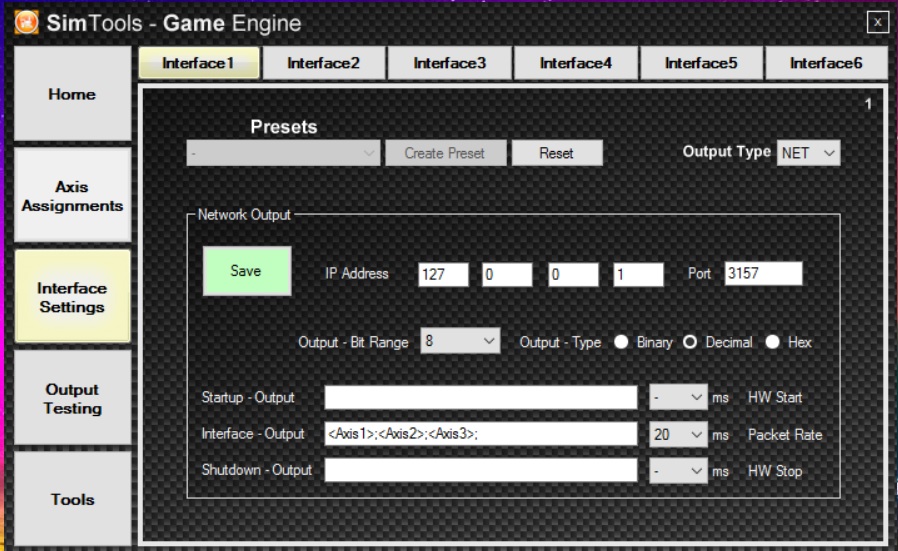

    Simtools settings

    If you are using the supplied files @sww, including the default model, then you should not be making changes in SketchUp and should be configuring the Interface Settings and Axis Assignments exactly as specified: https://www.xsimulator.net/communit...-to-work-with-sketchup.5340/page-2#post-96846
    You are welcome to change the model, configuration and model later but the reason I packaged this all up in the first place with pre-configured settings is that people had real trouble with which version of SketchyPhysics to use, when and when not to use upper and lower case naming conventions, it is lower case in SketchUp and Upper case for SimTools, and designating which way the axis are configured.
    My best advice is start from scratch, re-download everything including the model, configure it exactly as indicated to get it working. Once working then you can change how many axis and the model itself.

    I have tried <Axis6>;<Axis2>;<Axis3> and <Axis1>;<Axis2>;<Axis3> in the interface settings, because the first axis in SkechUp is named 1 but in the tutorial they took the number 6. Either way it does not work.

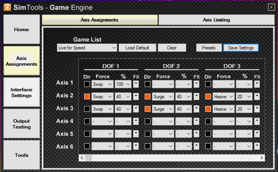

    Before we get into possible game patching issues can you please check output testing in SimTools with the tutorial values used in the default profile.
    Best to test with LFS if output testing is OK, make sure you patch it for motion.

    With dirt 3 if it is 64bit it is patched for motion in the game folder inside my documents. For 32bit you patch to the game folder.

    I have now patched the game folder and game manager is now saying "game running" which it did not before, but it still does not move the axis in game engine > output testing > virtual axis

    Each game needs its own motion profile and the settings supplied were done for LFS, as that is the default plugin installed with SimTools.
    At the simplest end run a base setting for the Tuning Center: https://www.xsimulator.net/community/faq/set-base-tuning-motion-values-in-the-tuning-center.122/
    Here are the full steps to creating a motion profile: https://www.xsimulator.net/community/faq/steps-to-create-a-motion-profile.228/

    Tuning center does not read the values. Even though game manager is showing "game running"

    Try unpatch the game, run a few laps without motion to generate the correct files then re-patch.
    This is a Dirt 3 configuration issue, not a SketchUp/SimTools issue so perhaps best to start your own thread about it if my suggestion does not work.
