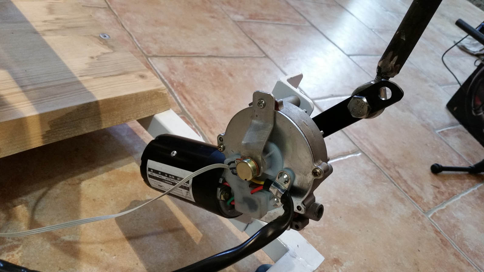

    Sorry for the late. The power write on the motor (50W) It's a mistake. I try the motors, for 12V I use 26A for the max torque that I mesured 18Nm. P=UI = 320W real.
    the motors use 50W about 4A without load (I mesured it). I put a controller between the battery and the motors.
    I just finish to control them. I Put potentiometer on the back with an arduino controler and it look like good. Very reactive.
    I mesured real 40kg with a lever arm 4.5cm. It's more than a lot of motor I tried. For the moment I don't try it on a simulator.

    Strange, I mesured it.
    The spec of the constructor is 28Nm, and the same current that I used. Perhaps the motors can't works a long time... but I try them during 10mn and they don"t warm.
    For me the most important are the reality, no only the spec...

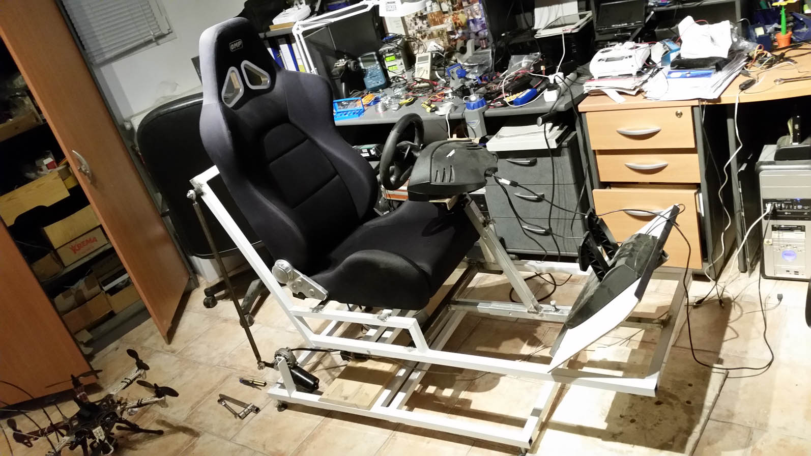

    I just finish my simulator with this motors.
    I mesured the curent: it's 45A max for the 2 motors.
    One motor warm a little after 20mn game
    I have 6.5cm "lever arm" "moment arm" I don't know the name in english. This afternoon I try with second option 8.5 cm. Like you can see on the photo I have a second option.

    Nice rig, But not likely the Wiper's will be able to deal with much more "lever length" 6.5cm is the same as I run with 2X as powerful motor's on a Seat mover setup. Your seriously over working the wipers with those levers.

    ... and I expect no aggressive movements due to the fact that the motors are overloaded. Dear @nikitojm I respect your great work but there is a long experience which says there is a divergence between the specs and your measurements. I would like to see a video soon which is much appreciated.

    Hi @nikitojm, your rig is almost very promising, good work so far. There are some minor points which honestly I would like to point out:
    1. The joint shows some slackness, too weak or not stiff enough.
    2. The seat is sticked/mounted too high over the joint which results in a wider radius of the movement to the left/right side which are not real.
    3. The speed and reaction time is not bad (I dunno your SimTools/SMC settings), but the 600W seeing on the display is way too high for the standard movements, probably this is the max. output but I have my doubts, perhaps the multimeter shows wrong values.. If you want to test and confirm these values you can use a car fuse between the PSU and the MMs - lets say 15A - and ride your rig until the fuses blows...
    NTL you have a nice working rig, now you can spend a lot of time on the optimization :)

    It moves, Thats the important part.......little tip, DO NOT use a Stiff F1 car for base profile testing, It wont do you any good. A street car or Mild race car (GT'ish) will be a much easier to tun your profile and Tuning center #'s around.
    Also the older games dont have As Nice of motion as the newer stuff does.

    I'm doubtful about the motor mount with only 2 holes... it will wear and fatigue the motor body.

    RacingMat, I know for the 2 holes, it just to try the ebay motor.
    Merci RacingMat pour tout vos super tuto!!!
    Je n'ai mis que 2 vis mais le support moteur appuis sur ma cornière de fixation qui est du 5mm. Mais c'est juste pour essayer.

    @Pit I put the seat more back and it's better.
    I control the curent again. Like I said 49 A it's the maximum current (600w) during a big movement. During a normal race I use just 1A for 6mn playing, around 10A, 120W.
    I try with other game and other car, it's better on durt.
