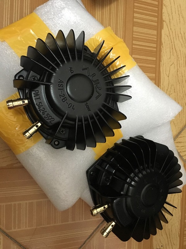

    If i just add 2x 50W Aura under the seat. Will it have good effect on flight sim? If i only use sound card output signal for the source of Aura.
    Will it have good effect on Flight Sim?
    22,124
    154,370Coins
    +11,179 / 57 / -2
    2x 50W Aura transducers are a good start and you will feel things like engine vibration and the 'thunk' of wheels retracting.
    Keep in mind you can start there and if you like the effect add more transducers later.

    2 Auras under the seat should be okay. You want to get them as close to the seat as you can because they are not very powerful. Ideally bolt them directly to the seat if it is fibreglass, if not then make a bracket right under the seat.

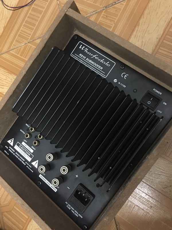

    SimShaker and SimVibe also not support my FSX/P3D~ I am planning to use normal Sound card output signal.
    And using Low Pass Filter to make my Shaker work. Just order 2x aura and 1x JBL 250W RMS subwoofer amp. board(disassemble from JBL RS10).
    What Hz should i set on the LPF setting?

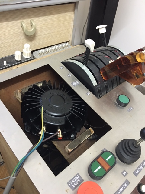

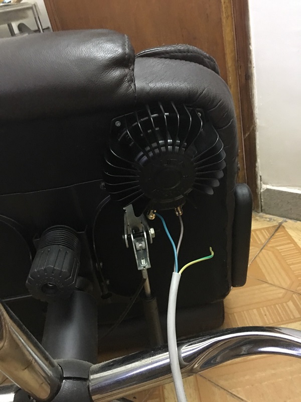

    Already test with my Amp and shaker~ It Great even i just install one on the seat.
    Still waiting my parts for building for my motion sims. :thumbs
    My RS10 250W RMS/400W Max Amp. Can push arround 4-5 Aura 50W
    Cost 81USD including shipping in China.
    Install one for testing. Will install more in motion sims seat~~After try it, i think it MUST in my Sims seat!!!

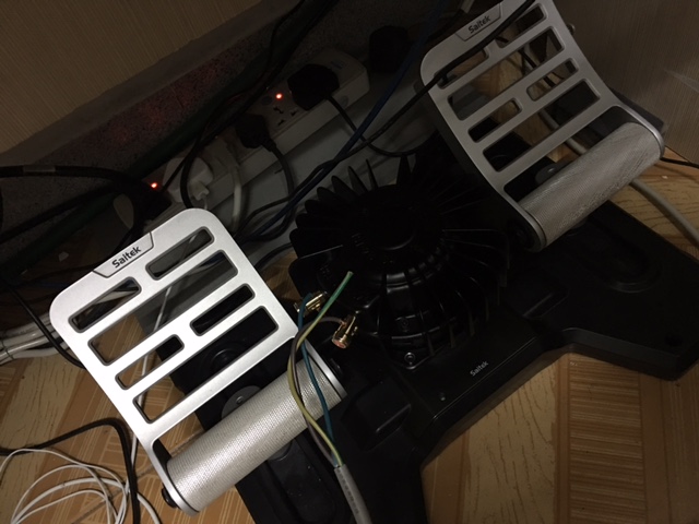

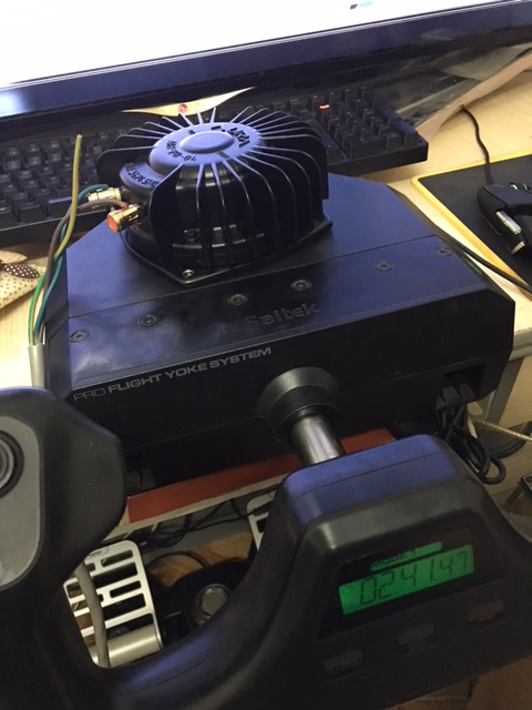

    Wowo~~Testing with my Yoke, throttle and pedals.....The feeling is RIGHT!!! It make all things have life.......Just Re-order 3 more and mount on it....LOL:cheers
