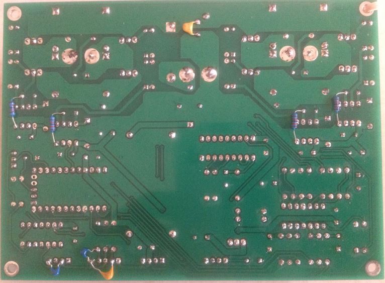

    [QUOTE = "RufusDufus, post: 130873, member: 8539"] Eu tenho algumas placas extras de "teste de campo" para venda se houver algum Aussies que gostaria de um. Eles são $ 150 + $ 10 de frete postal padrão com assinatura. Para comparação, o preço esperado dos conselhos finais será de US $ 220 + envio. Pagamento por paypal.
    Essas placas são construídas à mão e possuem componentes na parte de trás delas para trazê-las para as especificações de construção final, conforme mostrado nas fotos.
    39471

    Yes the field trial units were all sold. I make small batches at a time when I get requests. I have put your name on the notification list for when more available.

    I am a qualified electronics engineer and spent much of my early career developing products. These days just management and reporting so I do these projects to satisfy my engineering interests. I chose the stepper motor because I had one for testing and liked the challenge of designing the controller for one. Parts were readily available and yes relatively low cost motor.
    Yes a DC motor can be used and has been. Check out @Alexey's post https://www.xsimulator.net/community/threads/diy-ffb-steering-wheel-mmosffb-in-progress.7769/
