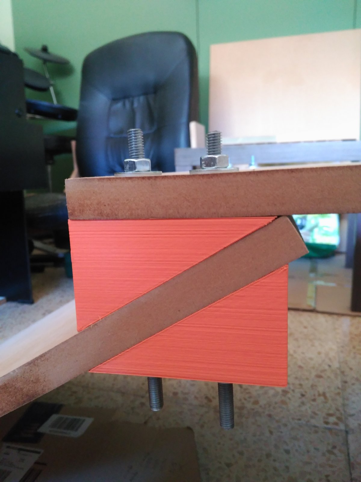

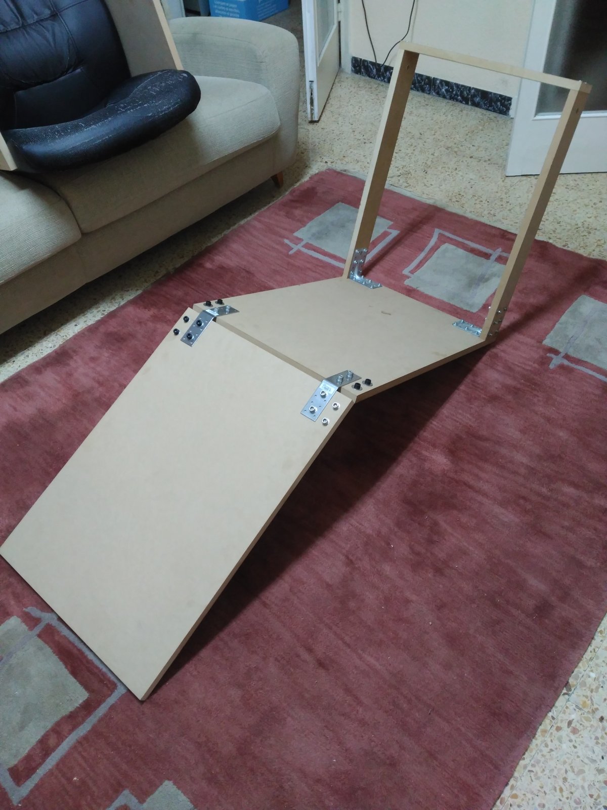

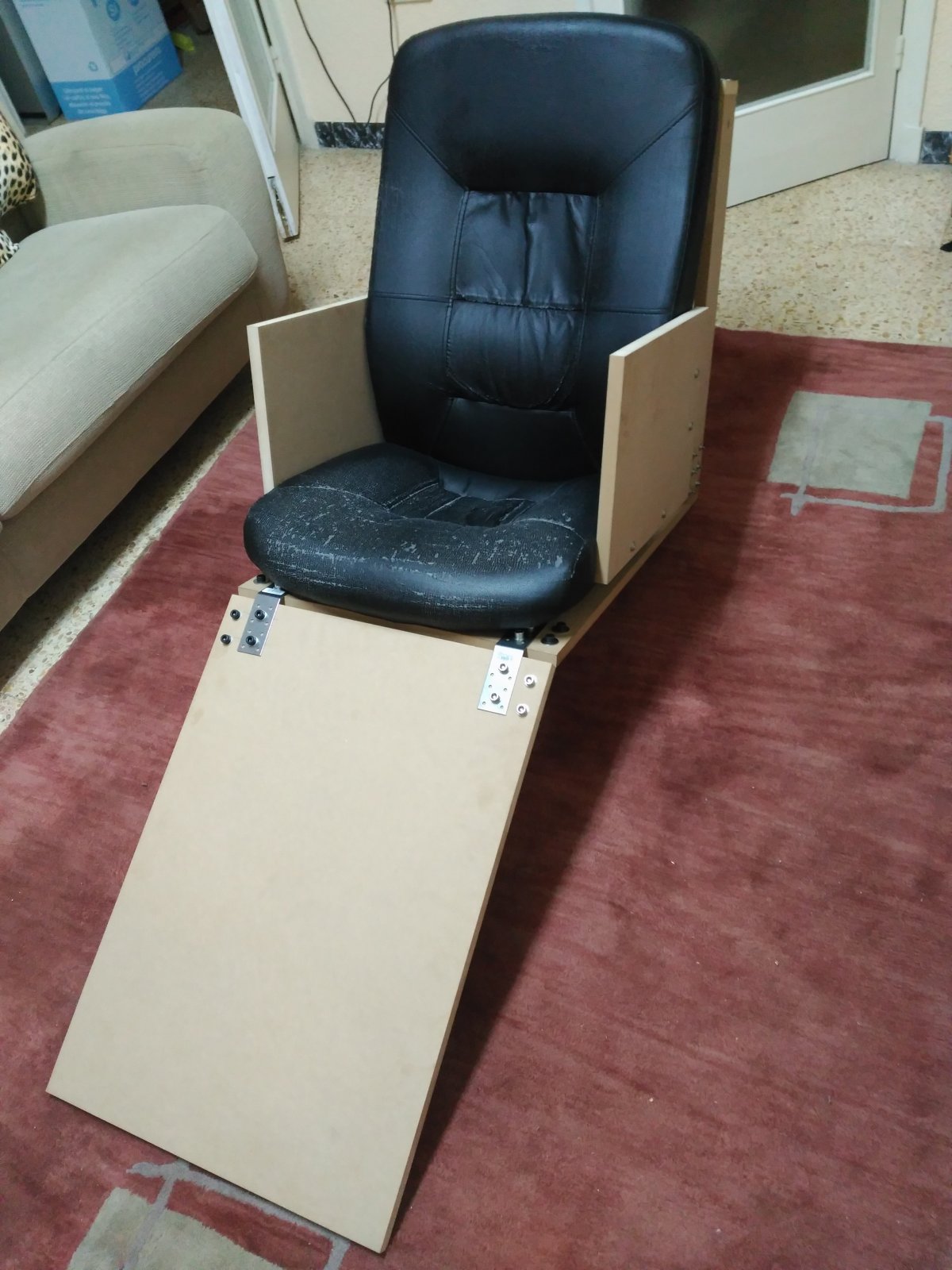

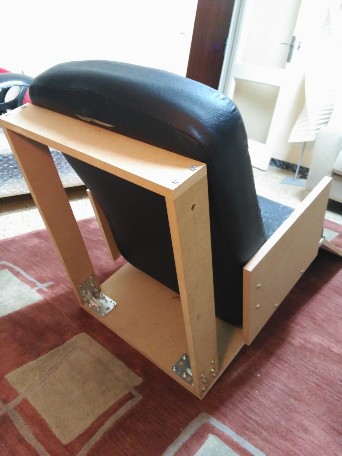

    Finally some progress!
    I decided to use only DM wood because it looks strong enough for this build (and it's cheaper). I still have to shape some of the boards, and I may change the footrest board attachment because with these 45 degrees brackets it'is flexing a little.

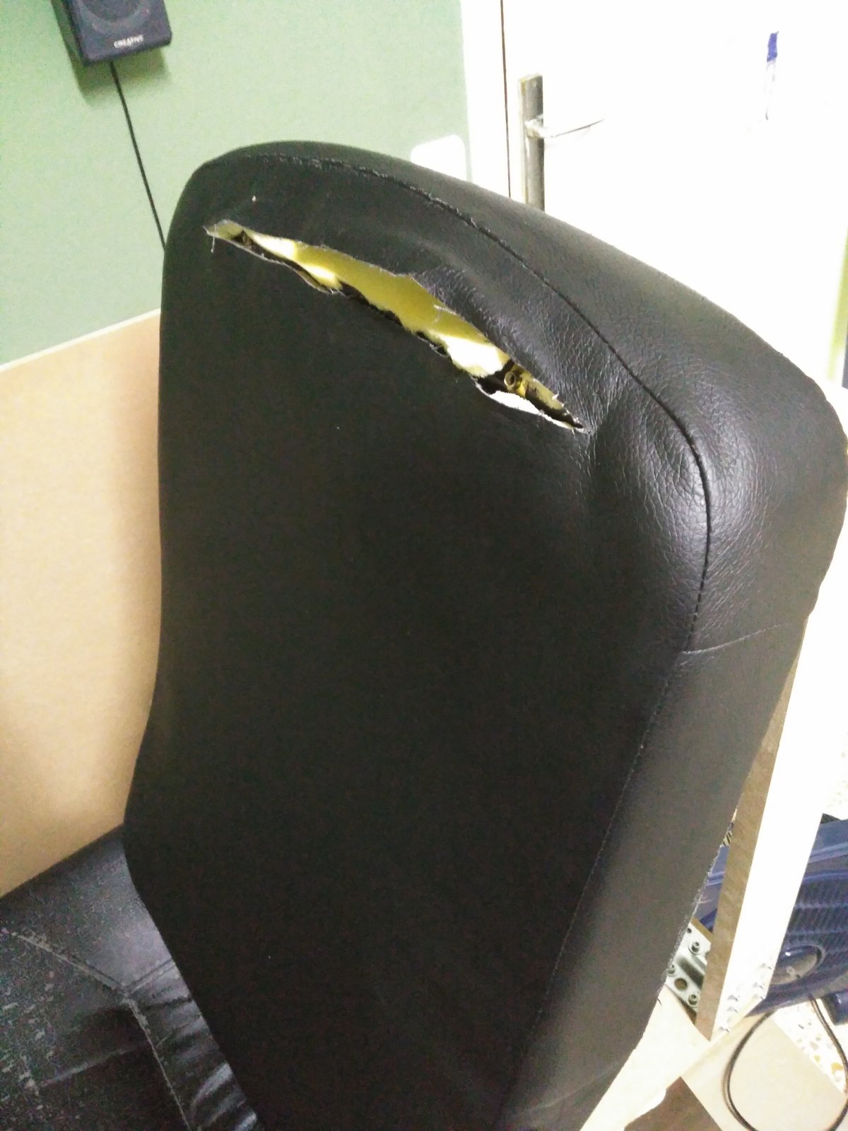

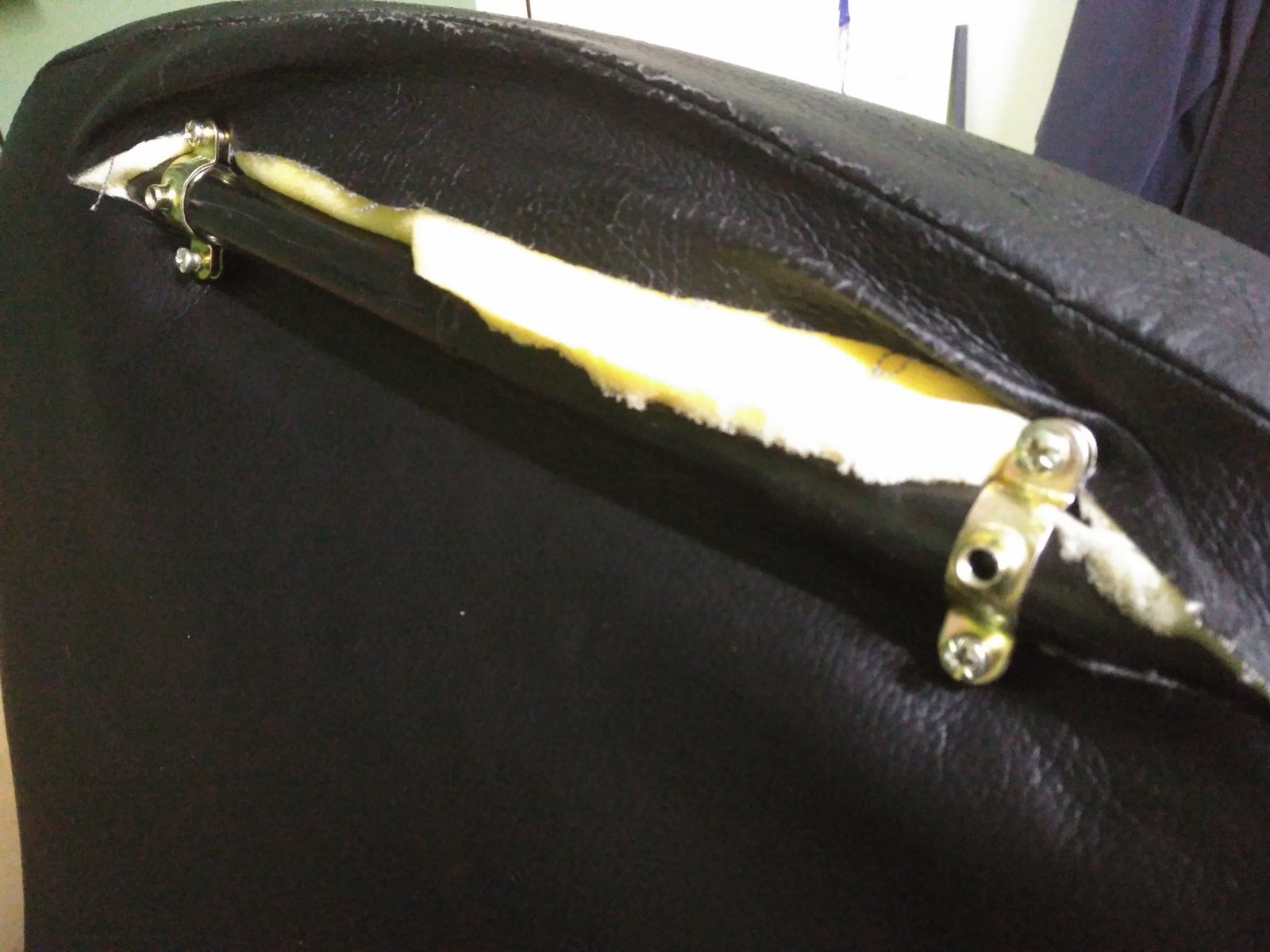

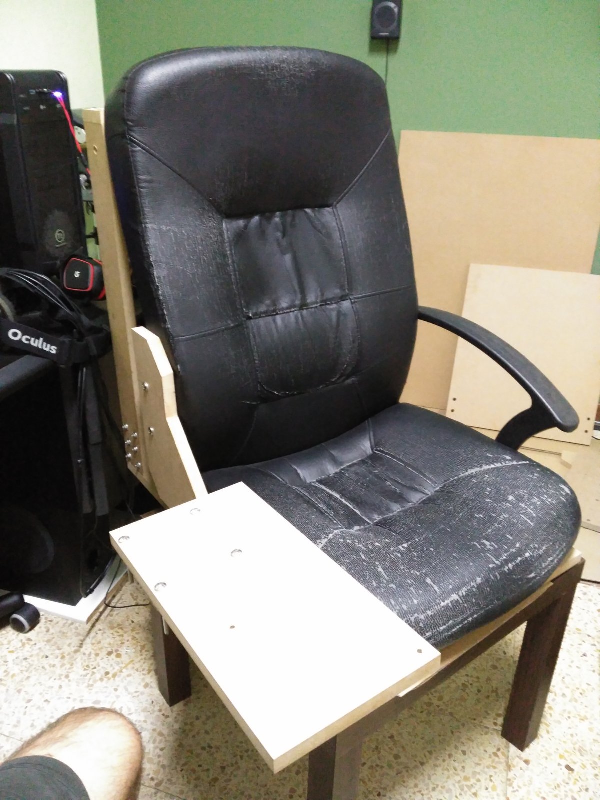

    Had to destroy the chair a little in order to get to the inner tubes. Now I can attach the chair to the frame from behind too.

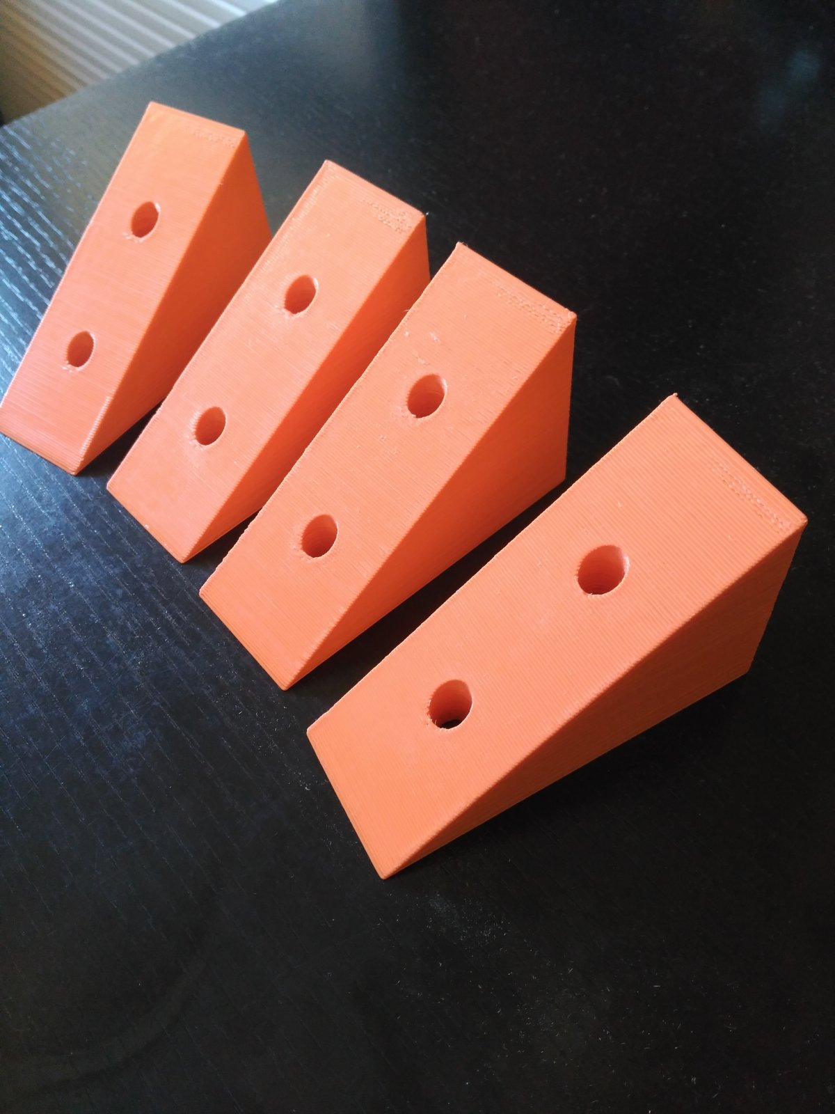

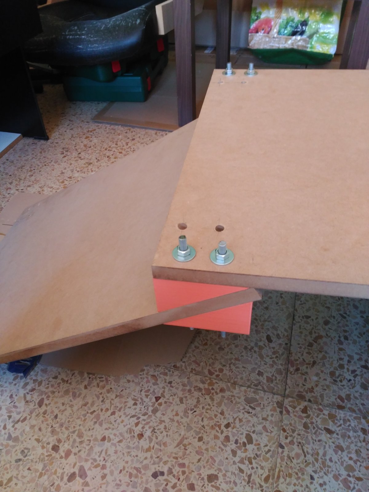

    I changed the footrest board inclination from 45 to 30 degrees. 45 was to steep and I would have to raise the chair too much in order to avoid floor contact in high pitch situations.
    As I couldn't find 30deg brackets, I printed some custom parts with my prusa and used some threaded rods to attach the boards. The result seems pretty solid at the moment.

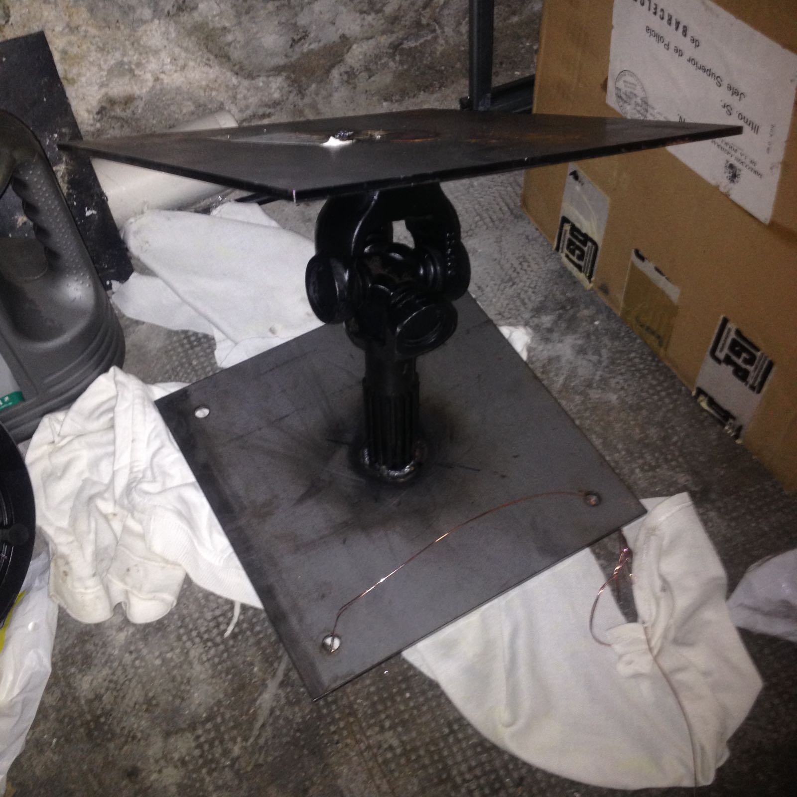

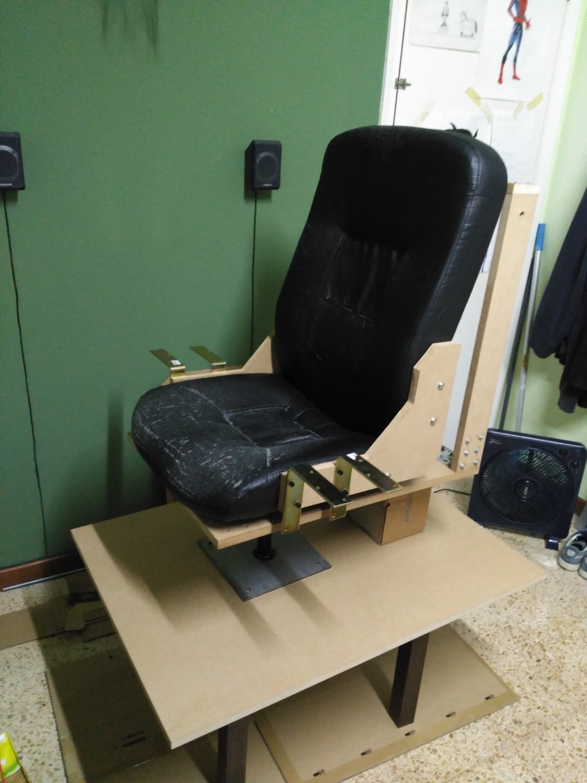

    And finally the u-joint got some plates attached! :D

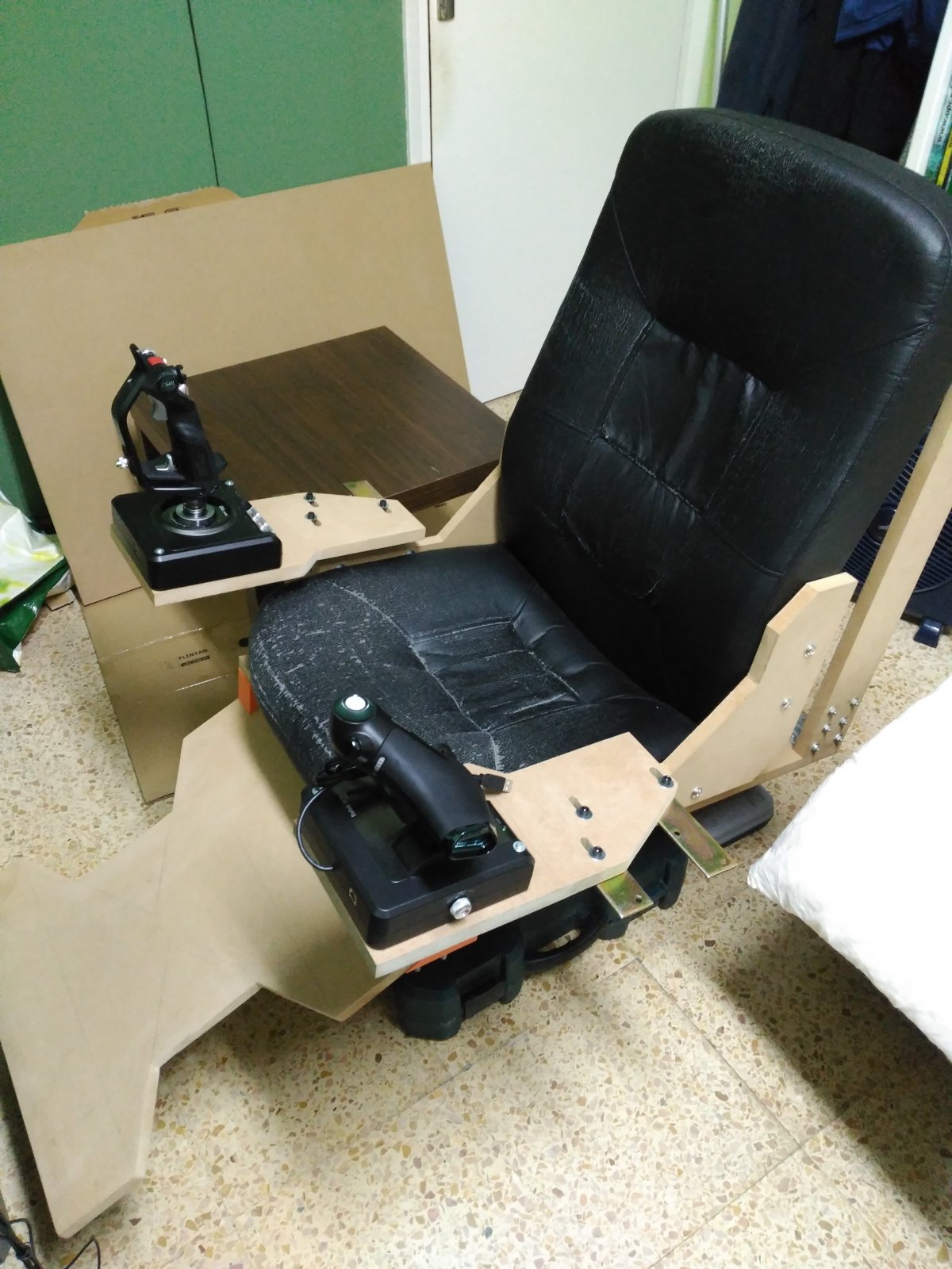

    More progress!

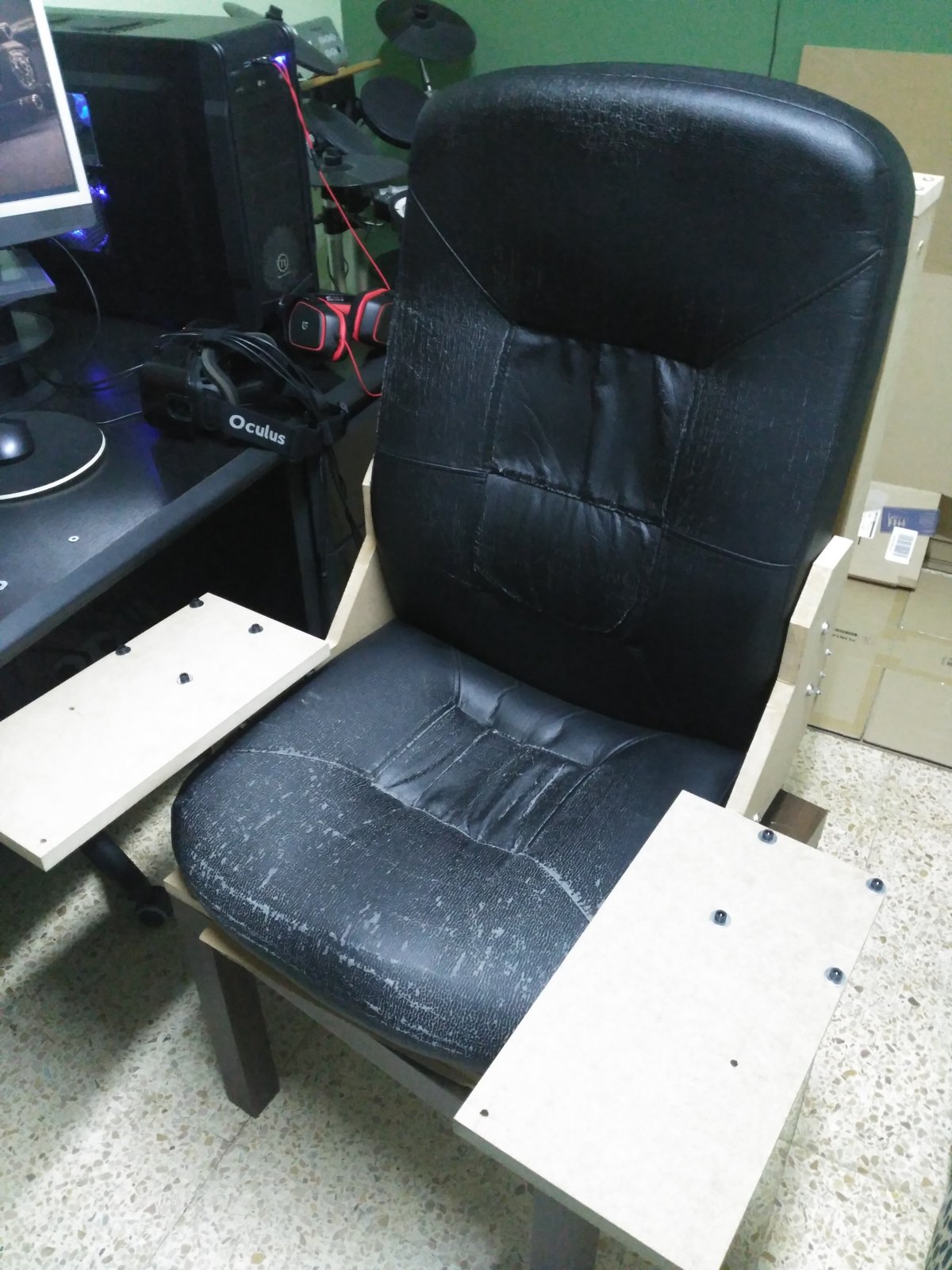

    Some wood reshaping done. The rig is looking way cooler now!
