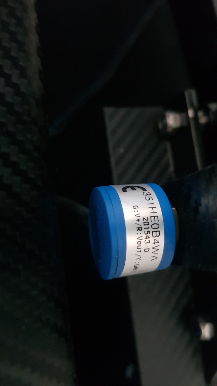

    Dont know if it is okay to post it here?
    Else I will post it elsewhere? :)
    Using this plugin with a 2x32 Sabertooth.
    As you can see in the video my leverarms have a bit of slack?
    Is that normal?
    Know there is a little in the gearbox and the coupling.
    Everything is as tight as possible.
    In the SMC3 utilities deadzone is set to 0.
    Could it be my potentiometers?
    They are hall potentioneters from Vishay.
    But as you can see in the attached pictures there is one from SMC3 utilities showing a green bar.
    That is from min to max position.
    On the old type I had (cermet) the green bar had a bigger span?..
    Thanks in advance.
    Simon

    Simon,
    No Idea really.
    Naturally because of the design there has to be clearance which translates to backlash in any gear set.
    What ratio are the gearbox, the standard 25:1 or the higher 50 or 60:1
    Noorbeast had problems with the standard 25:1 motors back-driving under the weight of the sim and that was solved by going to the higher ratio.
    I myself went for the 50:1 ratio and it does not move with me in the sim playing a driving game with no motion as yet and there is a fair amount of weight
    and leverage acting on the motors.
    I just had one thought and that is did you remove the gearbox from the motor at any stage as there is a rubber X shaped bumper that fits between the motor's output
    shaft and the matching drive flange of the gearbox.
    If that was missing for any reason it would provide a large amount of backlash between the two which would create such an amount of movement ?
    I just watched your video again and I hear a definite clunk sound when it changes direction and
    that makes me feel even more that that buffer might not be present.
    BTW does it do it on both sides ?

    Hi @Deane :)
    Thanks for your reply.
    Appreciated:thumbs
    My current gearboxes are 25:1s.
    Actually I had the 50:1s before those.
    They didnt have any problems, and as you write yourself cant back-drive.
    But I missed some speed and got some 25:1.
    They does the job perfect.
    But this little problem just annoys me a bit now.
    But in many ways a 37.5:1 gearbox right between would be the best fit :)
    You mean the rubber coupling between motor and gearbox. But that is fitted, and fitted correctly.
    Asume without it would sound quite awful because of the 2 aluminium parts together.
    The video is taken just beside the electronics/fan/gearboxes etc, so all the noise sounds alot worse than it really is.
    Both sides are exactly the same.
    Just curious if it is the potentiometers?
    Looks od the feedback isnt with a full 5v output.
    If it have been that perhaps the software have had a better "resolution" to see the feedback and mayby have been more precise to hold the motor/leverarm in neutral?

    Hall pots don't output 5v. They output .2 to 4.8 volts.

    Exactly @BlazinH..
    Thats why the bar in smc3 utility doesnt show full scale.
    Do you know if that can interfere into what I showed in the video?..

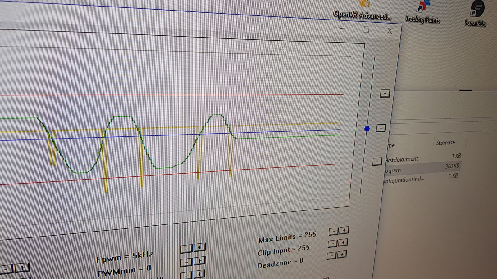

    I don't use smc3 myself so I'm not very familiar with what the graph is showing. But I would try increasing kp and adding in some ki and see how that responds.

    Tried adding sone Kp and Pi.. Again..
    Doesnt do any good.
    Drives back to neutral faster..
    But the leverarm moves just as much.
    Tried ordering new pots yesterday.
    The ones I have from Vishay doesnt give 5v at min or max.
    When I receive them and they are fitted I will let you know :)

    I looked up your hall pot model number and it looks like the biggest issue is they're 360 degree. Using 180 degree pots instead will double the resolution as it appears 180 is all you will use.

    Those motors should do better since they have more torque. In any case doubling the amount of kp that would be used with a 180 degree pot should have about the same effect since kp x error = power. The "steps" in the power will be more notched but that doesn't necessarily mean you will feel them. Since they're already ordered might as well give them a try.

    Got my new potentiometers yesterday.
    Got them mounted and tested today.
    The slack is now very much to a minimum.
    So thats great. :)
    But when I start up the rig and the motors drive to "neutral" they start to oscillate until you put some weight on the seat.
    Have tried with adjustments of more or less everything in SMC3 utility.
    The graph shows a nice bar in smc3 utility, so doesnt look like its EMC related.
    After it has been powered up in a few minutes it doesnt oscillate anymore.
    Only just after reboot before entering windows.
    But the way it finds its neutral position at the startup seems more aggressive than after a few minutes?
    At power up it starts after the parameters in the arduino.
    After a few minutes when it doesnt oscillate, does any if you know if simtools control it and mayby havent as high values mayby?
    Remember it have done it a long time ago just after getting my ssbertooth, but it ended from one day to another rtjer quickly after and havent done it since.
    Just curious whats causing this.
