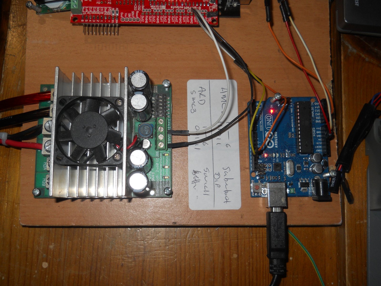

    After many failed attempts and late nights.
    I think I have solved it but I dare not jink myself as I thought I had it right before and fell on my sword.
    I removed the suspect Hall Effect Pots which I think one is stuffed and replaced it with some garden variety 10K Linear Pots
    I can now get each axis moving in the SMC3 Utility by selecting each mode .
    So hopefully it is now onto the setup of SimTools which looks like more reading and I hope there is a Simple Tutorial for Dummies on the subject .
    I am using your Soft Start Packet Serial Sketch edited to 38400 baud rate, Baud Rate or 38400 also set in DEScribe software
    Sabertooth 2X25 V2 dip switch settings 1, 2-Off 3,4,5,6-On
    So for the moment I am a happy camper and have put Mr. Ruger to bed ;);)

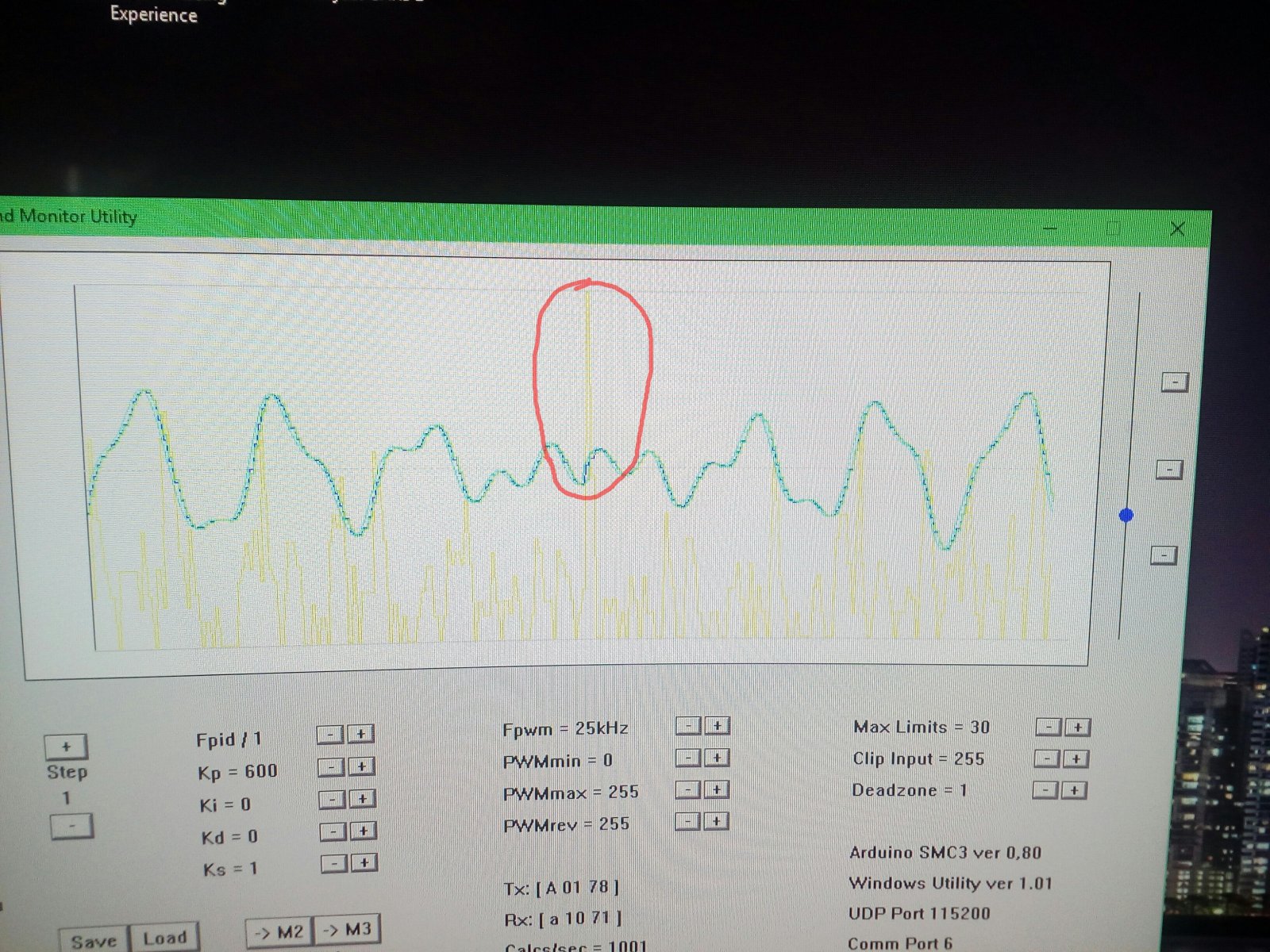

    Kann mir jemand sagen an was dieser Ausschlag liegen kann?
    die Potis sind neu es sind die Magnetpotis
    Can someone tell me what this rash can be?
    the pots are new they are the magnet pots
  3. BlazinH
    BlazinH Well-Known Member
    Oct 19, 2013
    2,145
    Oklahoma City, USA
    16,701Coins
    +1,840 / 32 / -1
    Possibilities include bad solder joints, bad wire connections, magnetic interference, and faulty pots. If its not any of those though it may only be Gremlims so whatever you do don't get anything wet. :rolleyes:

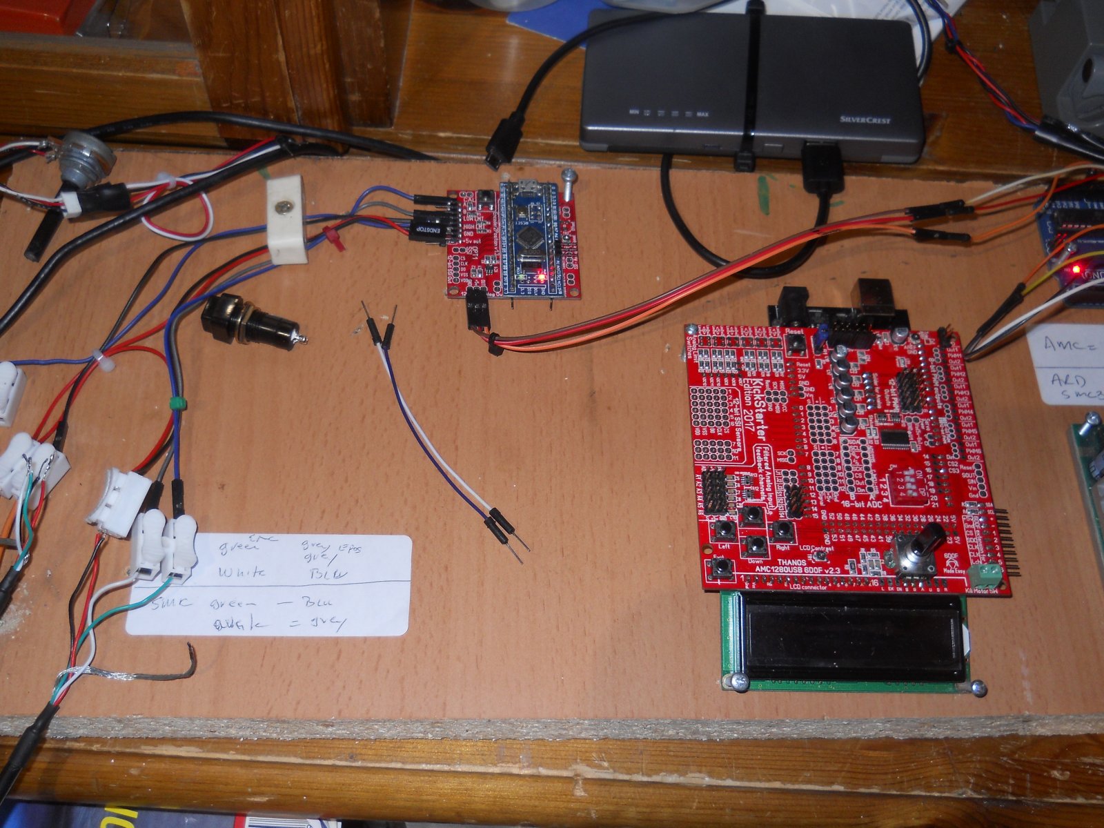

    Hi Guys mr warts and all back again after a layoff and decided to tackle this Interfacing option at the same time as im getting good results with my Encoder2pos Tetsing as well ..
    Anyway in the spirit of giving you guys a laugh and me with my Homer simpson Duff hat on I set up this Great Utility and for the last 3 day have read through this thread like crazy man... OK all connected up wiring checked, Software steps Followed ,2 brand new sabertooth 2x60 bought and ready to go .....Er Zip Nicht Nadda at the output No movement from test motor, SMC utility works A treat .Pot seen , Pwm seen all good that end .. three days of head scratching . describe using , more post reading . Rewiring check/ head sctratching and loads of Expletives mainly because I know this works but could not see the wood for the trees as to why mine was not working as it should ... 3 more Ards Bought same Issue ....ARRRRGGGGHHHH I know ive been away but dam this was crazy ..
    ok heres the Bit that made me look like the doofuss I am but at least I found MY MISTAKE Grrrr .. turns out in my efforts to do the simplest operation I forgot a key step. remember "Cant see the wood for the trees" saying .. Don't laugh too hard guys ( well at least try not to ) ...
    It seems I Validated the SMC sps code and seeing as the screen did not show any error message I thought the program was ok .........Stop laughing Guys ....did anyone see what I missed .......Er ya need to press the download icon ya dam fool man ..
    I knew all 4 ards I had could not be faulty and I also knew the utility works . so that left just the Operator .... serous amounts of humble pie being swallowed ..
    Blow me the Dam setup works like a charm .. Gotta say massive Thanks @ blazzinH for a great option .. now the next step ... will post an update on my other tests Ref Optical encoder /Sabertooth /Amc on my Posts ..
    Sorry to Ramble on @BlazinH but was just great to get this working the way you intended ...Happy chappy Cheers

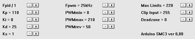

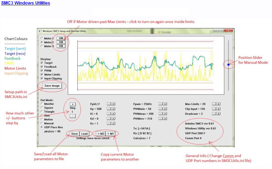

    I'm currently in the middle of tweaking my SMC3 settings but some reference values would be great! I don't really know if these values make sense?
    My setup:
    Sabertooth 2x32 (obviously) with 2x 24V 25W motors with 250rpm
    My current settings:
    My motors get pretty hot in-game (not glowing but hardly touchable) so I tried smaller power output.
    With this settings I have a smooth motion so far in SMC3. In Game with only Sway as dof output it still feels like a "stepping" motion.
    Do you have a similar setup and can share your settings and experiences with me?
  12. Pit
    3,007
    30,516Coins
    +3,098 / 31 / -0
    You could use lower PWMmax and higher Kp values (i.e. Kp=300 and PWMmax=150), Kd should be zero as a first attempt. PWMrev should be higher if overshooting the motors over the clip limit. I use the same value of PWMmax.

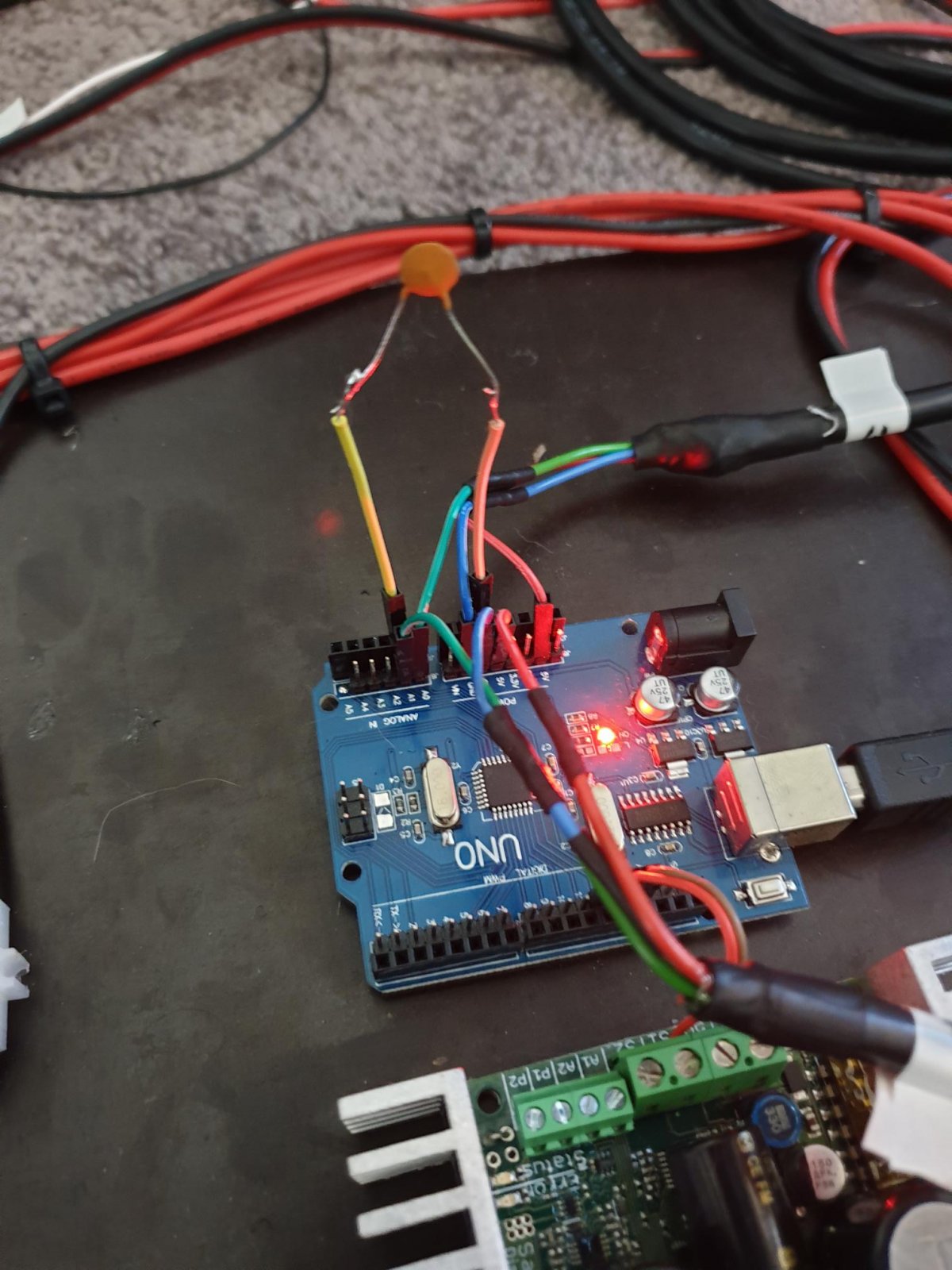

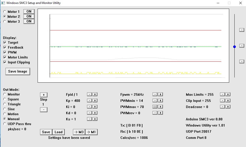

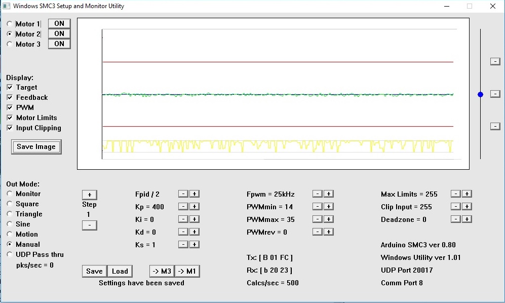

    Hey guys, not sure if anyone has a solution, but i am having a floating issue with my pots. the pots have a slight deviation when sitting still which force the motors to constantly chase the center. It seems like nothing i do smooths out this problem. tried raising the Fpid which makes it worse at low pwmmax values but better at higher values. Tried some PID tuning but dont think i'm going to smooth it out that much as its so erratic. I'm using shielded cable for the pots.
    Now... i am using 50k ohm pots... will that be my cause by any chance? will they be more sensitive then 10k pots thta ppl use? i ordered these a year ago and was going to try get away with using them. Is there some code i could use to filter it out at all? or should i use resistors to bring my pot ohms down? or i dunno.. anything would be nice right now haha.
    Cheers, Chris
  17. BlazinH
    Oct 19, 2013
    2,145
    Oklahoma City, USA
    16,701Coins
    +1,840 / 32 / -1
    Its possible its the 50k pots. It's recommended to use 10k or less with arduino.
  18. Peacemaker105
    Jul 18, 2017
    197
    Perth, Aus
    2,005Coins
    +362 / 2 / -0
    OK so after a bit of research i found my fix! just in case anyone has similar issue. A 30 cent 100Nf capacitor between the ground and the wiper pins fixed it straight up. :) phew! motor holds steady and pot output is near flawless.

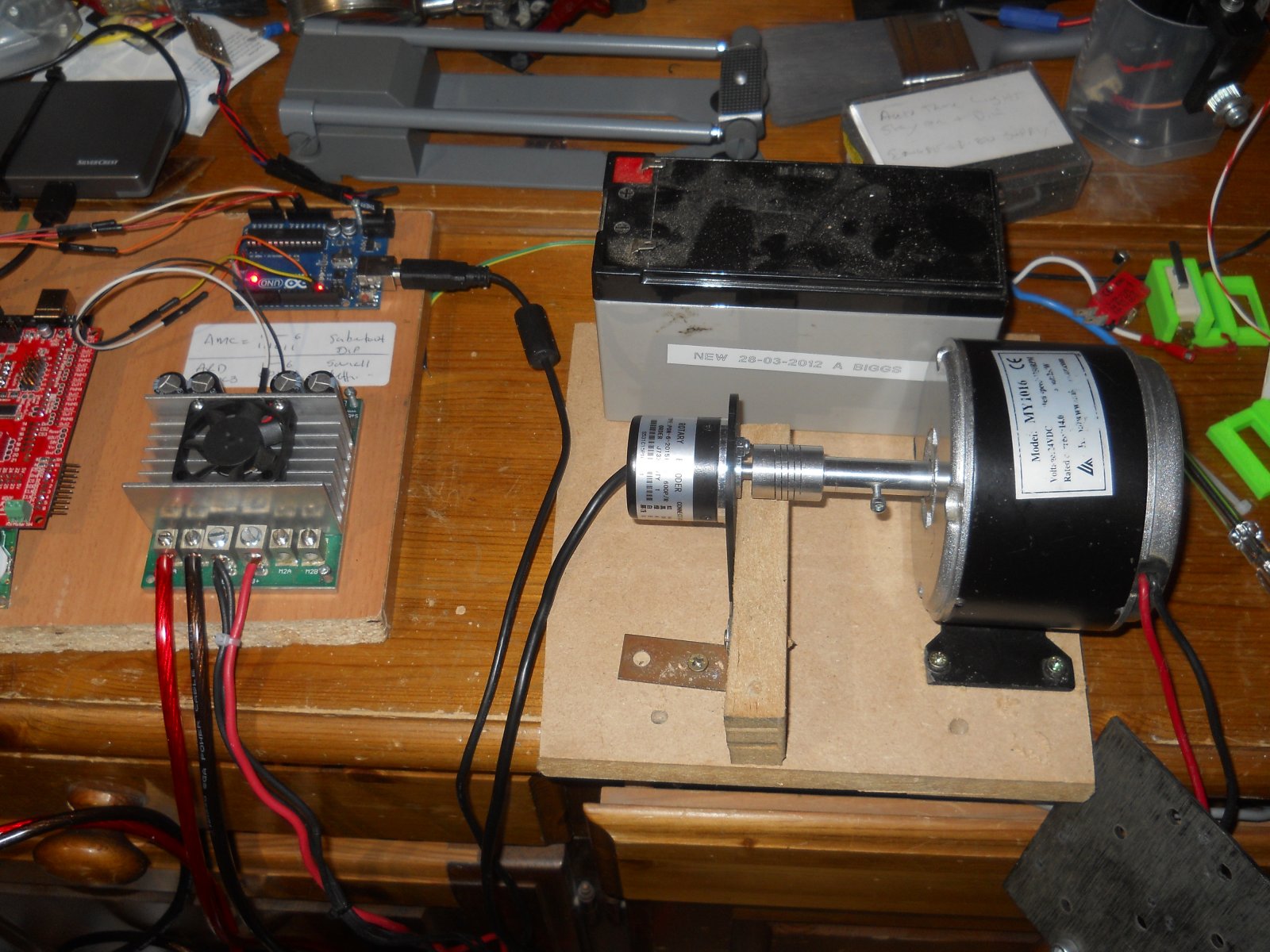

    Hi @BlazinH hope you don't mind my adding this little tit bit of info ( not prematurely I hope ) as another string to the SMC3 bow :)
    I have started to post the findings of a wee experiment I did today ( I may not have been the 1st so if this is already out there im sorry guys ...did not see those posts ) anyways I was able to replace multi turn pots with Optical encoder and use your program to verify that the susbstituation could work ..
    im Trialing Thanos's Encoder2pos Interface as one of my system setup options was my original AMC128USB controllers anyways but really want to maximize and use Simtools V2 soon , Long story short ( my posts are always Yawn roll eyes long :) ) I thought about the optical ens=coder option using your program and it seems on the face of my initial tests that I can indeed Feed the Output for the Optical encoder interface into your SMC/Ard setup and get the correct feedback and tracking ..
    Early days yet guys ( WAKE UP lol ) but once I post the video you may be able to point out any issue .. Cheers @BlazinH
    again I have to admit if this has already been done I have not seen the posts and just had a light bulb moment whilst tinkering today feel free to delete this if its old news :)
