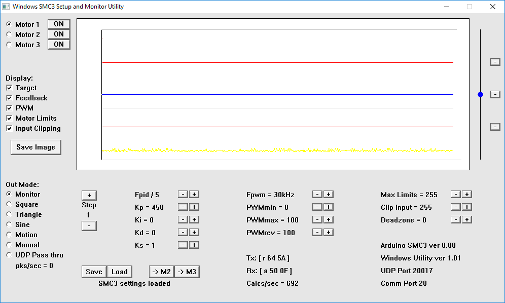

    The settings are exactly as they are above for simtools I didn't need to change anything from before.
    In SMC3 I have the settings low but like I say it works perfectly using the SMC3 utility no jerking nice and smooth.
    Soon as I try to test using simtools it's terrible.
    Can't upload pics as I'm out at the mo. I will do a video after when I get home, shouldn't be too long

    Unless there is something specific about the sabretooth version it should be OK. I've always used 1ms on my standard SMC3 on UNO.
    You could try using SMC3Utils in UDP passthrough mode to search for problems. It will display a light blue line showing what it receives from simtools and a dark blue line showing the returned value from the arduino (or the other way round?). It might help tell you where the error is introduced?

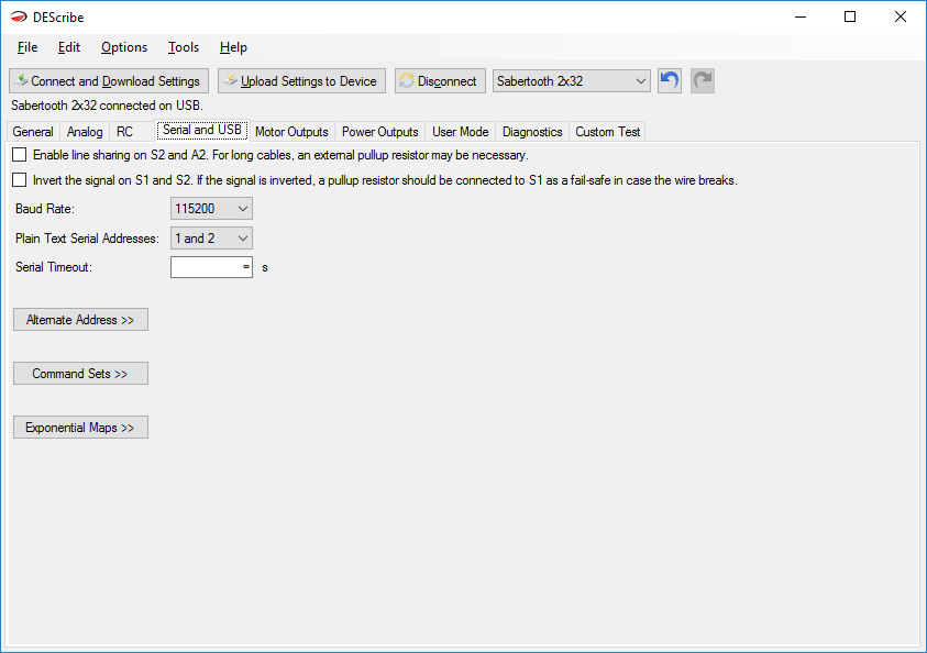

    I changed the rate 112500 in describe for each sabertooth

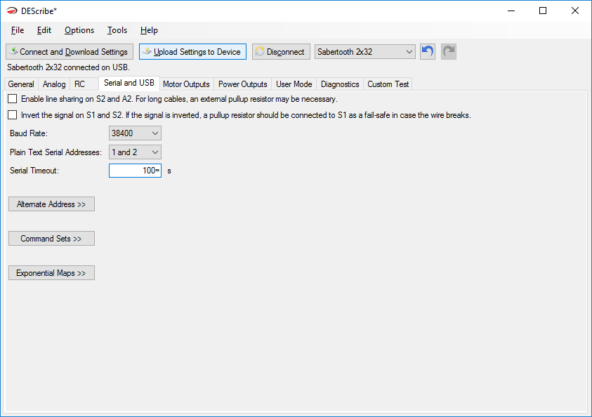

  10. SilentChill
    2,645
    20,601Coins
    +3,570 / 34 / -0

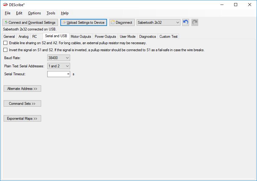

    Here some screenies
    These are the same for all 3 Sabertooths and UNO's

    ok, try to set the Sabertooth to BAUD 38400 for testing purposes (Describe)

    Sorry to hear your are having issues. I see serial timeout in DEscribe says 0. That screen shot is after running the sketch and download the settings again correct? My plan was to have only one sketch for both sabertooths but in may be necessary to make two, one for the 2x60 and one for the 2x32. The problem may be because the 2x32 is a V3 sabertooth and the 2x60 is V2. After @Pit couldn't get the sketch to work on his 2x32 after I got it working on my 2x60, I had to call DE support to confirm that V3 is not 100% compatible with V2 commands. That's why you must use DEscribe on the 2x32 to set its baud. I forgot to check if the serial timeout was also working or not though and from your screen shot it isn't. That shouldn't be causing your issues but maybe the code for the 2x60 is screwing with the 2x32. I assumed the 2x32 would just discard the V2 commands but maybe its causing the problem.:confused: But again, I don't have a 2x32 myself to test with.
    Shortly I will be sending you a striped down sketch that @Pit has had success with to try to see if that makes a difference since he said my posted sketch is not working for him now either.

    Good idea to try this too. Don't forget to change the baud to 38400 in the sketch to though.

    What should I set serial timeout to ?
    WIll try this now

    Its fastest setting, 100ms.

    change it where ??
  19. SilentChill
    2,645
    20,601Coins
    +3,570 / 34 / -0
    I changed it uploaded it and it goes blank again ?
  20. Pit
    3,007
    30,510Coins
    +3,098 / 31 / -0
    same here
