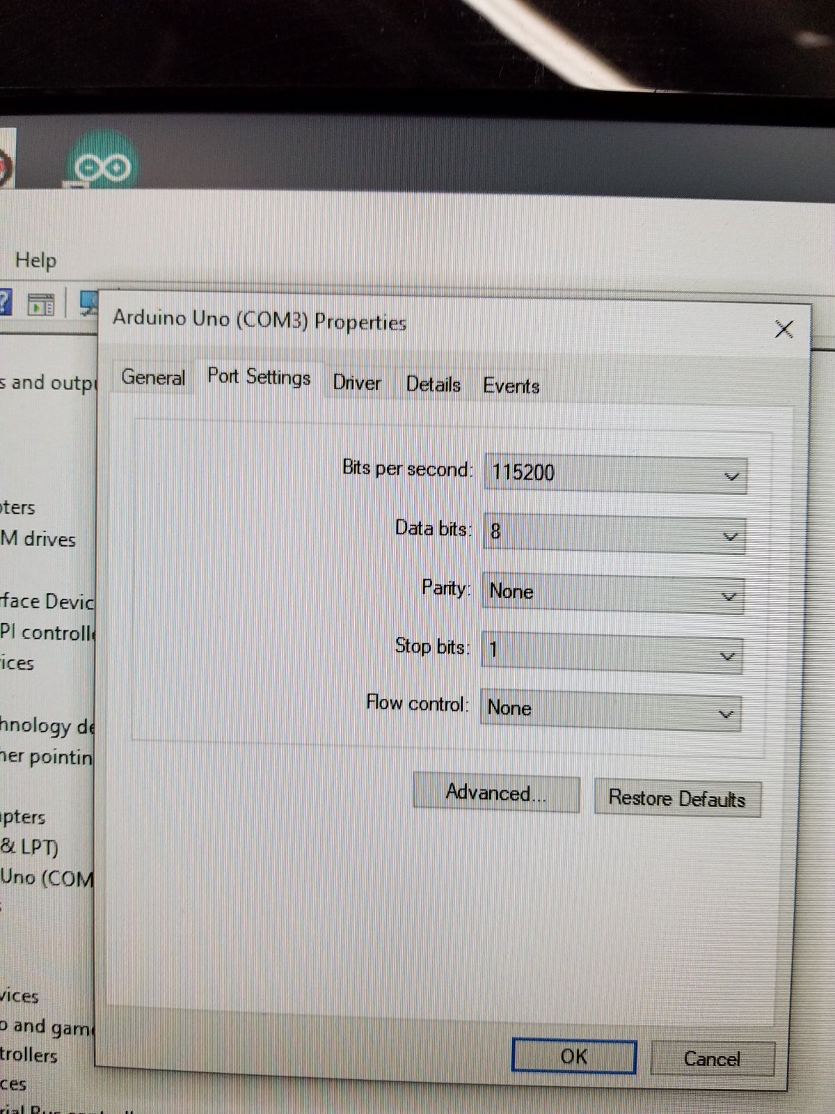

    where do you have your dip switches set to also Describe is not used with a sabertooth ..to get the right baud rate you must ground the pin 13on the ARD on power up then turn off the power reconnect pin 13 to number 13 pin on the ARD and power it up again.. then your baud rate will be 115200...ive built many of these systems ..you must also change your com port settings to 115200 in windows device manager..

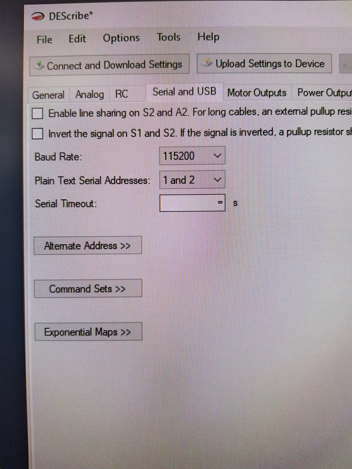

    Sorry to be a pain :p I got one more 2x32 Sabertooth card so now i got two. I am trying to run 3 motors now with two Sabertooth chip, i got two uno aswell...
    I am so confused how make this work. So i go to DEScribe and fix the bau rate on new card. "DONE" Now i need to figure out how to connect two arduino uno to gather..
    Do i have to connect : ground on one card to the other card and A4A5 to make this work or what shall i do Please is there a guide about this? Need help :p

    Hook them up individually as per instructions on first post then configure Interface Settings in SimTools with one Arduino and Saberttooth for 2 axis and the other one for 1 axis.

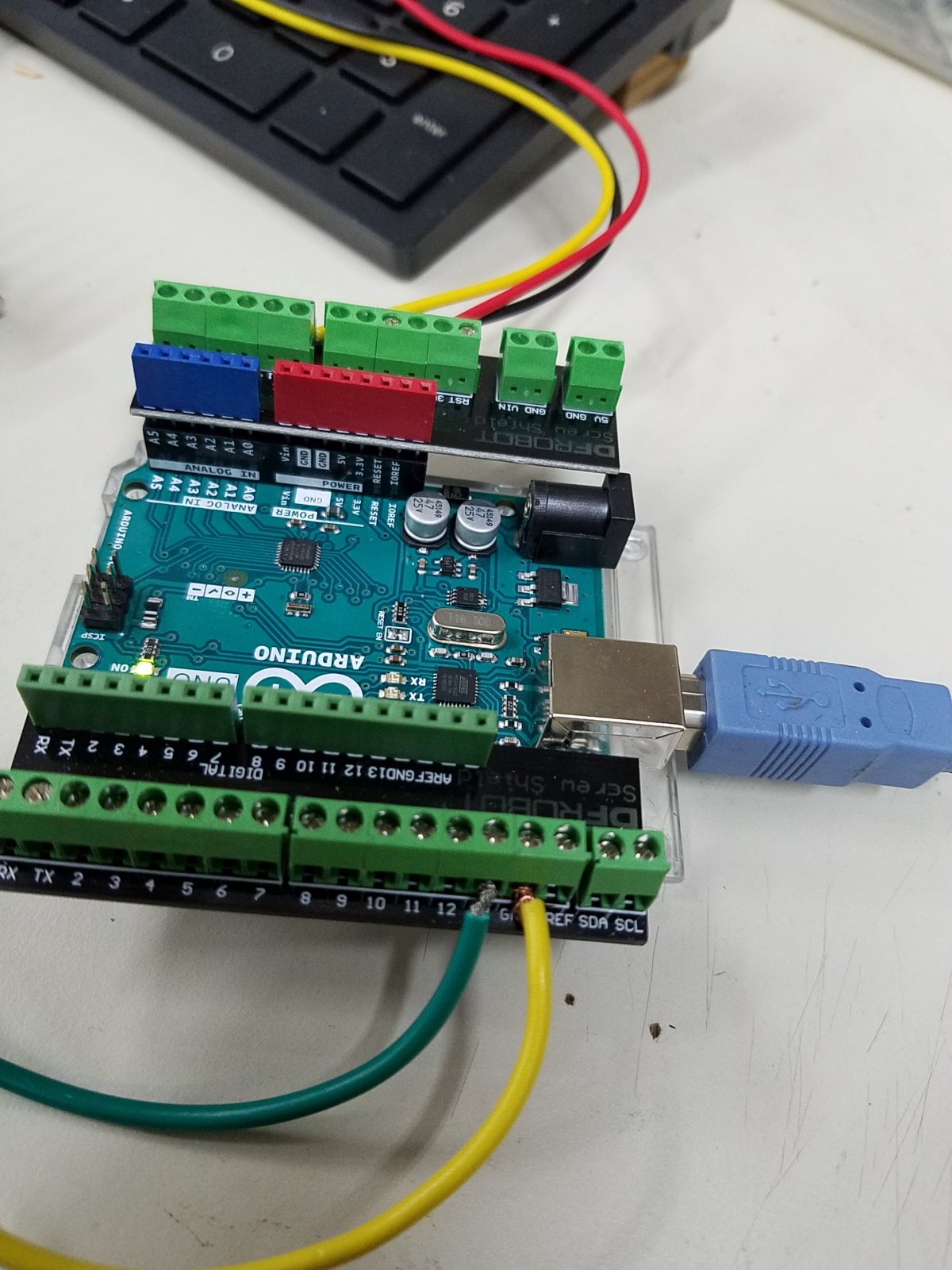

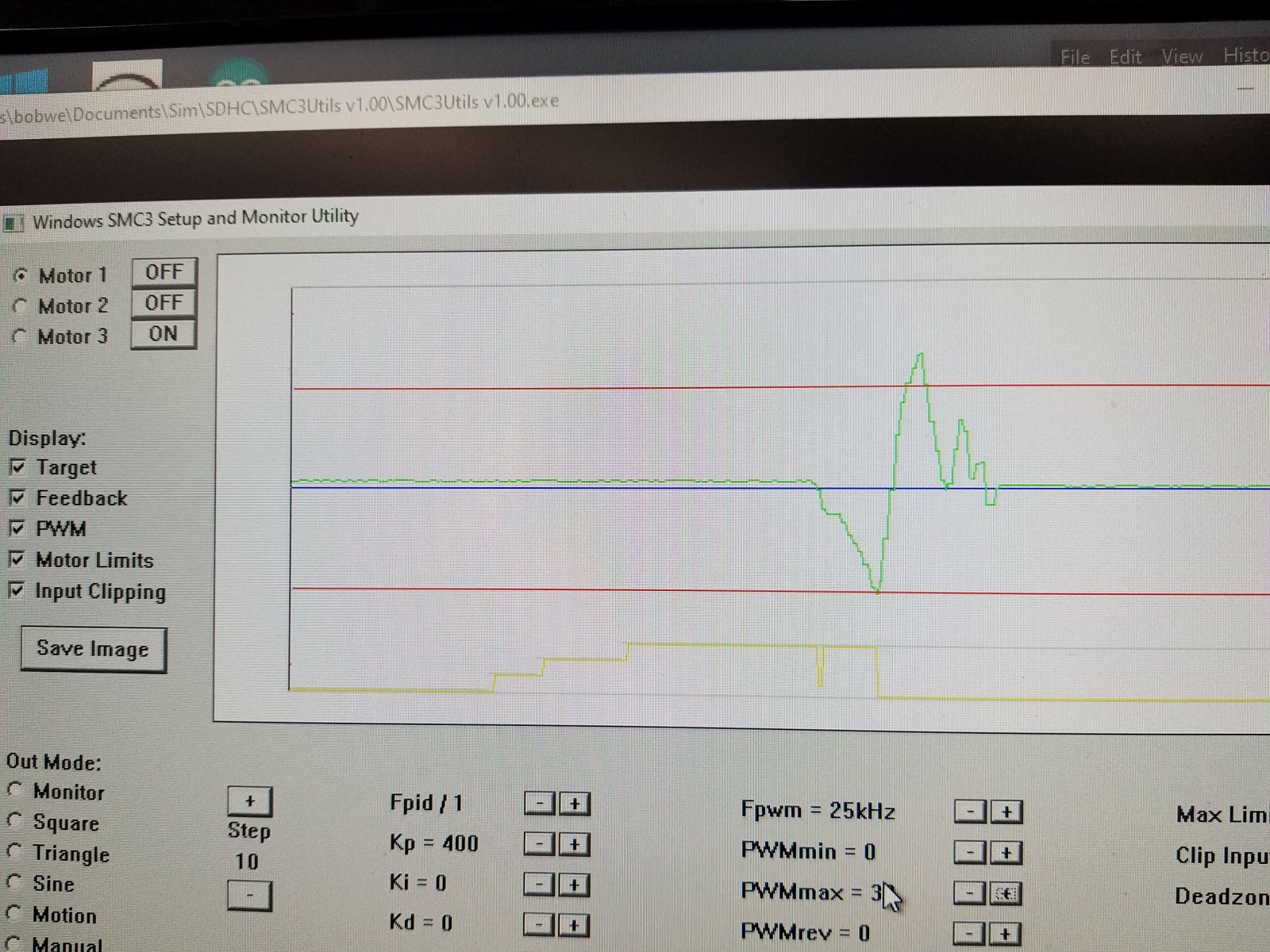

    DC motor, Arduino, 4DOF

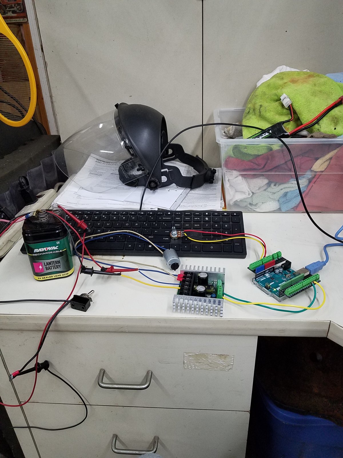

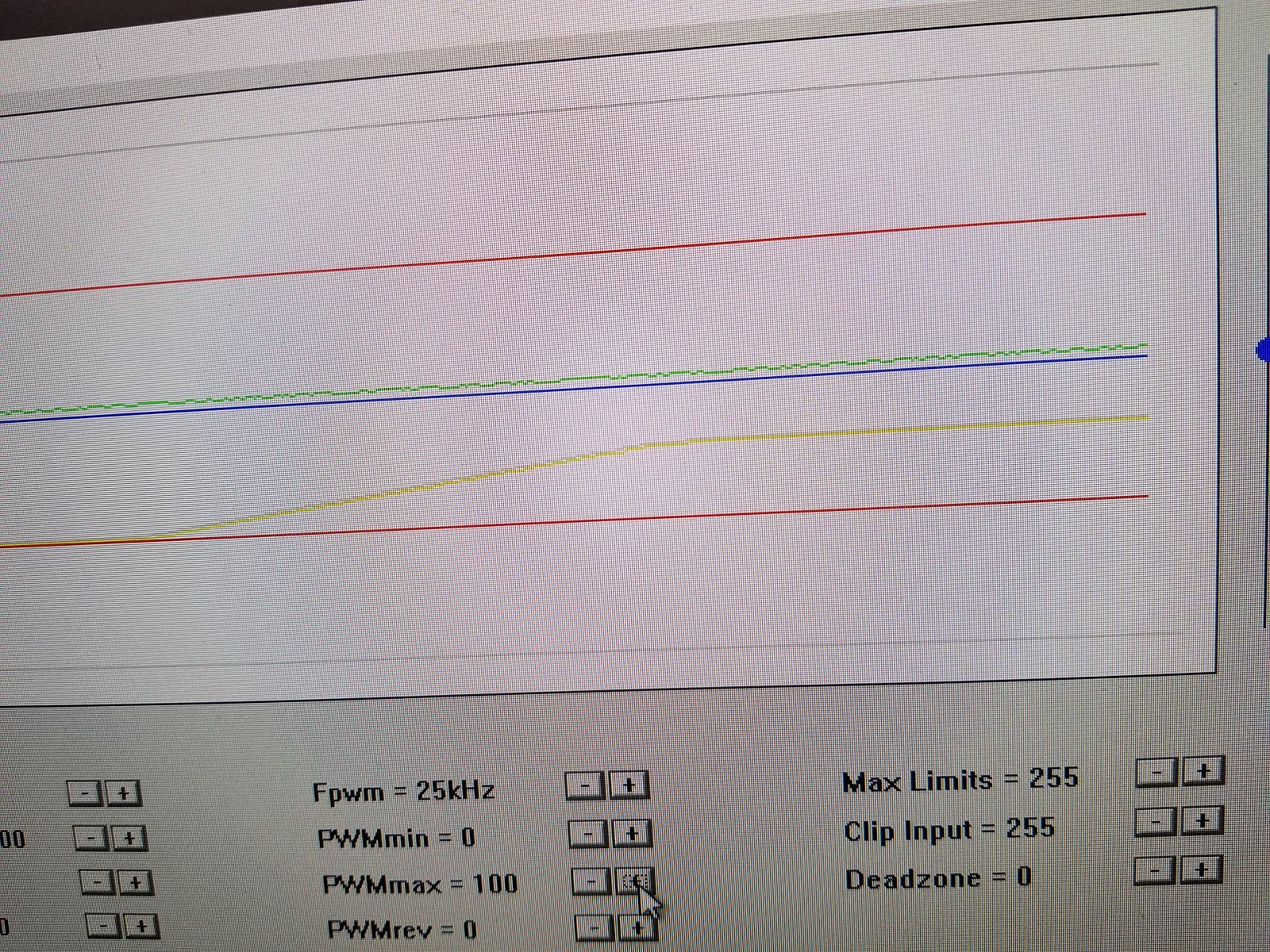

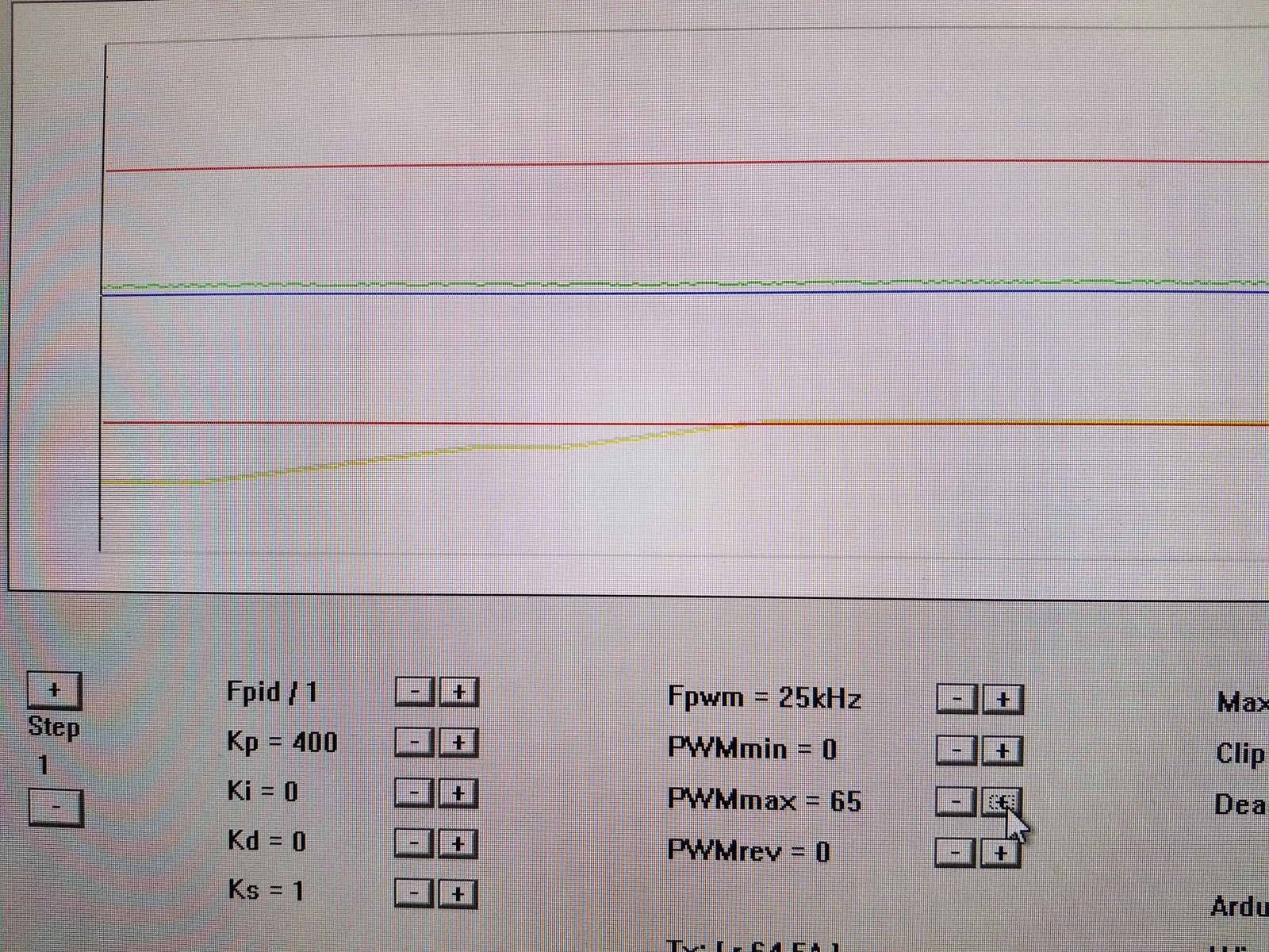

    Well after 3 days I finally persevered and got the arduino and 2x32 v3 hooked up to a little motor and 6v battery. Per step 17 of the original post, when I increase PWMmax the motor will turn but the yellow line goes up as I increase it . The green line will move if I mess with the pot. Help.

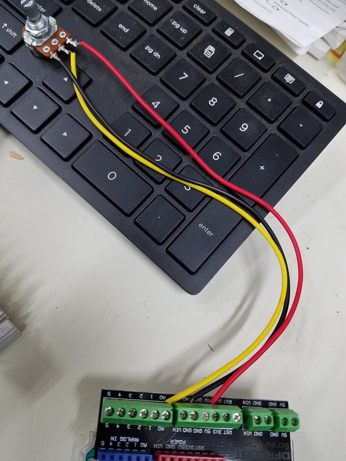

    Is the pot connected to the Motor?
    Could you please post pictures of your settings and physical hardware.

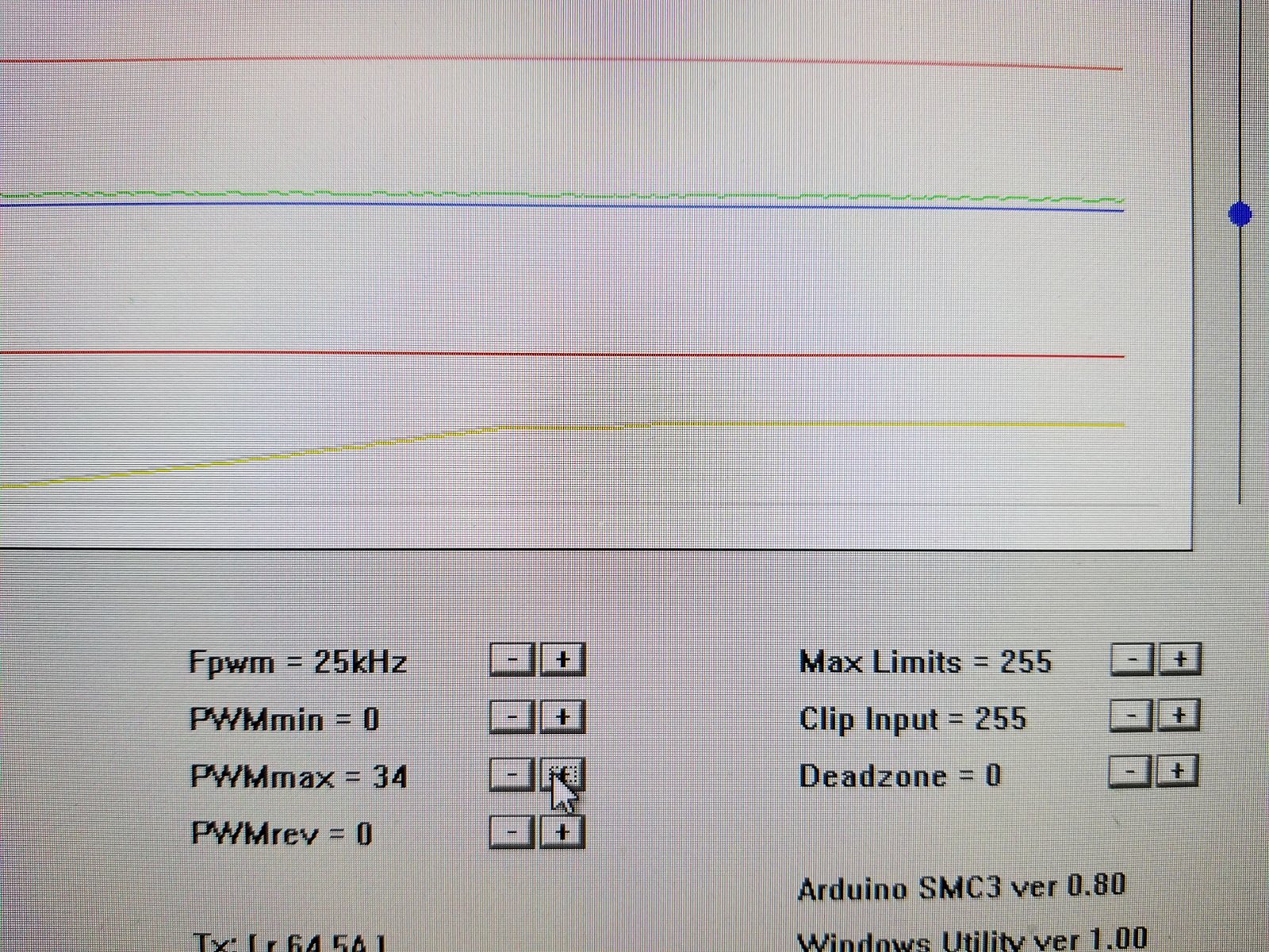

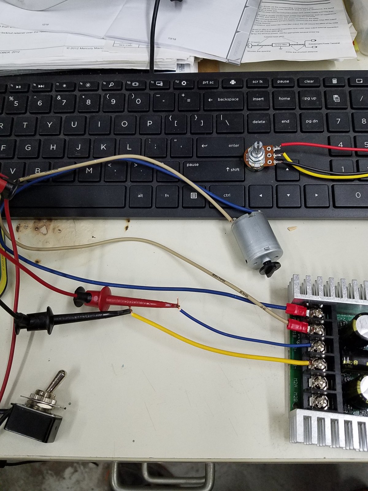

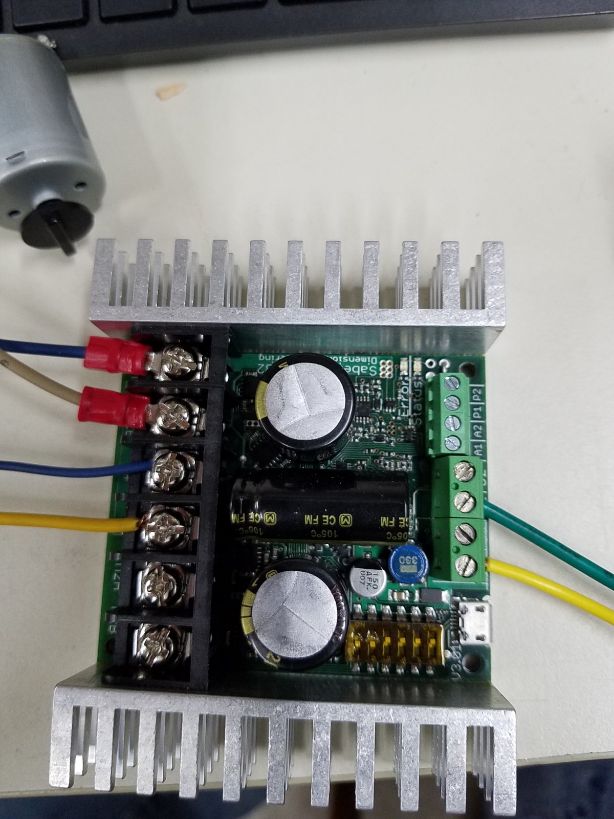

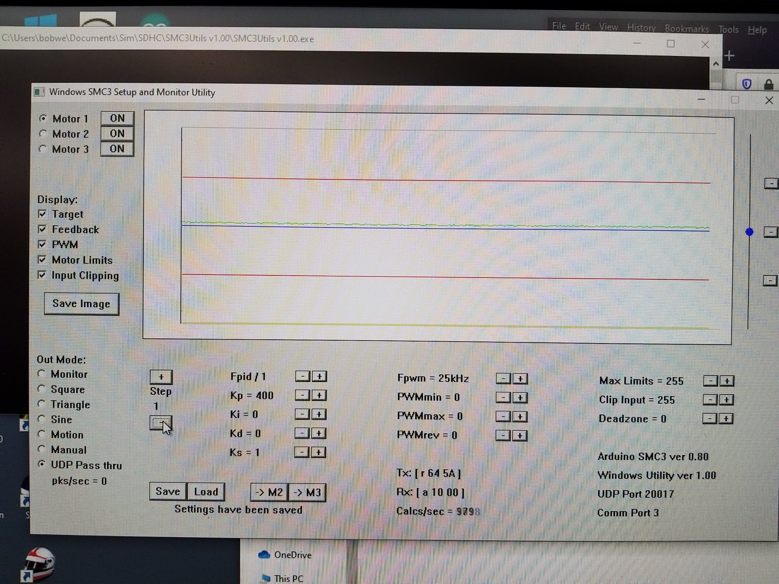

    Pics as requested. Turn up PWMmax and yellow line goes up. Wiggle pot and green line moves and MOTOR 1 turns to OFF

    if the pot is not connected to the motor the motor must change the spinning direction when the feedback line of the pot is crossing the middle line in edit SMC /edit.
    ps: also messed it up lol

    What a dum dum oversite on my end. I will get that sorted out tomorrow and give it another shot. Thanks

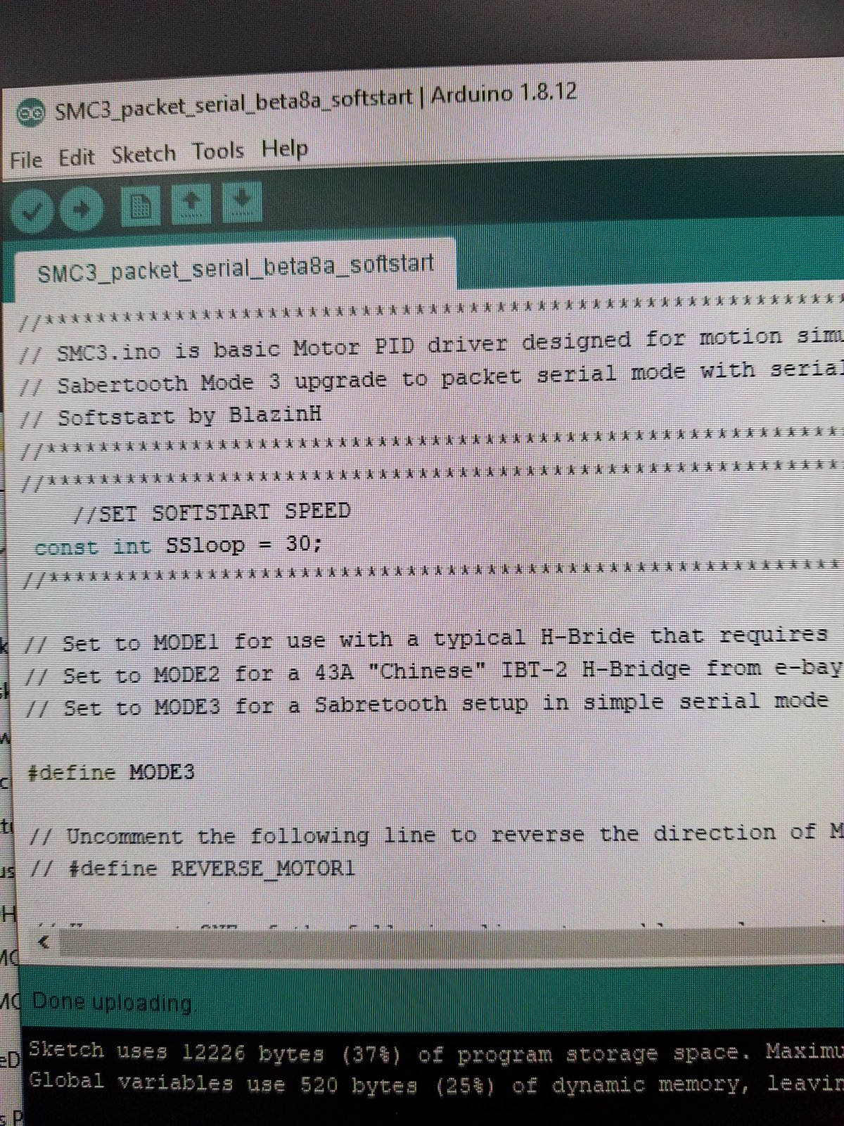

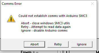

    Hi, I'm using SMC3-SPS , I had my systm working for a while then I had to dissassemble it to do some upgrades, but it took me about 6 months to get back to it (was too busy for it), anyway I have things back in place and I need to do PID tuning, so I have to use SMC3 windows utility, I'm getting an error when launching it stating that it can not comuniate with the port, I have the ini file edited with correct port nubmer, any ideas what to check?
  20. noorbeast
    22,185
    154,750Coins
    +11,196 / 57 / -2
    Is the correct port configured in the Arduino IDE settings?
