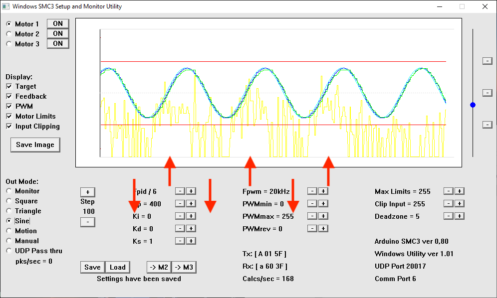

    Well, I tried all of the codes for Sabertooth less the LCD one because it needs invest in touchscreen and I feel it is a little bit complicated to configure but mostly because I don't think it will solve the problem while the other codes doesn't solved it at all.
    I bought a PCIe USB 2.0 card and checked it is driven by USB 2.0 controller (the built in 2.0 ports are driven by 3.0 controllers) and It didn't help, the problem stills.

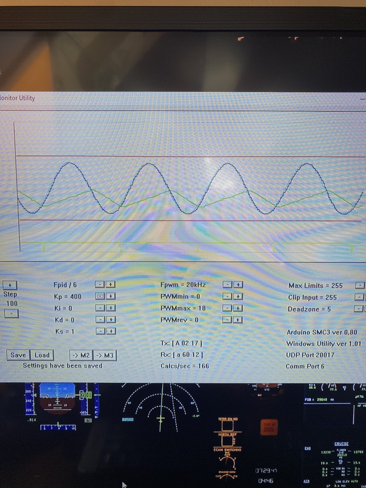

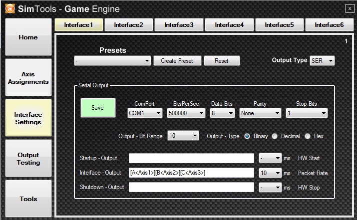

    If I move the hall sensor manually the motors drive smooth and silent, If the movement comes from commands from Simtools/FlyPT (meaning from USB) the yellow signal is completely noisy like a mountains.
    Tried all:
    Different USB cables: shielded, with ferrite cores, longer, shorter, 2.0, 3.0.
    Different USB ports: 3.0 and 2.0 built in, and 2.0 dedicated PCIe card.
    Shield and manage all the wires.
    Ferrite cores in all the wires.
    Coaxial cables for serial signals.
    Run it with power supplies and with batteries.
    Run it with and without load
    Configured infinite combination of parameters in SMC utils
    Tested in different PC (even with a Mac running a virtual machine)
    I'm very frustrated

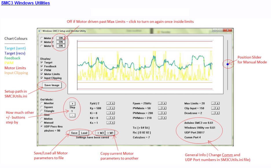

    As I mentioned in these previous posts nothing changes whatever the settings are, in the attachments you can see the settings.
    Do you need to know other settings?

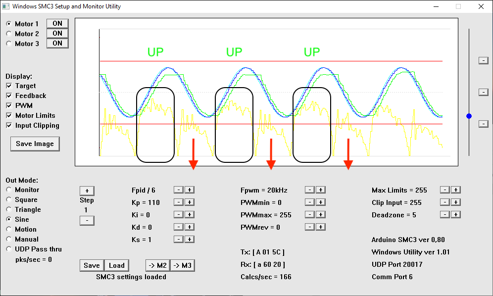

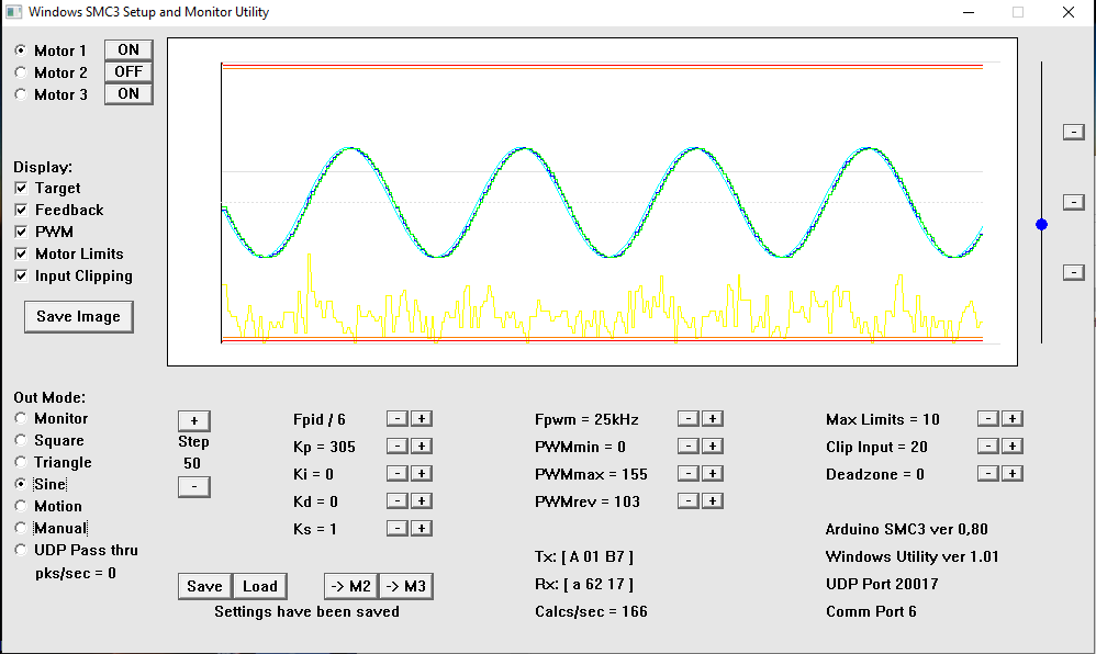

    Here an example of the problem:
    No matter what changes I do, the problem does not change. The only way is decreassing Kp to a value so low that the motor can't lift anything

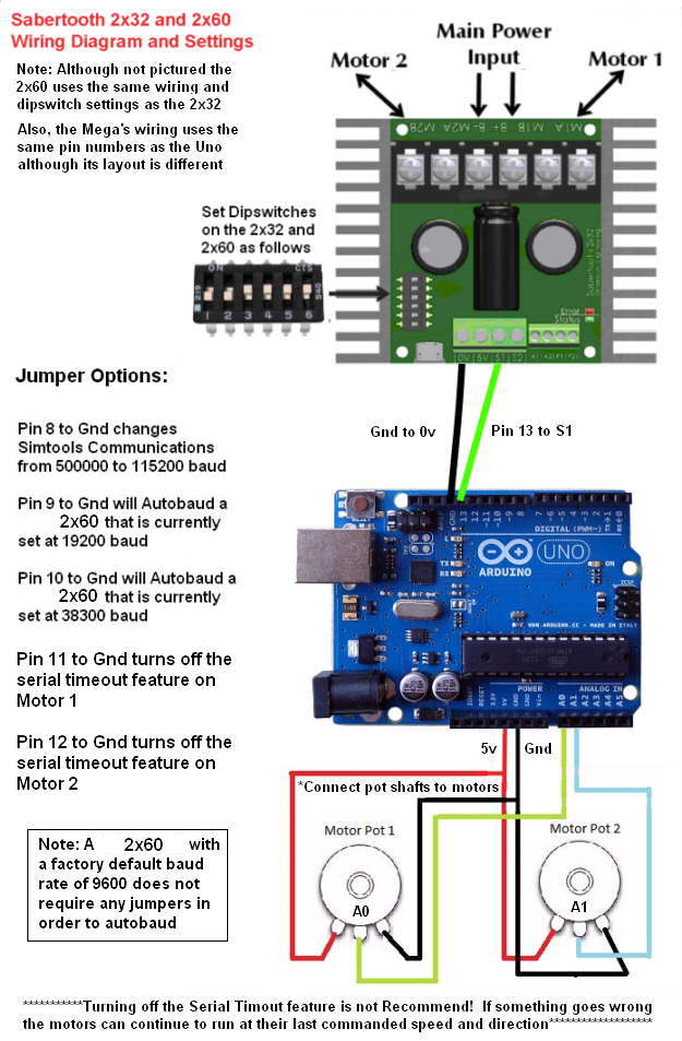

    Hey, finally I found the problem and the solution. The pin from pin 8 to GND to reduce the speed from 500000 to 115000. I tought that I only need to do a pulse signal and few days ago I dicovered the jumper needs to be kept there

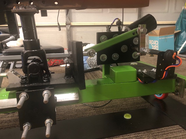

    Sorry to ask, but would be very thankful for any advise... but have very very limited experience and exposure working with PCs and Software. I am having difficulty getting pass point 8 "Now use the Arduino programming software to install the SPS sketch attached below on your Arduino. Make sure you choose Uno or Mega and to set the comport number." - how do I do this? - and obviously have not done the next point = Next download and run the Windows SMC3 Utility software attached below and make sure it communicates with your Arduino. - _ How? _ Open the accompanying SMC3Utils.ini with notepad to change the comport if needed (see image below) - _ changed to comport3 _.. any suggestions as to the missing steps i should have made? please talk to me like I'm a 4 year old...

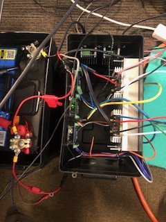

    Thank you Noorbeast.. I built Kevinski's aka Dr ADHD 4DOF Motion Sim, but I am really struggling with the "software" part of the build. I am finding to many rabbit holes to look into and not understanding. I would gladly pay for someone to hand hold me through the last parts of the process as I just seem completely lost with it. Will keep trying but it may be
    a bridge to far for me.

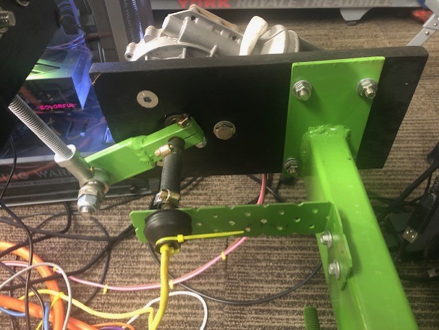

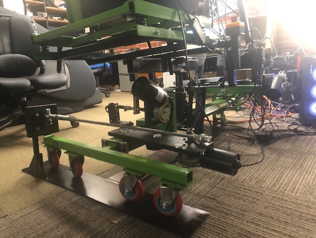

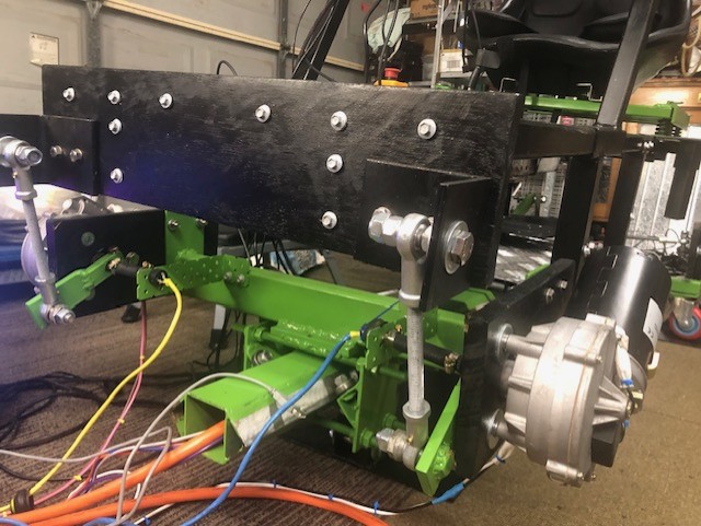

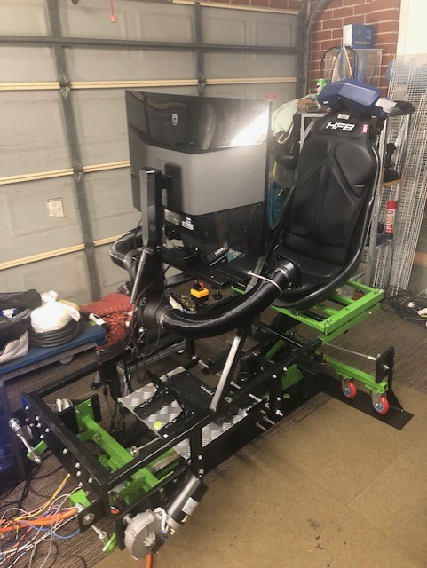

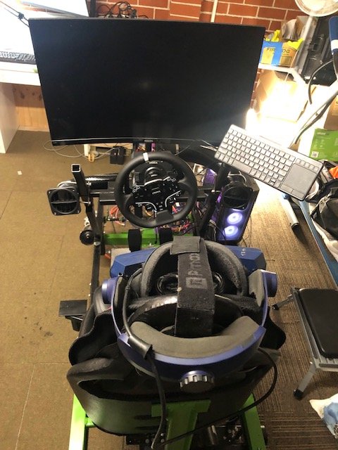

    Thanks Kevin .. Your a gentleman and a Scholar, You have been very generous with your support and hope that I can get this rig up and running. Spent a bit of time over the last couple pf days making sure of no duplicate files and downloading all files etc. Also finished physically installing the wind sim with two 3000rpm server fans to eventually get it running with an Arduino Uno R3 and two IBT2, strapped in the HF8 Haptic seat insert over the racing seat and started my marketplace hunt for a racing seat harness so that I can utilise the extra 2x32 I have coming in. The Pimax 8KX VR Headset is a bit of an unknown for me but Pimax are working on Motion Cancellation to add to their app.
