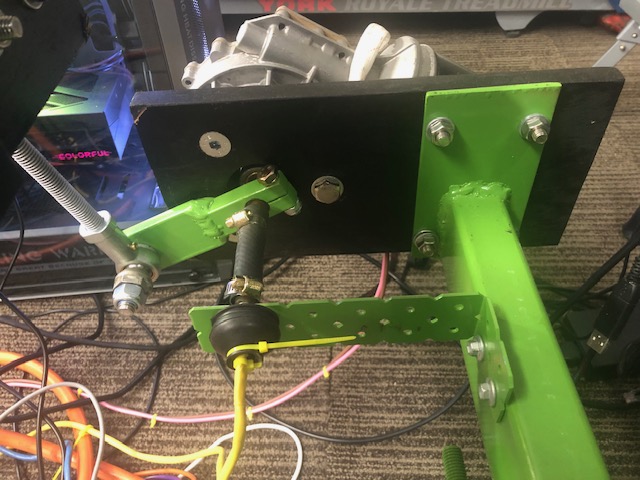

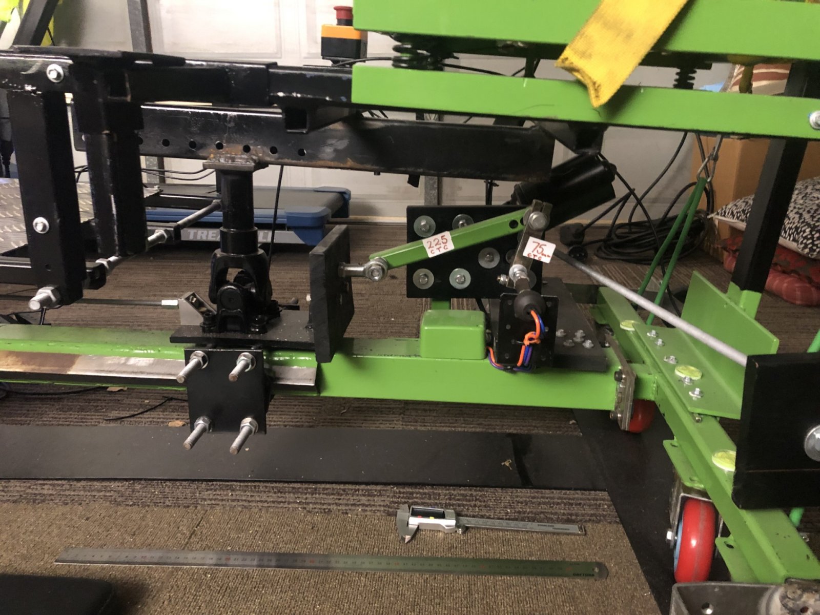

    the centre to centre on the motor leaver arm is 92mm

    @Michail sorry for the late reply. 90mm CTC on surge motor lever.

    So with 90mm CTC you get ridiculous long 210mm travel this is insane.

    Just to make sure we are talking about the same thing ... trolley arm lever CTC length is 75mm and 225mm... check out kevinski's server in discord for others results.

    I’d have to double check, but that’s 210mm in total. 105mm forward and 105mm backwards from the trollies centre position.

    Correct ... mine is about that too

    @Michail yes it is a bit insane building one of these things and taking the time to show others. But hey, others have taken the time to do the same. That measurement for the distance of travel is 210mm in total. 105mm forward travel and 105mm aft travel. And yes, it's enough.
