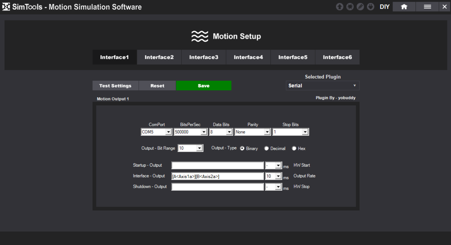

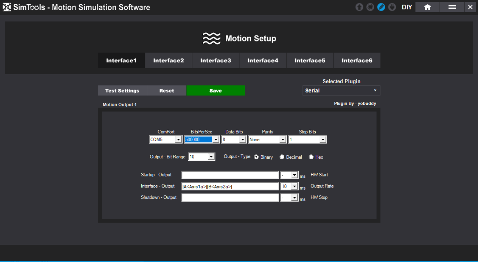

    Attached is my screenshot from my attempt at sim tools motor testing (again, works in smc3 utils motor test- both my motors). Tried the baud rate as pictured (500000 as well as at 115200). My hardware did not work connecting pin 8 to ground and things stopped working properly when testing in SMC3 utils. Without pin 8 to ground, it still worked in smc3 utils. I never tried grounding pin 8 during sim tools testing though because things didn't work in smc3 utils.
    Also, I tried my hand at the IBT 2 & arduino with SMC3 sketch as well because I'll eventually add a traction loss and surge axis eventually. I was able to get my sabertooth and ardiuno communicating with SMC3 utils, but couldn't get the SMC3 sketch for arduino and IBT2 to communicat with SMC3 utils. Main problem is the motors don't get recognized and I can't turn them "on" to test with the PWM slider. I tried multiple versions of the SMC3 sketches for the IBT2 set up with no luck with any version. Wiring seems correct and my rotary sensors get picked up when testing (rotating them when in SMC3 utils), just no motor movement or voltage output in motor pins on the IBT2. I confirmed voltage from power source was working. Thanks for the help, I'm excited to get things moving. Just not sure what i'm missing at this stage.
    22,185
    154,750Coins
    +11,196 / 57 / -2
    That looks right, which suggests a port or communications issue.
    To narrow that down can you please post a picture of SMC3 running the Sine test.
    If that confirms the same port please try temporarily disabling your firewall and antivirus, reinstall SimTools with them off, then test again while they are off. If that works you may need to whitelist SimTools.

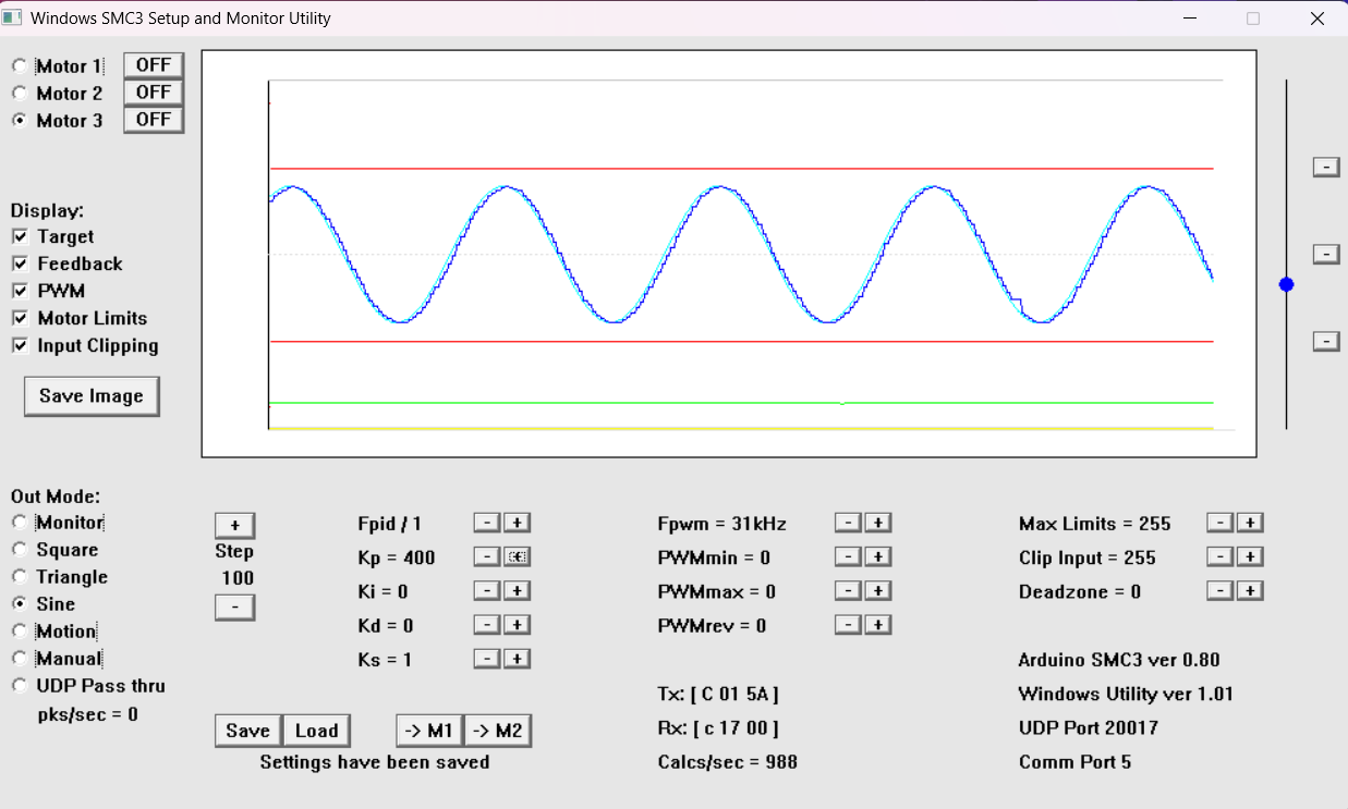

    here are the screenshots of the sine test with SMC3utils. performed with sabertooth and IBT2 set ups.

    My apologies. I will focus on the sabertooth set up. I have followed the steps listed in the official sabertooth set up you posted. I have been successful testing with SMC3 utilities. After entering and saving the settings in sim tools game engine, I do not get motion.
    22,185
    154,750Coins
    +11,196 / 57 / -2
    Can you please post pictures of your SMC3 settings running the Sine test, and your SimTools Interface and Axis Assignment settings.

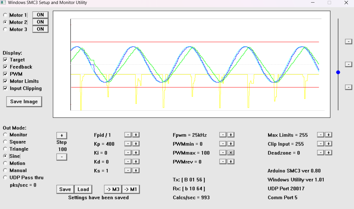

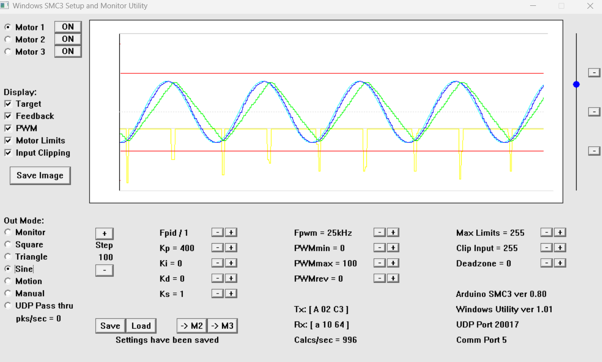

    I have attached my sine test for both motors as well as my interface set up. I was able to get the motors running in sim tools, however I had to leave the PWMmax at a value that that generated motion when closing the SMC3 program. Previously I was setting it back to zero when exiting. When doing so, sim tools generated no motion. I do not have my rotary sensors stabilized while testing the motors so if in the wrong place or accidently moved, the motors would just keep rotating and wind all my wires and damage my connections. Now that I have the motors moving in simi tools interface set up, should I set and leave the PWMmax at 255 now once I get my actual rig set up and the motors/sensors fixed?
    22,185
    154,750Coins
    +11,196 / 57 / -2
    Could you try PWMmax at 200 and PWMrev at 120, then rerun and post the Sine test.

    Here are the tests.
