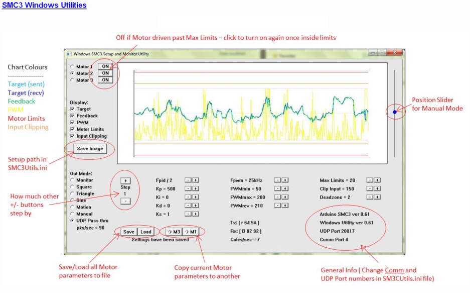

    Hi guys, for a while I'm using SMC3 with sabertooth 2x32, but I do not understand why the engines are not perfectly synchronized, I tried with ibt, and as far as they are "cheap", the engines are perfectly synchronized. Delay the known species in gear changes, or in the box lane with the pit limiter, I feel that the motors do not go together I tried to increase the power a bit of one but it is not the power that does not go, it's a delay Of the signal. What can I control?

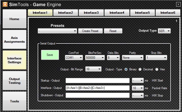

    I want set serial timeouts 100ms in describe software. It show me "s" and not m/s. I try to set 0,01but it's not accep this value. How can set 100 m/s? writing 100? but this meean 100 s and not 100 m/s.

    Use .01

    In fact, I had already solved this way, for me it was enough 3 on fpid, thanks for the help;)

    ok ive sorted my issues guys..
    1st..the arduino port was set to 9600 (i didnt no how to find or change this at first )
    2nd.. i think this was the cause in axis assignments i had
    [A<Axis1a>][B<Axis2a>][C<Axis3a>]
    the 3rd axis was cause the issue it was bleeding a signal over the top of the A and b i removed the c axis and it fixed all my issues ..

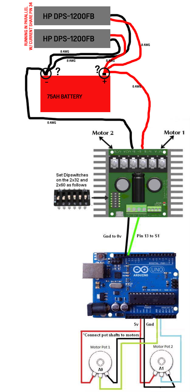

    Guys - I am switching my sim to sabertooth 2x60 (From MM) and adding 3 - 75ah batteries. (1 for each 2x60) I think I'm clear on mostly everything - except the wiring of the battery. Here is the way I have envisioned.
    I guess my only question is that where the wires meet at the battery post - it is OK for the Pre-Battery and Post-battery wires to be touching? I guess I am not comprehending what prevents the regenerated energy from being absorbed into the power supply if the wires are touching? (bypassing the battery)
  16. Avenga76
    Avenga76 Well-Known Member
    Jun 29, 2014
    518
    Network Engineer
    Auckland, New Zealand
    3,261Coins
    +858 / 6 / -0
  17. CLEOPHUS
    CLEOPHUS Member
    Apr 12, 2016
    47
    229Coins
    +69 / 0 / -0
    Great - Just didn't make sense to me. Moving forward.
