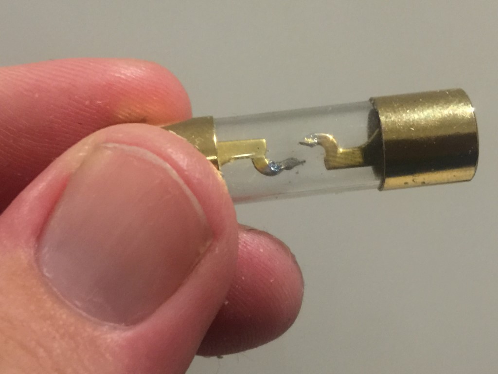

    Did you check the pot? Maybe it got broken/disconnected and didn't reach the limit to make the motor stop so it kept moving
  2. Avenga76
    Avenga76 Well-Known Member
    Jun 29, 2014
    518
    Network Engineer
    Auckland, New Zealand
    3,261Coins
    +858 / 6 / -0
    The Pot is working fine, I disconnected the motor leads and moved it back around to the normal position with a spare battery.
    I tested the pot while moving it with just the battery and it was responding normally.
    I had some spare fuses so I replaced the fuse and reconnected the motor and it is all running perfectly normal now in SMC3.
    I don't really want to try it again in game until I figure out what went wrong. The motors feel really powerful so I think I need to detune it even more.

    I know how you feel, it happened to me twice but always because of pots (using jrks)
    I would try lowering the power as much as you could with the stop button in your hand and check if it stops once reached the limits
    Good luck!

    If I try it in SMC 3 it obeys the limits, The clipping limit kicks in if I try to move the slider past the limit in manual mode, and I tried setting the max limit the same as the clipping limit and it stopped the motors fine when I move the slider past that point. I also tried it with the sliders in SimTools and it stopped the motors fine when it got to the angle that I set it at, that is why I am really puzzled with this problem, because I fully tested all the limits before I tried it in game.
    When I am doing my testing I switch over to a killswitch with a really long 10 foot cable, I call it my roaming killswitch because I just have it in my hand the whole time while testing, just in case I get an oscillation or it goes out of control, but I wasn't fast enough to stop it, it just whipped around and blew the fuse probably about a good second or so before I hit the killswitch. When I have my rig all running perfectly then I have a killswitch next to my wheel and one at the back of the rig.

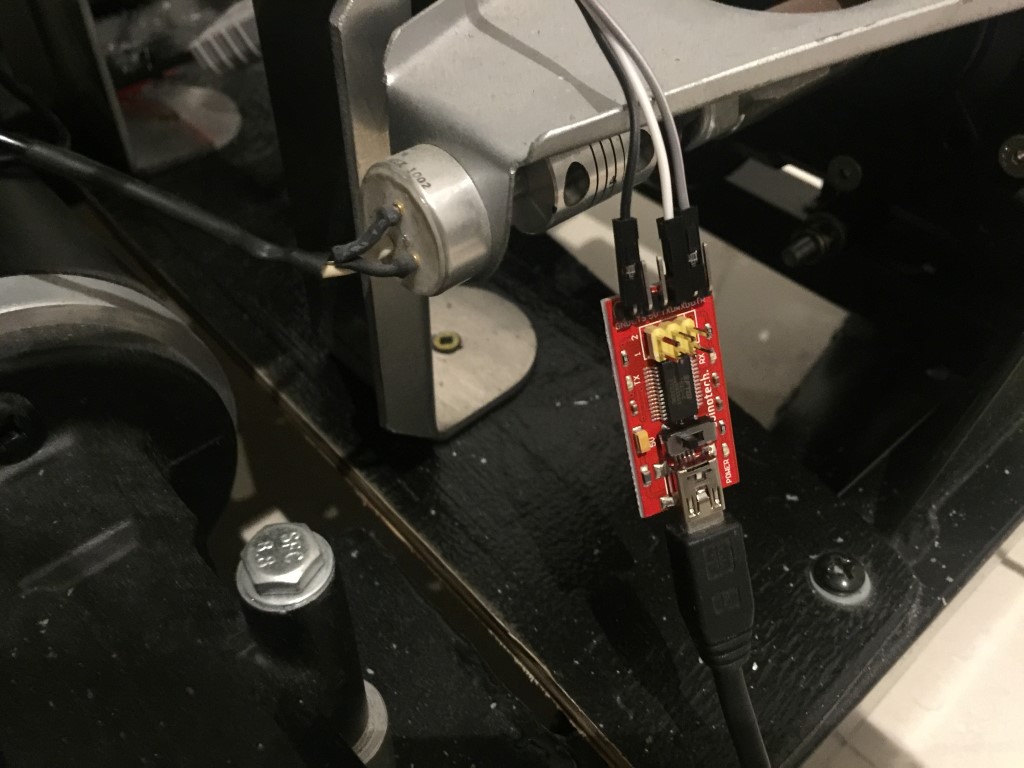

    Awesome!!! It worked.
    I went down and got the serial to USB converter.
    Wired it all up and connected to 38400 with DEScribe then changed the baud rate in packet serial section to 115200, then restarted the SyRen to make sure I could connect on 115200 using DEScribe.
    Then I connected the Arduino back up to the SyRen and uploaded the standard sketch and it is working perfectly running at 115200. I don't get the arduino comms error anymore either. So it is working exactly like my Sabertooth.
    Normally you would connect to 9600 in the first instance but I had changed it to 38400 using the "ST[0].setBaudRate(38400);" command.
    So anyone reading this in the future. All you need to do to get a SyRen working is buy a serial to USB converter, connect to the SyRen on 9600 using DEScribe, then go to the packet serial section and change the baud rate to 115200
    Thanks heaps for your help getting this going @BlazinH
    The SyRen makes a good controller for rear traction loss if you are doing 3DoF, use a sabertooth for the seat mover and a SyRen for the traction loss.
    This is the serial to USB converter I used, it was $19NZD ($13USD) from Jaycar using my trade card, but as @BlazinH linked above, you can get them heaps cheaper on eBay

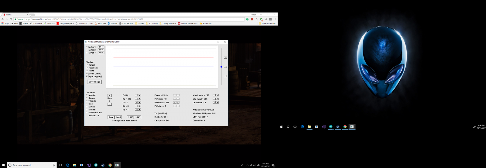

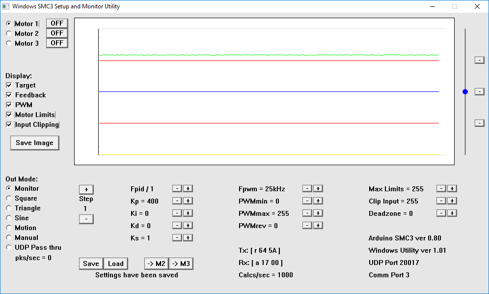

    I can't seem to get the motor to turn ON. If I click any of the Motor buttons, they flash ON, and then instantly go back to OFF as shown in the picture below. Any help would be greatly appreciated.
    I have set things up according to the instructions at the beginning of this post. I'm using an UNO and a Sabertooth 2x32. I've set the baud on the 2x32 to 115200 and also set the serial timeout to 100ms using DEScribe. I've set the DIP switches as 1-2 OFF, 3-6 ON. The UNO is on COM 3 and the sketch has been uploaded. I set COMM=3 in the config file for SMC3. I've wired everything up according to the drawing.
    Any thoughts on what I'm missing?
    Thanks for any suggestions.

    @MyTPioneer green line is your potentiometer and must be between the red lines Max limits. its a safety feature in SMC3
  14. MyTPioneer
    MyTPioneer New Member Gold Contributor
    Jan 22, 2017
    23
    Database Developer
    United States
    301Coins
    +7 / 0 / -0
    Thank you @insanegr
    I manually twisted the motor to get the POT back within the limits and was then able to turn the motor on! Unfortunately it ran the POT right back over the limit and shut off again, so I guess I need to figure out what I need to adjust to prevent that from happening, but at least I have some movement now. Thank you, thank you.
