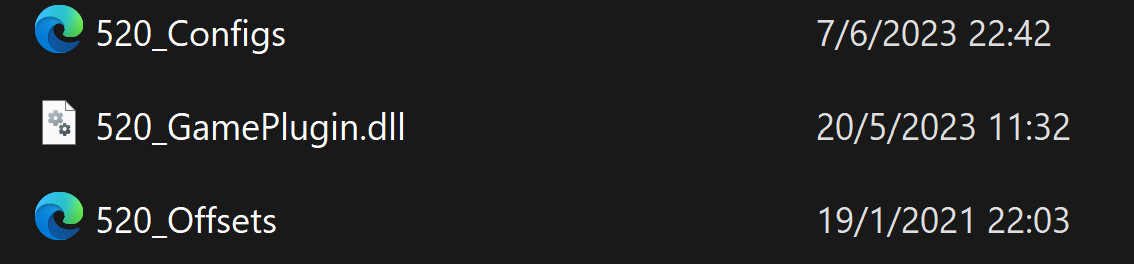

    Hi everyone! I had downloaded the SimTools v3 plugin for Squadrons but when I try to run it, I have some errors:
    "start error
    indice fuera de los limites de la matriz
    en Squadrons_GamePlugin.GamePlugin.GameStart()
    520_Offsets.xml or config not found! Patch game again!"
    I see the 520_Offsets.xml and 520_Configs.xml in the GamePlugins file. I need help please. I am new with my simulator. Thanks!

    The plugin on this thread is for SimTools v2 and is incompatible with SimTools v3, if that is what you are trying to do.
    Available SimTools v3 plugins can be accessed directly from the v3 interface when online, as v3 is in Beta not all plugins are available just yet.

    Thanks for response! I had downloaded from simtools v3 plugin manager, the Wagnard version. I have issues with that version. When I install it, I have 3 files in GamePlugins. I dont have problems with other game
