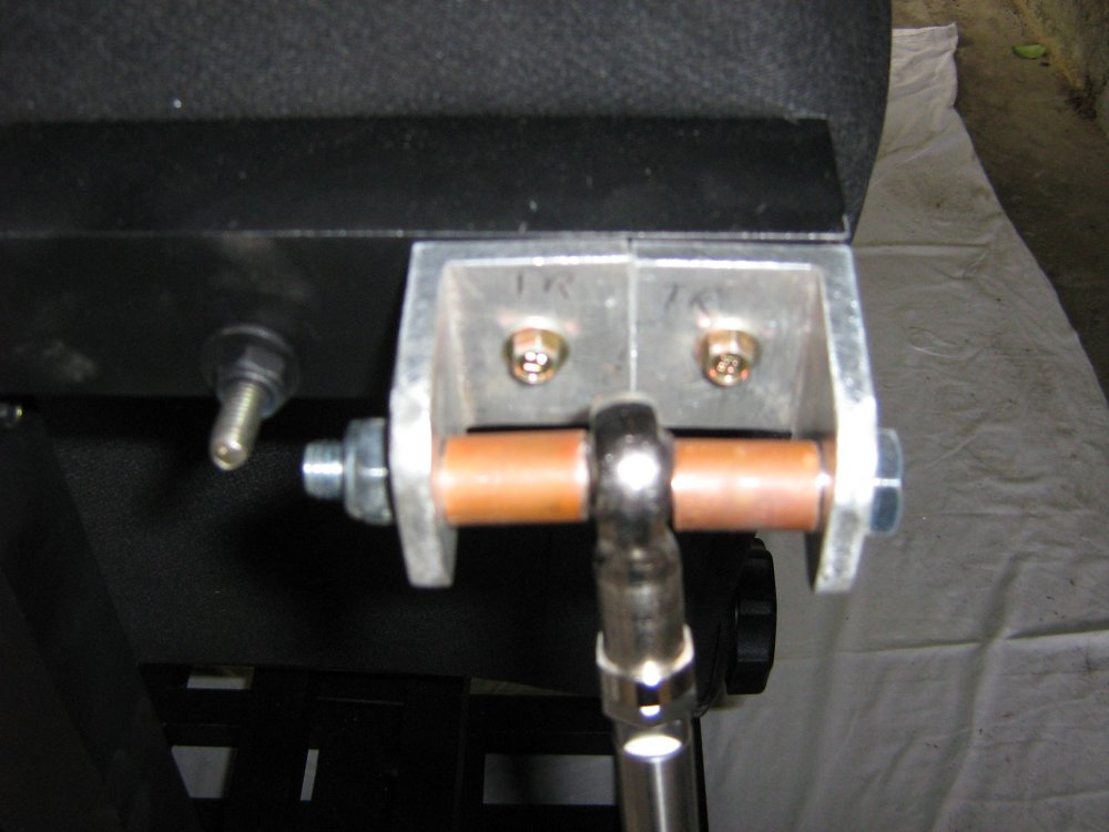

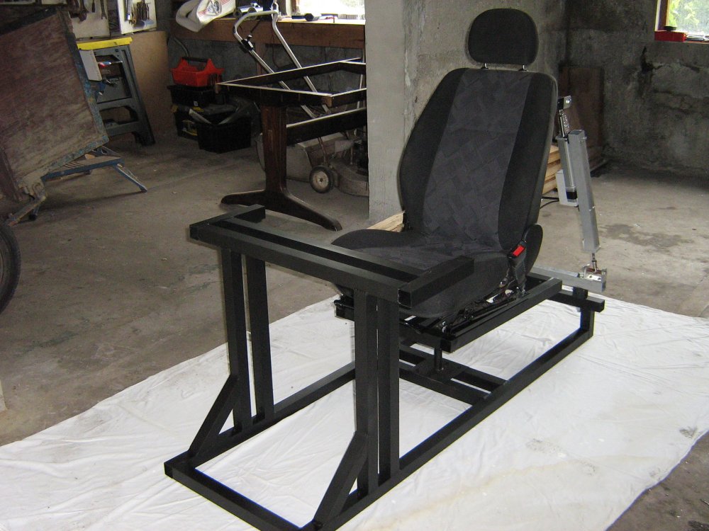

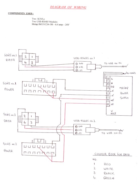

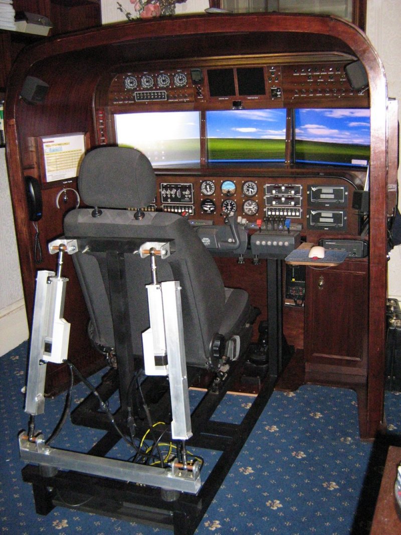

    Well I have completed my platform and you can see some photos below. I am sure that I may have to adjust a few small things but I will have to get it up and running first. One small thing that I noticed was that the rod ends in the brackets seem to be quite free to move left and right on the free space in the brackets so I put some spacers on ether side to prevent too much freedom, is this OK ?
    Now comes the part that I mentioned in an earlier post that I need all the help that I can get. The construction of the platform to suit my cockpit setup did not present too much of a problem but as they say over here I am now into electronics and in Indian Country for me !! I have compiled a proposed wiring diagram below which I have derived from the SCN5 Hardware thread named Using Dyadies SCN5 servo linear actuators with X-Sim which you have directed me to in previous post. Would be most grateful if you could confirm that I am correct in my learning from this section as I have read it about ten times. As regards fitting a Kill Switch and some 2.2kOhm resistors if you recommend this I can add it to the circuit .
    Assuming that you give me the OK to carry on with this wiring can I presume that before I switch anything on I should load up the X-Sim software ? As you know the platform is for main use with Flightsim FSX and I have read your section on profiles for different uses. Could you give me a little guidance on the best combination of settings to achieve the best results for a Flightsim ? and most important how to initally set up the software.
    Sincere thanks in anticipation.
    Toni

    Hi Toni,
    the diagramm looks alright when i flick it. But you should use the killing switch, resistor and diode between the V+ and SCN5 for overvoltage protection function.
    Best regards
    René

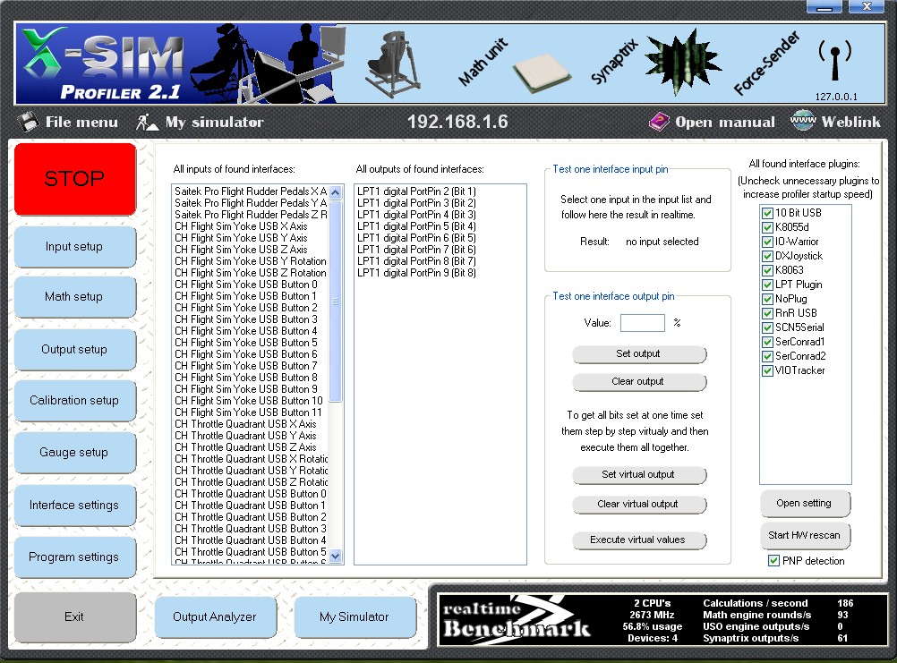

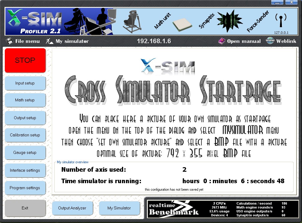

    I got my Motion Platform switched on today but I am afraid that I did not get a squeak out of it, I mean no movement at all. I will explain what I did as I feel that I may be leaving out something in the setup which is causing this.
    From the Video Details on X-SIM installation I carried out the following and everything seemed to react as it should have :
    1. Press “Force Profiler” on opening screen.
    2. Select “Math Setup” and then select “Add Axis”
    3. Set up axis No.1 for “Left Actuator Math”
    4. Set up axis No.2 for “Right Actuator Math”
    5. Select “Outut 1: 1 Gforce”
    6. Change maximum from 2 to 1000
    7. Go to ” Sender Input 21” and change “Indensity of this value to the axis” to 80%
    8. Repeat items 5,6 and 7 for Right Actuator
    9. Press “Output Setup”
    10. Go to Left and Right Actuator Position ( I did nothing here as I did not know what to do )
    11. Go and press “ Force Sender “ Icon on main Screen
    12. Go to “Settings” and then to “Manage Network Cluster”
    13. View setup of left and right actuators
    14. Number “127.0.0.1” should be seen.
    15. Go to “Official Developer Phisic Plug In”
    16. Go to “Test Plug In”
    17. Press “All slider Auto Move”
    18. Next “Try Send Data”
    19. A Graph appeared at the bottom of the Screen.
    20. Press “Input Setup”
    21. Slider 1,2,3,4 now showed readings of various figures.
    22. Graph on bottom now showed moving with scale of 1000 and with 20% off top and bottom.
    Now all of the above showed up on screen and performed as I thaught it should. I then went to Force Sender and selected the Flight Sim Profile, came back to Force-Profiler and pressed START. IT changed to a flashing STOP. The seat on the top of screen started to rock,the Synaptrix icon started a flashing movement and the Transmitter icon on the extreme right showed signals been sent out and 127.0.0.1 under it. The game FSX started up and I thaught I was in business but I am afraid ther was no response from the actuators, as dead as doornails !!
    I repeated this several times and even though the software gave me the impression that everything was going fine the actuators would not perform or show life of any sort.
    I feel as I have said above that there is something that I should do which I am not doing and would be most grateful if this could be pointed out to me.
    My thanks in anticipation.
    Toni

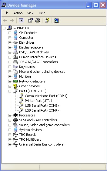

  12. toktiny
    toktiny Member
    Jun 21, 2009
    74
    - 20Coins
    Hi Rene,
    My aplogies for bothering you again but I have discovered that nether of the SCN5,s are being detected by the Force-Profiler. Idiscovered this when I found that they were not been shown in the “Interface Settings” section under “All outputs of found interfaces”.
    By using the “debugmode” I followed the sequence of directions in the Force-Profiler at the start of the program where it looks for information from the SCN5’s to detect and establish there presence and this is what I came up with.
    It obviosly scans all the available COM Ports and as I said in my previous post COM 3 and COM 4 had been set up in my PC to handle the platform. Now it went through the scanning like this :
    1. “Try to scan SCN5 #0 on COM 3”
    2. “Response from SCN5 #0 on COM 3”
    3. “Response is not correct from SCN5 #0 on COM 3”
    4. “Try to scan SCN5 #1 on COM 3”
    5. “Response from SCN5 #1 on COM 3”
    6. “Response is not correct from SCN5 #1 on COM 3”
    This cotinued until SCN #15 on COM 3 and then moved onto exactly the same procedure for COM 4 with the same results.
    By the way it scanned COM 1 as well but it was slightly different as follows ;
    1. “Try to scan SCN5 #0 on COM 1”
    2. “No Response from SCN5 #0 on COM 1” (Obviosly it knows that COM 1 is not to be used)
    This was repeated until SCN #15 with the same answers.
    The only thing that I can take from this is that COM 3 and COM 4 have been set up correctly for use with the platform but that the informatiom that Force-Profiler is getting is not what it is looking for. I have checked the wiring a dozen times but it is exactly as I showed you in a previous post.Have you any idea as to how I can correct this ?
    Kind regards
    Toni

    Did you try to connect the USB converters to an on-board USB hub? External USB hubs or hubs in the front panel of pc housings may cause trouble.
    I guess you have tried to switch the RS485 wires already, like Sirnoname proposed?
    Sometimes a re-install of the the X-Sim software does the fix as well.
    Are you using an updated Devantech driver?
    Regards
    Christian
  17. toktiny
    toktiny Member
    Jun 21, 2009
    74
    - 20Coins
    My sincere thanks for your reply.
    I was a little nervous to change any wires as sirnoname suggested exchange A/B (+ve/-ve) and I was not sure which wires he referred to so I asked for a clarification of this.
    Now in your mail you said the RS485's which I have done and BINGO both the SCN5's are being detected by the Force Profiler and after the program starts both of the SCN5's withdraw to there lowest position slowly and then with a jump come up to the half way position.Thats what it says in the manual they should do ,is that right ? Thats the first movement I have seen from them so I am delighted.

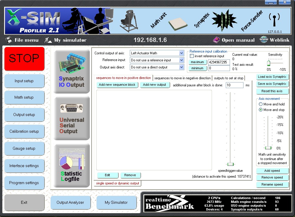

    I followed sirnoname's step by step profiler configuration as follows ;
    1. Insure SCN5 is detected and displayed
    2. Start the sender application and select the test plugin.
    3. Let move the test slider 21 in auto mode
    4. Press try connect button
    5. Go to the math setup and insert a axis
    6. Insert a gforce with effect 21 and automode
    7. Now there must be drawn a sawtooth line ( A Sawtooth line was drawn in graph )
    8. Go to ouput setup and to Synaptrix IO

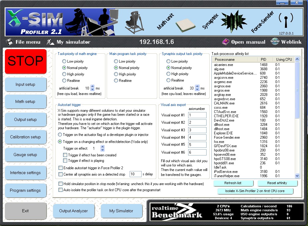

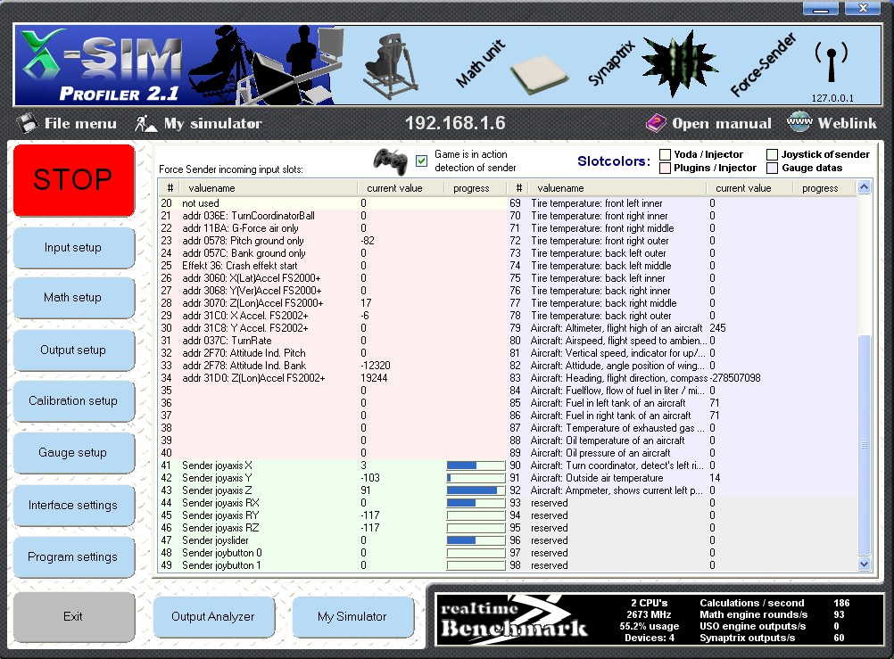

    7. Choose axis and a SCN5 as direct output ( I have my two Actuators axis named as Left Side Math and Right Side Math so I chose Left Side Math and then as a Direct Input there was a choice of three 1.Position Out 2. Acceleration and 3. Speed out. I chose the first one and then repeated the same for Right Side Math Did I do right here ?
    9. Press the start button

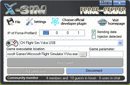

    I Proceeded then to load FSX and everything was going as I thaught it should, however, the flight created no movements from the platform. I closed everything down and repeated from start to finish several times but still no movement.
    Now I examined the Input SetUp while FSX was in flight and all of the Yoke movements were been shown changing values and also ther were four commands listed on the FSUIPC Help Screen which comes up on screen and all of the changes in values of these were shown as they happened.
    Game in Action / Detection of Sender Box was ticked
    In the Output Setup I noticed that there were three identical sets of options available, it looked to me as if they were triplicated, is this normal ?
    I use two Daventech USB 485's with left SCN5 going to COM3 and right SCN5 going to COM4. The ID for both is 0. Does this make any difference ?
    I feel at this point that everthing is almost working but that I have omitted something that I should have done in the software setup or else I did it wrong. As far as I can make out the X-SIM is picking up all the information from the controls but it is just not been relayed to the platform.
    Toni

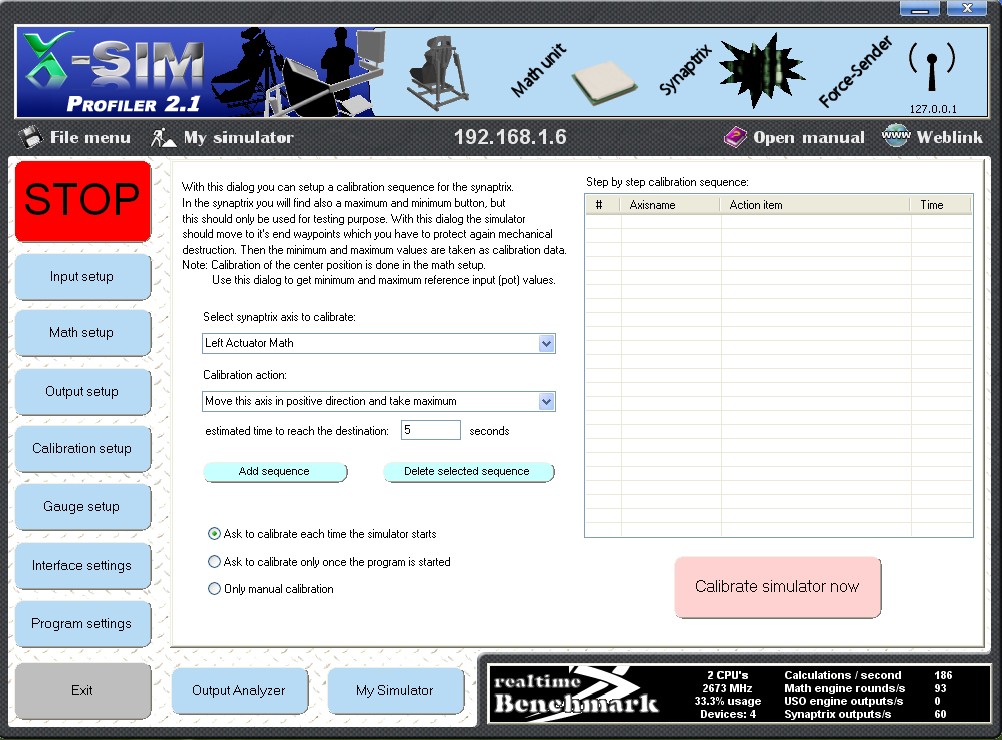

  18. egoexpress
    egoexpress Active Member
    Dec 13, 2006
    3,839
    Germany - Frankfurt/M
    421Coins
    +10 / 1 / -0
    Yes, it is the calibration procedure during startup.
    It wont be easy for you now, as there is no SCN5 movemtent profile for flight sims ready so far. Let's see if I can help...
    Do you know which FSUIPC effects you want to use to move the seat, already? You can either use xyz position data or accelleration data.
    Using both together is possible as well, but requires more experience. You should choose from both options for now.
    Let me know when you have determined the required effect numbers...
    regards
  19. egoexpress
    Dec 13, 2006
    3,839
    421Coins
    +10 / 1 / -0
    Did you copy the FSUIPC plugin out of the XSim other stuff folder into the matching plugin folder in the FSX directtory?
    And if so, did you selected the FSX plugin in the Force-Profiler?
    If everything works correct on the input side, you should see alot more changing values in the XSim Input window than the yoke axes.
    regards
