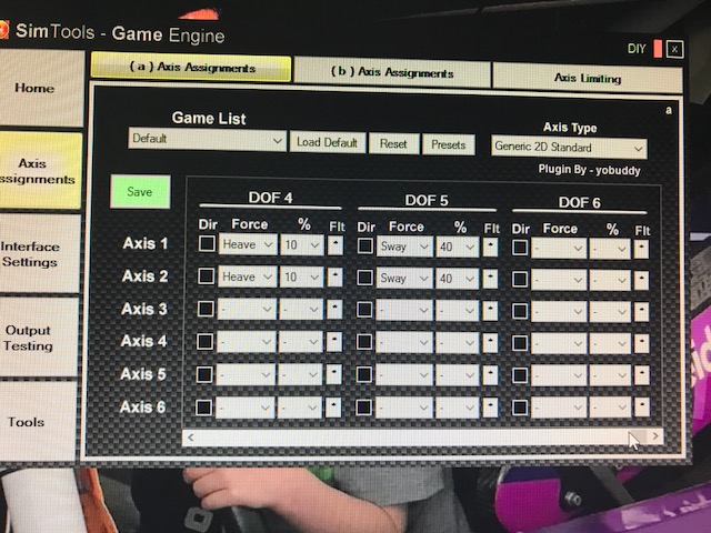

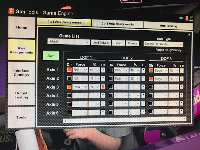

    Still trying to dial things in and have something I cant figure out in simtools. I drive a lot of high banked ovals in iracing. When the sim is setup for normal non banked road course driving and i am turning left the sim rolls to the right to simulate the cars body roll to the right. The problem is that when turning left on a high banked oval I want the sim to roll to the left to simulate the banking. I cant find an easy way to quickly switch this. The only way I have found is to manually go into axis assignments in simtools and reverse the axis for roll. Is there a way to make a preset to quickly make this switch?
  10. Nick Moxley
    17,056Coins
    +2,506 / 30 / -2
    Pictures of your Axis assignments please.
    Pitch and roll are very much Track related, Not so much car related. So your "when i turn left the car rolls right" isn't the case, I can assume you are running all 5 forces (excluding TL for simplicity sake) So what your feeling on a flat Track when turning is not Roll but rather Sway.....did you take the time to play with each force individually ? Im inclined to say No.
    Your complaint about Roll Vs Sway on the large banks is a legit one, Chat to some of the nascar/Iracing motion guys.

    I think I found problem with the axis movements but I have no idea how to fix it. I had the roll backwards...easy fix...switched the checked boxes. However the sway axis doenst seem to work properly. When I test sway in the test outputs screen it moves the seat forward and back....not side to side. Essentially sway is working identically to surge and pitch. How do I fix that? I am on the latest sim tools build. I will post up pics of my axis assignments.

    Here are the axis assignments

    Sway needs the opposite Axis Reversed to Roll.

    That did the trick. As soon as I read that I just face palmed myself. How do the rest of my axis assignments look, particularly the percentages?
