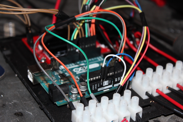

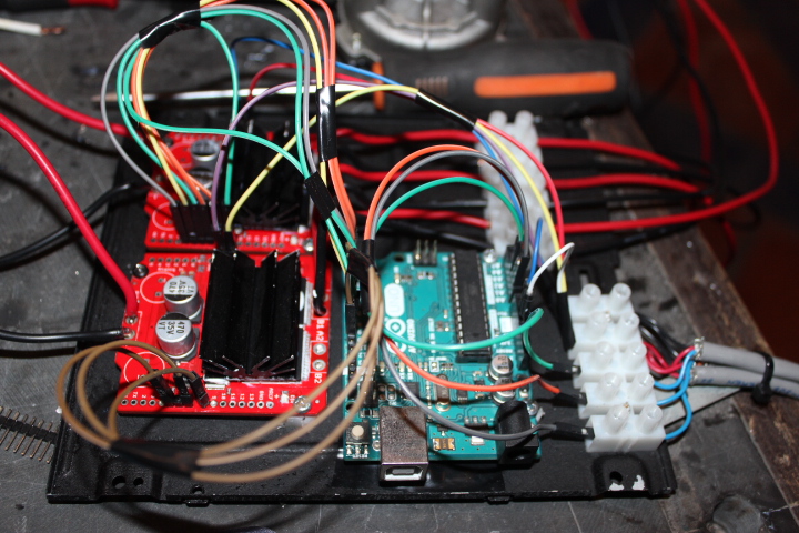

    Well ... if that is the program ... and is doing what it's supposed to do .... What should I do now? I get confused with all the comments in the guide ! I don't understand the arduino!

    No need for udp for right now. It's for two pcs to run sim tools and game. If you are configuring just use the laptop. Worry about udp later.
    Now the slow in one direction issue:
    Swap the leads on the slow motor. Or hook up different motor that you know works properly. If problem exists swap mm out. Double, triple then quadruple check the wiring. With so many connections it is easy to make a simple mistake. The software looks like it's doing its job. If you turn pot to an extreme it will disable the motor. This is the limit. It is there to help protect your equipment. There are also threads that mention grounding and some other things about wiper motors.

    THANKS.... I did insolated the motors... they are fine... maby the MM is not good... I have check the wiring 99% it's ok jajajja

    It was the MM... I have a new one and it's working!!!!
