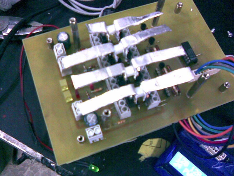

    I received the IRF4905 and the IRF3205 (a better replacement for the IRFZ44 as TronicGR suggested on his topic), so i have a the DSMhb finally complete.
    Here's a picture of it, mounted and ready to run:
    As you can see, it's pretty similar to the one TronicGr did and suggested all over his topic... let's see how it works in some days.

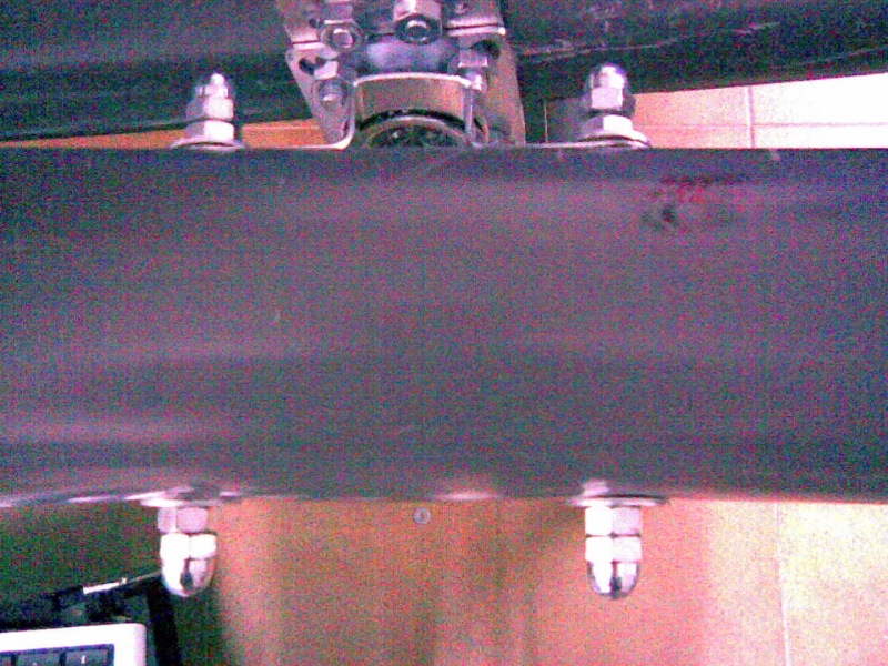

    Talking about the Joyrider itself, i have brought some blind nuts (i don't know if that is the name), becouse i destroyed a couple of trousers while working around the joyrider... and my wife told me it was enough money wasted for waste more on clothes.
    The pictures are very bad, sorry about it, but i think you will see the point:

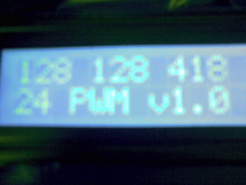

    To end, the picture of the first light of my joyrider:
    With the 24Hz crystal, running the v.1.0 firm and the potentiometers moving the numbers... (waiting for the hall sensors)

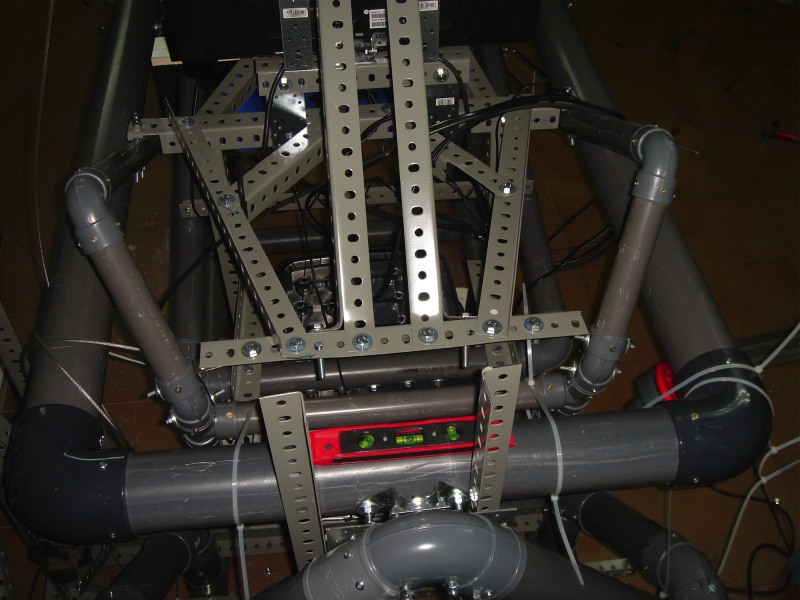

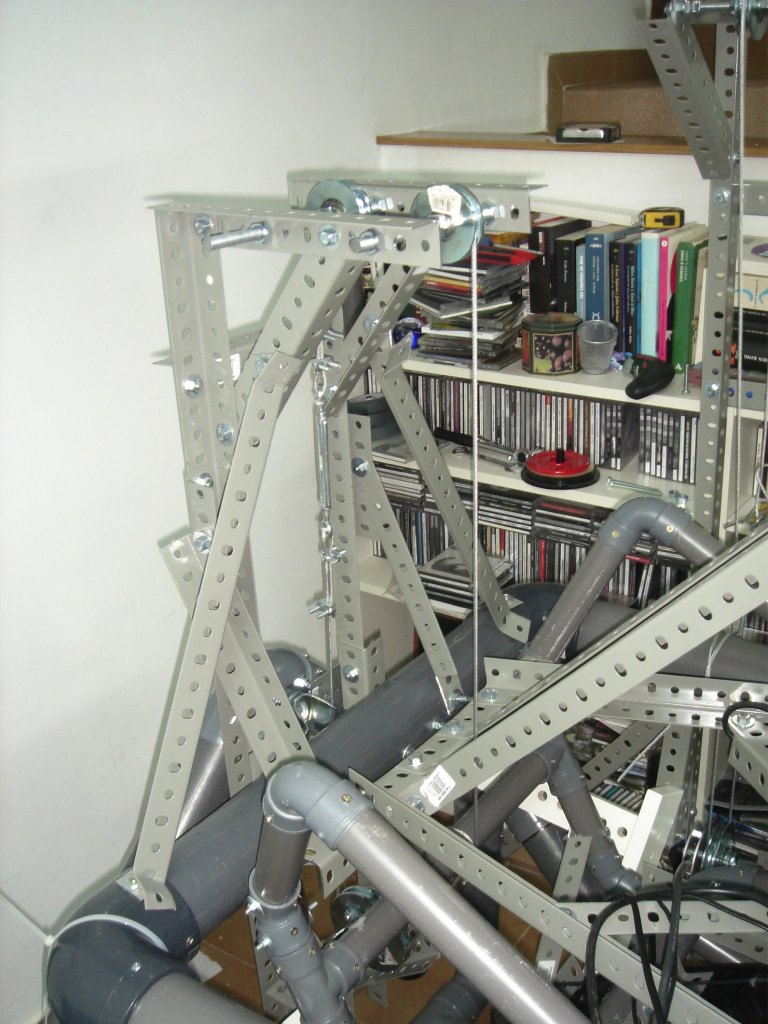

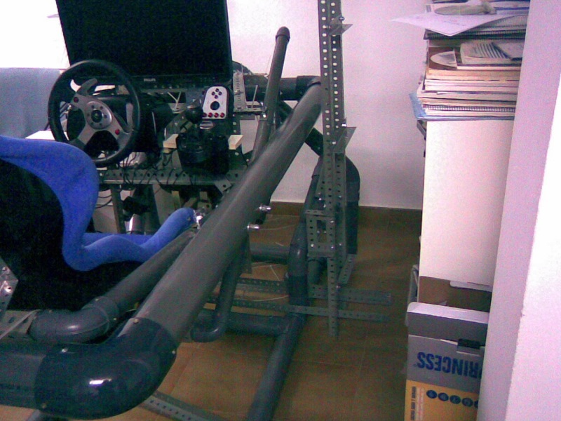

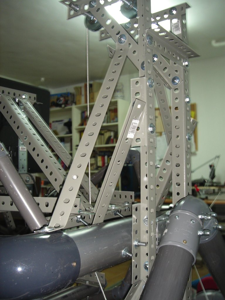

    The bank motor is getting completed as the reinforcements are nearly done... i need to try some stress tests, but for now is pretty unmovable. Note the angle TronicGr told us in his site: Whatever you will use to move the frame (wire, rope or the bus belt), the pulleys must be a little inside the frame becouse it will move on the x axis when moving (not as much as on Y axis, but enough for push the whole motor structure)
    This is my bank structure so far:
    and this one on a non orthodox position... i really needed to put it on that position becouse it was the only way to insert the roll structure i will show you later:

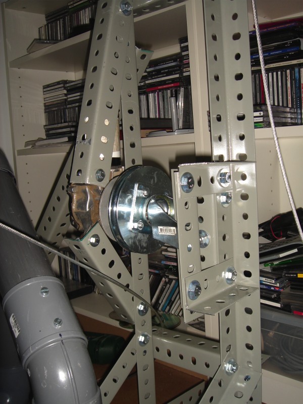

    On the roll side, and due the lack of space i left when i built the frames (i really don't know what happened yet), i'm doing it just the other way around TronicGR did, i mean, instead on the inside of the large frame, my design is on the outside. What i have to do becouse of this? If you see, my main pulley is too far away from the desired place, meaning i will need to buid an intermediate pulley to let the wire (or belt in the mid-future) to reach the vertical plane of the roll structure.
    Half work done in the next picture:
    Tip of the day: watch out for the angle when you attach the roll structure... let the bubble be in the middle to keep things balanced. Letting the motors balance the sim will end with a lot of amps drained from your batteries. The more the motors have to work, the less electricity you will have to play.
    This is my bubble in the middle moment:

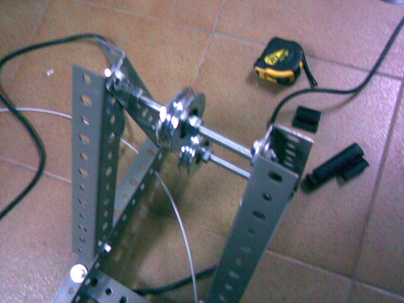

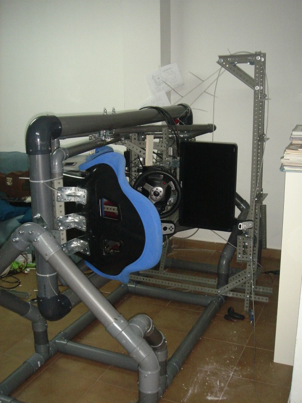

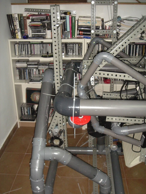

    Joyrider is getting more and more completed with the pass of the days. So let's see what i've been doing on my little spare time:
    On the mechanics side, i have both roll and bank frames ready... remember that my joyrider differs from TronicGr one becouse my frame dimensions are smaller, so i had to mount the bank structure outside the roll frame, instead of inside. You can see a picture (bad picture btw):
    and a detail here (i really love simetry):
    Be carefull becouse the metallic structure that holds the motor underneath the frame (you can't see it on the picture, sorry), may hit the joyrider structure when moving. On the other way, the higher you put the motor, the less length of the pulley belt and thus the more power the motor will need. My bank structure hit the joyrider base on a 50º and -º50 dregress, allowing a decent inclination. As TronicGr tells, a relay is something to have in mind (the circuit is completed with a diode) to let the motor run backwards in case the relay stop the movement when it hits the structure or physical limit you would want.
    TronicGr updated his joyrider with two bus belts instead of the metal rope... i'm still trying to find those belts (more or less), in my case: One of 250cm length and the other about 200cm length. They are too big for a normal car parts shop, or at least it's what they told me on my nearest shops.
    Anyway, the metallic rope works like a charm for now, let's see what happens when the structure moves again and again.

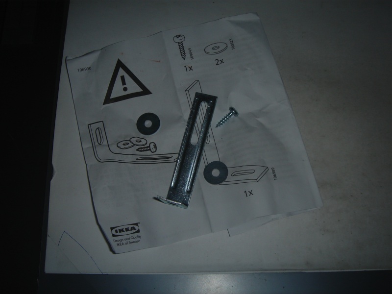

    Talking about the electrical stuff, i received a RS amidata order with a lot of parts for the AMC box i'm buiding as a enclusure. On the next week i will show you some of the connectors i have choosen and the layout of the whole box. Inside the RS order came the hall sensors you will need if you want to upgrade the Potentiometers feedback of the AMC.
    To mount them i followed a different way of TronicGr just becouse i threw all the old computers parts to the rubbish before starting this project and i don't have any metal parts like TronicGr used on his joyrider.
    This is what i have used: (Ikea DIY... that is something i will not do again if i have the money to buy it already mounted)

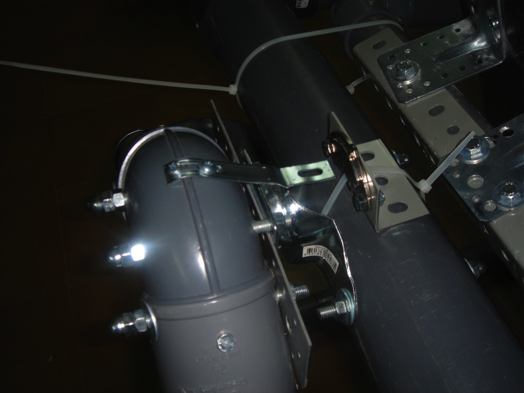

    As you can see is just a metal part that comes on all the bookshelves to screw it on the wall. I have more than four in a box (god save my wife and her tidy little boxes). If you bend it you have a perfect and strong bridge for the sensor, letting it be near the magnet without danger of hitting each other. Some views of it:

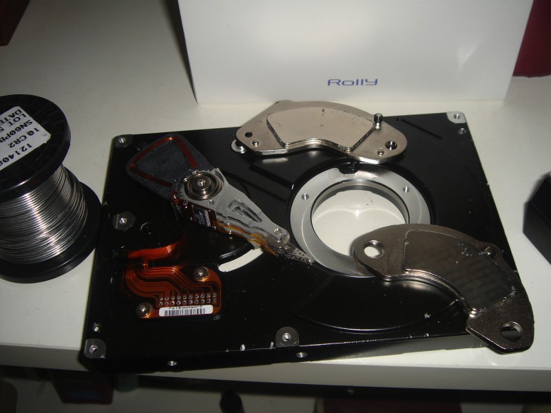

    The magnet is a Hard disk magnet. If you have some HD's at home and of course, you don't need them, you can dissamble it and take the magnet like this:
    This is the way i managed to mount the magnet:

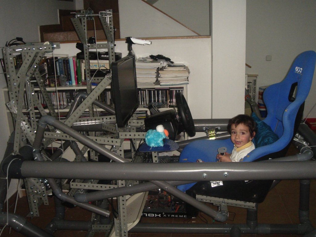

    For closing this new update, i want to introduce you my personal Beta-Tester. He is very professional indeed, and his help is invaluable.
    Put a beta tester on your life!!!! :lol: :lol: :lol:

    Wow, you make a lot of progresses, looks great! Curious to see it in motion.
    Btw. The last picture is one of the best funny Sim pictures i´ve ever seen.
    I also like the blue mascot beside the G25 :rofl:
    Hope that beta testing guy does his job well - keep watching the street 8)

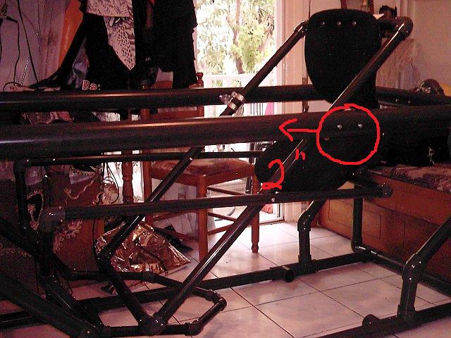

    I just noticed, When your sim is going to turn or tilt to the side.. your pitch motor and its construction will not turn with the sim. whouldent this be a problem when the sim going to pitch and tilt at the same time?
    I dident think of it befor I looked closer on Thanos joyrider and noticed that his complete pitch structure whas moving..
    I dont know if anybody understands what im trying to tell.. because my english is really bad this late.. And I can always blame on the fact that I live in Sweden ;)

    He IS moving the whole pitch structure as well!! Its just mounted on the outside of the thick bank frame structure cause some miscalculations made his cockpit a little short, with little space in the the inside.

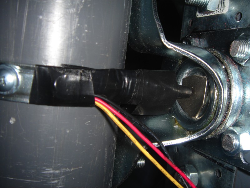

    Thend, as TronicGr said, my pitch motor follows the movement of the structure... my design is quite different from TronicGr original one as i left not as much space as i thought. Anyway, the way it works is the same as doing inside the frame. How you attach the pitch motor to the structure is another history, a big WTF! will escape from your lips two or three times, and is something i recommend you to do with someone else helping you.

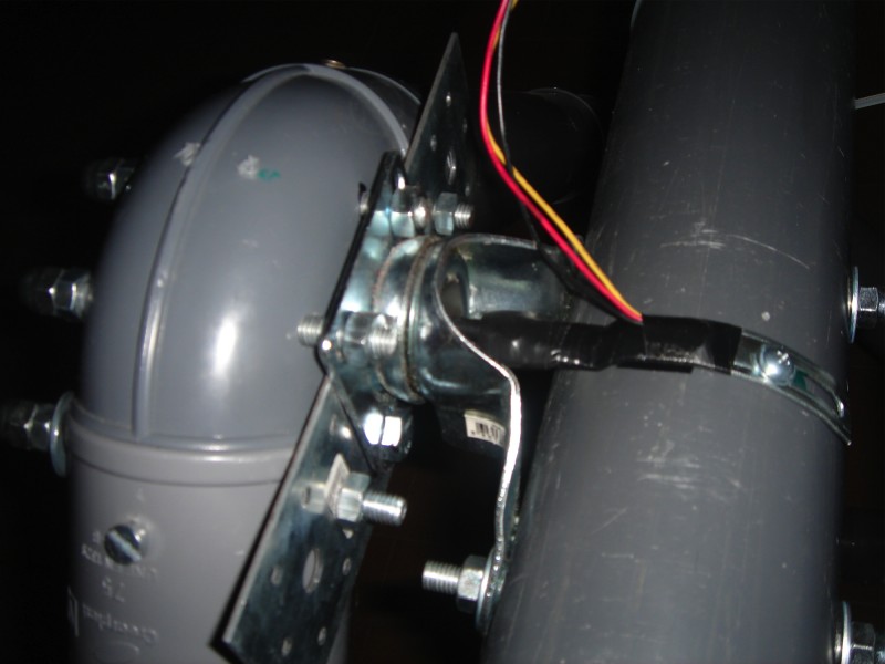

    I have change the Hall sensor frame becouse TronicGr told me that to get the best results from the sensor is rotating it at the same axis as the magnet. I'm on the beach right now (holy holydays :clap: ), so when i return to my place i will show you all the upgrades i've made to the simulator in real pictures.

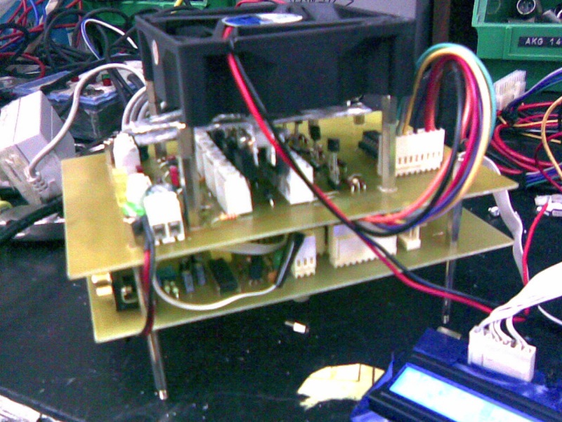

    After this mini holydays, back on work and some upgrades on the joyrider :clap:

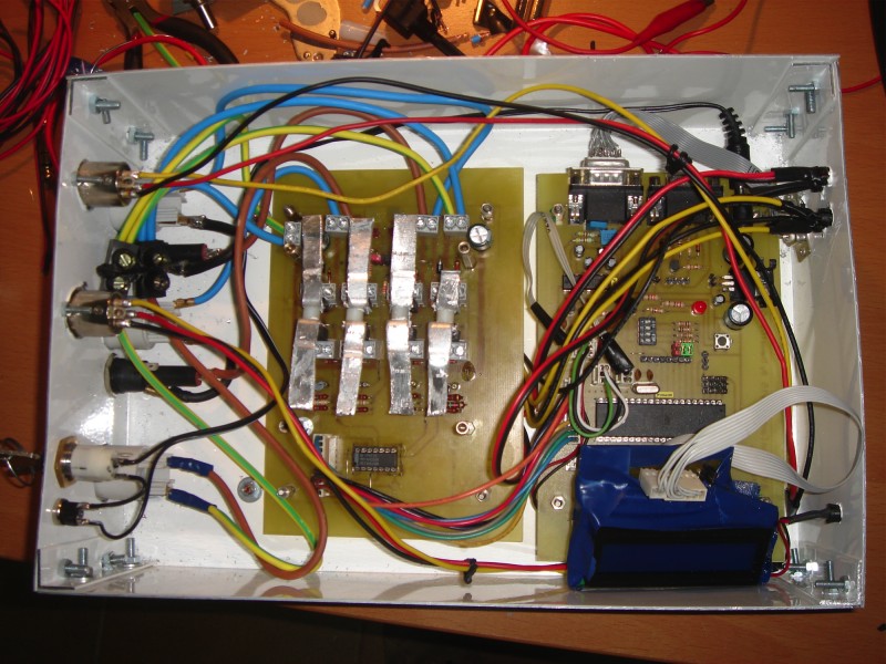

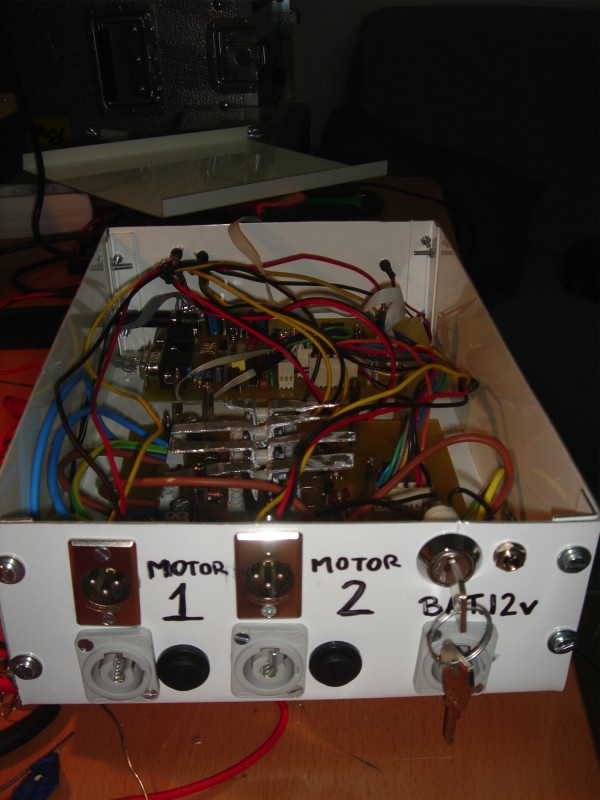

    On the hardware side, i think it's a good idea to have the AMC and the DSMhb on an enclosure becose there's a lot of amps running here and there. Following the DIY spirit of the whole project, i made my own aluminium box. The material is just 2mm thick, easy enough to work with a light driller.
    After searching for some different types of connectors, i've choosen those you can see on the picture:
    The connectors for the battery and for the motors are female powercons from neutrix. I was looking for small and secure connectors... so i added another two XLR (audio pro) 3 pins connectors for the Hall sensors. I added 2 -15 max- fuse (one for each motor), and the female connector for the mains power. As i have a little child jumping over whatever he sees, i added a key to the power as TronicGr did on his enclosure.
    On the front of the box, i just put the serial adaptor (usb very soon), and the 5 leds (4 of the DSMhb and the green from the AMC).
    The inside could be a little anarchy but i think there is enough room for everything. I have to install the fan over the DSMhb and i'm thinking to leave the LCD screen inside, as it only works as a monitor for the axis data and it will be disabled while the motors are running.

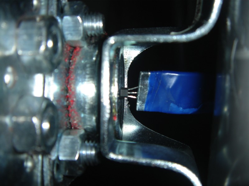

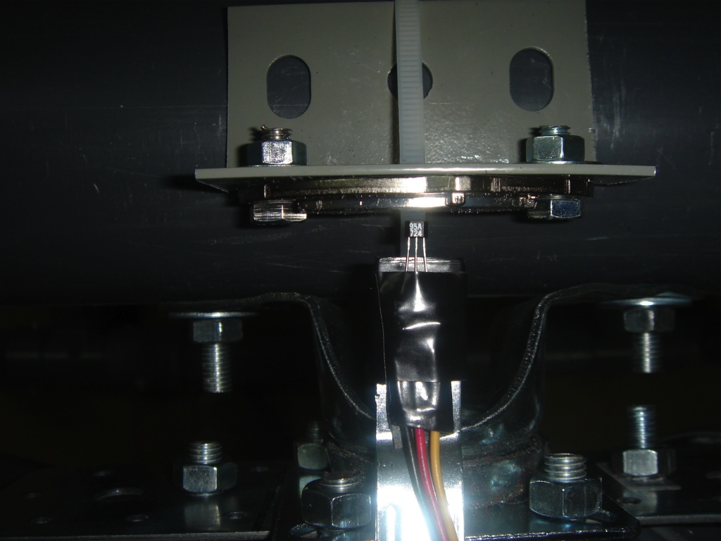

    As i talked on the last post, TronicGr told me the best resolution you will get from the Hall sensors is rolling it on the same Z axis of the magnet, instead of moving the sensor along the x or y, i mean, just rotate the magnet or the sensor without vertical or horizontal displacement between them.
    This is what i think is the best way to accomplish it:
    Notice the magnet doesn't touch the sensor, just move it a milimeter to have the best data. Again, i did it using those fantastic Ikea metal furniture stuff i found on a box.

    so much effort for a nice aluminium box and than you only write by hand with a textmarker on it :brows:
    Surely it looks much more cool, when you use labeling stickers or a spray can. (Laserprinted looks the best, anyone know how to make that with cheap things?)
    Keep up the good work! :cheers:
